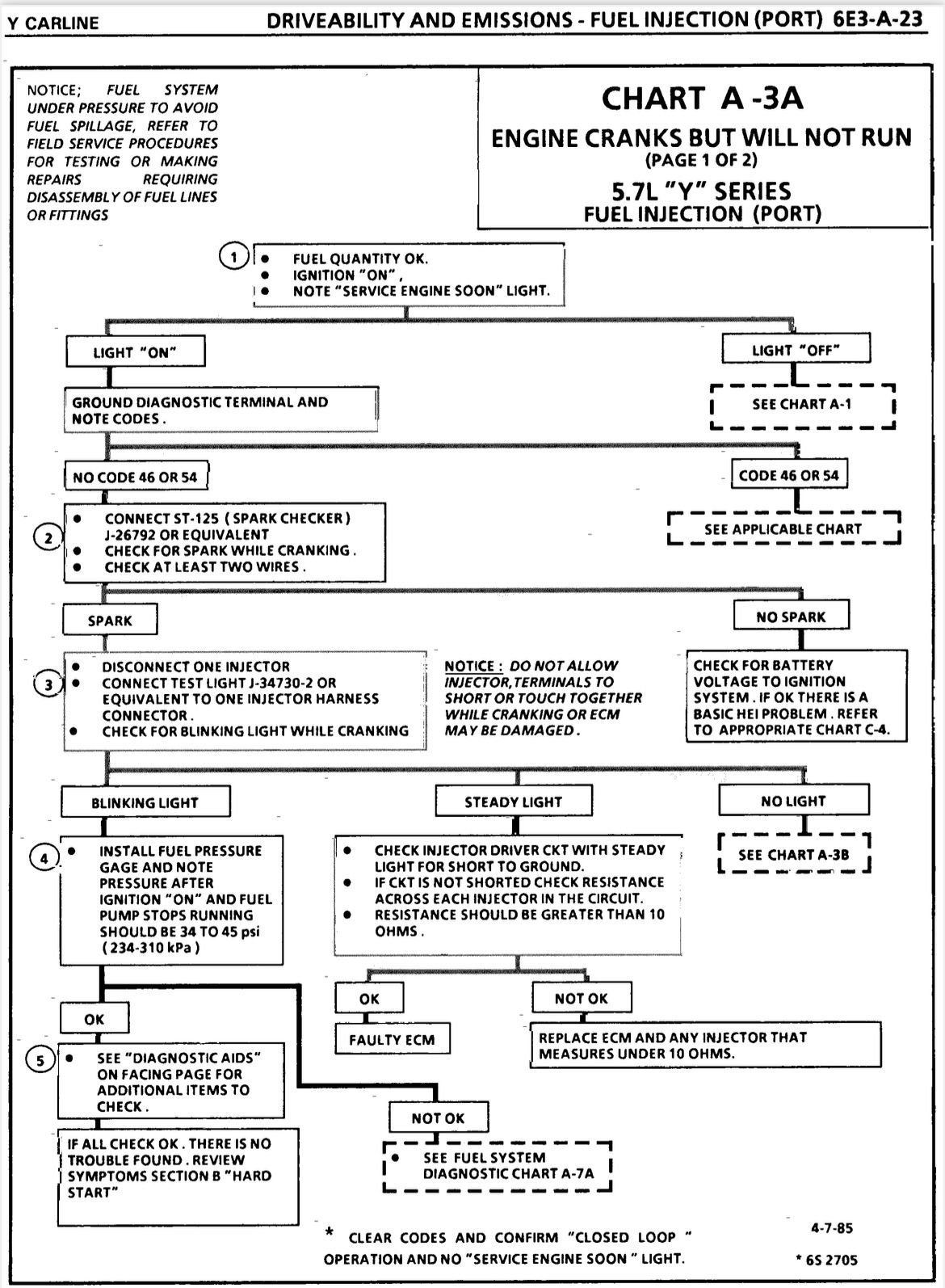

OK so good news. I took the sending unit and fuel pump back out of the car, and found that when i had put it in at first, must have somehow pulled the wiring off the sending unit. So stupid. Anyways I got it plugged back up and verified everything and stuck it back in the car.
Hooked up fuel pressure gauge and now fuel pressure now reads at 40 when turning the key to on. Pressure stays when key is turned off. So finally that works.
I have the charger on at the moment but still turning over but not starting. It did try to start a couple of times but that was about it. Im hoping after a good charge, it will start back up.
