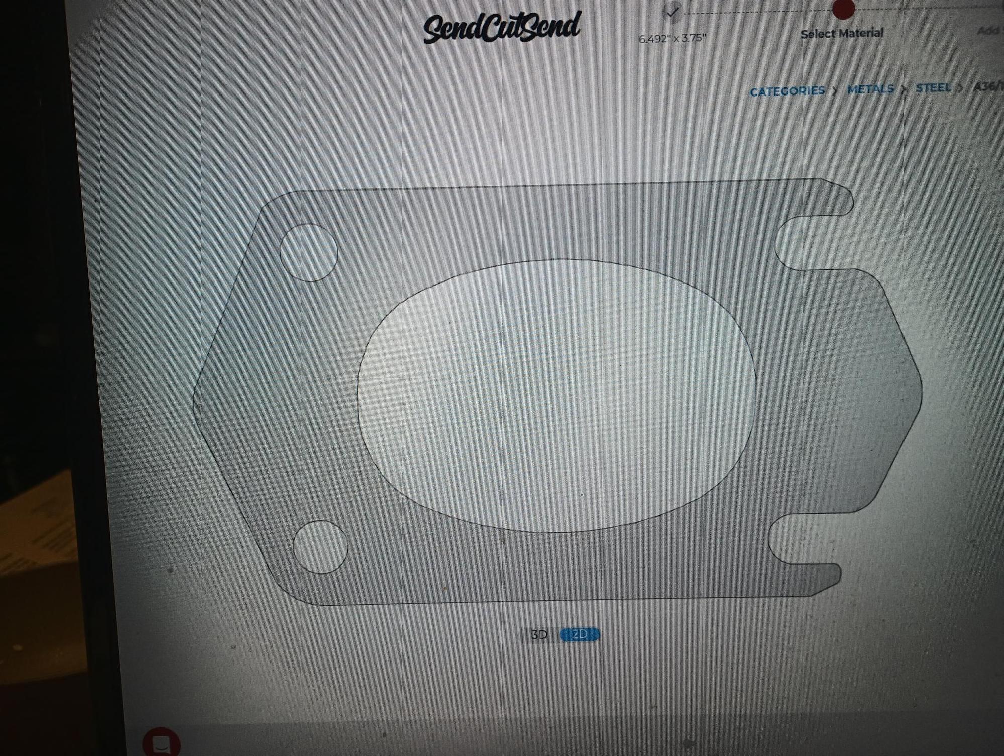

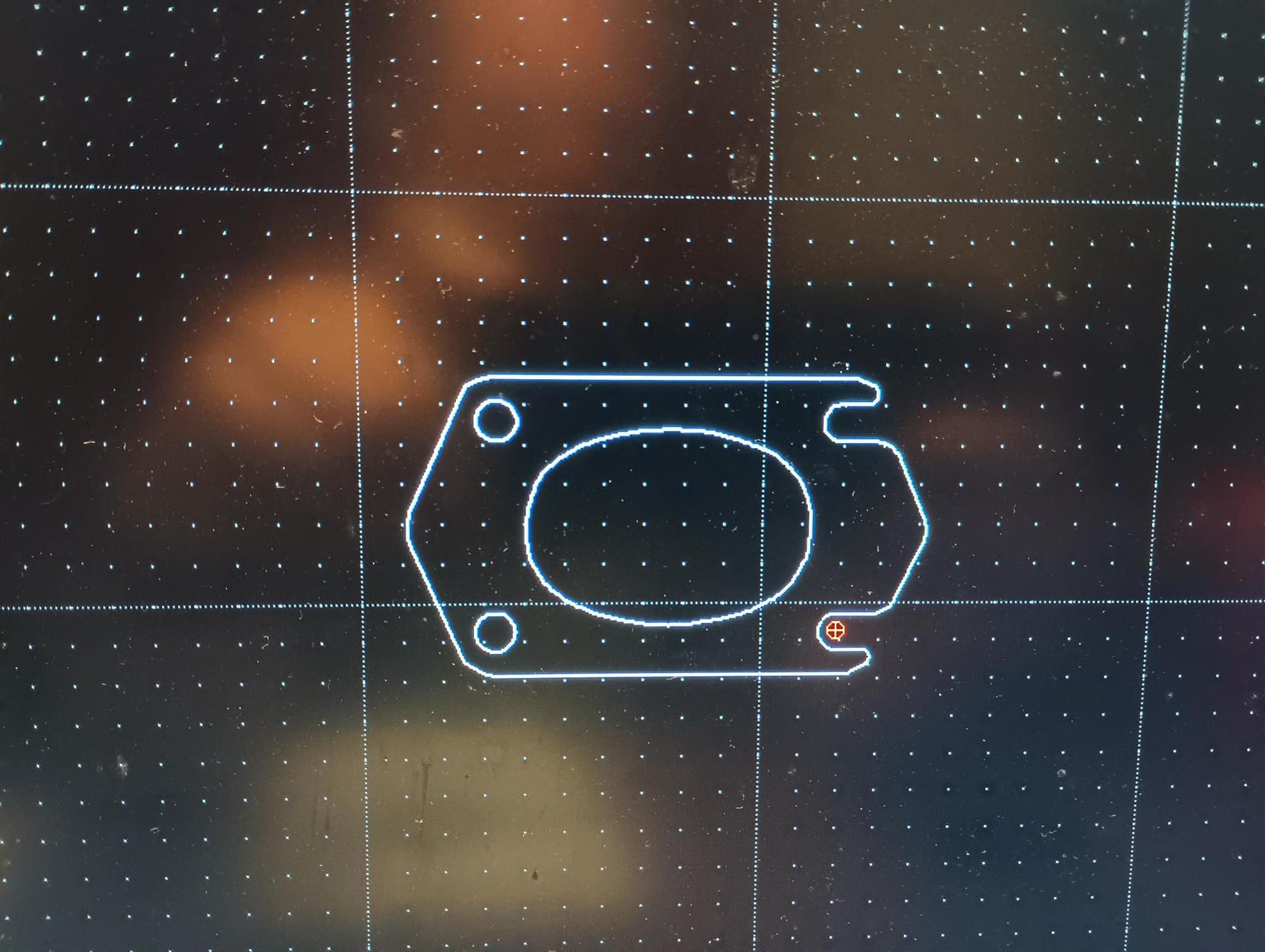

So I had a little time to mess around with CAD yesterday. My wife was in a bad car accident on Wednesday. She'll be okay. So I took yesterday and today off work to get things sorted. But it was nice to have something to focus on in-between phone calls with body shops, police and insurance companies. Anyway after a few hours this is what I came up with. It took a lot of YouTube videos to learn how to make this in CAD.
I ordered the oval tubing yesterday. So as soon as the flanges come in I'll make a jig to hold everything together for welding. Next I need to get my hands on a 86-91 cat to get measurements off of. Then I can have that flange made. I already have a shop lined up for the ball end of that one.
If I would have known that these things weren't for sale someplace I would have been making these and selling them a long time ago. Once I get the first one made I'll need one of you guys to be my guinea pig being that my 84 hasn't had a cat in 20 years. So if someone wants a test pipe for a 82-85 for the cost of materials and shipping please let me know. All you would need to do is report back to me with how well it fit.

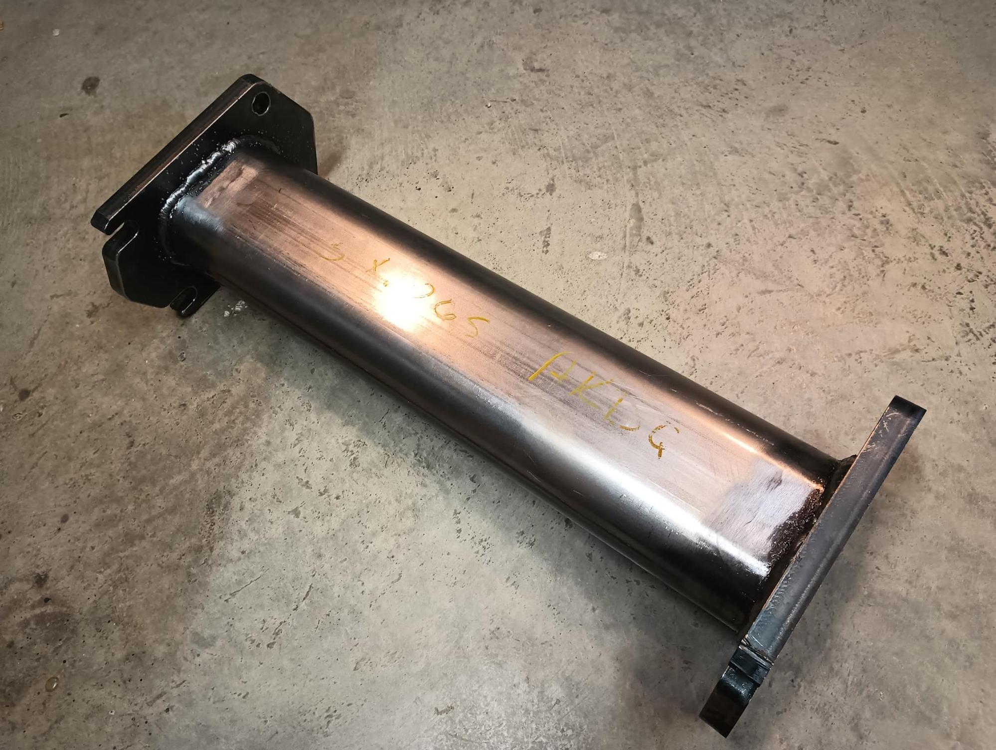

Well I got the first one done. This one is for 84 and 85 Corvettes and will also fit 83-85 Firebirds and Camaros. The jig I made worked really well. The welds aren't perfect. But I don't own a TIG so they're the best I can do with what I have. The important thing is they won't leak and they're straight. I think a half inch might be a little thick for the flanges. But it won't hurt anything. Anyone interested in getting one cheap and being my guinea pig? Once I get some verification from someone here that they fit properly then I'm going to try and list them on ebay. Hopefully they don't take the listing down.
Now that I'm getting the hang of LibreCAD, this weekend I'm going to make a CAD file for the flange on the 86-91 cats. I'll get that CAD file sent off and cut out on a laser. But I wanted to get these ones figured out first.
