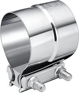

Also anyone with a 86-91, do you think a stainless band style step clamp would work instead of a U bolt? I hate u bolts and always use stainless band clamps if I can. If you guys think there would be room for that style instead of the U bolt I'll include one with this test pipe to make it easier to take back apart. This is a picture of what I'm talking about.
I just bought a pair of those clamps to use on a Corvette Central rear Y pipe and mufflers and they fit the muffler side but were too large for the Y pipe side. FWIW. Measure careful. Seemed well made.
