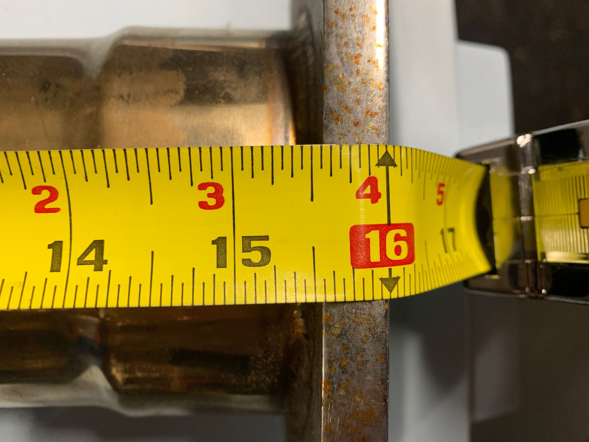

Thank you, you're awesome. On the 82-85 version I really just need the overall length. I know what it's supposed to be but if you could grab a tape measure and tell me for sure what you's is that would amazing.

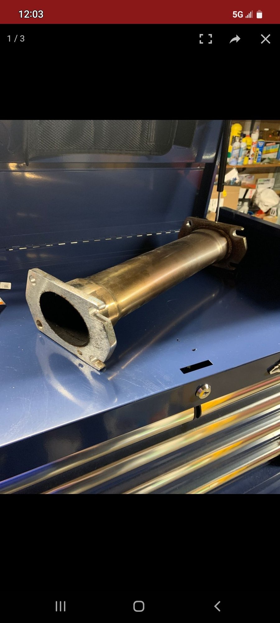

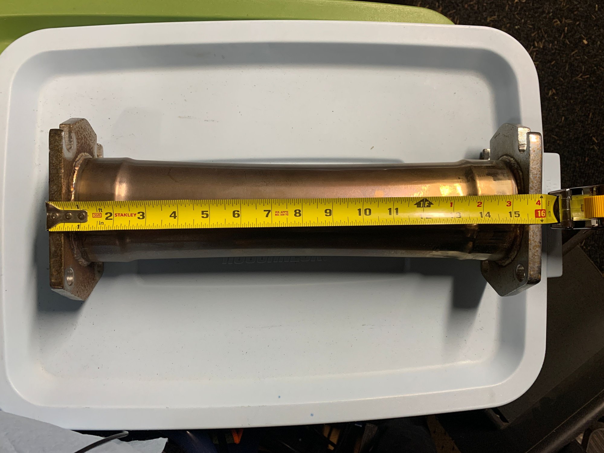

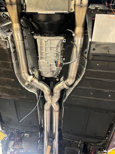

Hope these pics help.
Old Feb 11, 2025 | 06:03 AM
  #50
Phobos84's Avatar
Phobos84
Joined: Mar 2002
Posts: 2,876
Likes: 764
From: Sligo PA
Yes it does, thank you.

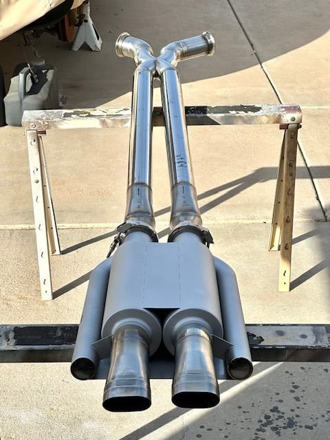

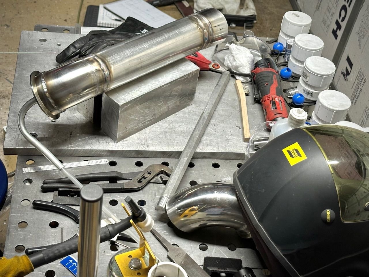

Slightly off topic, but I was actually making a set of test pipes this evening. One finished so far anyway.

^^^^^^^^^^^^^ Interesting project
That's not off topic. This is a thread about test pipes. I feel I hijacked this thread by talking about selling them lol.
Anyway I'm very jealous of your fixture table. Getting one is on my bucket list.

That's the one I have. Just bolted a big chunk of aluminum heat sink to it to reduce warpage.

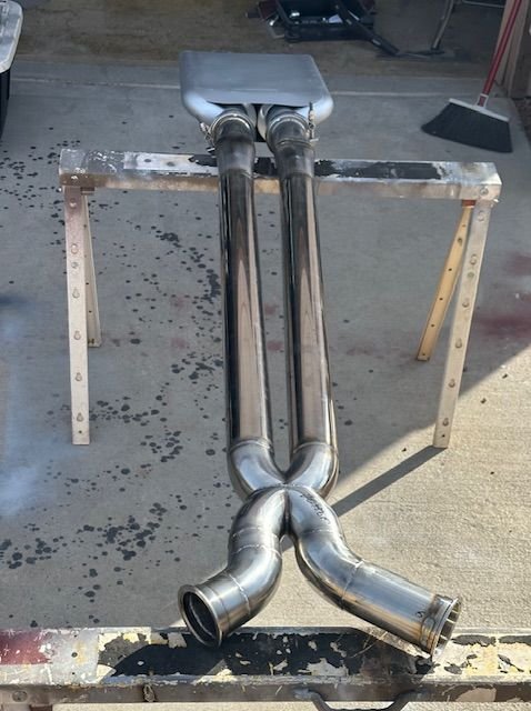

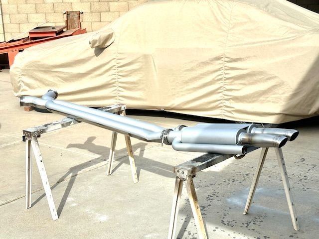

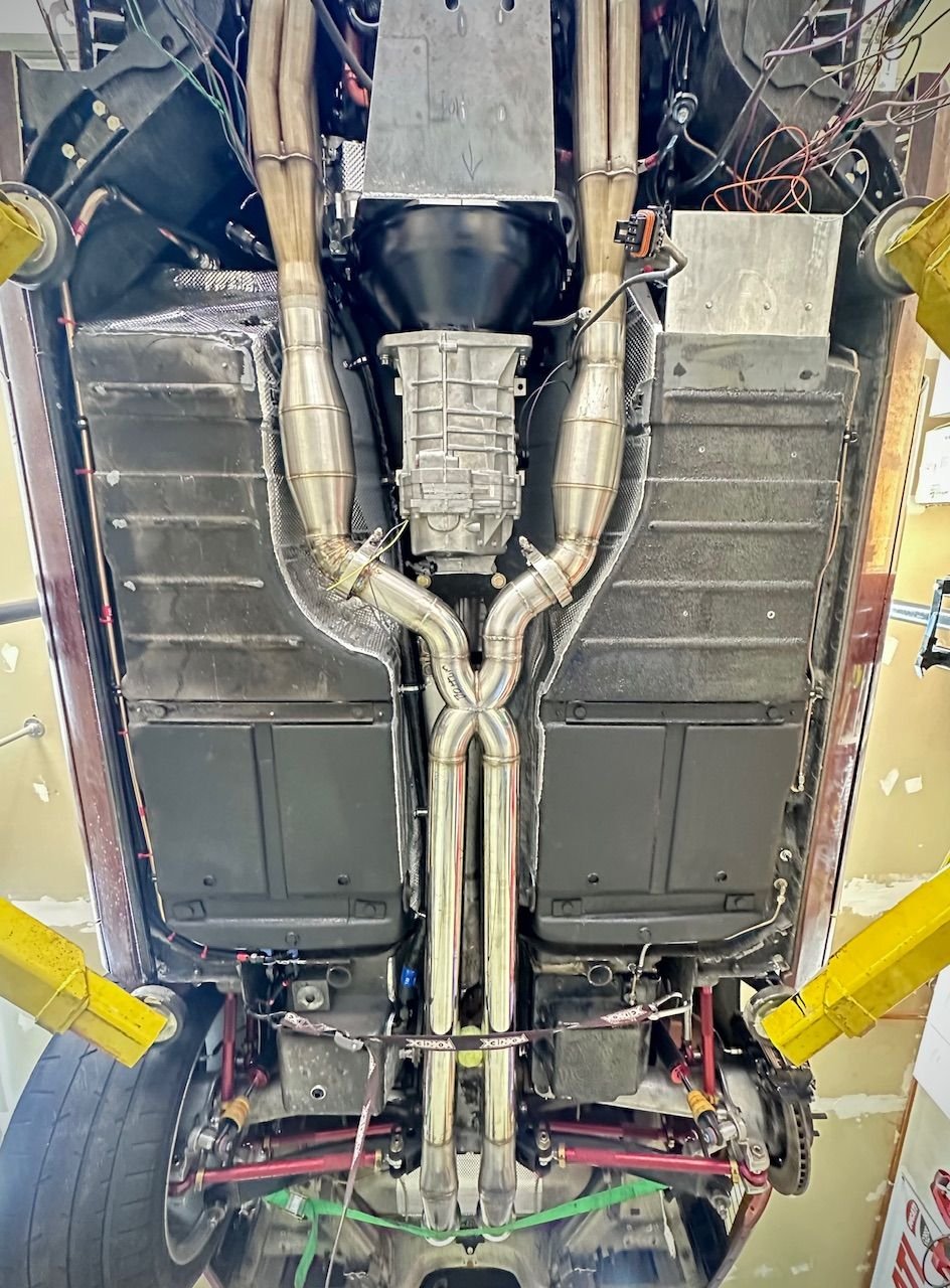

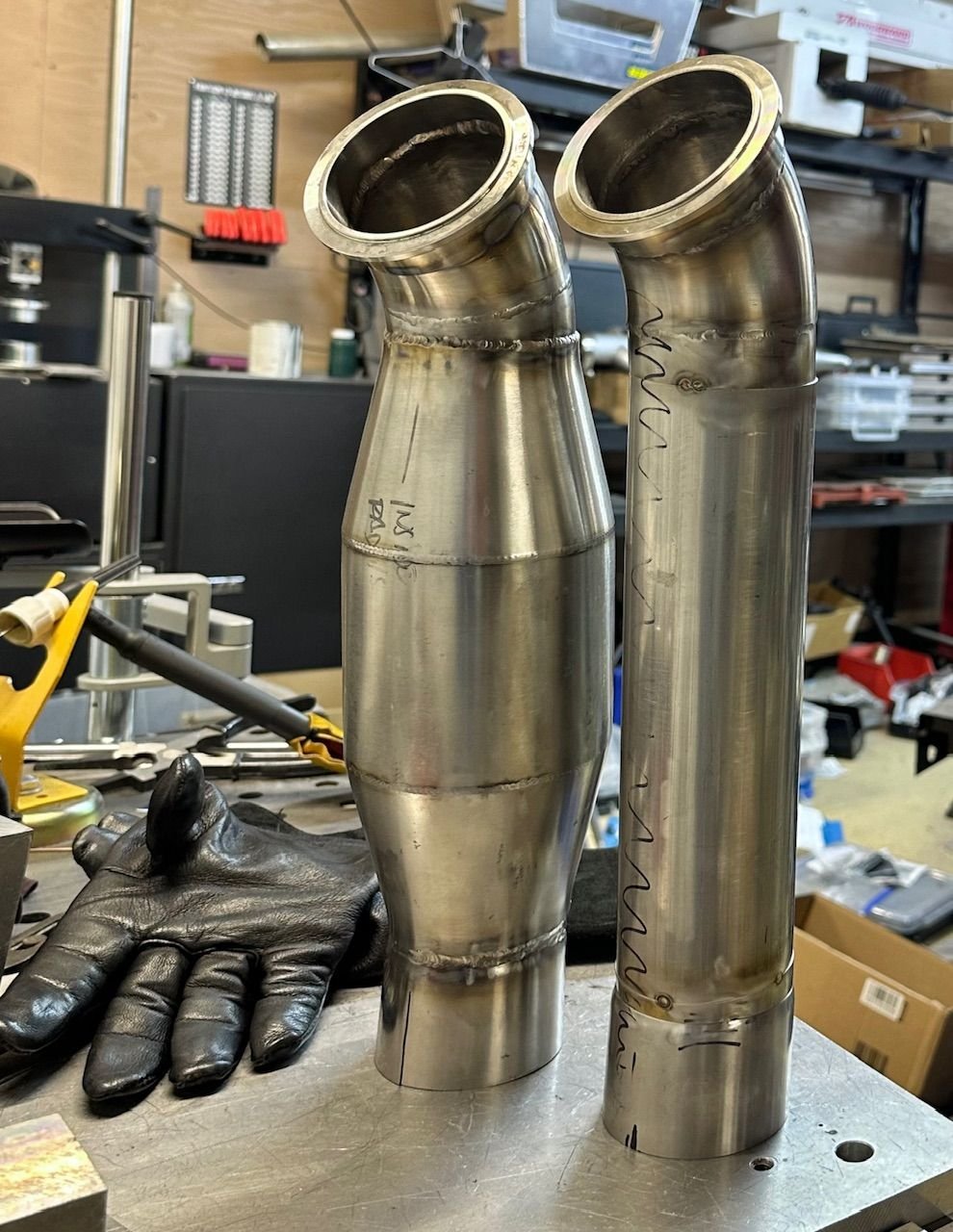

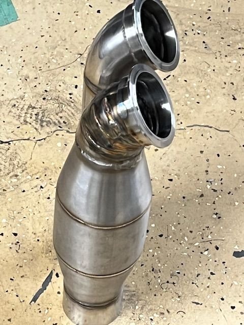

Finished up last night.
Exhaust system now finished except for brackets to hang and support. Needed test pipes for initial startup with all the assembly lube, and possible unburned fuel before a base idle tune and setup with timing light... that could foul up the cats. Test pipe useful later perhaps, but got some high flow 100cel cats for most of the time as it will soften the loudness, make the fumes more pleasant, and help with any roadside visual inspections and interrogations when driving on the street.
Here’s the rest of the exhaust with Helmholtz tubes that may be modified for length in the future, idea is zero pressure loss but noise attenuation at an annoying drone frequency. It also forms a nice upper diffuser.
