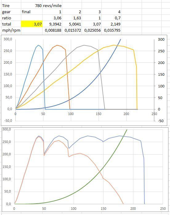

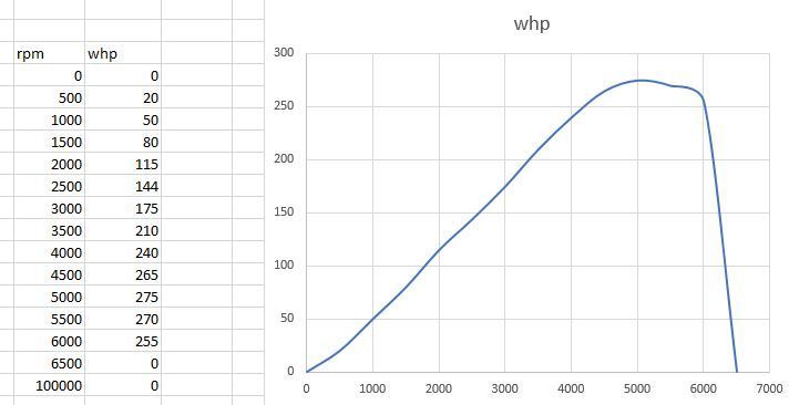

I made some calculations and graphing in excel. If you want to download and play with it -> The Excel file
First areo drag as a function of speed. The reference is 97 whp @ 130 mph from the book I posted earlier.
Then I created a dyno result. It is a tuned car making 275 whp @ 5000 rpm
I selected the gear ratios from a th700r4 automatic transmission. No torque multiplication from the converter is included in the calculations.
First a 3.07:1 in the rear axle.
In the top graph you have the whp for each gear and also aero drag, each plotted as a function of speed [mph]
In the lower graph you have whp from the best gear selection and purple curve is whp left to accelerate with after aero drag is subtracted.
Time to speed with the 3.07:1 in the rear axle.
Top speed is 183mph after 110 seconds.

Originally Posted by MatthewMiller
I think you're confusing power required to maintain a certain speed with force required (as I did when I typed the first erroneous calculation). Aero drag (and all restrictive forces like driveline friction, tire deformation, etc.) is a force. So we all agree that the force increases with the square of speed. But power is not the same as force. In order to exert the same force at the contact patch at 200mph as is produced at 150mph, you need 33% more power. This must be the case, because the basic equation for power is force*speed. Get way from thinking about power at the flywheel, and think about the power at the wheels: if the power level remains the same, the force and speed are inversely related. If the speed increases 33%, then the tractive force at the contact patch must fall by 33%.
So again, at 200mph you need 133% of the power you needed at 150mph, just to maintain the same tractive force as it had at 150mph. And you are also encountering an increased resistive force of 133%^2. So the total increase in force required is 133%^2, and therefore the total increase in power required to get that force is 133%^3.
Originally Posted by 69427
Again, I disagree. Below is where I disagree with you (I'm short on time, but I'll look at your graphs later today).We all agree that the areo drag goes up by the square of the speed. Let's just go with two simple speed numbers at the moment to simplify things (100mph and 200mph). At twice the velocity/speed, the aero drag will be four times as large.
Now, Work = Force times Distance (W=F x D). Horsepower, which is the rate that work gets done, is then Hp=W/t. (Work per second).
At twice the speed (200mph), the F (force to overcome the drag) in the work equation is 4x what it is at 100mph.
Also, at 200mph the distance traversed each second (D in the work equation) is 2x what it is at 100mph.
We then end up with an equation like this: Hp (@200mph) = (4xF@100mph)x(2xD@100mph)/(t=1sec) = 8x(FxD@100mph) = 8xW each second = 8 x Hp that was required at 100mph.
I'm late for an appointment. Will check back later. I welcome any correction to any mistakes made in this rushed post.
I stand corrected and I have corrected my post with the graphs and the Excel file.
I got fooled by the statement that you need cube of hp for keeping up with square of hp drag, not noticing that drag had changed from hp to force.
With 275 whp the top speed calculated to 183mph after 110 seconds with gearing to match max hp at top speed.
To get 200 mph you would need 350 whp with optimal gearing.
