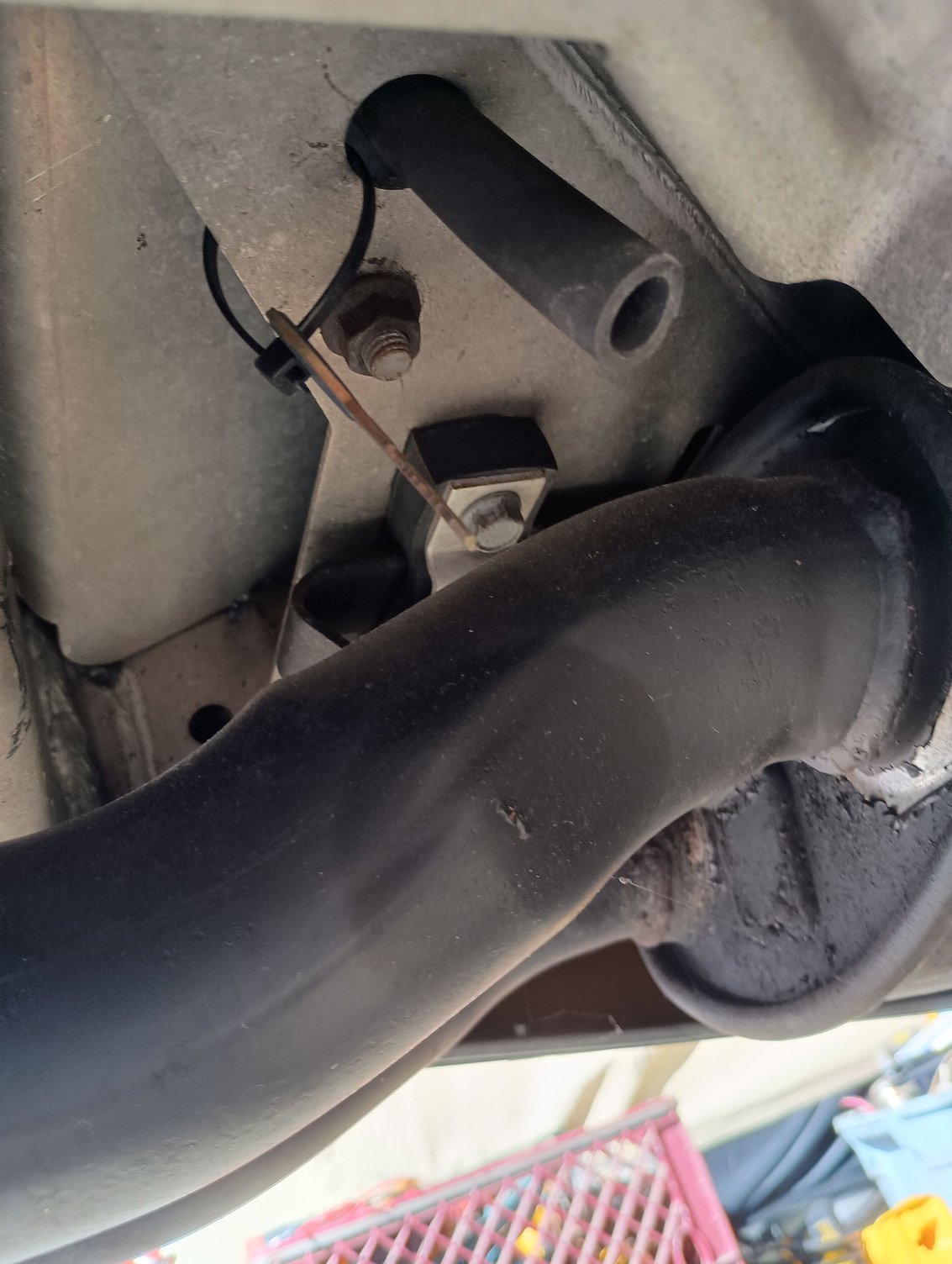

While I was underneath my car today, prepping it and cleaning it for NCRS judging I noticed that the gas overflow hose rest right next to the muffler. Personally, I don’t think this is correct. Does anybody have anything to add ?

On my 95 it's next to the Left muffler, in earlier years I believe it came by the License plate to the right of the spare tire nut

I think this is meant to drain water from the gas fill cavity. Hence no issue next to a muffler.

Unless someone is a slob and pulls while pumping or if it doesn't click and overflows

Is this your blue 88 convertible? On all years, the hose comes out through a hole in the aluminum rear extension brace in the location in both pics above. Your muffler's shell is longer than an OEM muffler. Stock mufflers end ahead of the hose, the end of the hose can't drain onto the muffler.

Mine doesn't run anywhere near the muffler.
It runs just a tad left of the spare tire bolt, near the license plate.
That's on my '90.

Earlier ran down and out below the license plate which I like because it's a straight line from Bibb to ground I'm not sure if the new way is prone to clogging

No. It has always been on the left side, near the muffler. There's a hole in the aluminum that it protrudes through.
Here is a picture of my unmolested 1985. I just took it. As I mentioned in my post above, I've scrutinized several hundred C4 Corvettes over the past 20 years. The hose is positioned exactly the same on all years of C4 Corvettes. Cheers.
this is a 1985, built in April. Picture taken from inboard looking outboard to the driver's side.

We also know that awhile back you replaced the fuel tank in your 90. If the hose is now "nowhere near the muffler" it is because you didn't re-route the hose back to its original position. It is supposed to protrude through the hole in the aluminum. Cheers.

Hm. I'm gonna have to give that a look, Thanks.
I didn't even know that there was a hole for the hose to run through.
