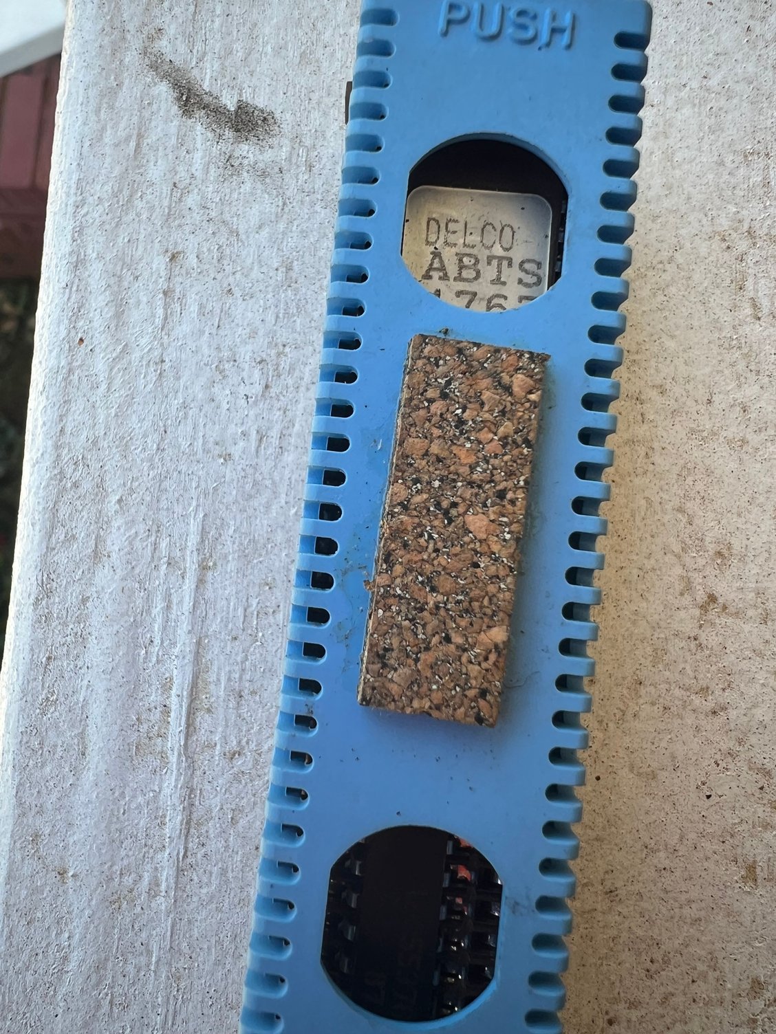

Posts: 139
I thing this is the prom . sorry about how large it is

That’s what’s considered a memcal, memory calibration. With a prom on one side and netress on the other
I don't know what that means. are you saying I need a different prom. if so can you recommend one.
I have another ECM and a aftermarket prom that I tried and the truck does exactly the same thing
