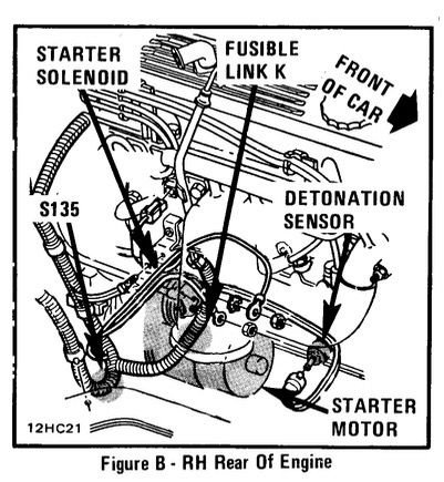

Old Jun 1, 2026 | 08:37 AM
AGENT 86's Avatar
AGENT 86
Active Streak: 90 Days
Joined: Jan 2003
Posts: 20,315
Likes: 245
From: Summerland B.C. Canada
Have a look at fusible link K at starter. Power comes from large stud on solenoid through fusible link and onto blower control.
