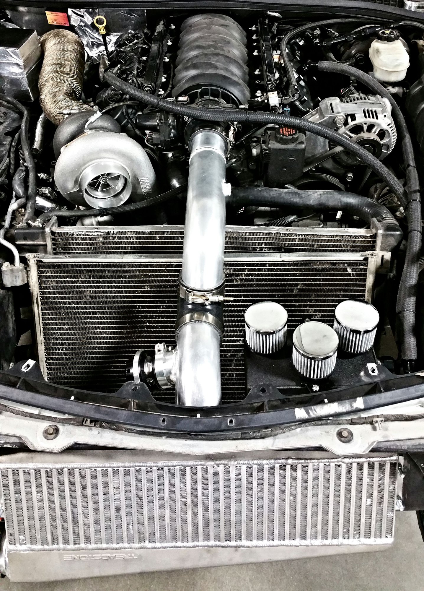

Here is my setup.
07 LS2 with an LS6 valley.
Check valve between valley and tb
Each valve cover is vented with -10 to my big *** catch can
