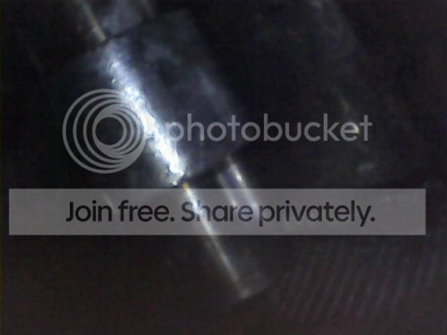

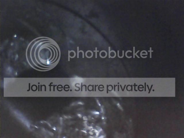

When I break stuff, I go all out. I had a brain fart the other night fiddling with my tune. I did some cutting and pasting in my VE table and missed a section which left a nice low spot in exactly wrong area. Oh well, live and learn. Here is the result(pics with a borescope in the spark plug hole):
I already have another LS6 shortblock on the way as well as a set of 317 heads. I specifically did not go 5.3 because if I go back to NA down the road I dont want to be short of power. Still deciding which way to build the shortblock before I swap it. I still have no aspirations of huge power so I'm thinking just some forged rods and pistons if the stock crank checks out.
Still havent taken anything apart but its a good bet my turbine is detroyed as well.

How lean and at what boost did it hit?
Old Dec 10, 2013 | 08:13 PM
MawneeC5's Avatar
MawneeC5
Joined: Aug 2004
Posts: 2,237
Likes: 9
From: Springhill FL
I was in 3rd gear doing steady state cruising at about 4k and gave it a bit too much throttle. It jumped right into boost and popped it pretty much instantly. Afr went from high 10s to 13.7 right at 5k rpm, timing was 15 degrees. It was a whole bunch of stupid on my part. I was way too tired and aggrivated to be tuning(4am sunday morning after working 12 hours). I was chasing down an issue with my map sensor scale and should have fattened up my VE across the board and gone back to conservative timing. Instead I just copy and pasted my rows in the ve table guestimating thier new spots on the map scale. It actually wasnt too far off except for the row I missed.....150kpa.... Absolute bonehead move on my part to even try it like that. As soon as I looked at the log and the tune I knew exactly what I did. Like i said, live and learn. I guarantee next time ill be a bit more conservative.

Some good news. My turbo seems to be unscathed.
I may have to toss my intake though. I flipped up the throttle body blade and there was shrapnel sitting right behind the blade. I will wash it and give it a thorough inspection with my borescope camera.
