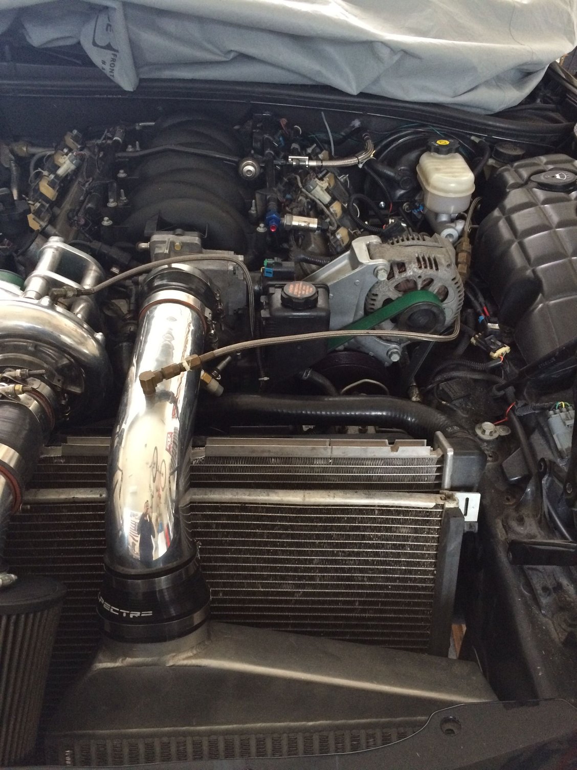

From: Earth, United States
Hey boss!! Looks good!
I'm curious as to why you have your meth nozzle orientated like that? Is the line just too short to route elsewhere?
Old Jan 2, 2016 | 01:49 PM
  #54
Yes, line was short. But I did reroute it slightly because i did not like it running across the alternator. I will buy a longer cable at some point and fix it right.

it does look a little odd, make sure the check valve is in the right direction... it almost looks like the lines are hooked up backwards, the line from the pump to the check valve is shorter than the line from the valve to the nozzle and all the connections are the same so it's easy to get it flopped around
Hmm. I will check it. But since it was a used kit the nozzle was already on one end. I never checked the check valve tho.

if it's in the right direction see if you have any slack in the line from the pump end... the lines from alky control should be long enough to run down the driver side frame rail and cross over near the radiator hose/condenser
You were correct, the check valve was in the wrong direction. Really weird, cause the nozzle was already doped/threaded onto the line.
Anyway, I reversed the line and ran it up the frame rail and straight (almost) across the radiator.
