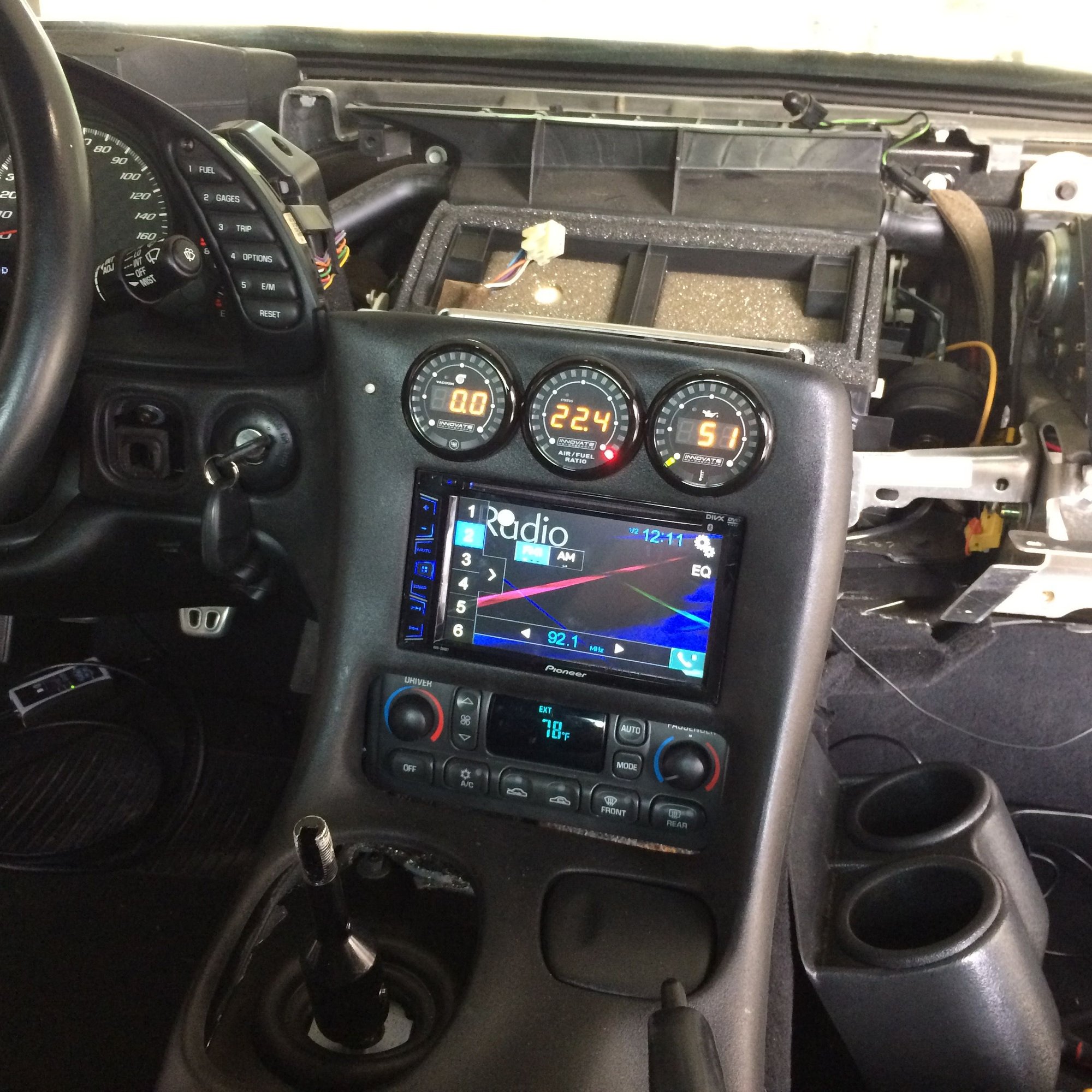

However, I do have the car torn apart again on the interior because I got a double din radio and modified radio bezel for my birthday...with 3 gauges.
This is what it should look like when done.

Old Apr 4, 2016 | 09:50 AM
  #86
TX Z06 02's Avatar
TX Z06 02
Joined: Aug 2014
Posts: 604
Likes: 25
Well, that escalated quickly.
I had to remove the entire dash pad to get to the cage support for the stereo/hvac controls. With everything moving down, portions of that mounting cage have to be cut out or modified.
I got the HVAC controls to fit without too much trouble, just locate it further down the cage and drill new holes.
The stereo is going to be a bigger issue. I have no idea how I am going to support it.
Also, when I plugged the OEM1 in and hooked up all the wiring to the stereo, the Pioneer wouldnt turn on. I figured out that there is no 12V to the yellow wire, which is supposed to be constant hot (battery). When I run a jumper over to switched 12V, the stereo powers up and works great. Still trying to figure that one out, but quickly got into bigger issues just mounting everything. Its an easy fix, just run a constant hot wire to the battery, but not sure why its not working since the OEM1 is pretty much plug/play.

Getting closer. Still waiting on the brackets to mount the stereo. Everything else is done besides programming the innovate gauges.

That came out really nice

3 gauge double din bezel installed (Shift light still not working after tapping white wire to gauge cluster. Gonna try going to a coil wire):

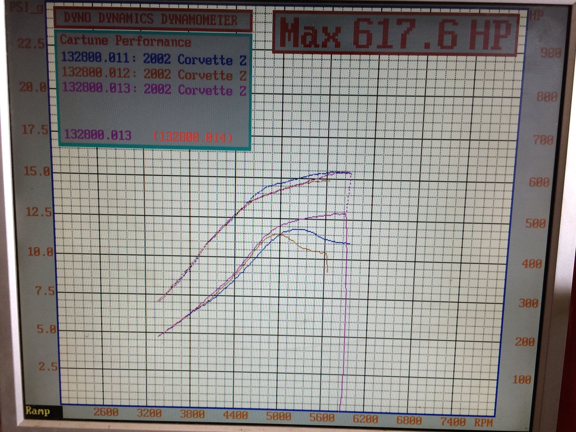

And then went to the dyno yesterday.
This was the same dyno that I made 396 rwhp when I just had LT headers and a tune. It was a bit more tricky this time. At first, it was spinning like crazy on the dyno. It finally was holding traction after the tires warmed up more, the car was cinched down more and the load on the dyno increased. And then the boost was falling off at high rpms. So I tightened the belt until i couldnt tighten anymore (found out my belt is slightly long).
Long story short, the boost finally held (bottom line on the dyno graph), but for some reason power peaked at 5800 rpms. After discussing with Bret, a dyno tune would get it over the hump with the higher load on the dyno, however, the car is street tuned and runs great on the street. I'm not chasing a dyno number so I called it a day.
The potential is there for 630-650. And the MPH from the 1/4 mile run suggests that the power is there as well. Overall, I am very pleased with the results.
