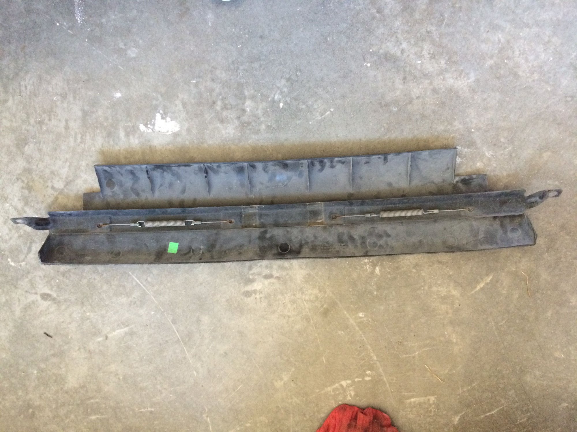

Originally Posted by TX Z06 02
I spent some time yesterday finishing up the install. I put the hood back on and the air dams and got it ready to drive.
So I try to go for a drive today and the air dams scrape on EVERYTHING. I mean just a high point in the road and they scrape.
By lowering the radiator support to make clearance for the intake to the supercharger, now the air dams are lower to the ground by about 1.75". Its annoying, so much so that I turned around and went home before ever getting out of the neighborhood.
I did not raise the center air dam with the relocation brackets that come with the A&A kit. My air dam wasnt like the ones that are in the instructions, so I just put it back in the stock place. However, it was higher off the ground than the outside air dams, so I thought I might still be ok.
But just to be sure, I took the center air dam off and went back out on the road. The sides still scrape everything, so even if I did raise the center up some, that wouldnt fix the sides.
What did everyone else do? Cut them down? Raise the front end up?
We typically use the air damn relocation brackets and I like to trim all three pieces shorter especially if the car is lowered too.
You are supposed to cut the springs off the stock air damn as per the instructions. "Carefully cut out the springs and take the metal brackets off the plastic air dam."
This one is not trimmed shorter yet, but you get the idea.
Attachment 47945629
Thanks Josh. I have the relocation brackets purchased from A&A through Bret. I missed the part about cutting off the old brackets/spring - that's what I missed. I couldnt get it to work with the bracket/springs still in place. I will try it that way and relocate the air dam higher up. Then cut off the side ones to make them even. I was gonna start at 1" and see where that got me.

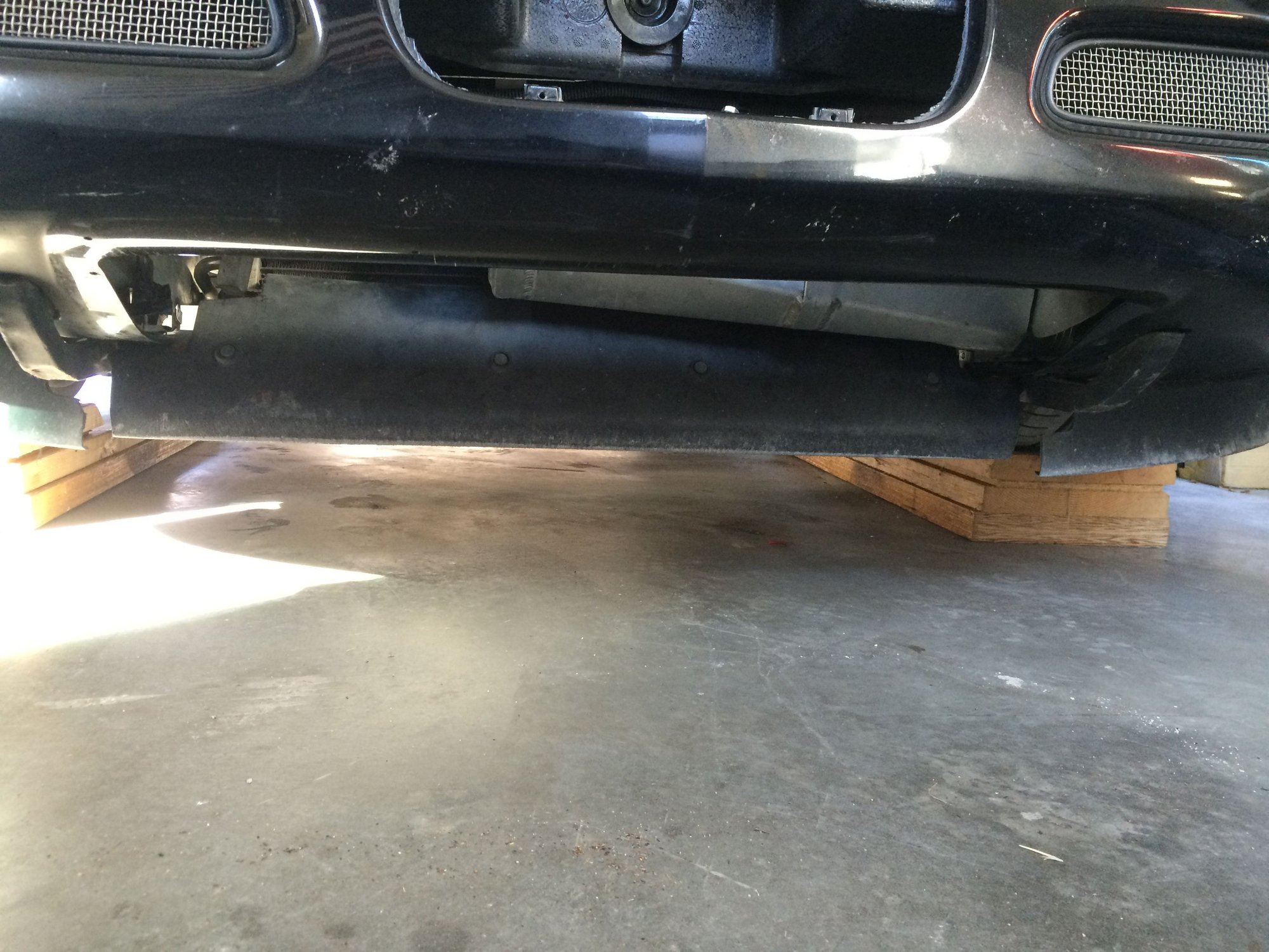

So this week I got the center air dam mounted correctly with the relocation brackets. I also cut down the outside air dams about 1". They line up very closely to the center air dam, so hopefully that is high enough off the ground.

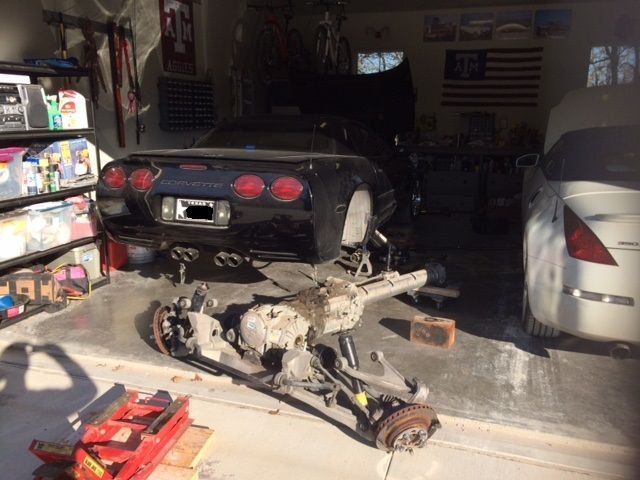

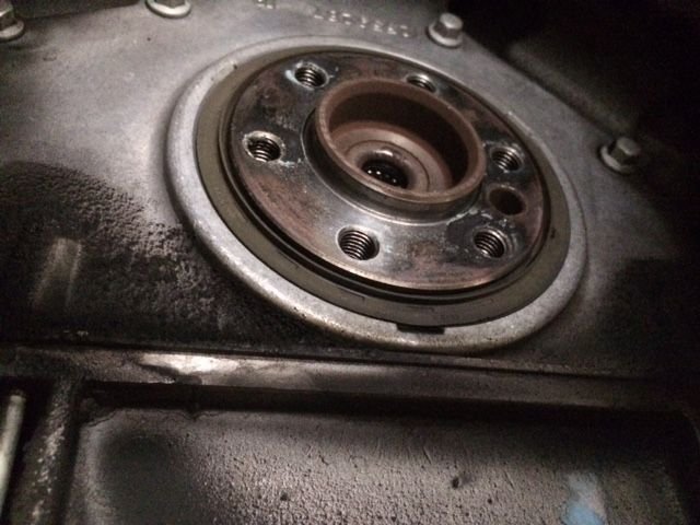

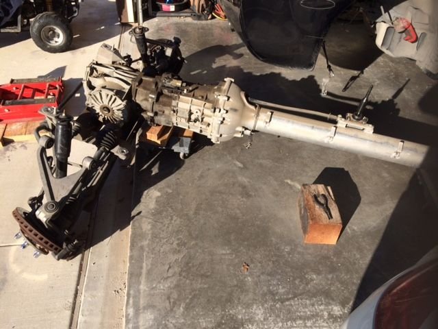

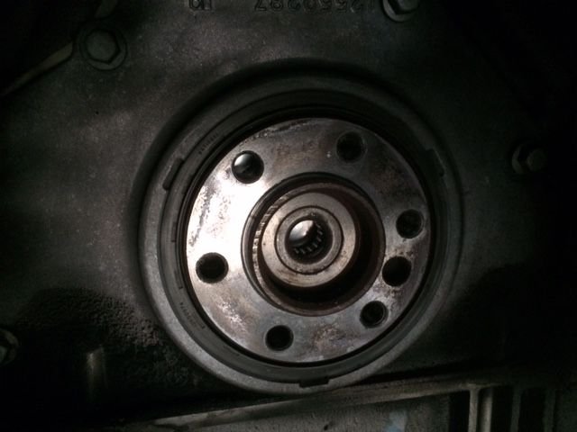

Got the rear cradle, transmission and TT removed today. Took me about 5 hours to get it completely out, but I was working slow and working on another vehicle at the same time changing oil and stuff.
I was contemplating changing rear main seal while I got it this far, but after looking, there isnt any sign of leaking. What do you guys think?

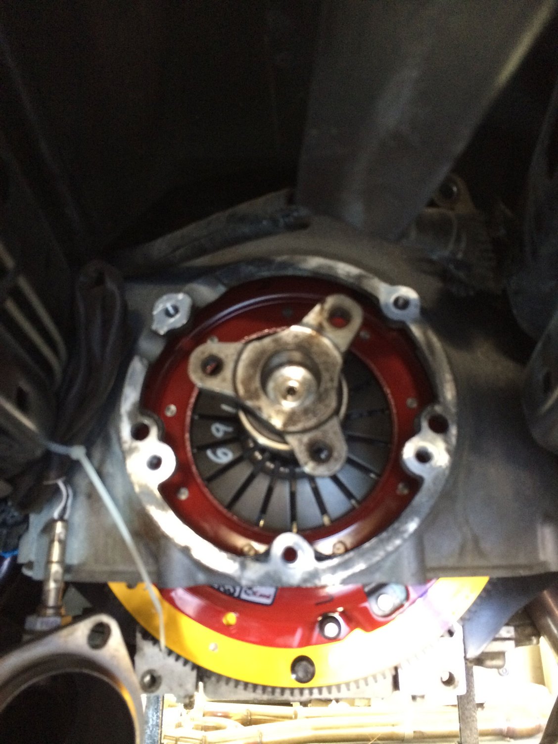

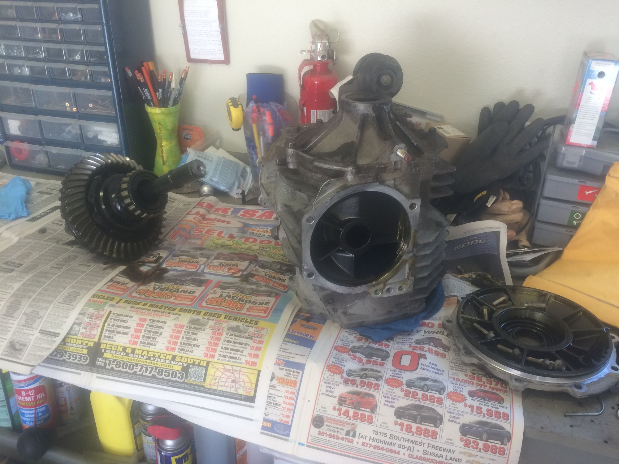

Making some headway again this weekend. Took off work yesterday to spend some time working on this project.
I got the clutch installed and torqued down.

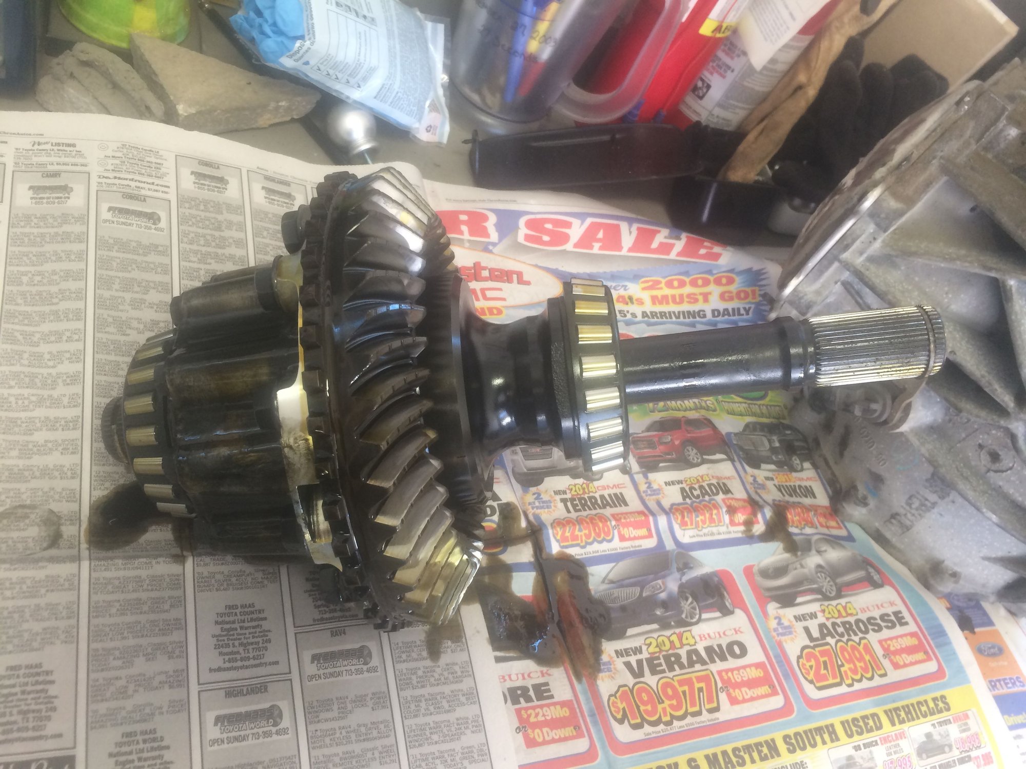

Got the rear diff removed and started putting the c6Z06 guts inside my housing. That was going really smooth, almost too smooth.

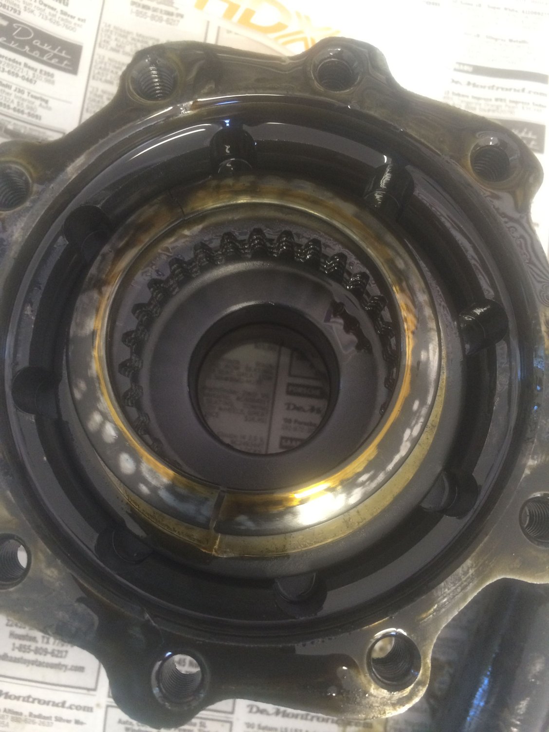

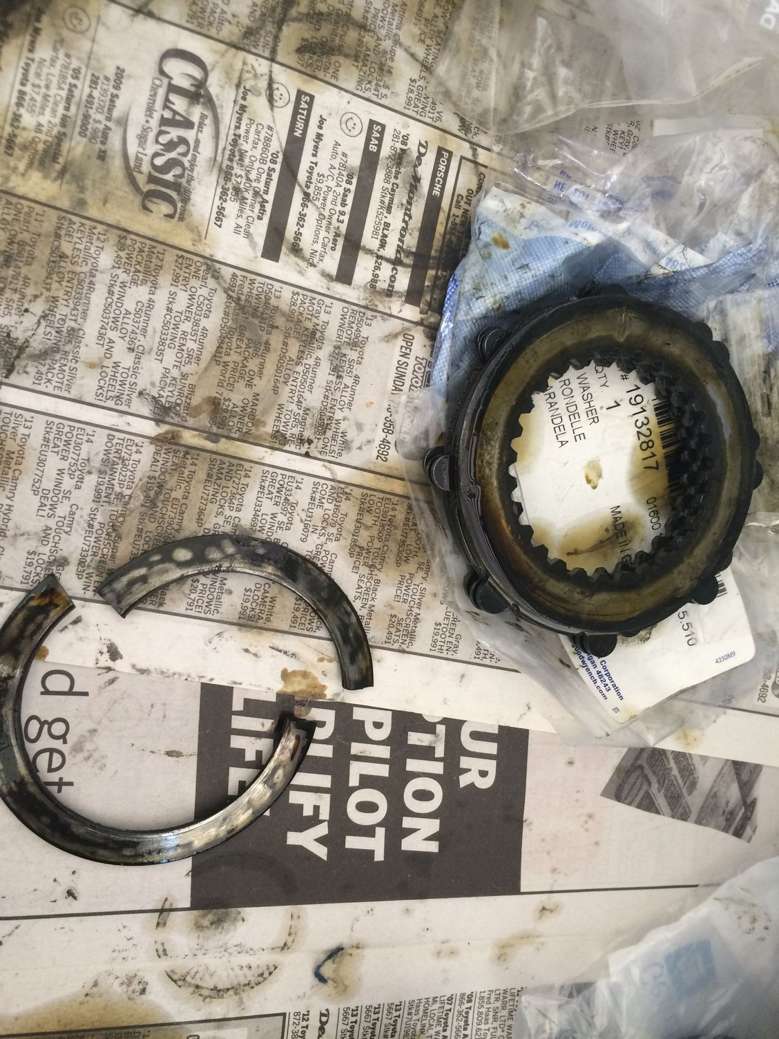

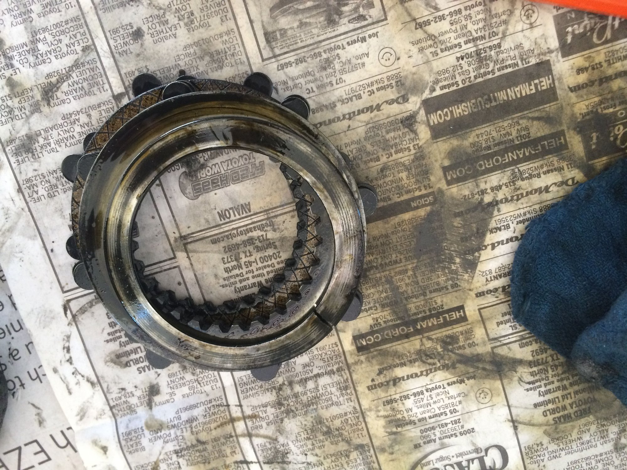

Here are some pictures of my broken bellview washers. Not good, but it was to be expected with the crappy stock ones and 100k miles. Clutches actually didnt look that bad, but i replaced them anyway since i already had new ones.
And then the highlight of my day, ready to reassemble and realized i was missing one retaining washer to put the short shaft back together. So now im on hold again waiting on a $7 washer.

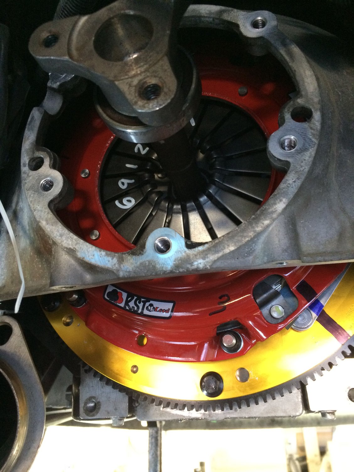

I also figured out why my clutch wasnt holding my NA power (396 rwhp). When i bought the car i was told it had an ls7 clutch. What i found was an ls6 clutch.
Yesterday, i installed my new b&m shifter on the TT while it was out and did the anti venom mod. That went well.

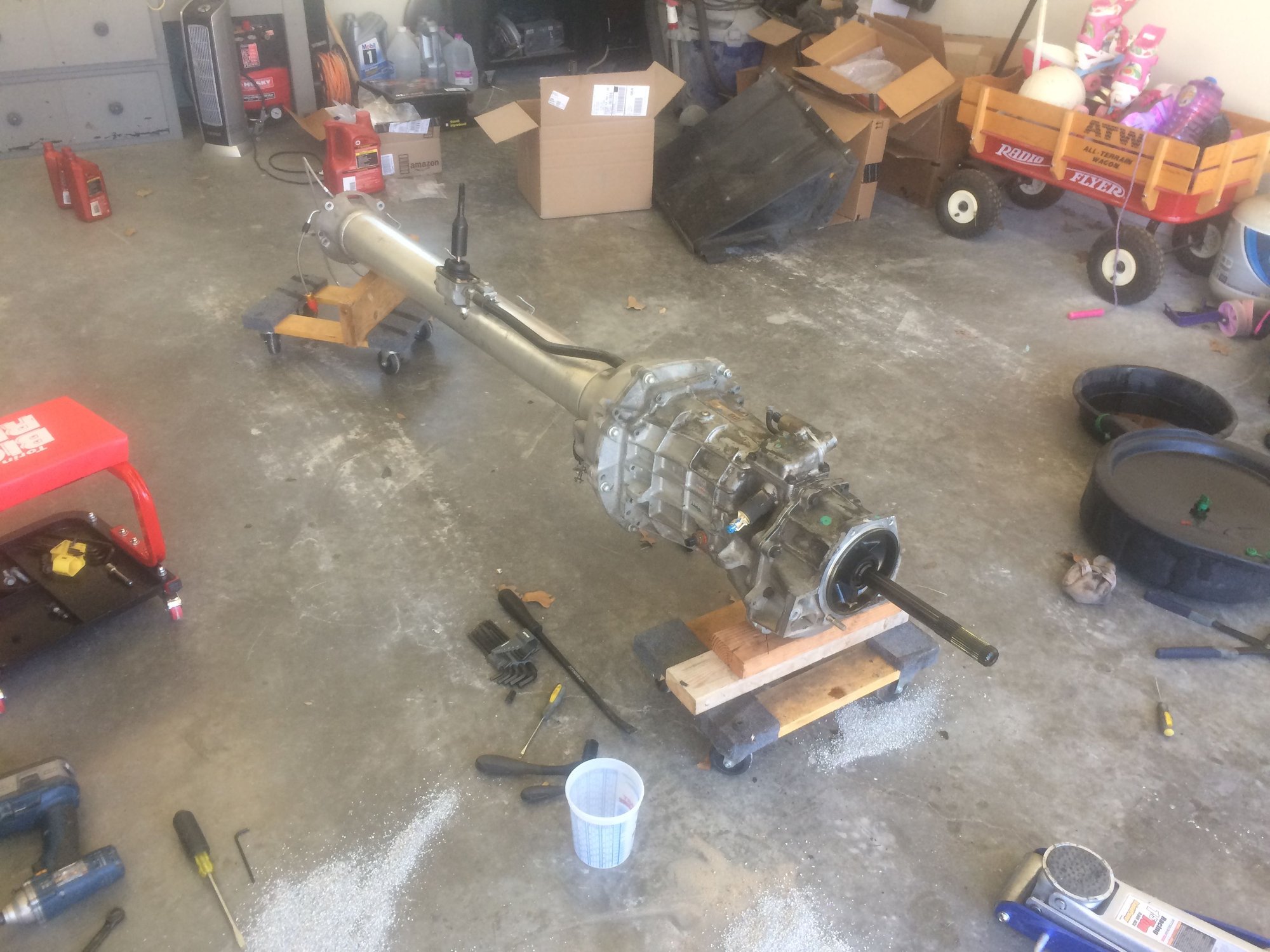

And then i went ahead and stabbed the tranny/torque tube. I figured it might be easier by myself to do just those so im wrestling less weight , then install the diff when im done with rebuilding it, and then the cradle.
Well i got it stabbed on my second attempt. Still a bitch working by your self, always needed 2 more hands. I left with bleeding knuckles, a bleeding nose and forehead and lots of cussing. The &^%$# c-clamp i was using to pull the TT to the bell housing fell and hit me in the face....twice.
