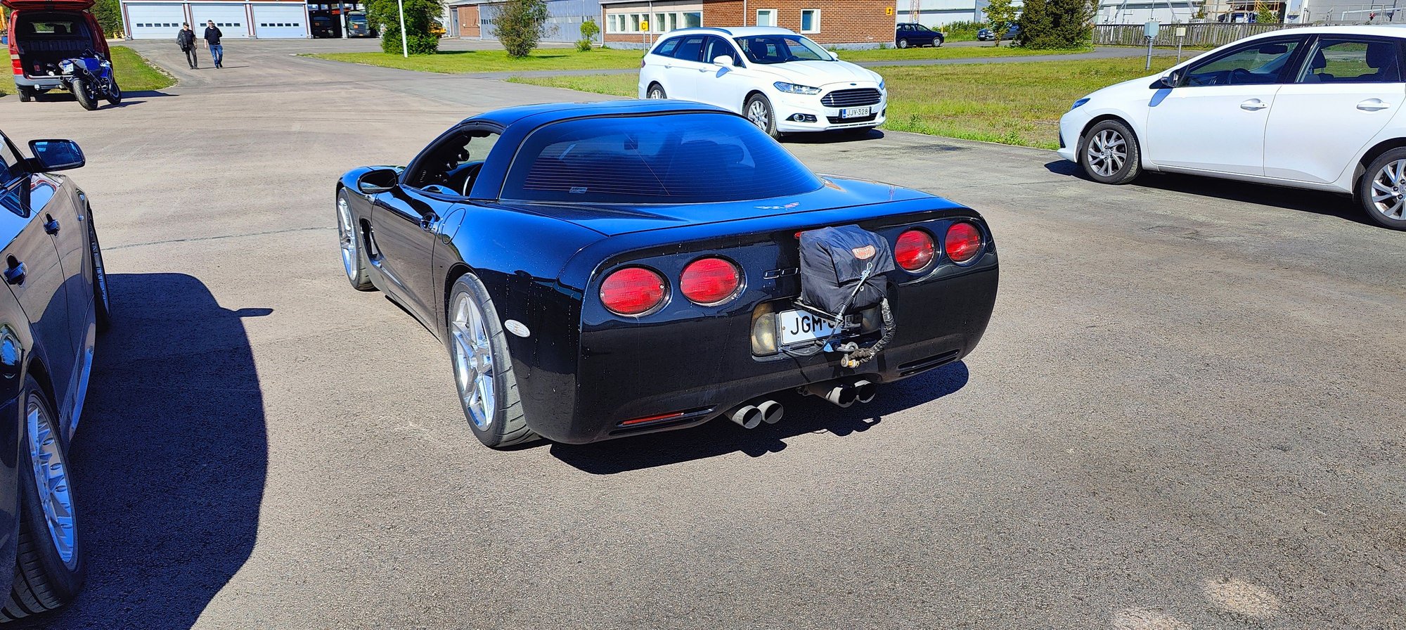

I have mounted under recister plate.
To Parachute
