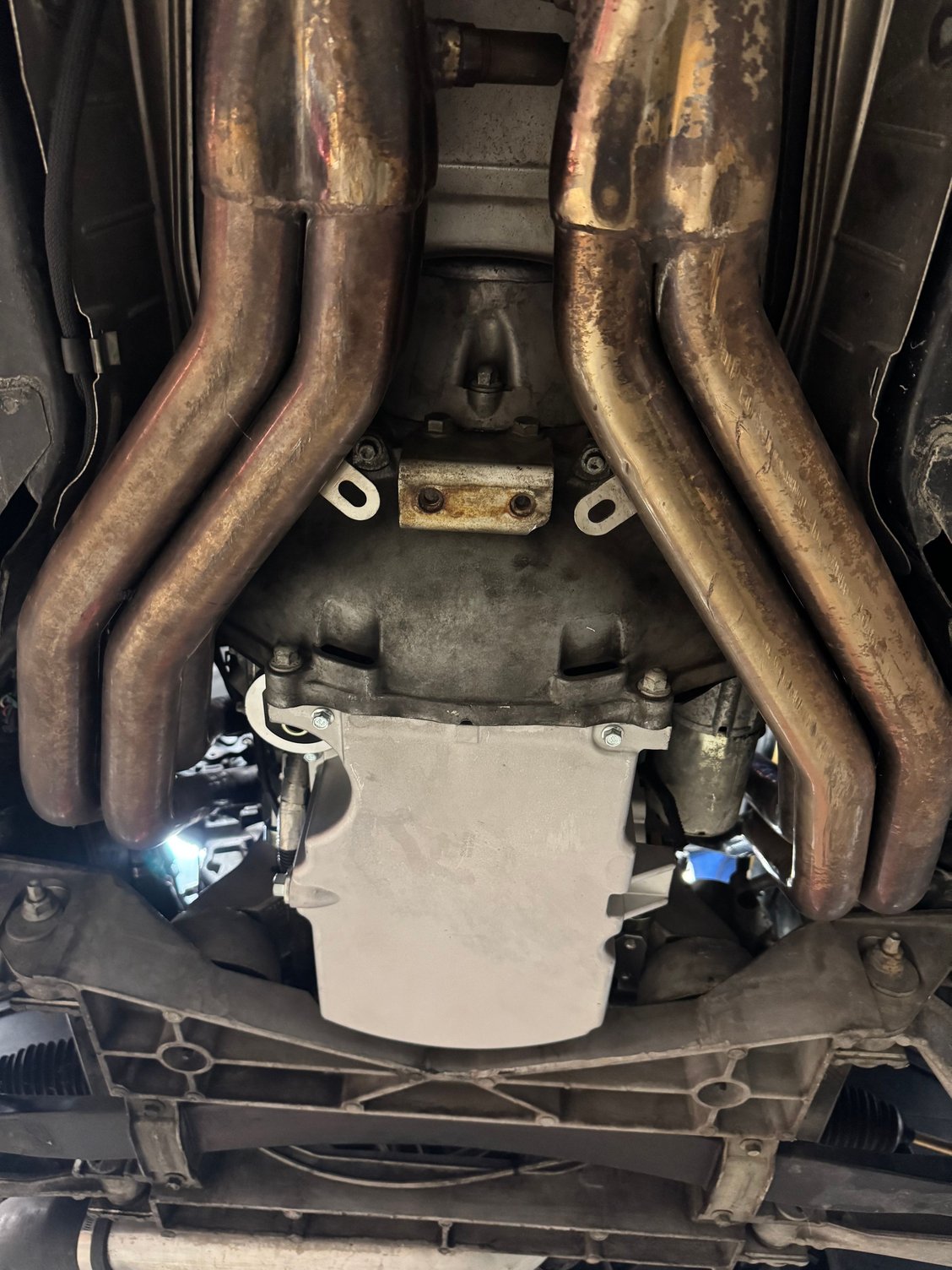

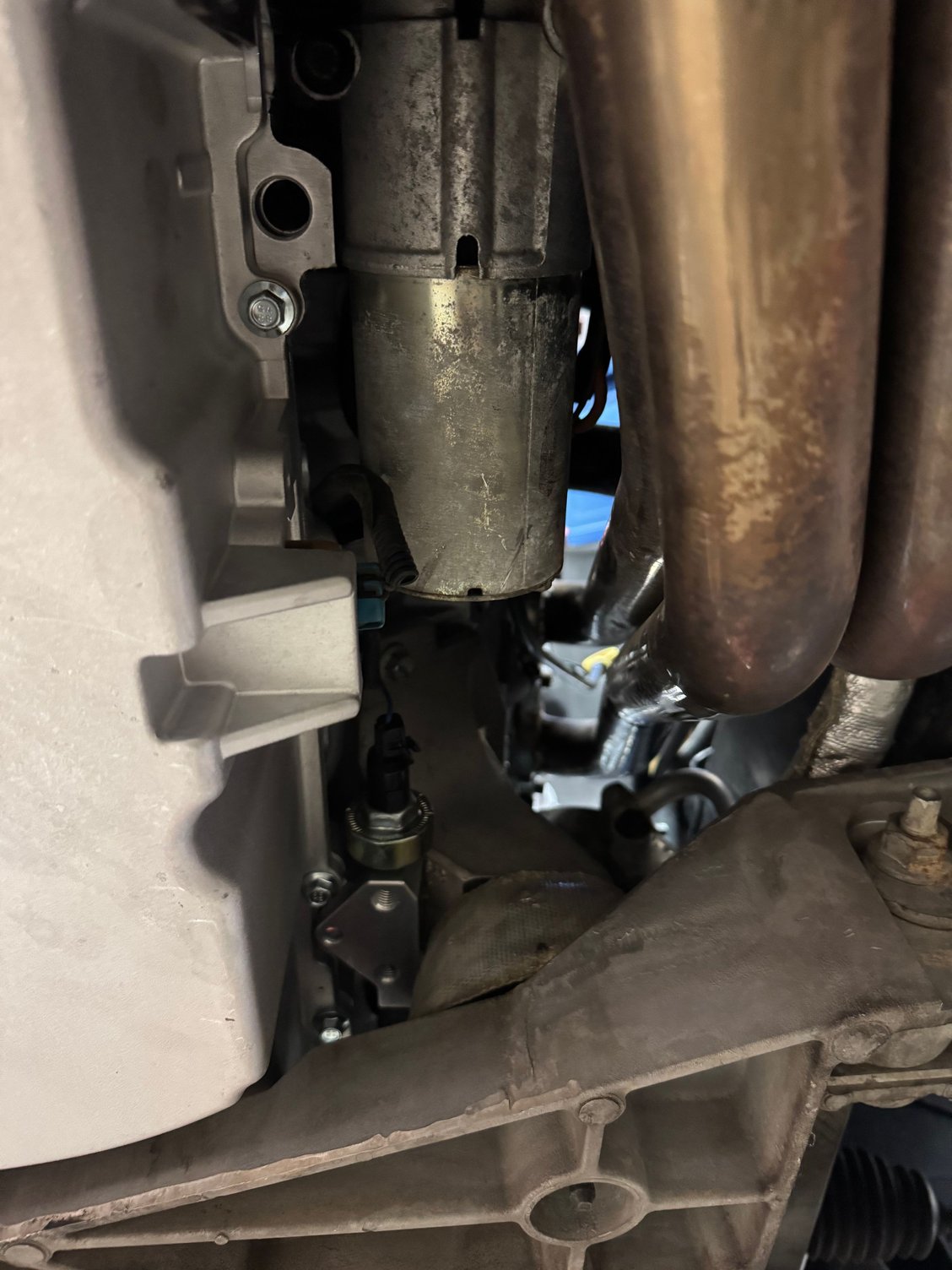

C6 pan installed. So much space.
Clearance
Clearance
Clearance
Clearance
Under shot with everything ready to go

Liking the remote knock sensors. I'm running the LS2 style right in the holes. Now I'm going turbo so I have yet to determine if they will work in their positions. Helpful to know remotes are available. The LS2 sensors I believe have a greater range. Though I am on Haltech ecu and can tune for specific ranges and avoid engine noise.
Double check that fuel level sender part number. A lot of companies have dumped C6 parts as C5 and there were some part replacement number changes made where the two units read opposite of one another for full.
Looking great! I want to hear it when it's done.
