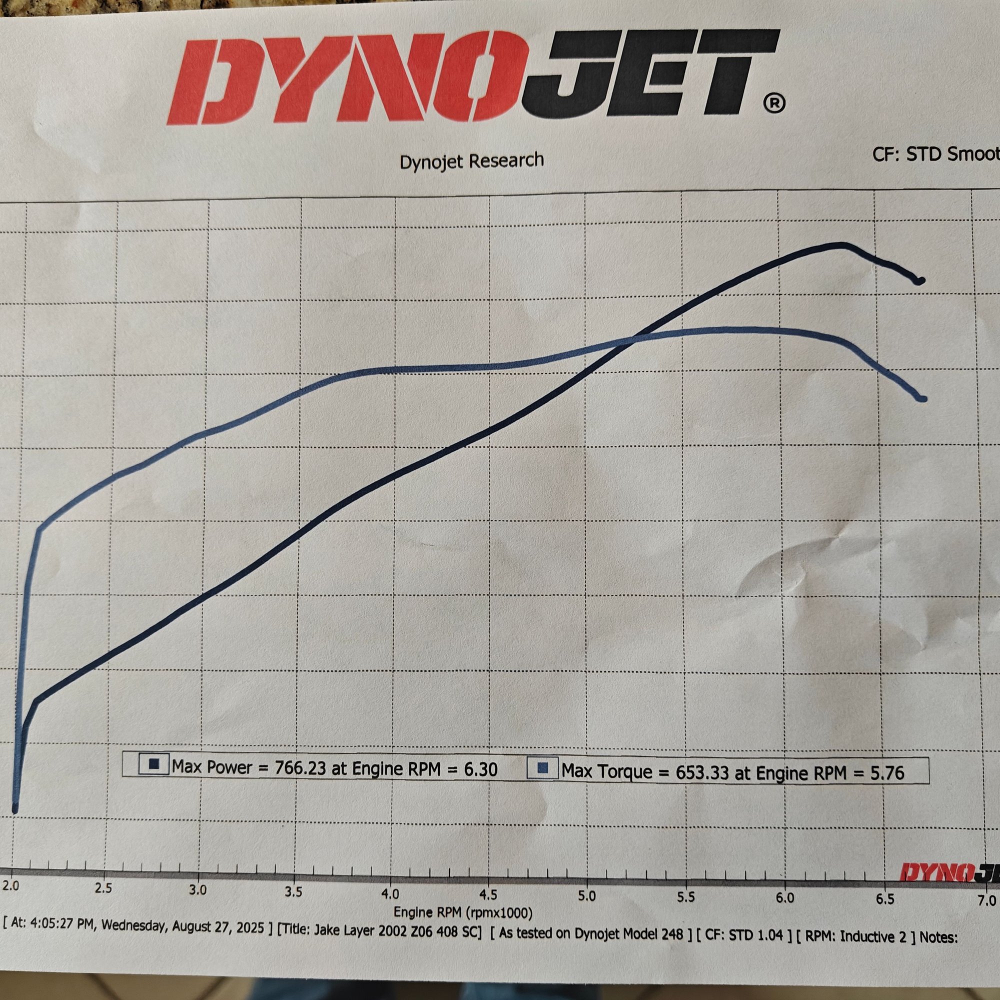

Well here's my update, probably not my last but it might be awhile. Just got to decide what I want to do.
First of all, got my final numbers today. Here's my graph. This run 11.2 psi was my peak boost.
766/653. You can see that I'm peaking at 6400 then falling off. Tuner thinks I still have belt slip. This run was on the 8 rib with an even smaller belt (889 vs 895). The 895 belt was slipping and wouldn't spin higher after 5000. No idea why it was slipping. They threw the smaller belt on and it took 2 hits for it to actually grab. Once it did, it maxed out with the above numbers.
What I'm questioning is that previously if you remember, the last Dyno, the belt snapped but it peaked at 11psi. This was on the 6 rib but with 2 belt sizes bigger (905). I'm now wondering if it's not belt slip but I'm justed maxed out on the unit. I'm going to contact ECS and see what they say
In the mean time, I'm ok with how the car is reacting, numbers and drivability. I'm not going to be at that rpm much so if the belt is slipping, I'll keep an eye on it and just change it when it looks wore out. Im not in the position to throw more money at this thing with a direct drive. And I don't even know if I need it. The Novi maybe the problem here with the 3.25 pulley on it.
So there it is. The car is 98% done as far as I'm concerned. I'm just ready to drive it and enjoy it.
Hammering it 3rd is nuts and the torque pull is beyond undescribable.
Thanks to all that have been following along. 😎
