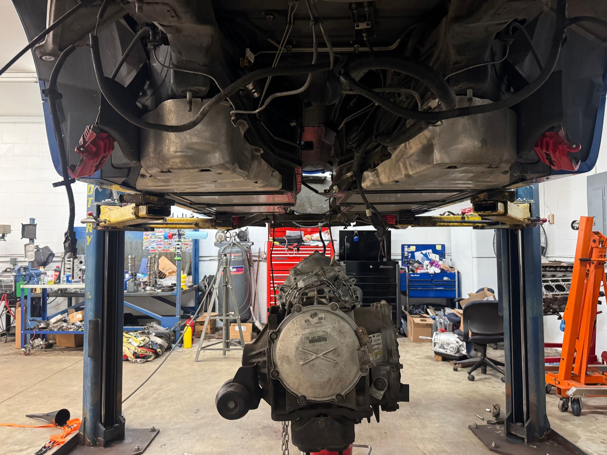

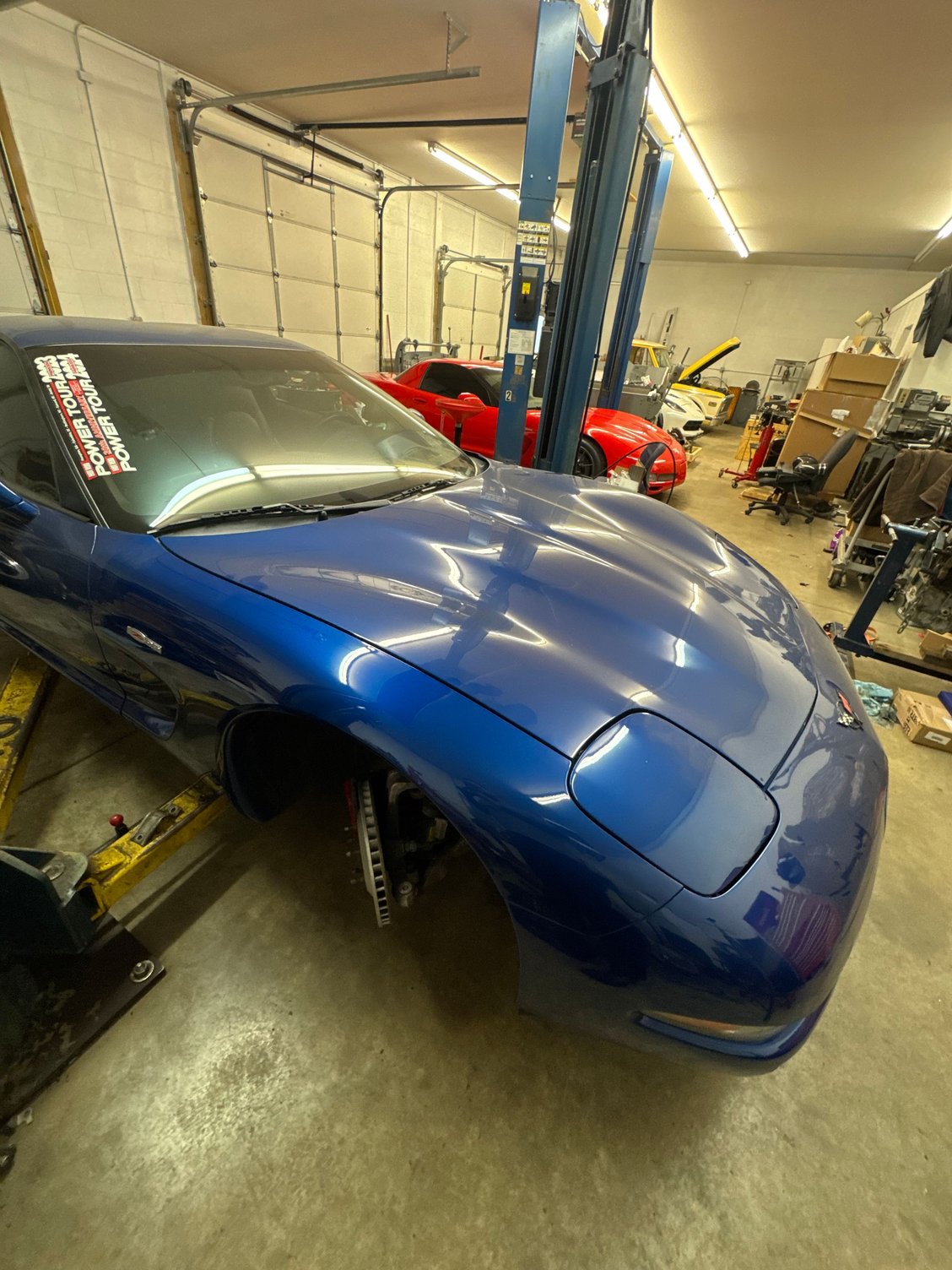

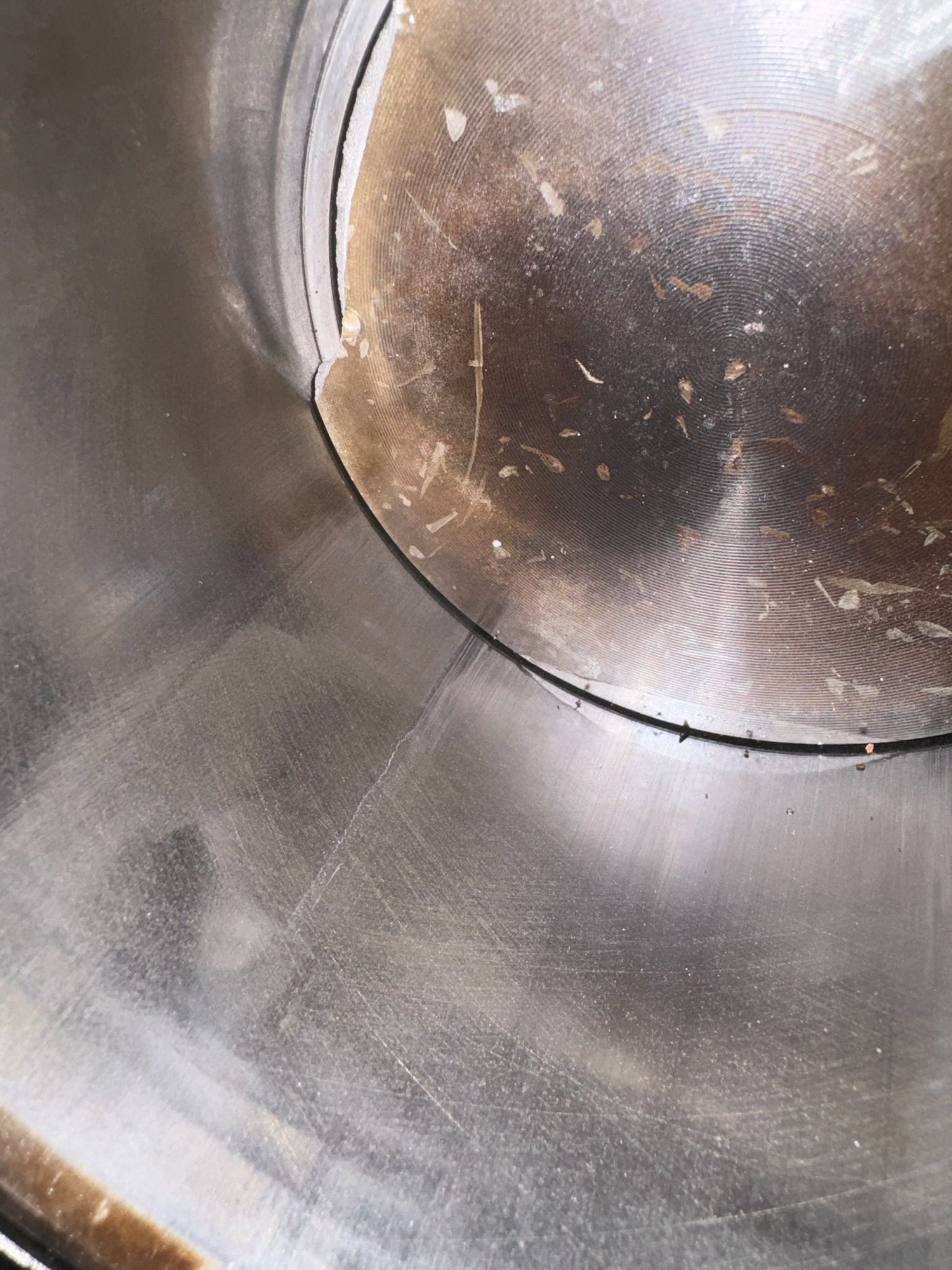

Back in June, me and my wife started the journey towards Bowling Green for the HRPT. We've now made it a yearly thing to do as long haulers. It's part of the year I truly get to appreciate the car for what it's worth. My setup was just a stock LS6 block, custom cam, ECS Novi 2000 around 9 psi, FIC 85#, and Walbro 350 in tank with hotwire and BAP. Nothing wild, it dynoed 605/595 after the cam swap.
First day of HRPT, we drove 3-4 laps on the track in bowling green. Drove it pretty hard but nothing over the top. Everything seemed fine afterwards and on to the next day. Decided to see what it could do on the quarter mile. Hit rev limiter pretty hard at the top of second, pulled third pretty well but as I went into fourth, the ENG light started flashing. As soon as I came down to idle on the pit road, I heard knocking. Oil pressure was still good so I called in someone to diagnose while in the lots. Compression on 5 and 7 were 85 psi. Loaded on the trailer and took it to where it sits at the shop. I attached a video of the run and also another video of a burnout in another car we grabbed to finish the HRPT in.
I knew this day would come eventually. Timing wasn't great. So for about 3-4 months I started looking at what options were available for a rebuild. After getting the block out we found a crack in the cylinder on 5 and a nice big chunk missing in the piston. Lucky the heads were ok.
​​​​​I really wanted to keep the LS6 in the car but it was going to cost more to get it resleeved and forged. After talking with some LS industry guys I know, I decided on a LS3 block. However, at the time I was ready to purchase, they were on nationwide backorder.
I proceeded to call Thompson's Motorsports and asked what they had available if anything. They actually had a 6.0 aluminum LS2 block available which I green lighted. Here are the specs I ended up with.

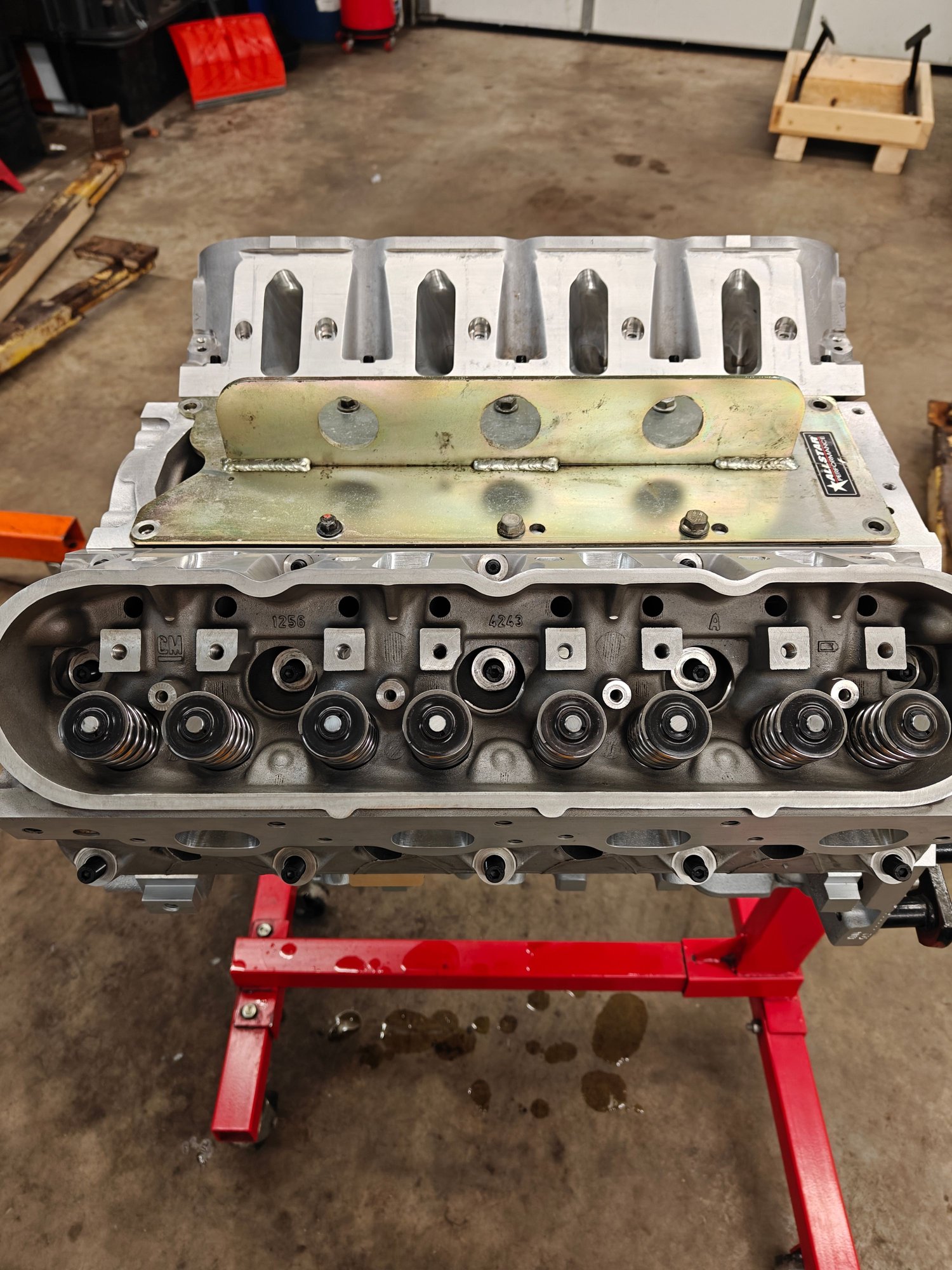

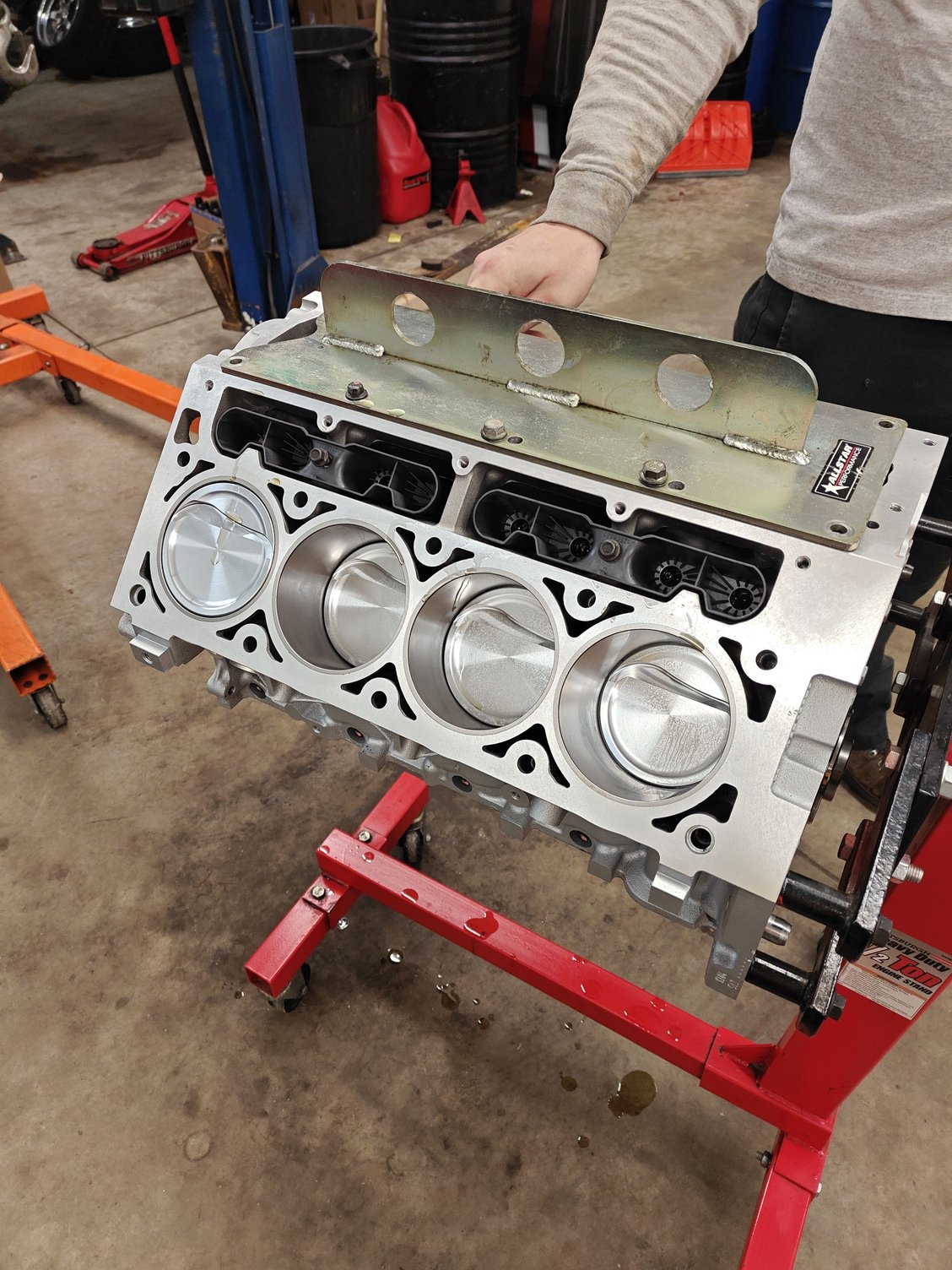

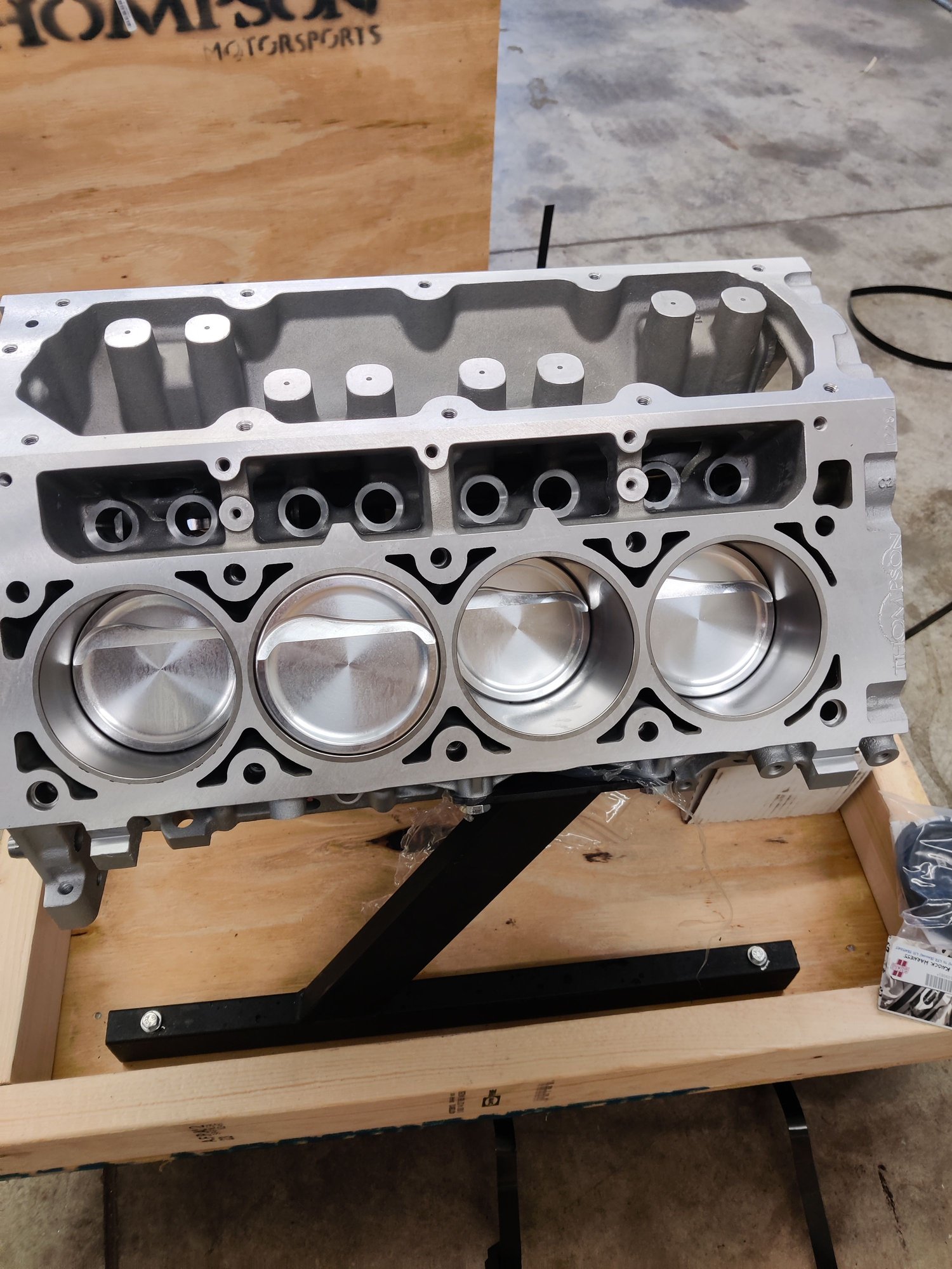

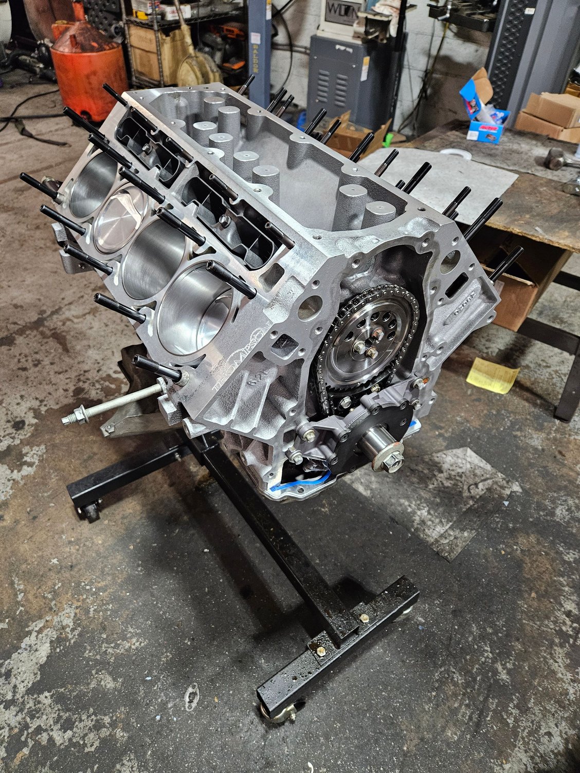

Block arrived about 3 weeks ago...
Heads and cam showed up yesterday....
That's where I'm at right now. I'll keep updating with more progress in the next couple of weeks.

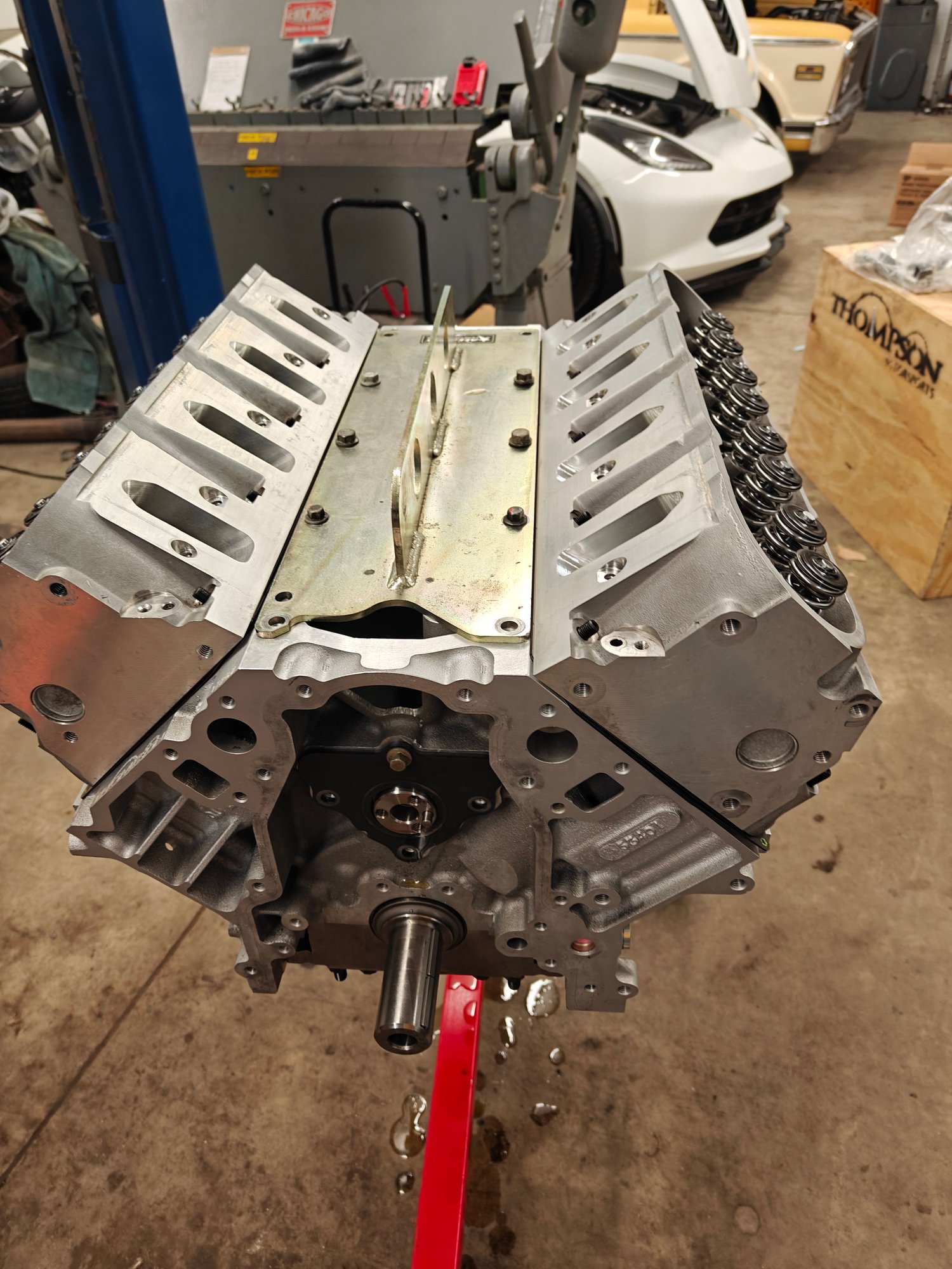

Finally getting around to start assembly and installing the block. I've been held up at home with building my kids quads for this season so garage space is limited. I told my builder I should have room to get it back in 3 weeks.
I ran up to his shop yesterday and helped with assembling some. Hopefully we will have the block back in at the end of this week.

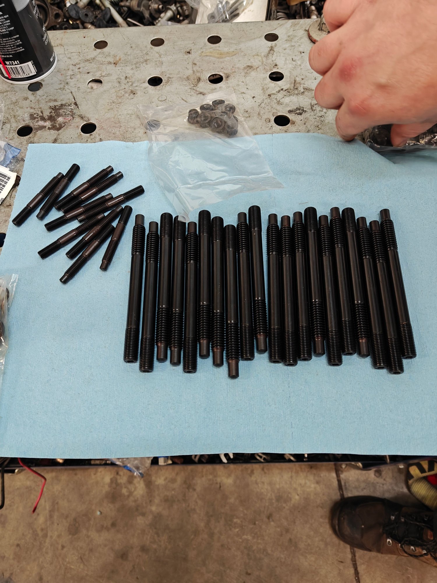

Arp studs getting prepped

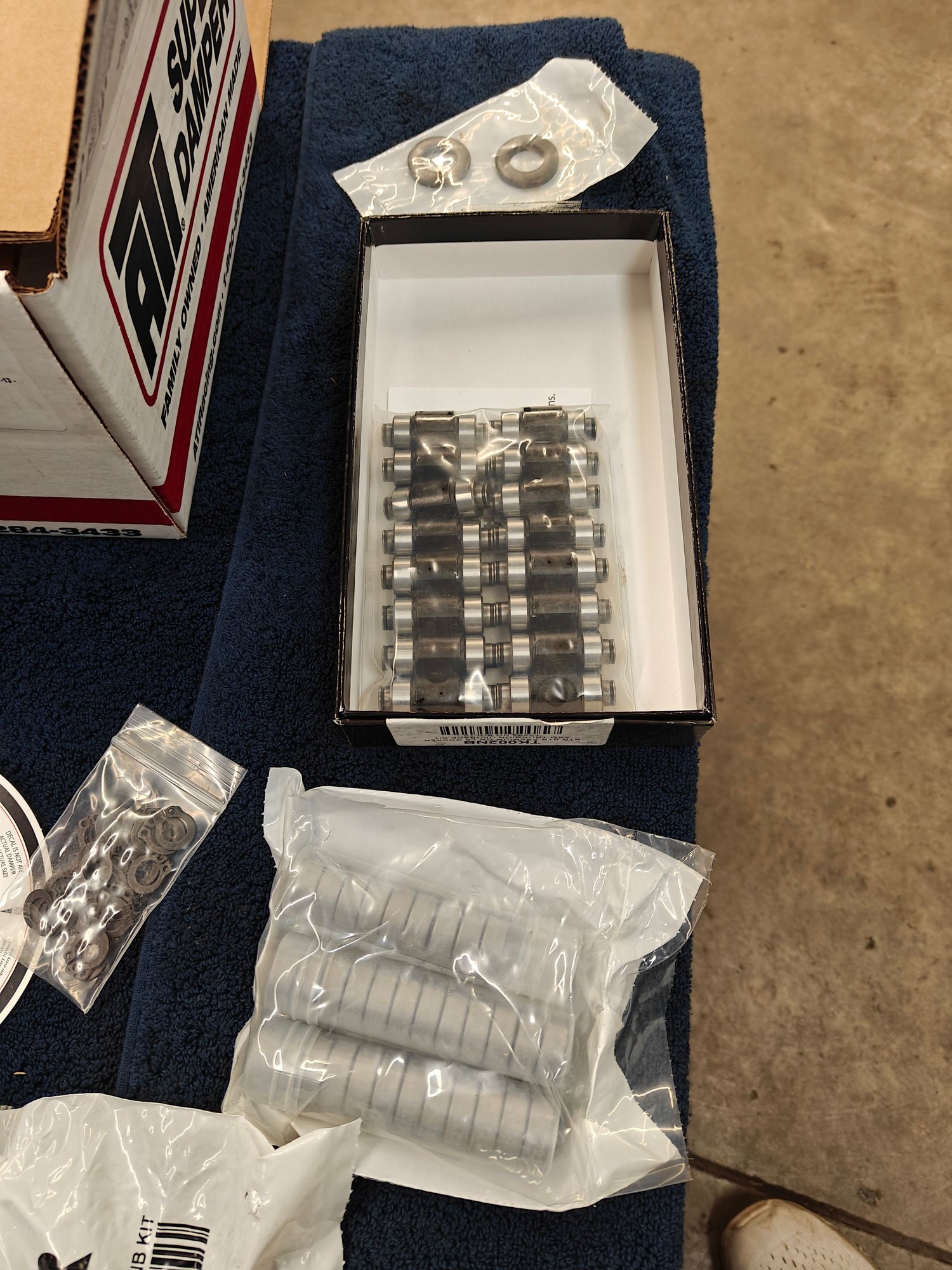

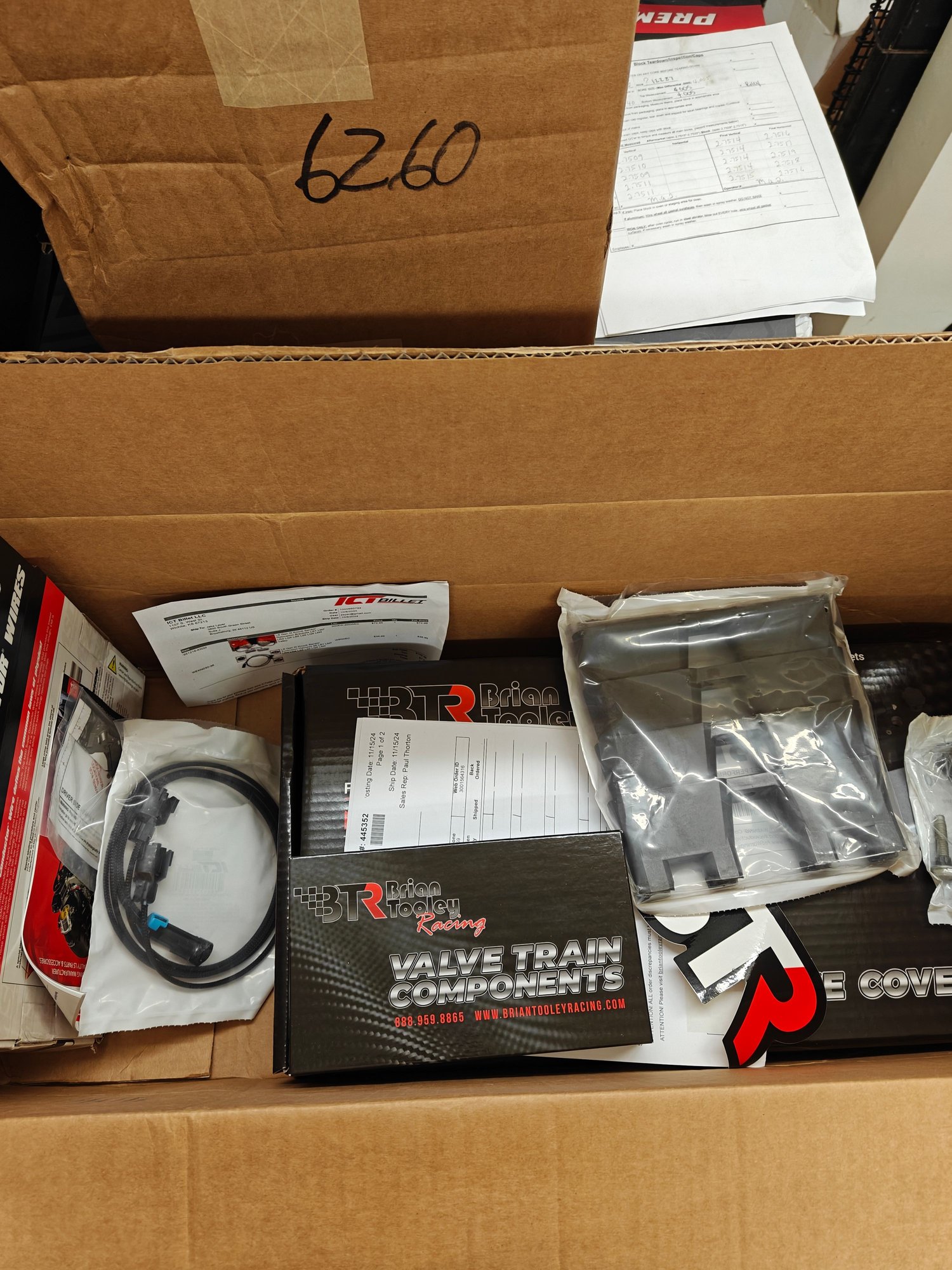

BTR reunion kit for rockers
BTR trunion kit for rockers
Installed
Installed

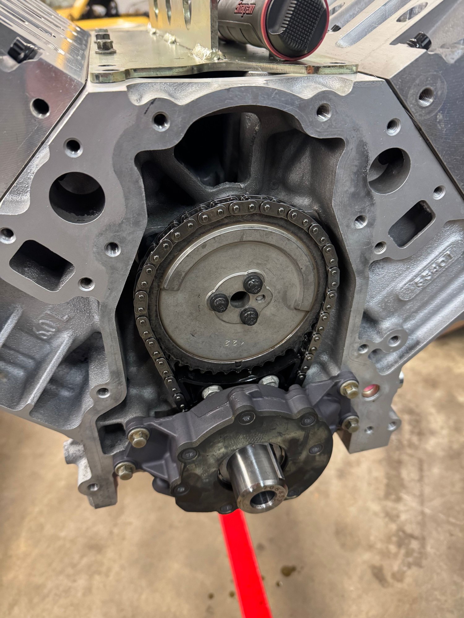

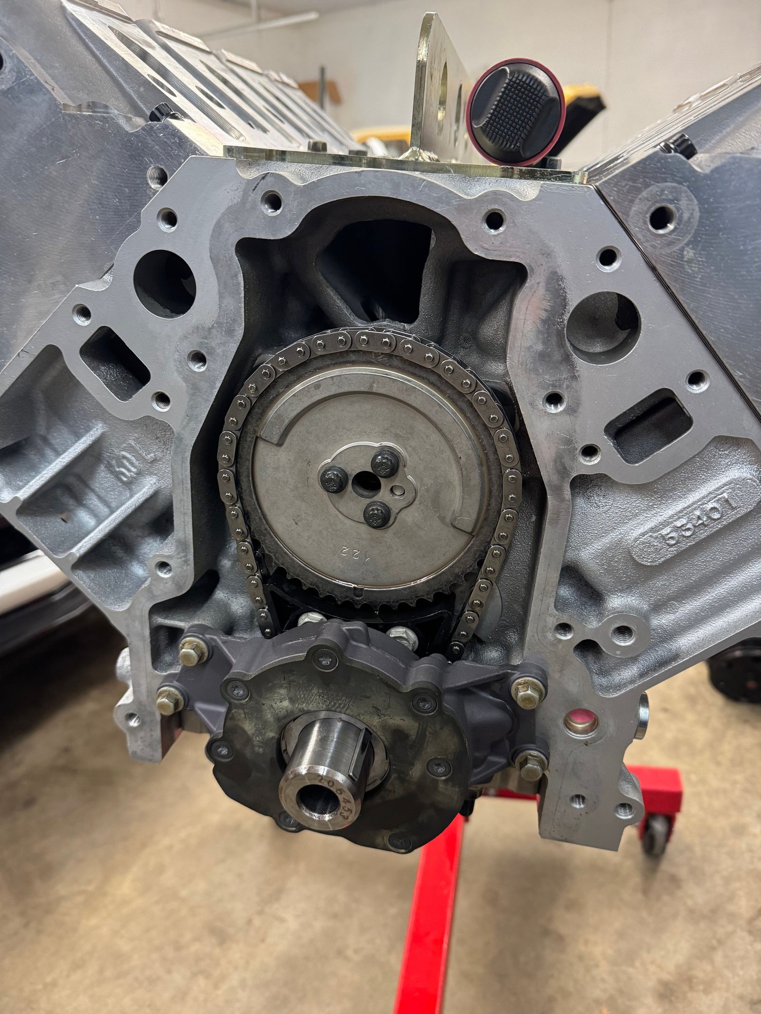

Cam gear and oil pump on

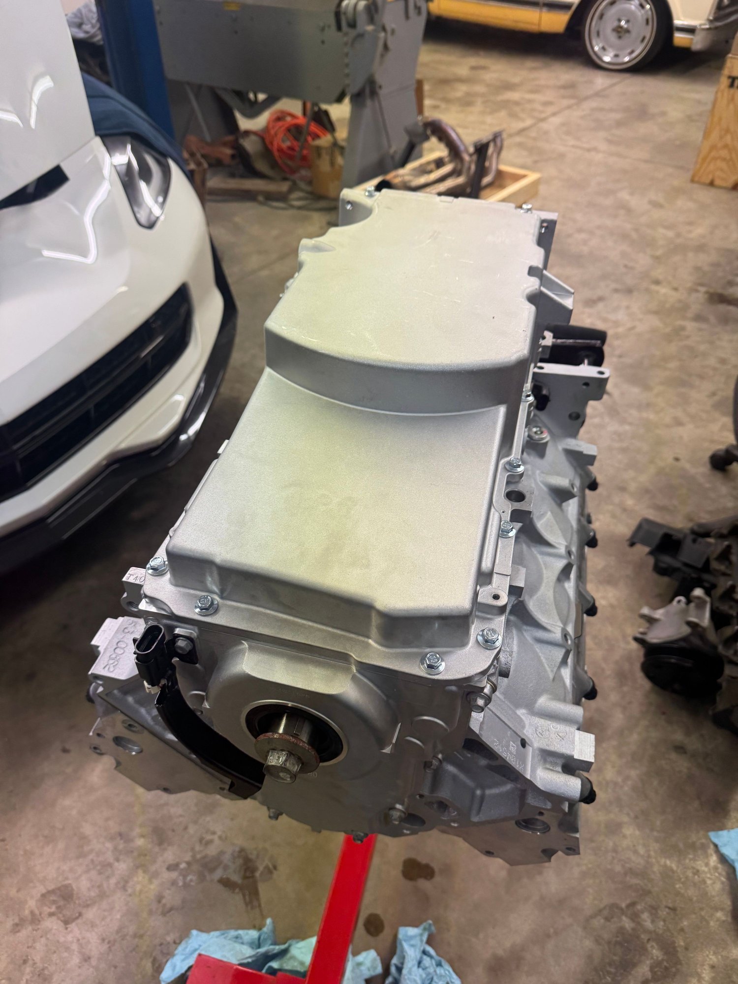

C6 oil pan on
C6 oil pan on

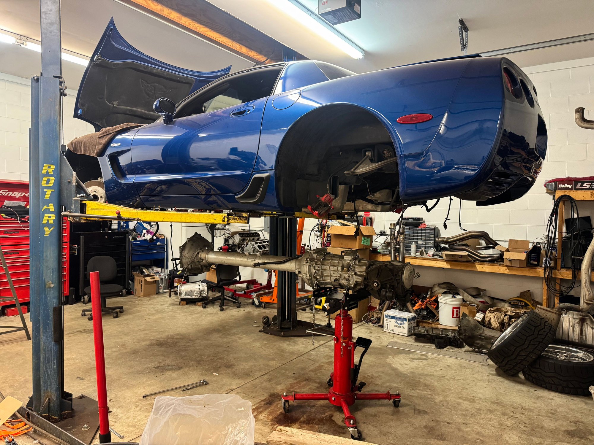

Torque tube rebuilt
Torque tube rebuilt

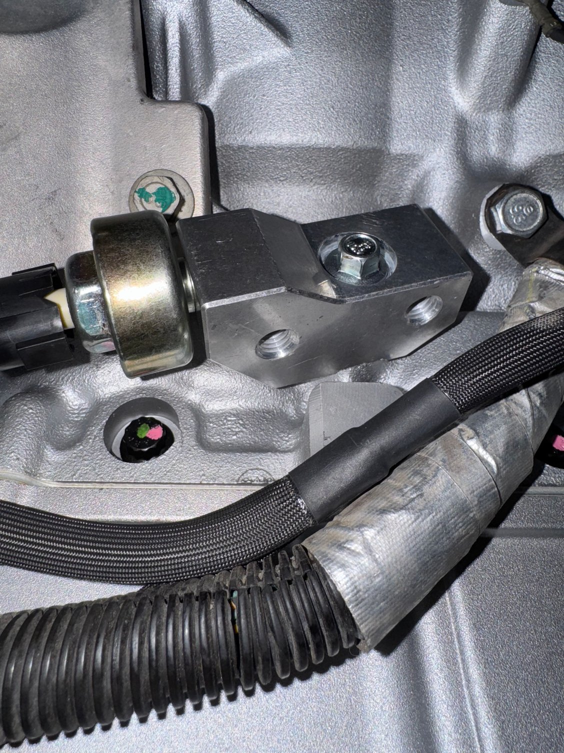

ICT relocation sensors. Had to machine a little to get it to fit on the LS2 block.

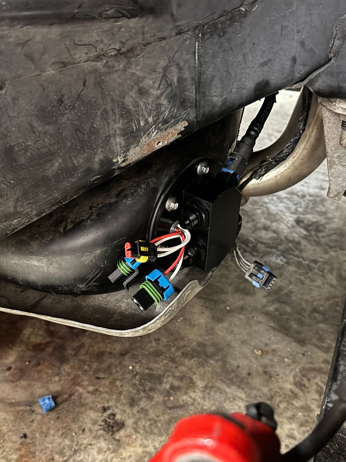

Chris1313 dual 450s installed

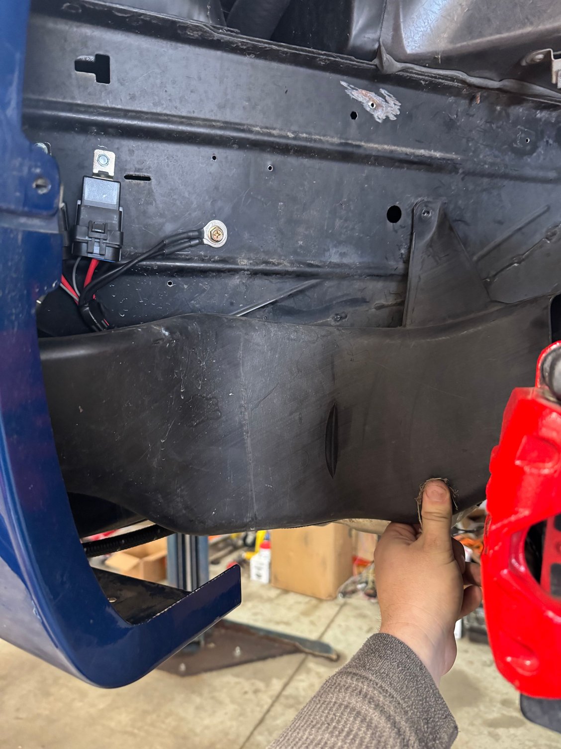

Brake duct fits.
Brake duct fits.

Another shot of the knock sensor

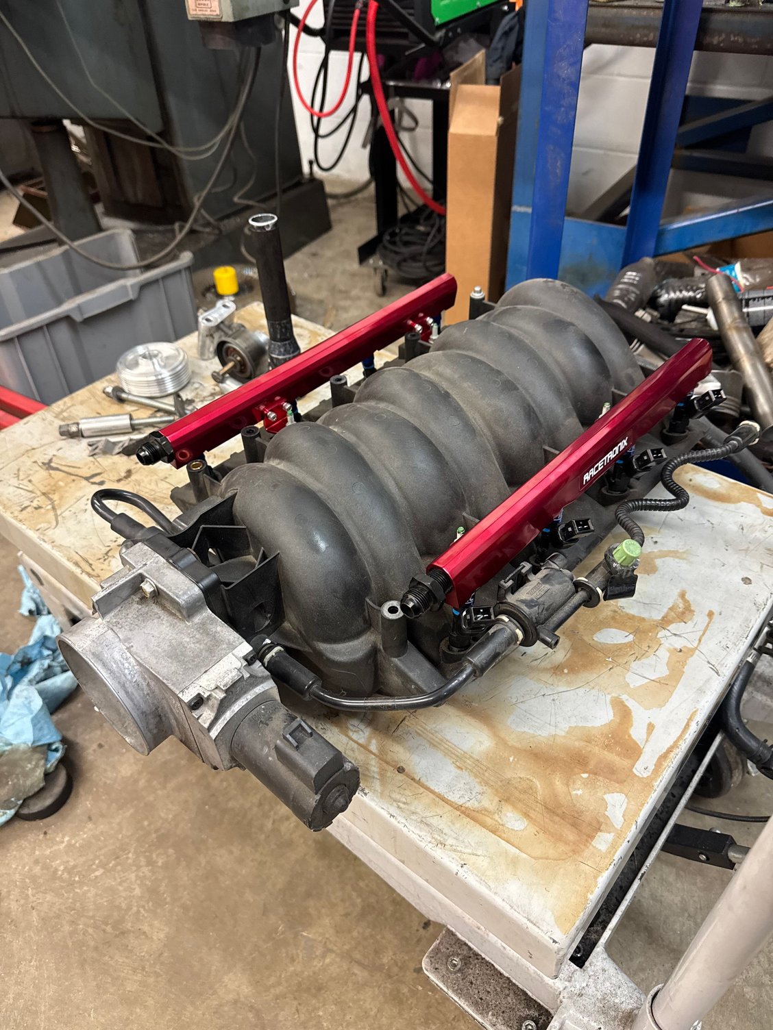

Racetronix fuel rails on stock TB on the LS6 intake.
