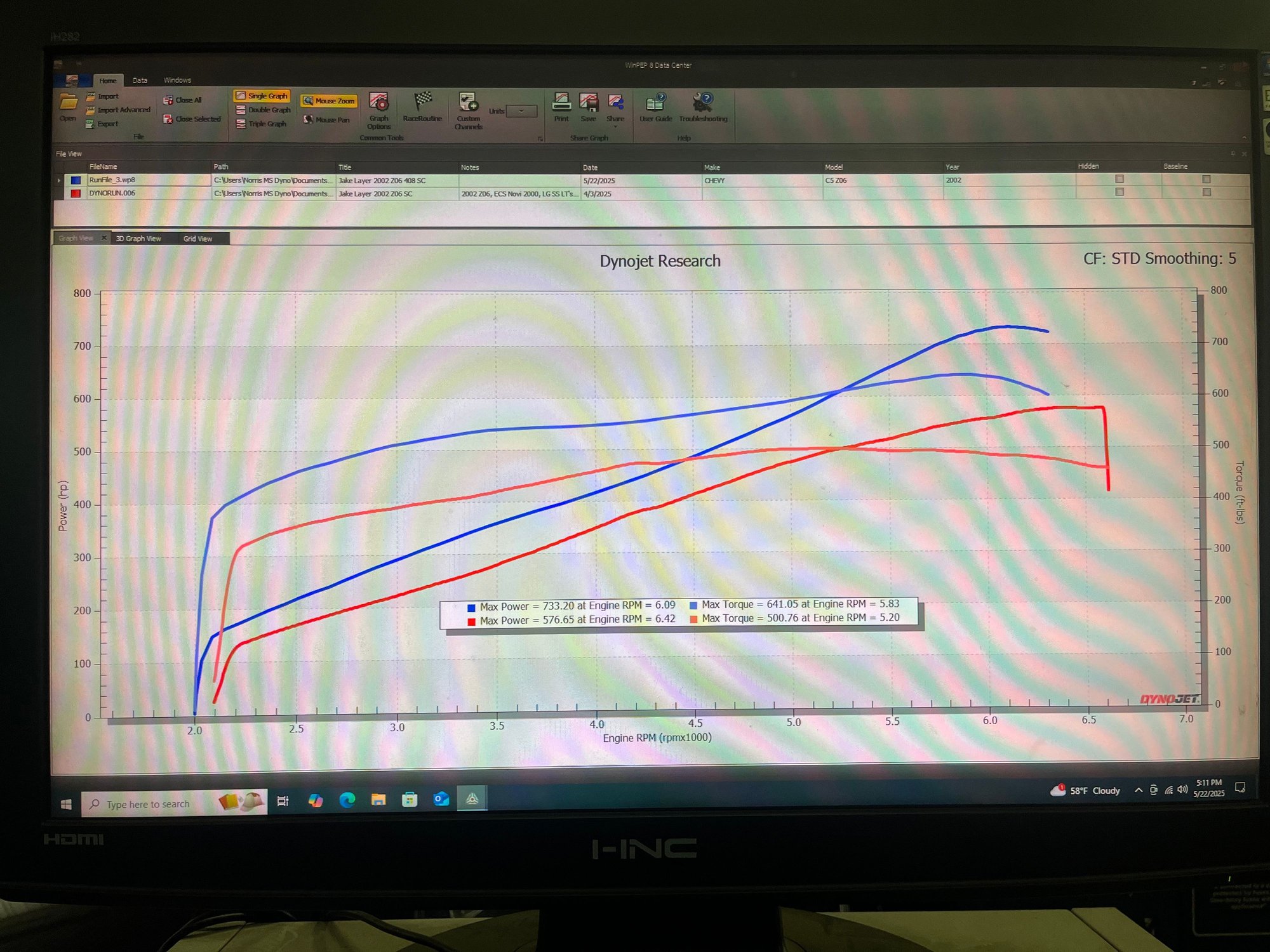

Its at the tuner this week hoping that he can get it on the Dyno.
Anyone want to take a guess at numbers while we wait?
Hoping for 700-710hp/680-690tq

700/700

So sorta final numbers are in. There's still a little tuning left to be done but since timing was not optional for me and the tuner, it'll have to wait a little bit longer for final numbers
However it's pretty dialed in on the SD tune. It blew a belt at 6300 on the last pull (that was my fault, I had a old belt on it) but it was still pulling. He said it showed 11 psi and threw down 733/641 at that point.
I have a graph but it's not the best but overall pretty stoked about those numbers especially on pump gas.
The car should be very drivable for me for the HRPT coming up in 2 weeks. I'll try to get it back to the tuner after to complete what's left which is cold start settings. Hopefully imwe can give it another shot. Need to find a green belt as I'm still on 6 rib at the moment.

Commendable. And on a 6 rib. I saw that Gates had the RPM line of belts available again. Prior to the covid changeover they used to be pretty tight. Not much flex. I have yet to hear experience from anyone running the newly released line though.
That's more power than I've driven before. Let us know your real world experiences with it.

Sucks about the belt but you gotta be pretty happy w those numbers on 93. Congrats!
