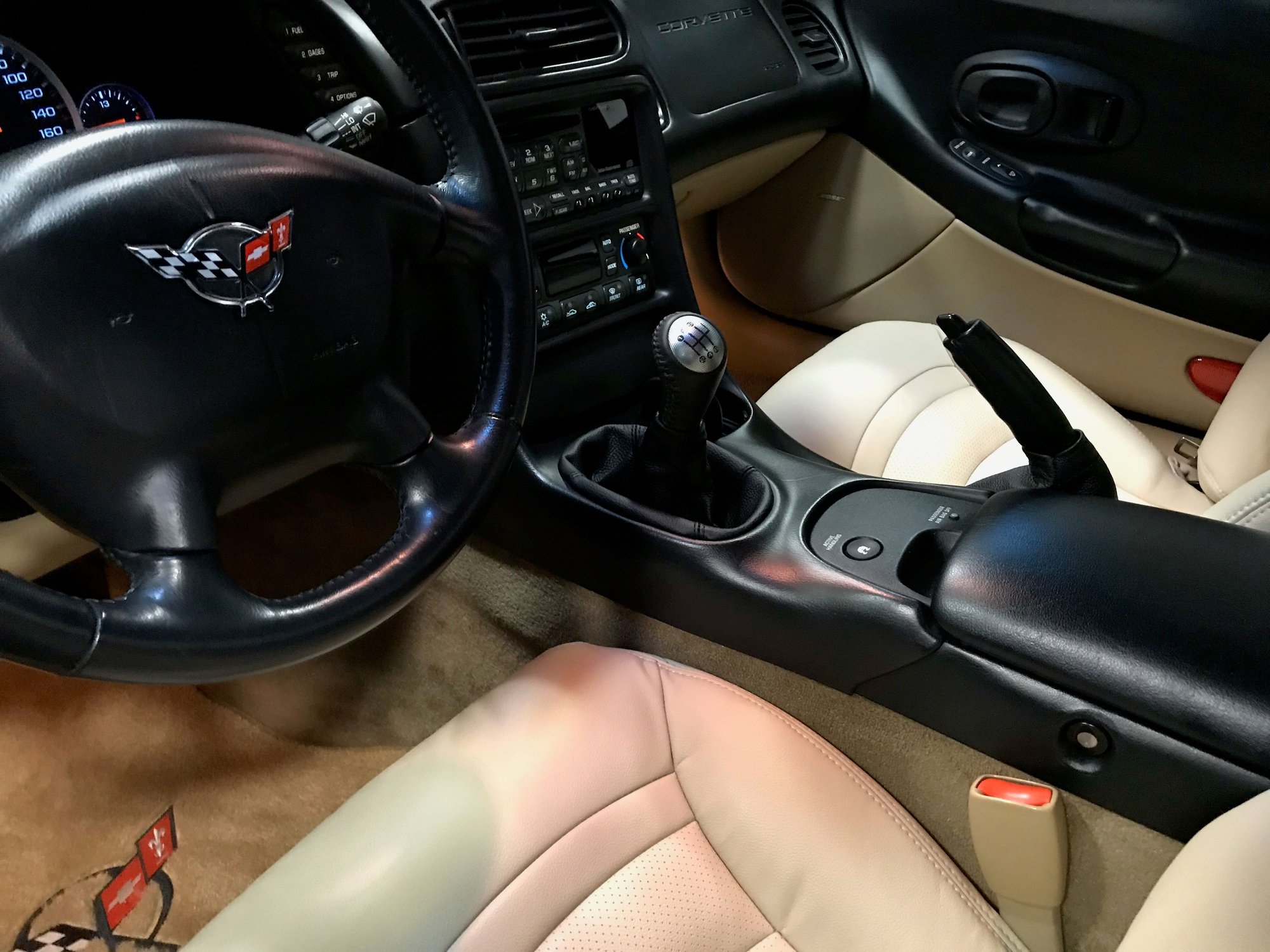

I am so pleased with the addition of the C6 shifter to my C5 Vert. Finally, the car shifts like I always wanted. Banging gears comes quick, smooth and predictable - way more fun now! The shifter position is fantastic. I was always disappointed that the wife's Mustang was more fun to drive. No longer - Gear Jammin' is now a blast in the Vette, too!

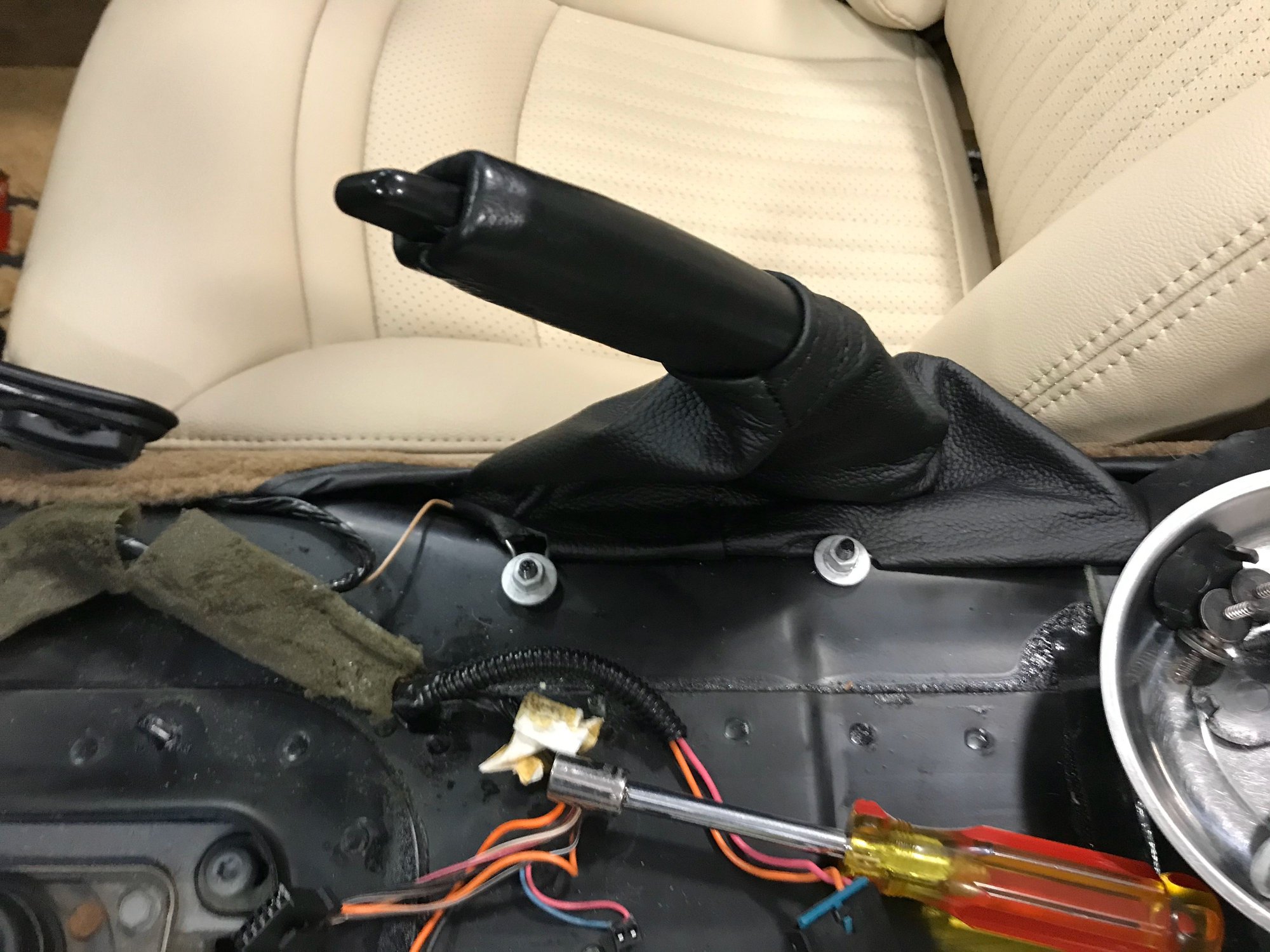

Also, the Redlinegoods leather for the e-brake and shifter are a perfect fit. The fit and finish is OE perfect. A bit of superglue and patience swapped over the original clip and wire to the new leather - highly recommended.
I can't say enough about how much enjoyment this upgrade (along with the Anti-Venom mod) has added to my C5 Corvette Experience.
Cheers from St. Louis!
Super-glue gel makes it fit perfect on the original GM plastic clip.
I cut the wire in half on the opposite side of the original e-brake boot and threaded it into the new Leather one.
