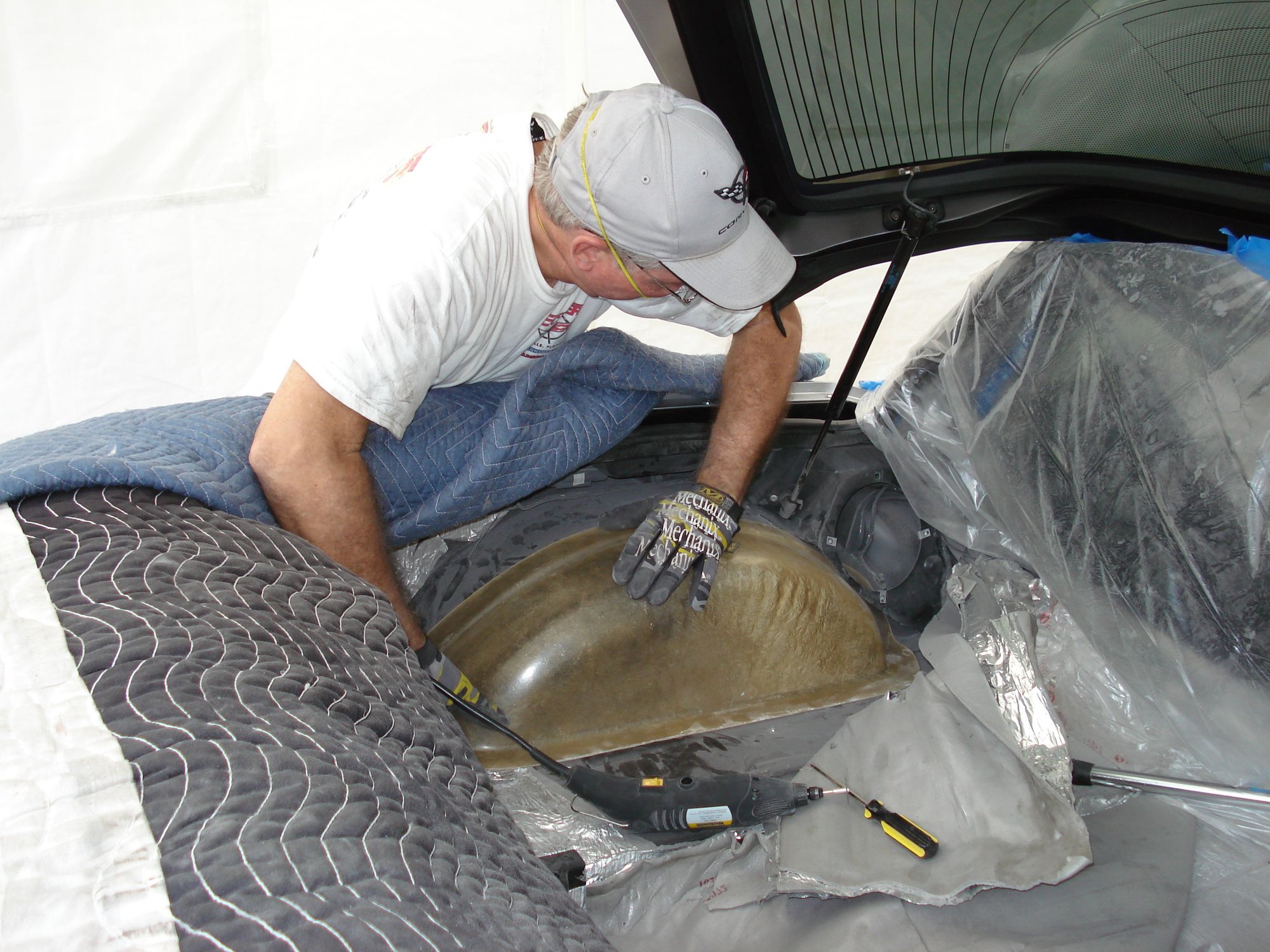

Originally Posted by flynbya2
It's mostly fiberglass work and hidden by carpeting. If you can wield a wrench, tape measure and aren't afraid of glass work and are a hands on guy,you should be able to pull it off.
Vadered from archives:
http://teamzr1.com/tubC5.html
That's the ticket. Much cheaper than flares,and you get the same
result more room for the meat. Good luck.

..its not a big deal ...after you make the first CUT!
I used the Lingenfelter kit. It comes with the inner wheel extender
and the replacement wheel liner for the wider wheel well...
Have a great time doing too!

here some of my mini tubbed
I did very similar process as this link http://teamzr1.com/tubC5.html, very good DIY write up, great stuff
doesn't cost much but its very time consuming but you learn alot
i have fender flares on now too, i would probably fit 400 wide tires haha
