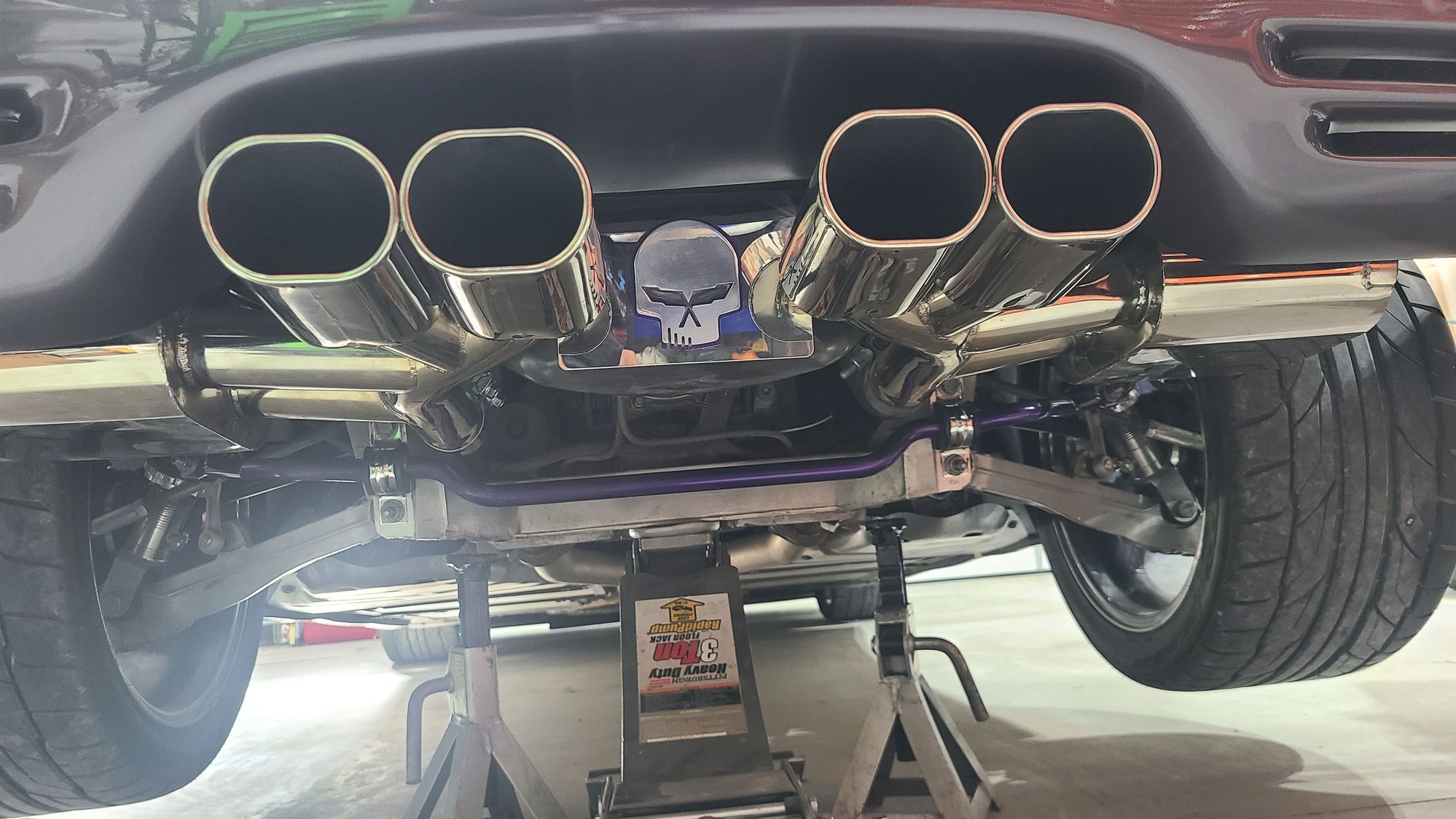

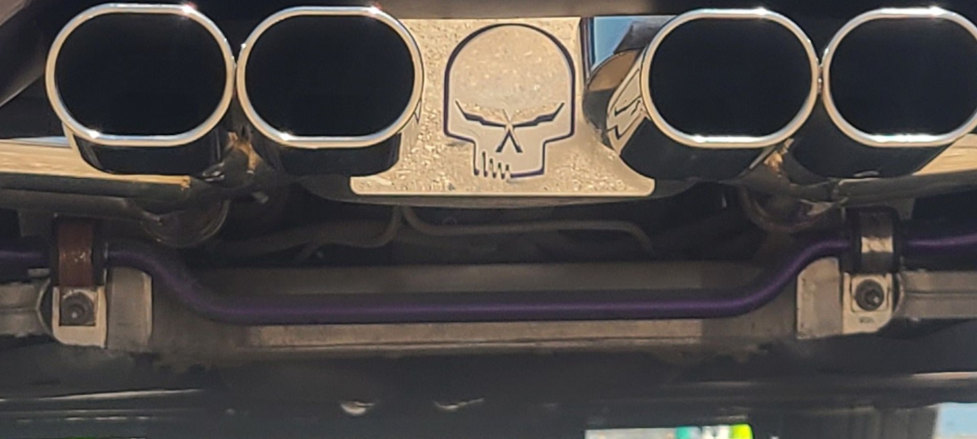

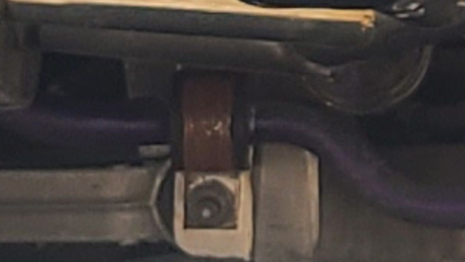

A week ago today I was at a car show and while sitting behind the car, I noticed the sway bar clamp on the drivers side has a lot of rust/corrosion on it compared to the passenger side. Today I finally had a chance to look at it and do something about it. From what I can gather and also looking at the sway bar, I have a slight exhaust leak that's blowing moisture on it and the clamp. I addressed the rust today on the clamp but didn't have time to look into the leak. I think I may need to get a good 2.5" clamp and see if that gets it to cinch down better. My other thought is, do I keep these clamps for the sway bar polished or do I paint them and not worry about them anymore?

nice job polishing the swaybar bushing retainers...maybe clear coat them to help prevent rust forming on them...btw...it looks like you beat the retainer with a hammer...looks dented a bit?
They are cheap to replace...just a suggestion since we both know you are the slightest bit ****...

Thanks 😎👍 I am a bit **** with things. I will see how the leak repair goes before I try the clear or paint route. I haven't touched them with anything other then the polisher from what I can recall. They are what came on the car I believe when I bought it. I'll have a closer look at them when I get time too.

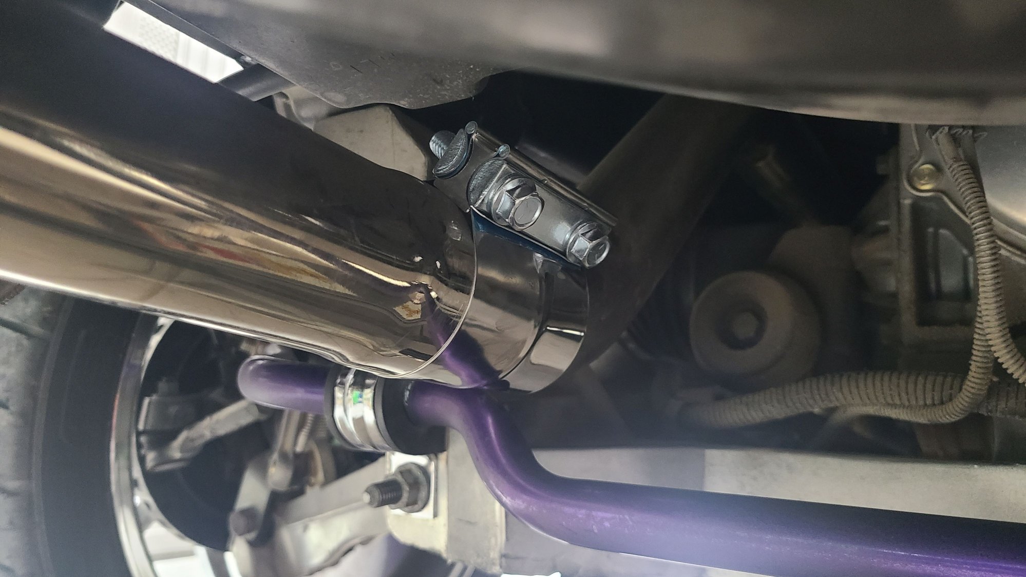

Got the clamp changed out. If it works I'll change the other side too to make them the same. I got a stainless 2.5" I.D. x 2.5" O.D. step clamp with 2 bolts. We shall see how it is when the car comes out on the 15th for an all Corvette show in Lincoln. I also got the center stainless plate cleaned up as well. It had a dull spot on it too. The cradle and the sway bar cleaned up easily too.
I'm not sure how good these clamps are but I'm willing to give it a shot.

The new clamps look similar to the clamps I used to replace the original clamps that came with my B&B Route 66 Quad Oval exhaust on my Red 98.
Like you I noticed a slight exhaust leak and contacted B&B. This was back in 2005 when I had a Red 98 for a short while. B&B customer service was great and shipped me a new set of clamps immediately but instead I purchased a set of clamps similar to yours and they cinched down much better, problem was solved.
