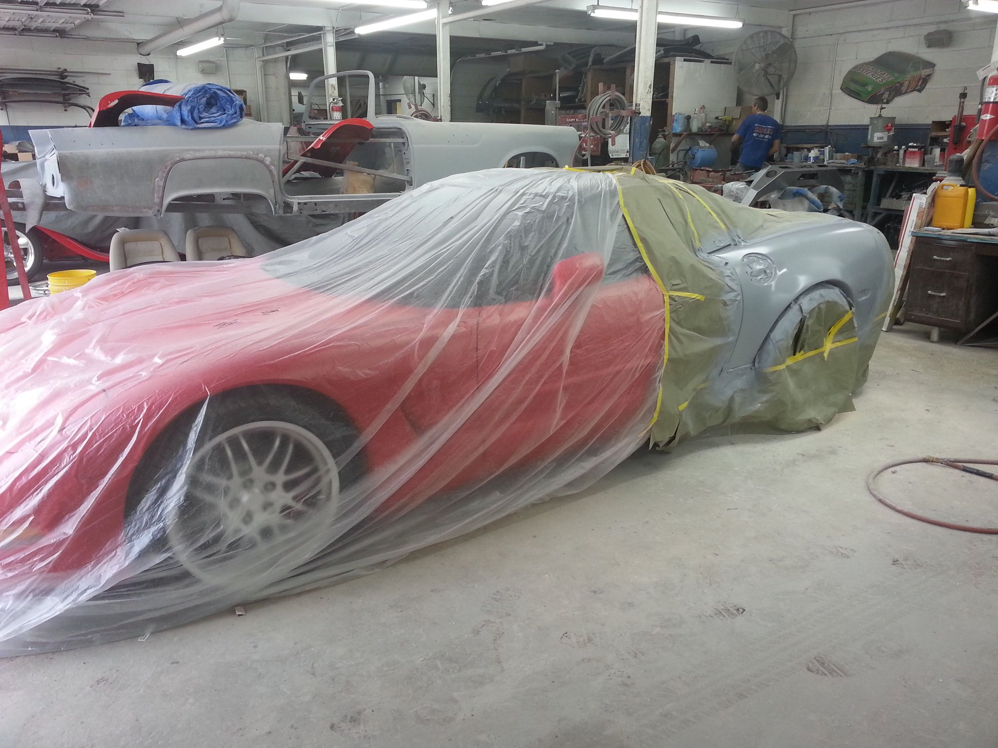

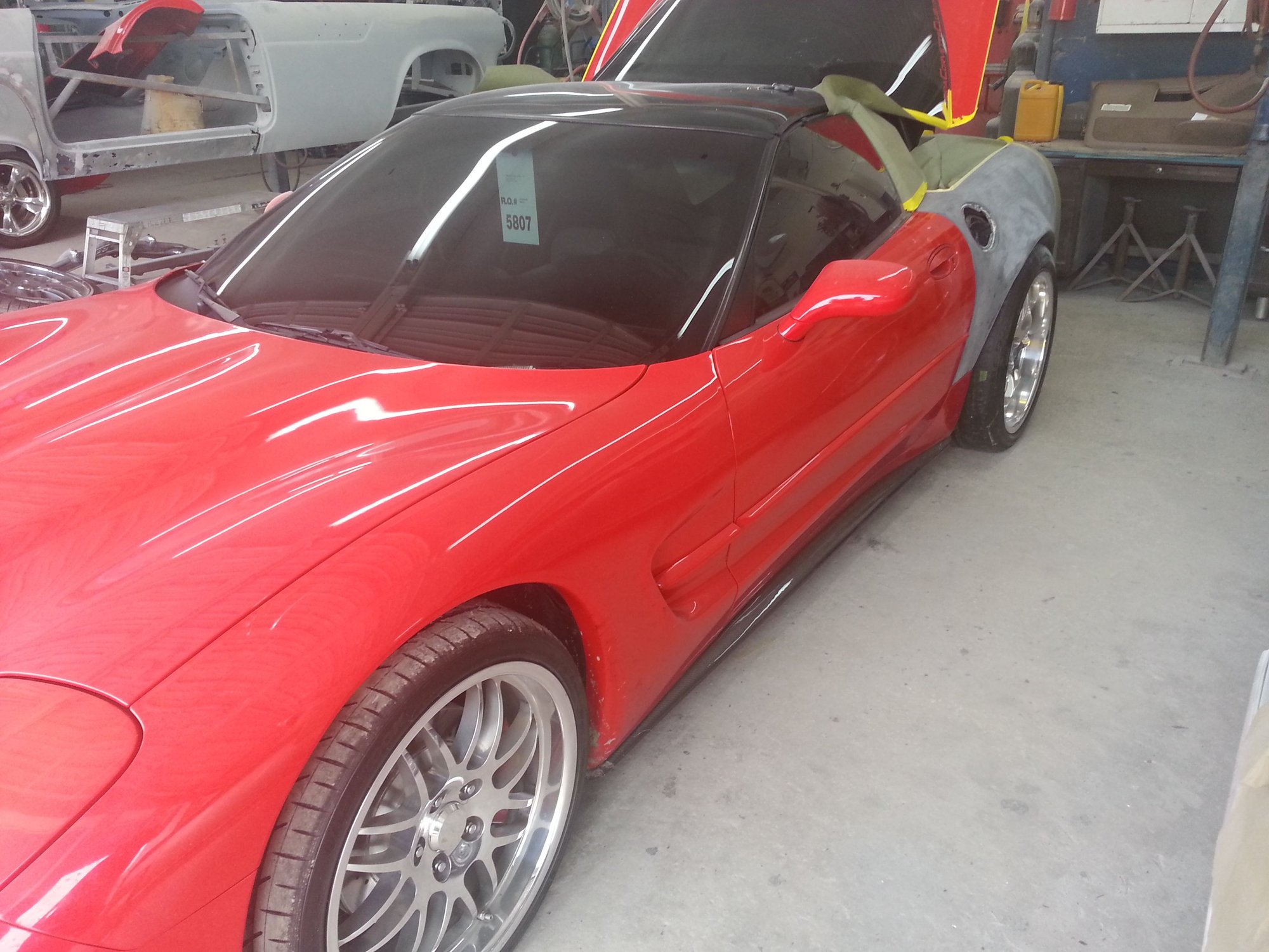

Been busy with family and life and the C5 too… for the last 2 weeks its been at my paint & body shop getting my wide rear carbon fiber fenders from Pete (corvette crationz) fitted and painted. Been one hell of a job and getting them just perfect but they are coming along nicely and the car is just about ready for paint, hopefully today. They will also be removing my BSM while we are at it. I kinda like them but with the carbon splitter and side skirts and rear spoiler/wing and now the wide fenders I think they are just going to be too much clutter and time for them to go. Anyway here are a few pic of the progress so far.
beginning the trial fit
flares with 20x11 rears still on
20x13 anxiously waiting.
same as the other 20x11's still on the car during 1st test fit of fenders with the 20x13's chomping at the bit to go on
glass work and fit is now done and 20x13's being fit
rear bumper back on the car and glass work is done and final fit of fenders is done
this is what it looks like front the front
final body work and filling of fenders is done primer is shot.. getting ready for paint is next

Thanks guys, I just got wrapped up with family and stuff doing little mods here are there. We are estimating 16 hours labor right now for fit, finish and paint. The fenders looked really nice out of the box and bolted up pretty well. The passenger side was noticably heavier than the drivers side and when fit it stuck out from the door a little more than 1/8 of an inch. Also inside the door jam it did not come to a point like the factory fonder and instead was rounded off and looked like it was missing a piece which it was. So the shop had to grind down and get the fit right so that they didnt stick out further than the door when closed and then had to make a fiber glass extension piece to fill in where it was missing. A little more fiberglass work had to be done to get the fit right where the fender meets the rocker.
The drivers side however had none of these issues. ok so now fenders are all mounted and fitting well the body shop calls for me to come by again. You can see that the new fenders are noticable wavy compared to the factory finders and the rest of the panels on the car. Look down the body line from the rear to the front its really obvious and once again decision time. They say hey we can paint it like it is or we can fill the low spots and work each fender which is the right way to go your call…. So Thats what we do each fender was the the filled and block sanded to perfect straightness and shot in primer than the holiday pops up soooo work stops for a bit. Hoping car gets into paint today going to make a run to the shop to check progress here in a min.
Please don't think i'm picking on Pete or his parts because he has always done right by me and they very well could have gone on and been just fine for many people. I'm just detailing what I saw and have been going through to get them the way "I want" and think they should be.
So if you go with flared fenders its going to be up to you how perfect you want them to be in no case will any of them be a perfect bolt on in a couple hours and go type of thing they must be fitted to each car. Petes fenders structurally seem to be very well made. the resin is nice,shiny, and deep. The carbon fiber is laid out nice and even and they are seem to be very strong and the price is for sure right even compared to the price of stock new rear fenders.
Not quite sure I like how the 13's fit in back so i may end up mini tubbing the car as well to get them to sit a little further in or sell my now 2 sets of CCW's and order a new set of wheels with a little different offset.
