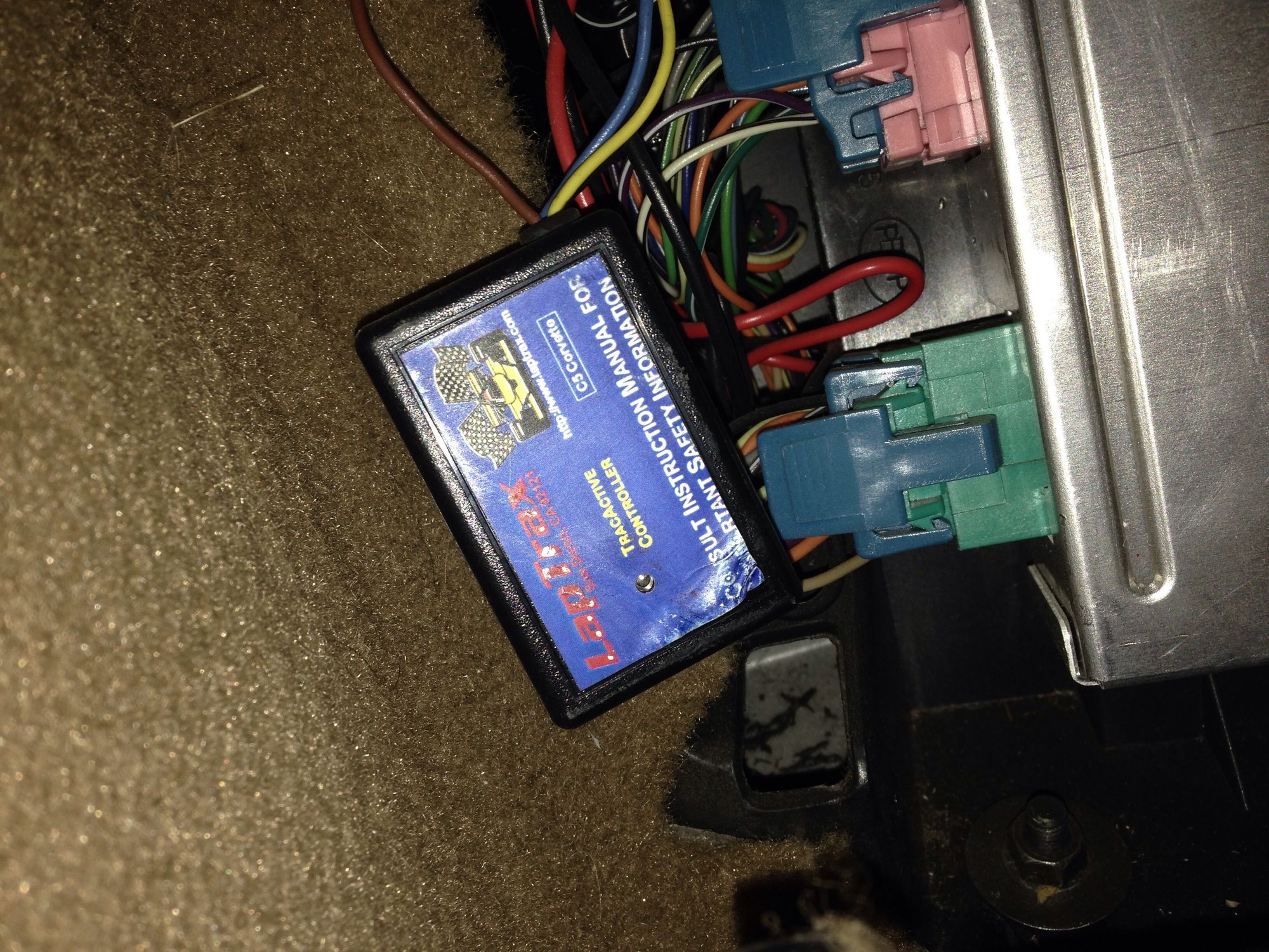

Old May 13, 2015 | 08:36 PM
Psydef's Avatar
Psydef
Joined: Oct 2010
Posts: 220
Likes: 57
From: Calgary Alberta
C5 of Year Finalist (stock) 2019
For anyone who was curious.. I finally got around to checking by the passenger foot well and sure enough this was installed by the previous owner.. Personally I don't see why anyone would want this installed. I'll probably remove it
