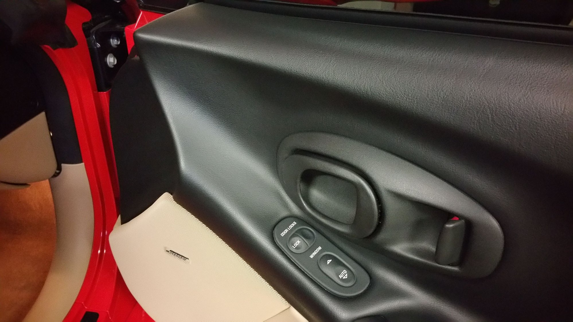

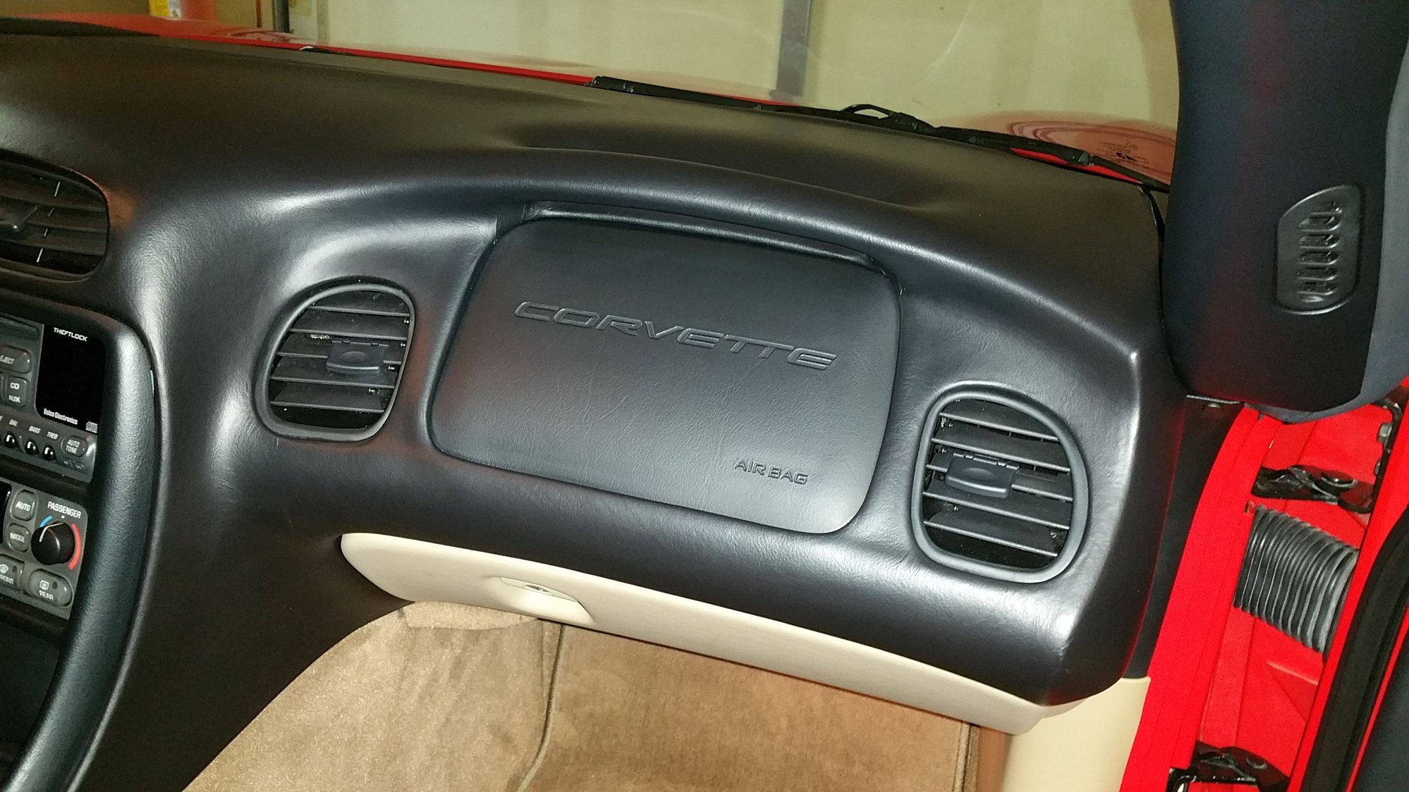

While admiring how well it worked on the scuffs I noticed the area had also lost the shiny, greasy look its had since I bought the car a couple years ago. The gentleman I bought the car from really liked the Armor All shine! So I tried the Eraser on an inconspicuous spot at the back of the door panel just to see what it'd do to the overly glossy black trim.. an hour and a half later I had the whole interior done
Just a spray bottle with tap water to keep the Eraser wet, very light rubbing, and a couple microfiber towels all the black trim has the very low satin finish it should have.

Although you like the satin finish, you just removed everything from the vinyl/rubber. I'm not sure if the vinyl/rubber can dry out too much or not.

I'm really tired and have no idea why what I typed was funny. My point was that you could cause it to crack over time.

I just thought you were being sarcastic about the greasy mess I was able to get rid of doing some good. I didn't get a before pictute of the rest of the interior because I didn't plan on doing what I did. The car pretty much lived in a garage for 14 years before I purchased it.. and as far as I can tell was Armor All'd monthly
I can start piling on the protectant, but now I'm just starting with a clean canvas.

Now apply some 303 protectant an you should be fine. Rub the 303 in and it will not shine like Armor All, keeping the satin look

Those are some of the NICEST interior pics I've ever seen... GREAT job!
