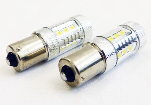

Is there a significant improvement in brightness, not just aesthetics, when these
Genssi 2x 80W CREE White 1156 Genssi 2x 80W CREE White 1156
are used in the stock housing, not the Adjure or other aftermarket replacement?
Will they fit inside the stock housing? They look quite long...

the adjure is the same as the stock housing, it just has clear lenses and the ones I have fit fine in my adjure housing so I don't see why they wouldn't work in the stock housing... like I stated, it's easy to take off and get measurements if you are in doubt... as far as the light increase it may not be as great with the stock housing but if you already have led tails they will really clean up the look on the back of the car... halogen mixed with led/hid looks bad to me

The combination of brightness and color make these or ones similar a great upgrade especially when you consider how easy to change, how little to spend, no downside and how big the improvement. A genuine "NO BRAINER".

Honestly, I would not buy the bulb from local sources. they are typically rather dim and expensive for what they provide.
The radioflyer solutions combines the adjure diamond-reflector/clear lens housing with Cree 16-chip LED bulbs:
Get the LED bulbs at a discount when you purchase them with the adjure light housing http://shop.radioflyerinnovations.co...rvette-013.htm
Can You post a picture of your bulbs ?
