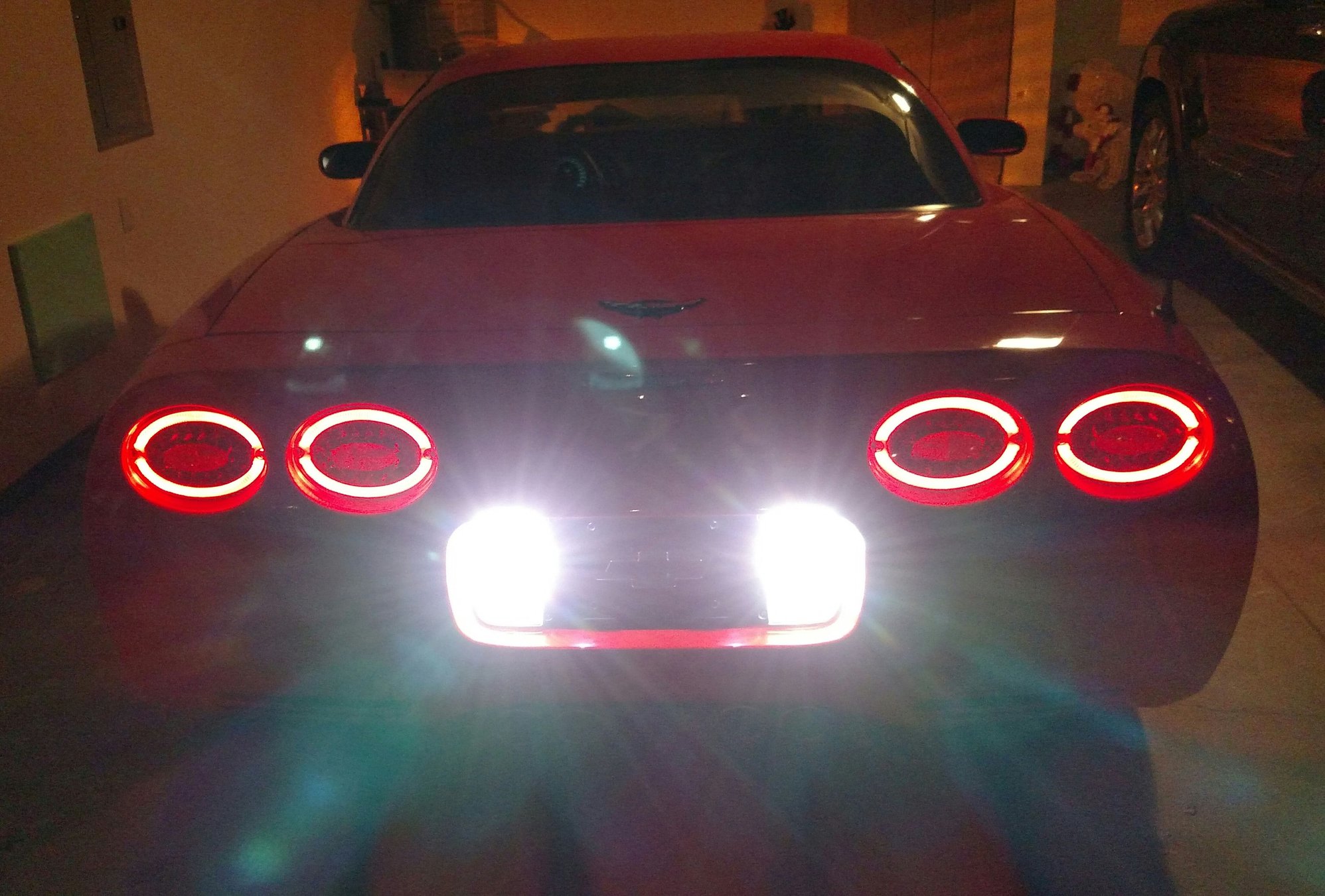

Extremely bright compared to the stock halogens. They'll be even brighter once I add the adjure housing as seen above. The white light that the LEDs cast looks much cleaner and more modern than the yellow halogen light. Not to mention it looks like you have high beams coming out the back of the car!
The aftermarket rear HALO LED's were ahead of their time. The oval shape C5 rear lights lend themselves well to this look...the C6 round lights do not.
Looks great TorchRedLS6 !
Thanks very much NemesisC5. Appreciate your help and everyone else's in this thread. Made my life much easier!
You're welcome.
The LED 1157s finish off the rear nicely with a clean crisp light compared to **** yellow emitted by factory halogens.
