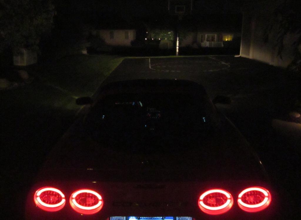

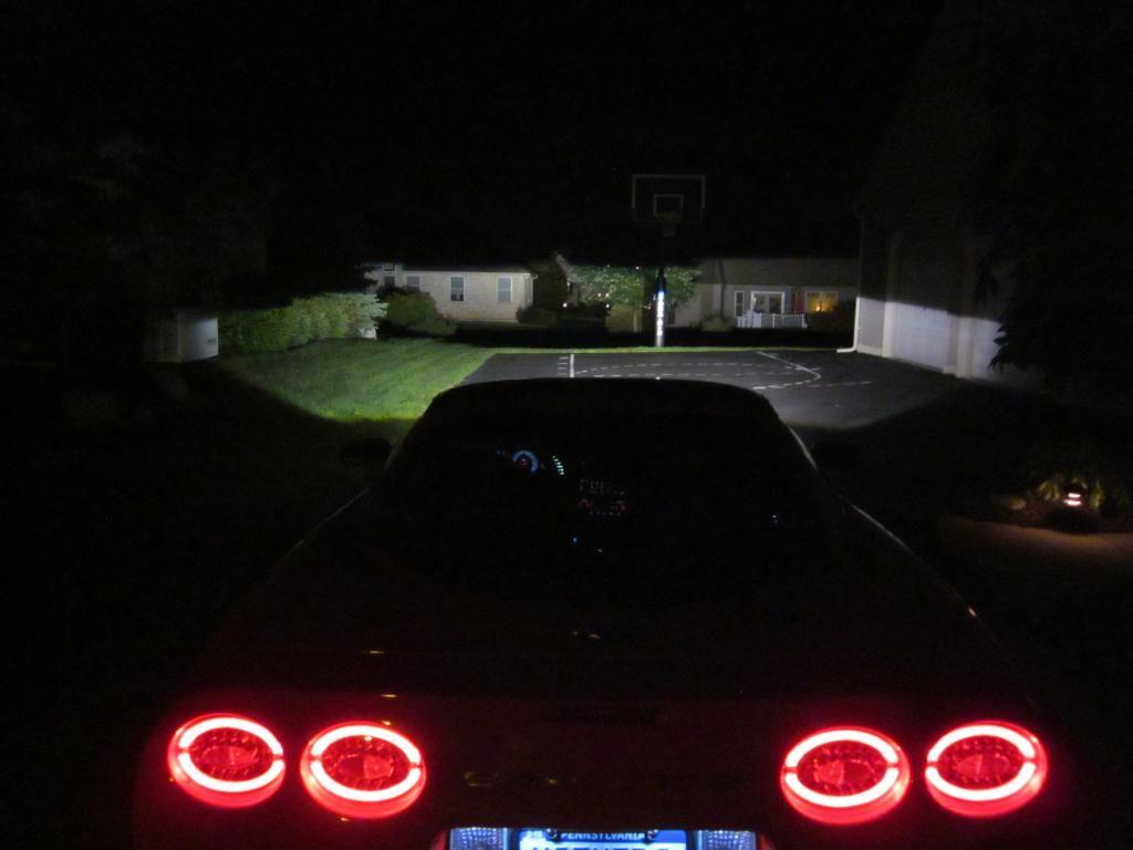

Old Jan 29, 2016 | 12:33 PM
TheRadioFlyer's Avatar
TheRadioFlyer
Supporting Vendor
Joined: Jul 2010
Posts: 8,550
Likes: 902
From: Republic of Texas
our Bi-xenon ACA (before/after)
http://shop.radioflyerinnovations.co...lights-015.htm
Factory Low beam
Bi-xenon ACA low beam
Which would you rather have at night?

Any complaints on other drivers flashing because they're blinded by the Bi-Xenon lights. How much adjusting needs to be done?
Old Feb 4, 2016 | 03:44 PM
TheRadioFlyer
Supporting Vendor
Joined: Jul 2010
Posts: 8,550
Likes: 902
If aimed correctly the only time oncoming traffic will have issues is on hills, but that happens with all but auto-leveling headlights.
Adjusting mostly needs to be done on the driver's side to bring it UP and LEFT. Because of the sharp cutoff on the low beam, you can aim the headlight much higher than with a traditional reflector headlight without risking glare to oncoming traffic.
