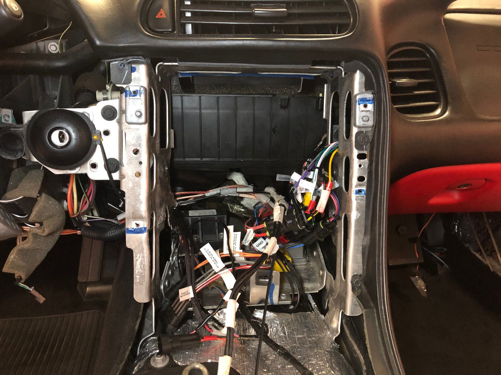

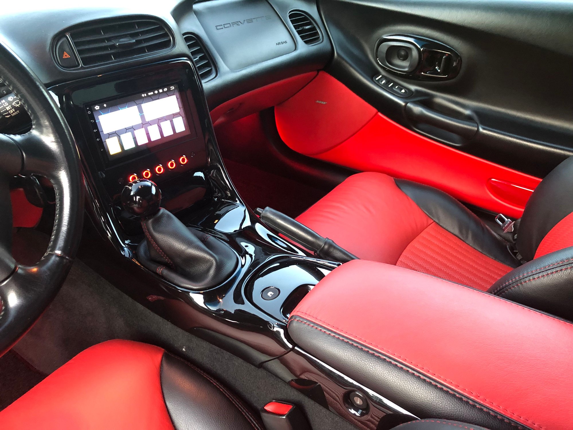

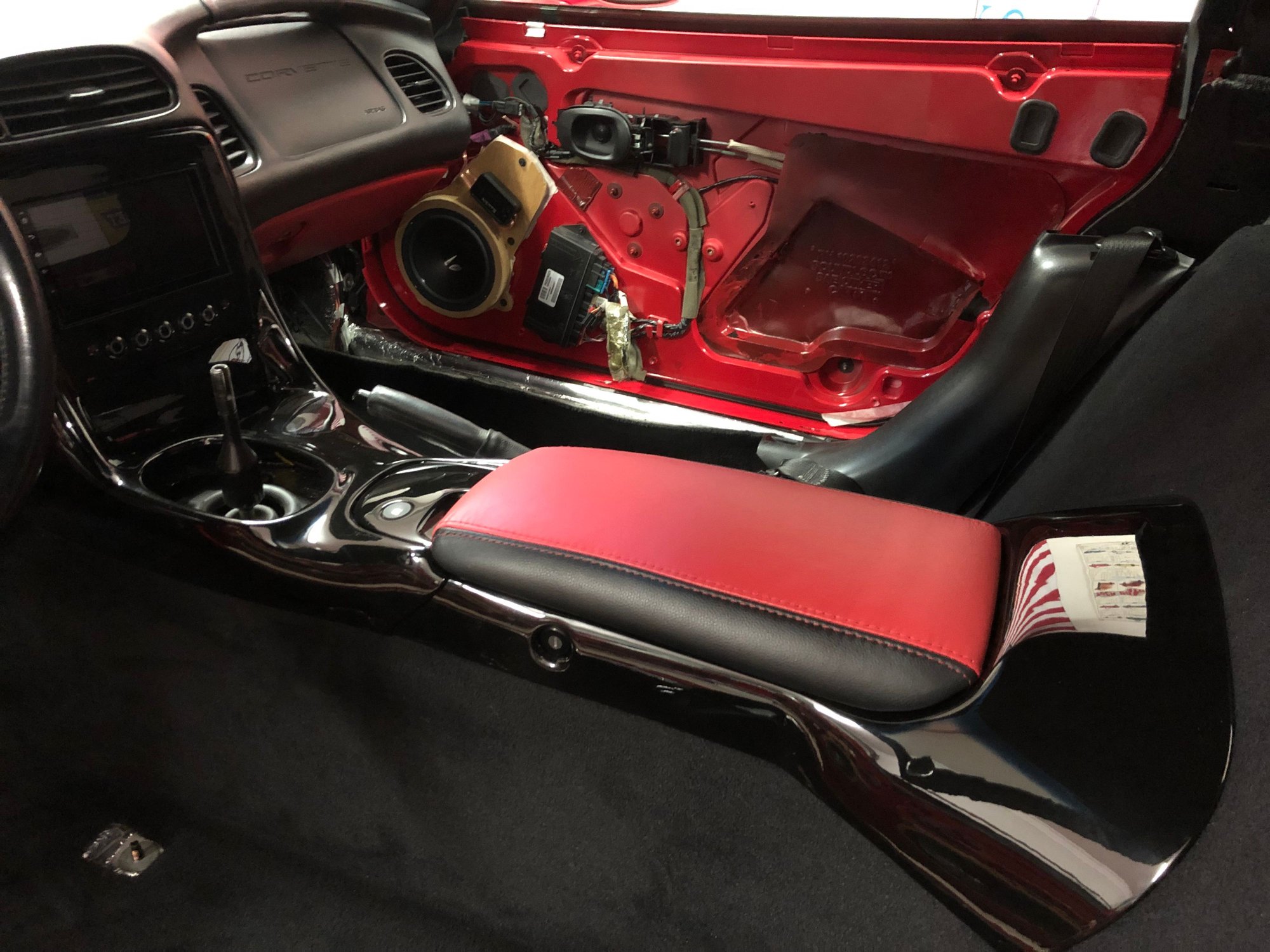

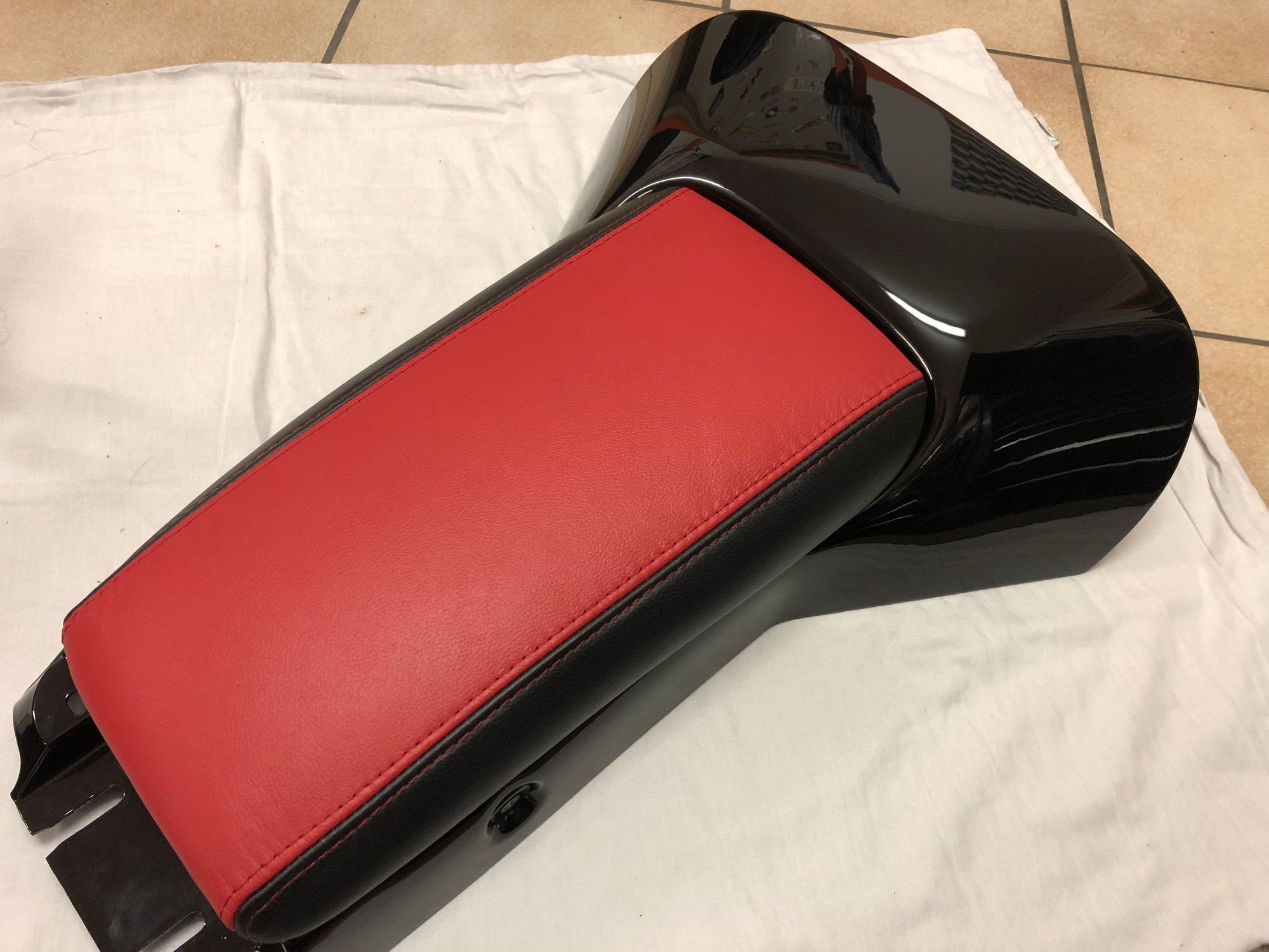

Finally I´m done with the interior
As I did the test assembly I realized that you do need to remove both brackets behind the center console. That gives much more room for wires. So anybody doing this - do yourselves a favor and cut both brackets from the start (its a pain to do it, when all the new wires are routed into position.

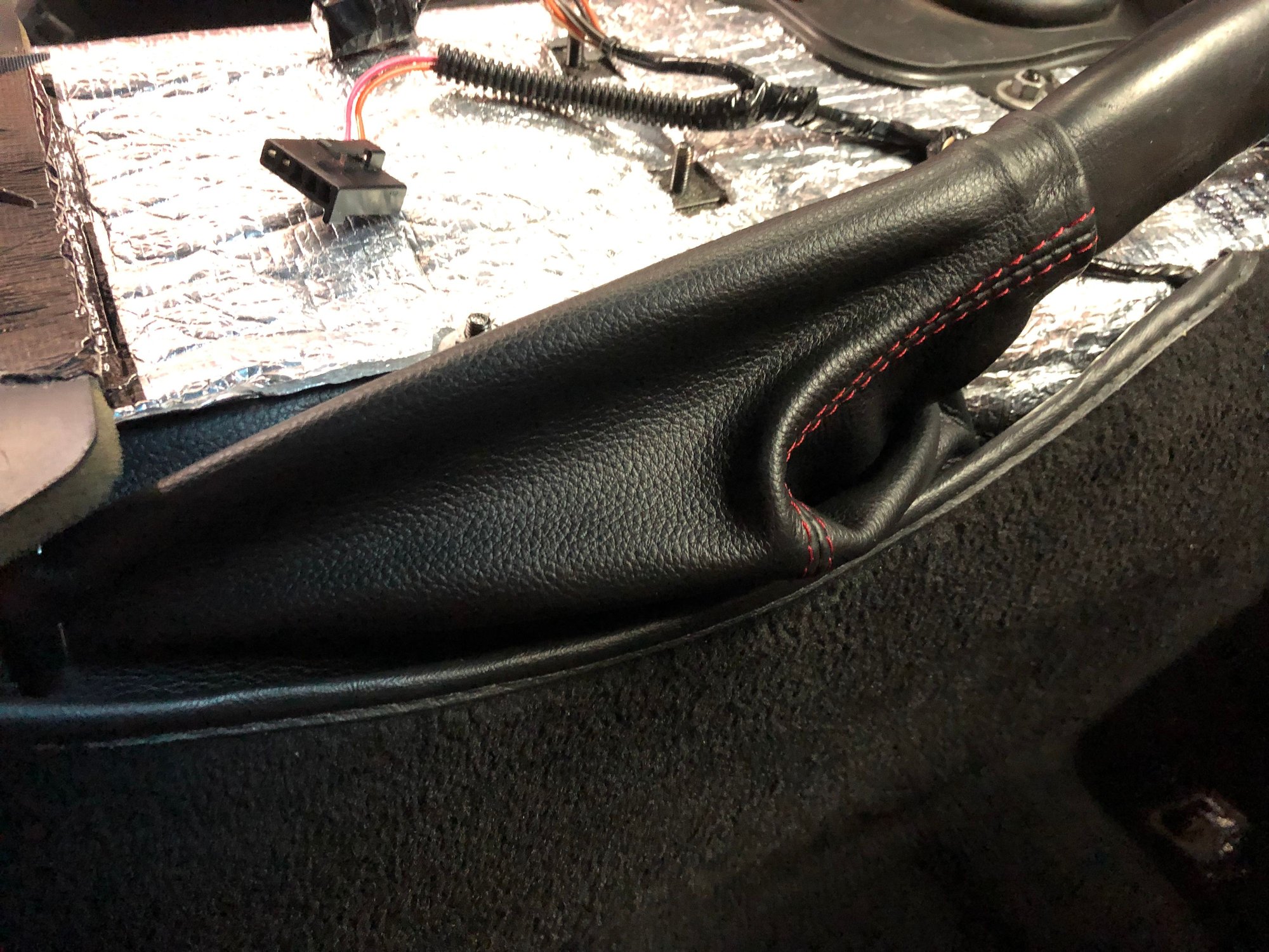

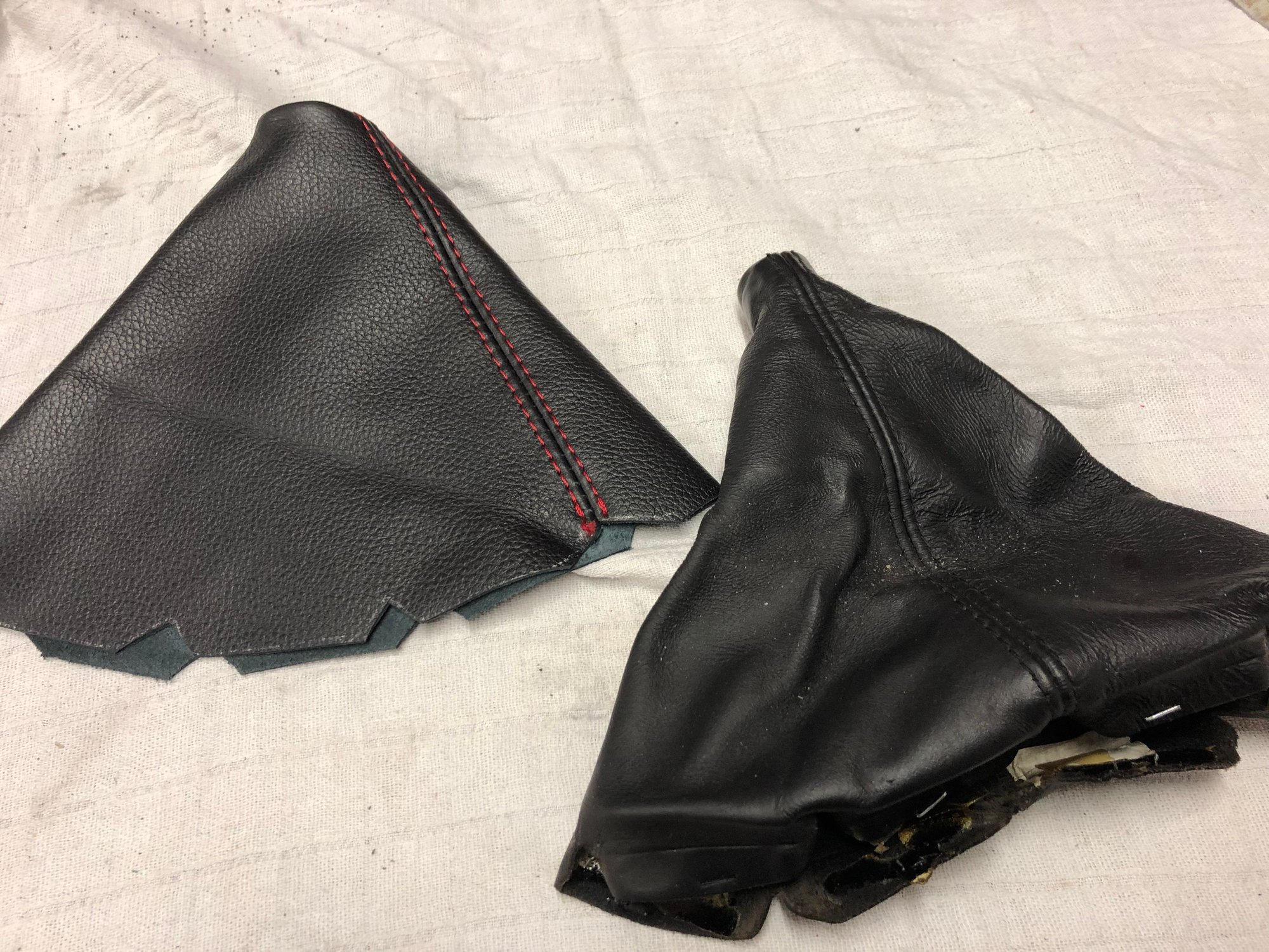

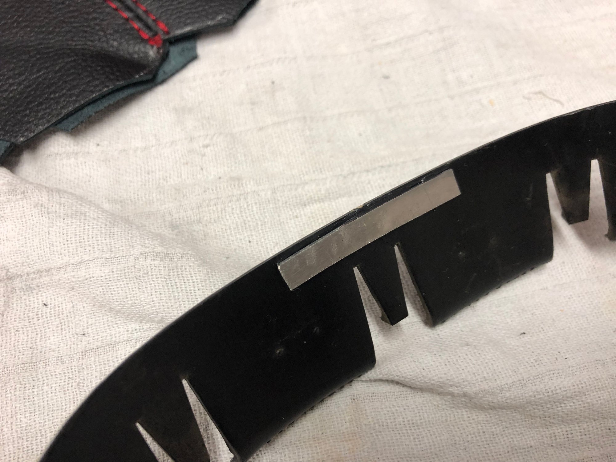

The new shift boot from Ridies. Unfortunately the OEM plastic support ring for the shift boot had a crack in both sides (seems to be a common problem). I made some small aluminum support pieces and glued them to the support ring before installing the new leather boot. Install was very easy for those who haven´t done it. And now it is as good as new (and even better).

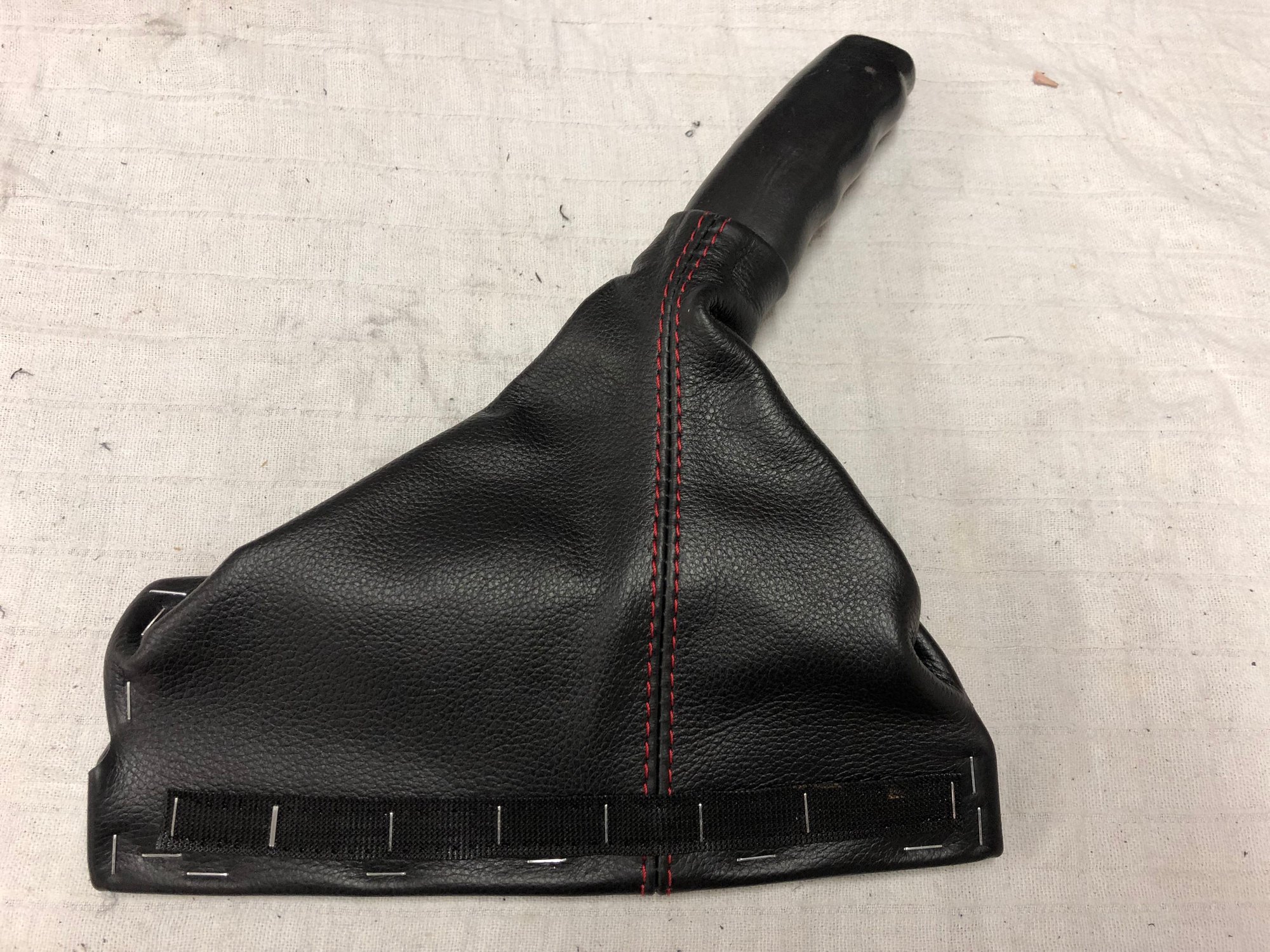

Also new leather boot for the parking brake. Not a difficult task, but you do need to figure out where to start, as you are going to mount the leather with staples around a metal trim bracket.
The armrest console turned out pretty well - and really fits the black/red theme.

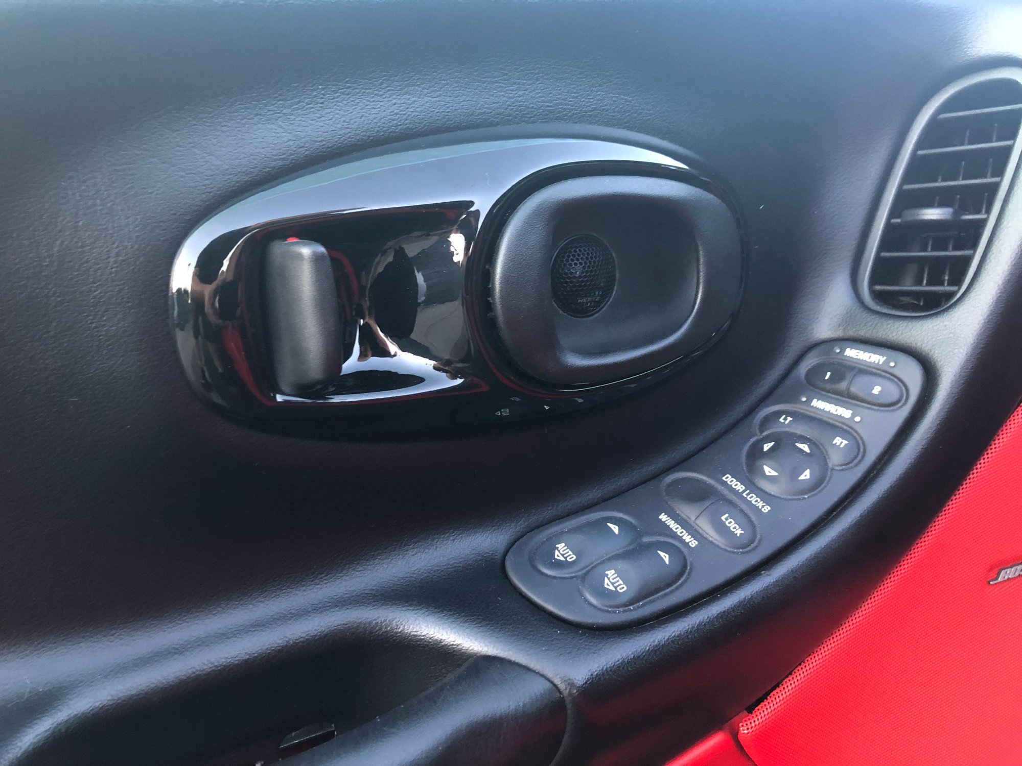

And the custom 3-axis bracket for the head unit did the job - its positioned exactly flush.

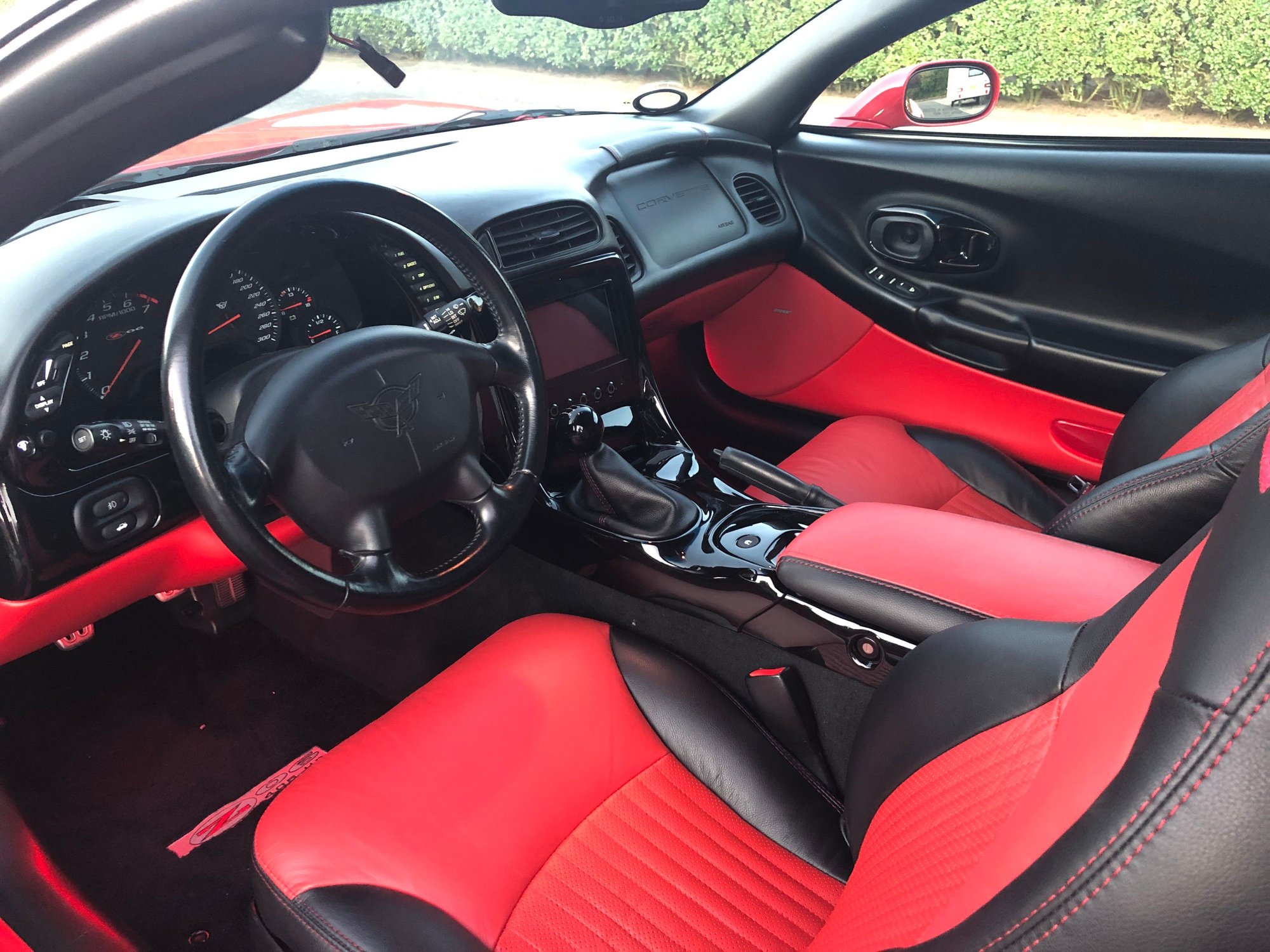

Ready to enjoy…- love the subtle look with the glossy dash and a few other parts.
...and the extended HVAC wires works perfect...

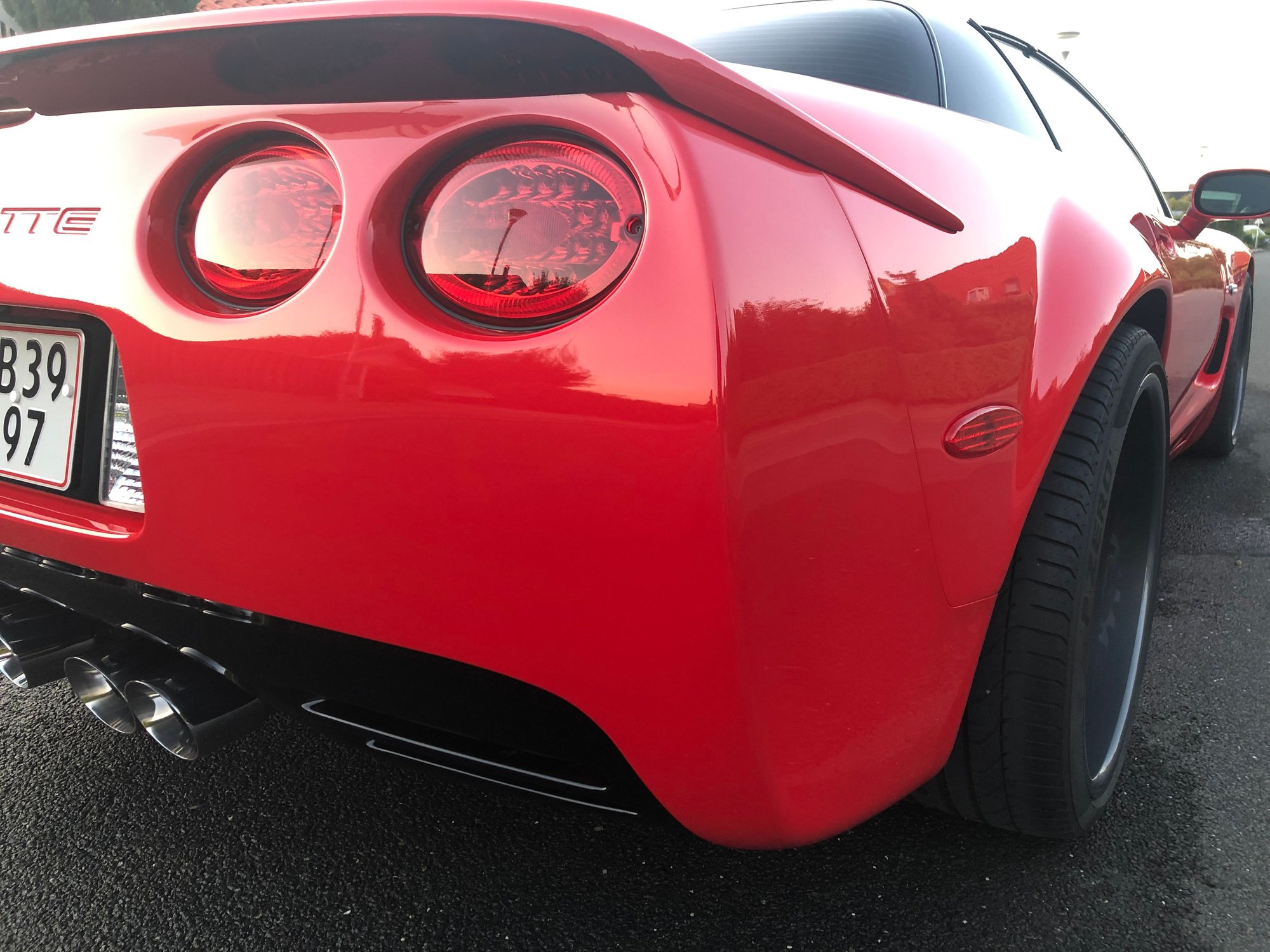

The pearl effect in "Lamborghini rosso mars" really shines in the evening sun...

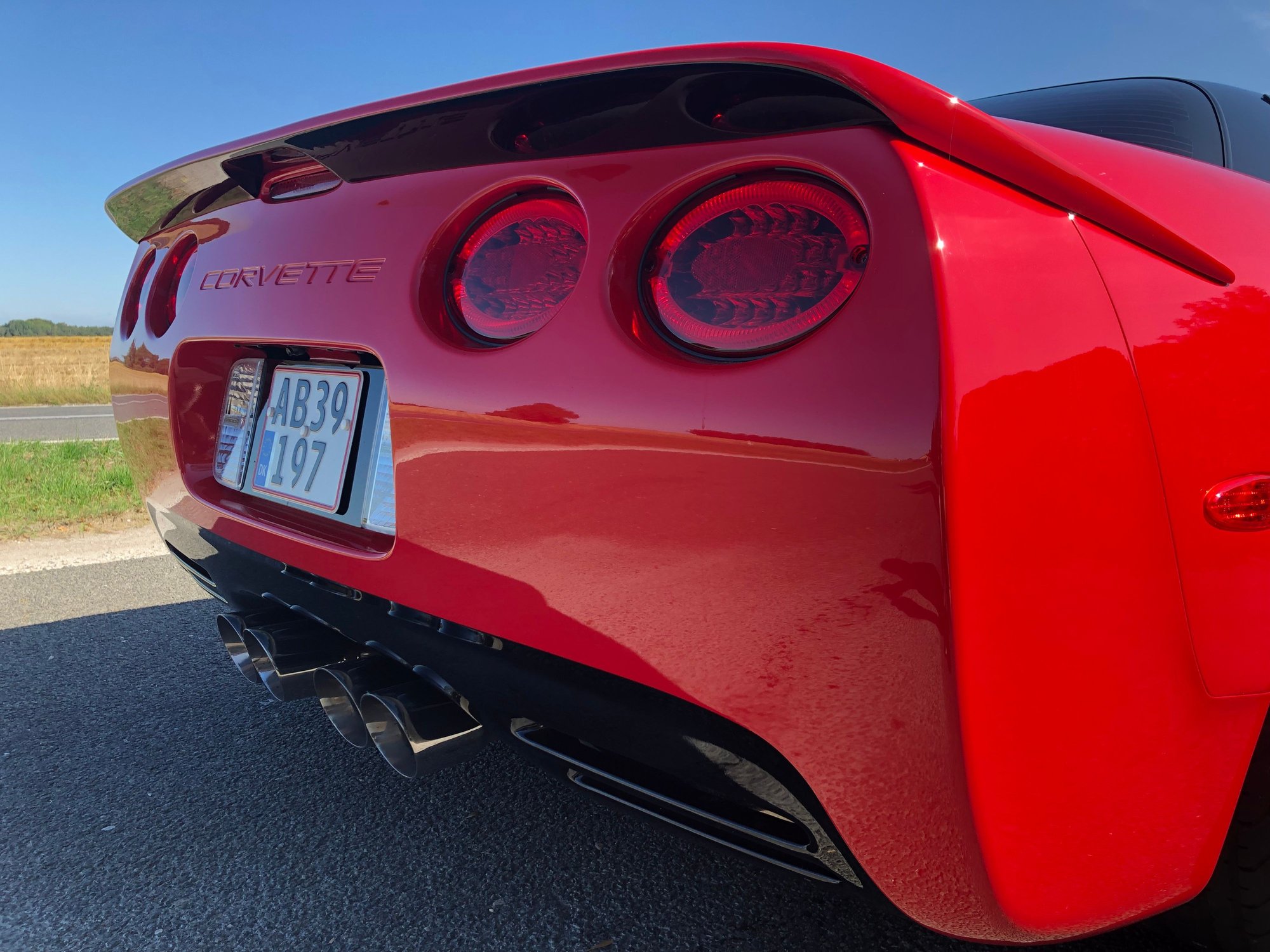

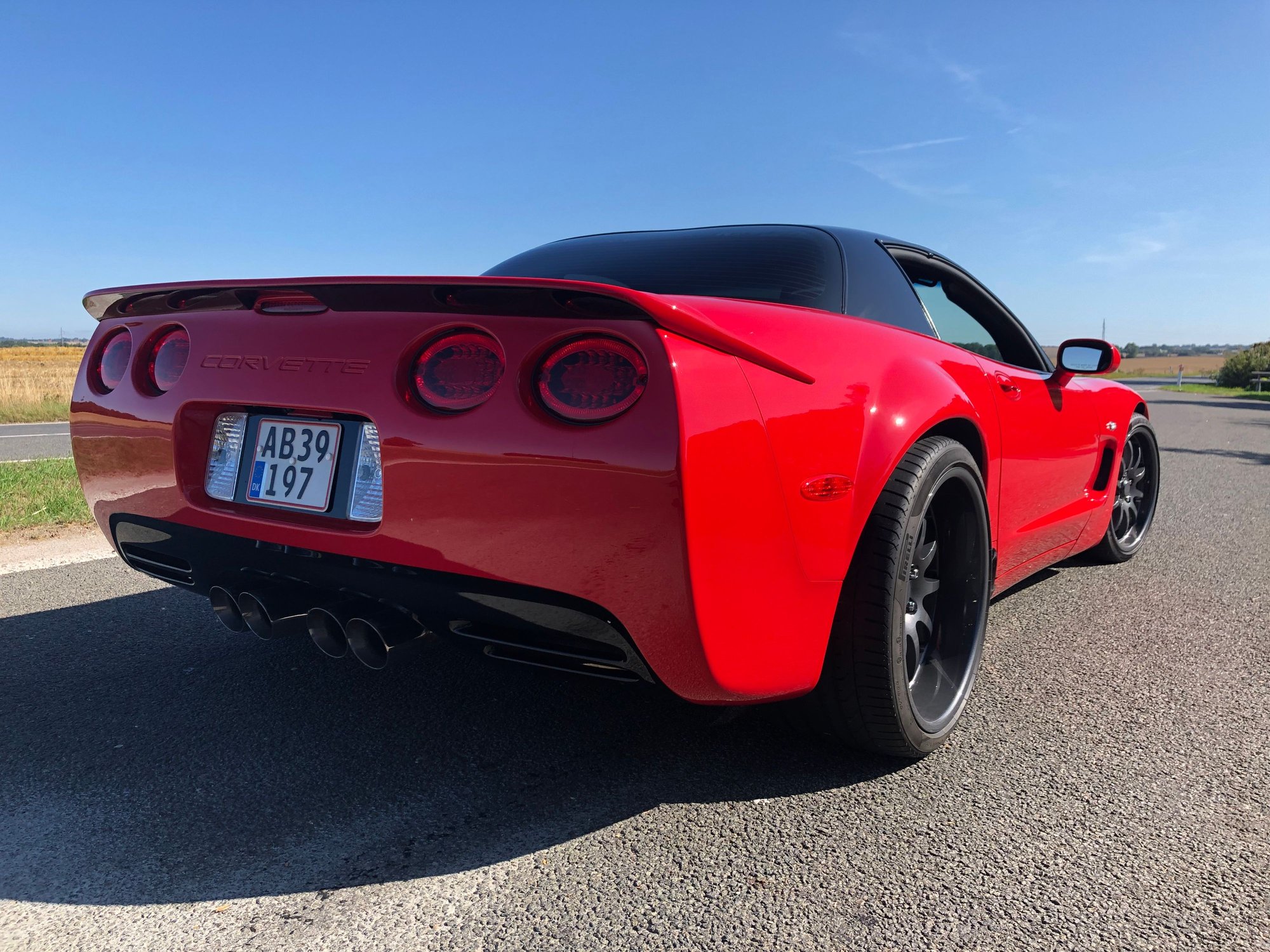

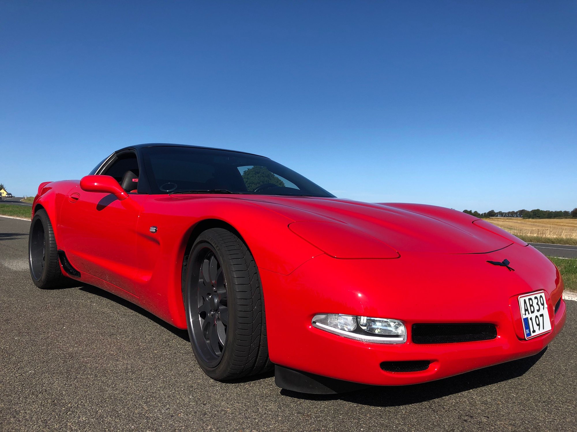

Originally Posted by Rob 02
Man that turned out nice.
What do people in your area think about it?
Thanks - I´m also very excided about the result so far

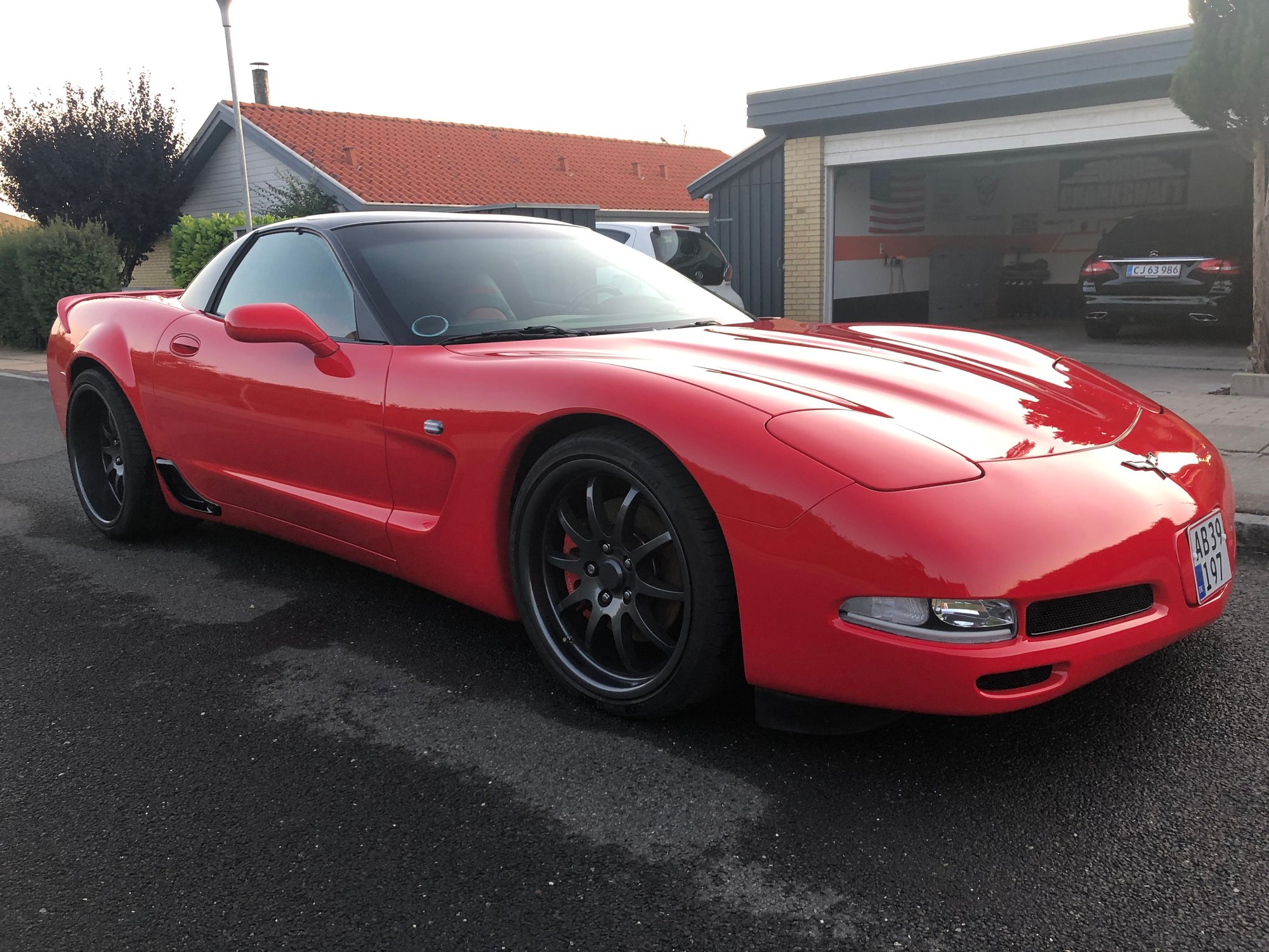

I do get lots of smiles and thumbs up here in Denmark - and it´s not that common to modify the newer corvettes in Denmark. I have only seen 3 other C5´s with wide rear quarters so far and most of the other C5 owners only changes wheels, exhaust, suspension and CAI. But there is a lot of attention and interest to the US scene in Denmark, and every year new nice projects and OEM restorations show up at car shows.

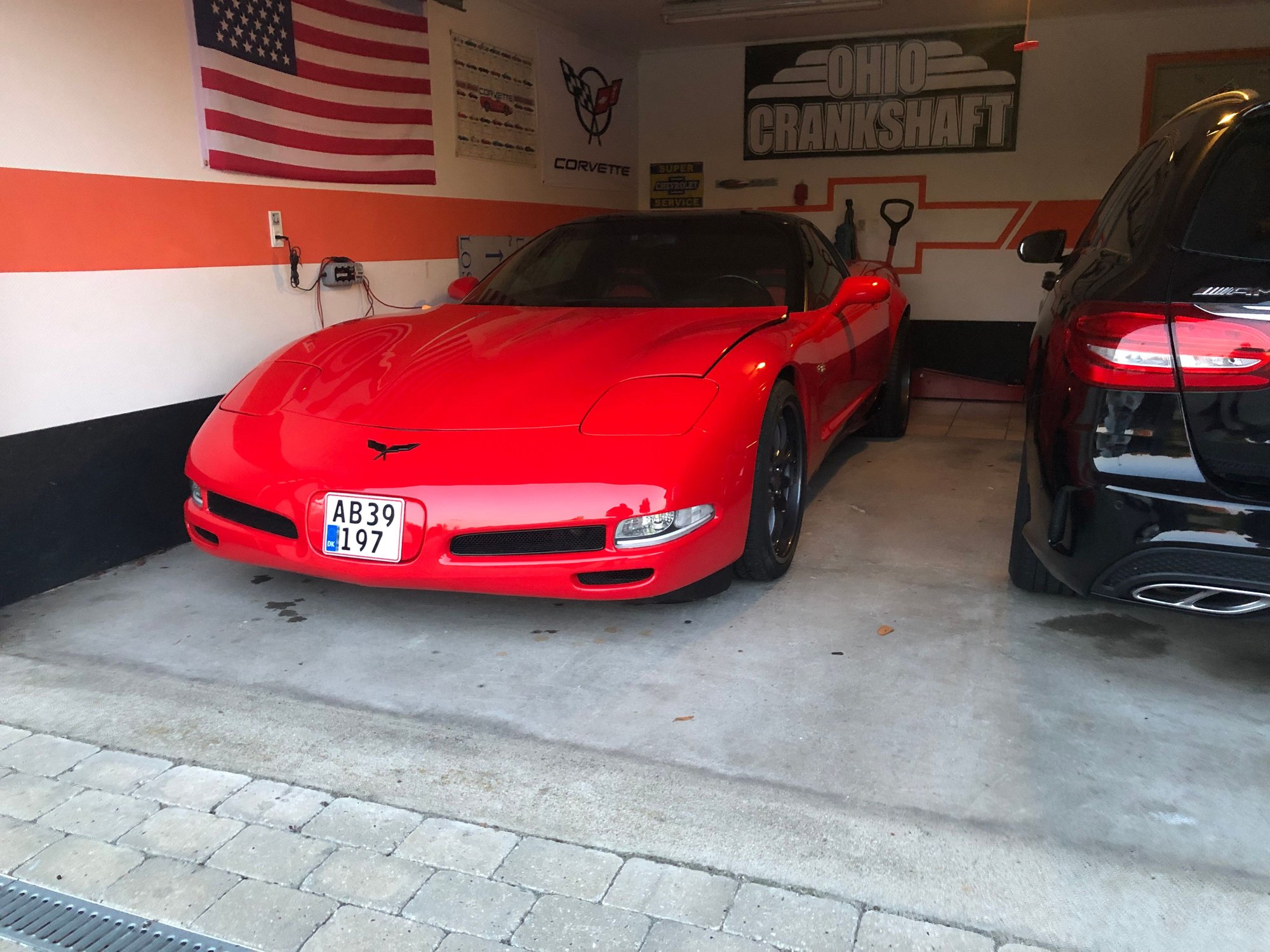

Here is a few shots from the week when it passed inspection (every 2nd year):

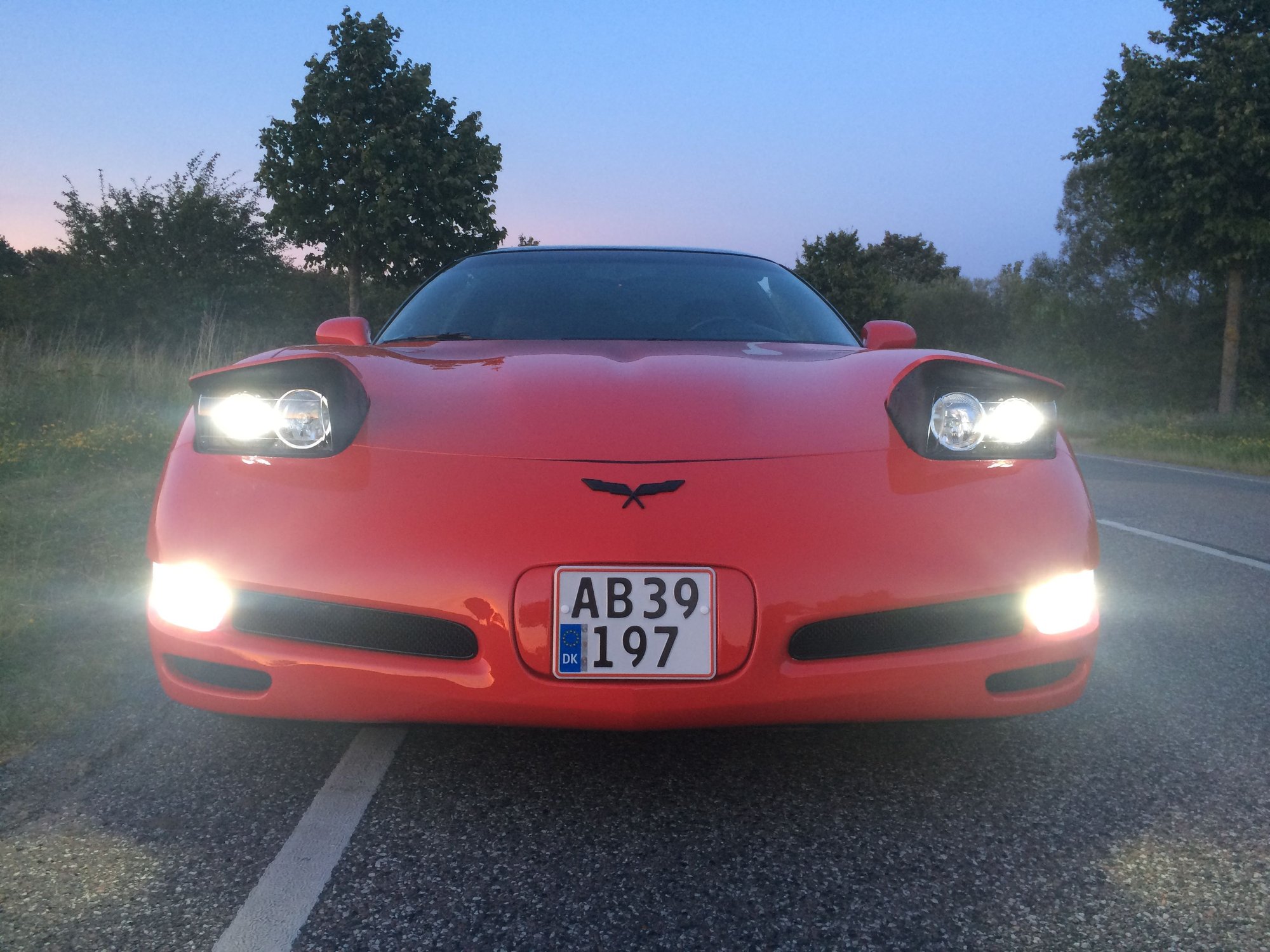

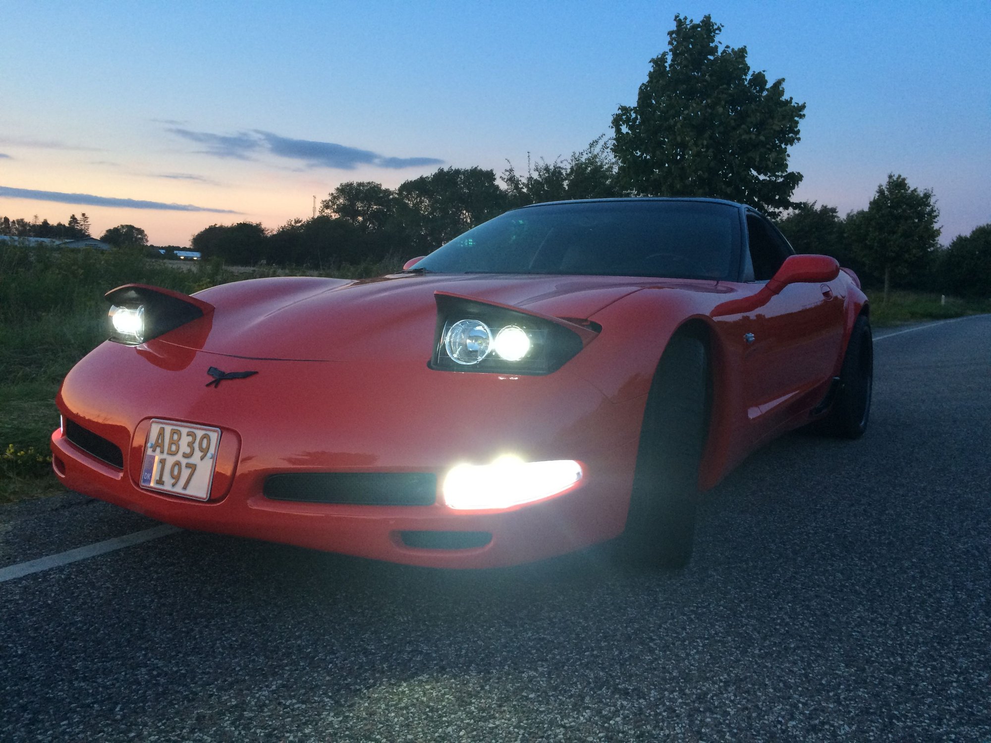

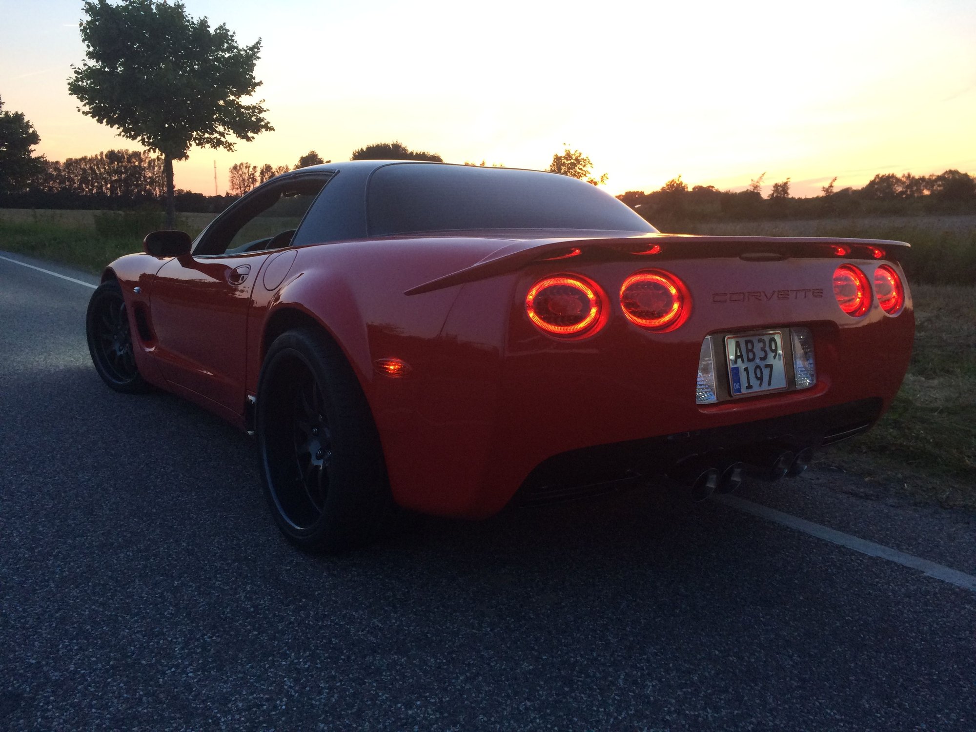

Originally Posted by helga203
How about some night pics to show off the new lights??

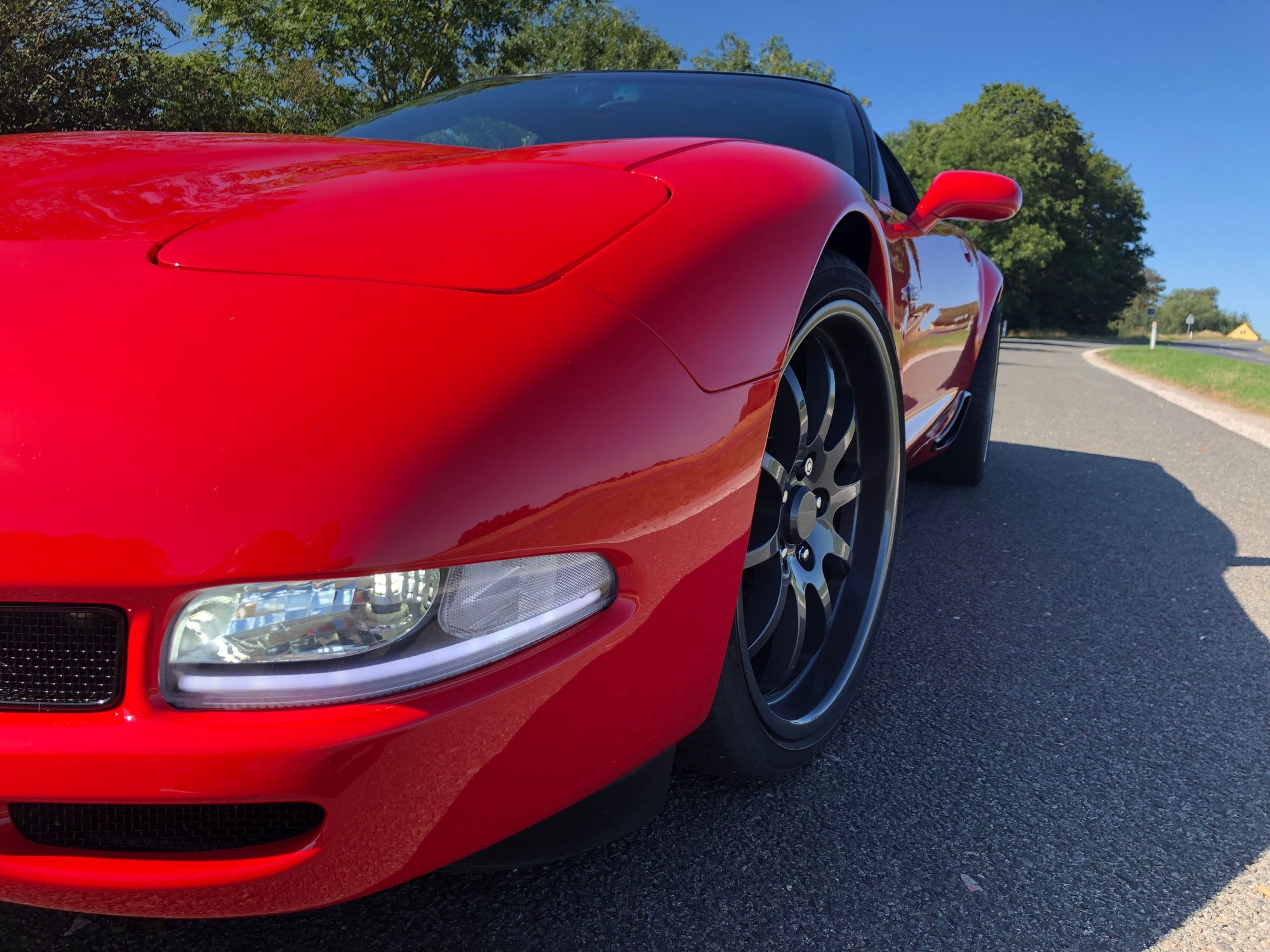

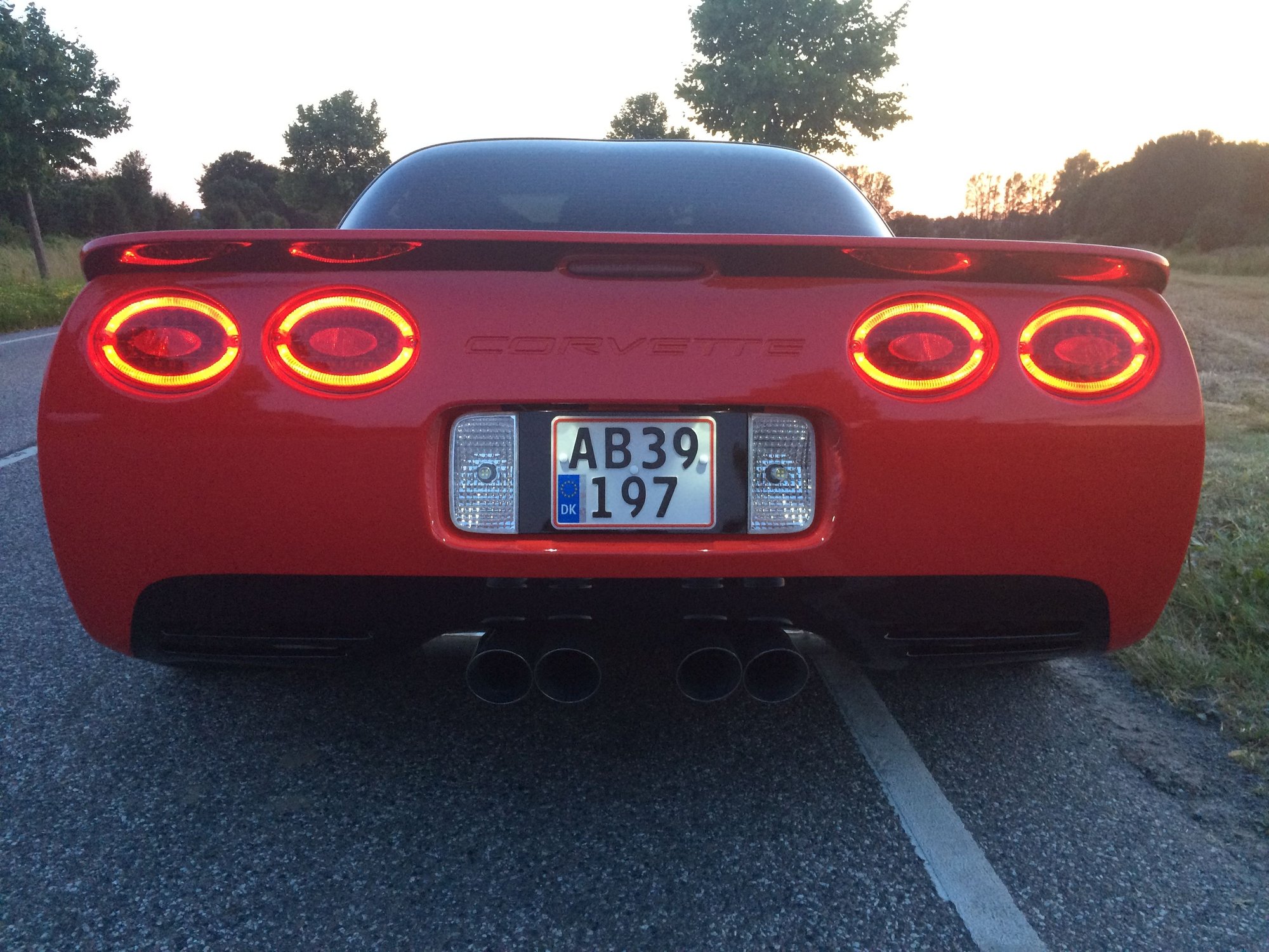

I dont have any real night pictures - but I have these from just before sundown
