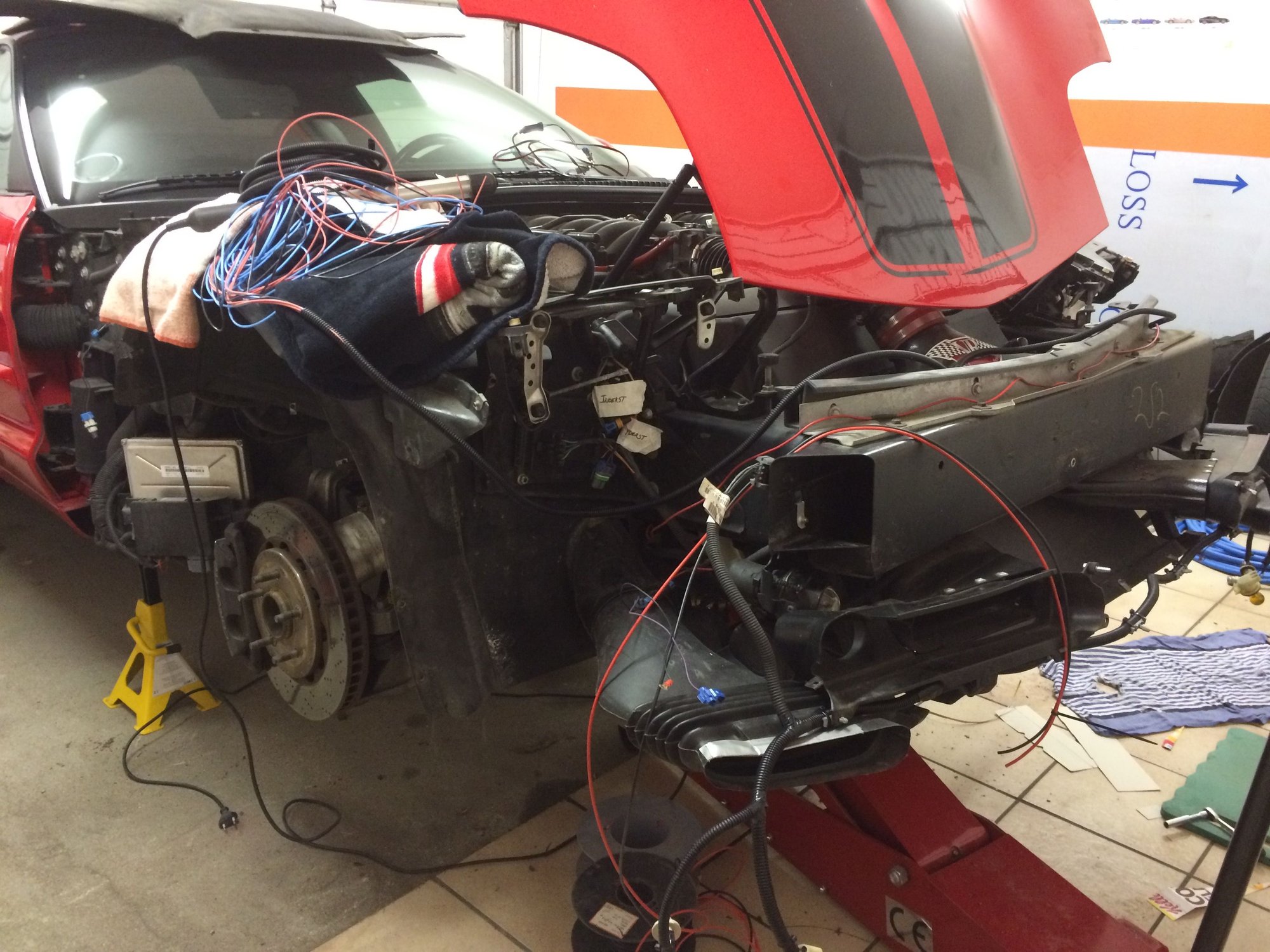

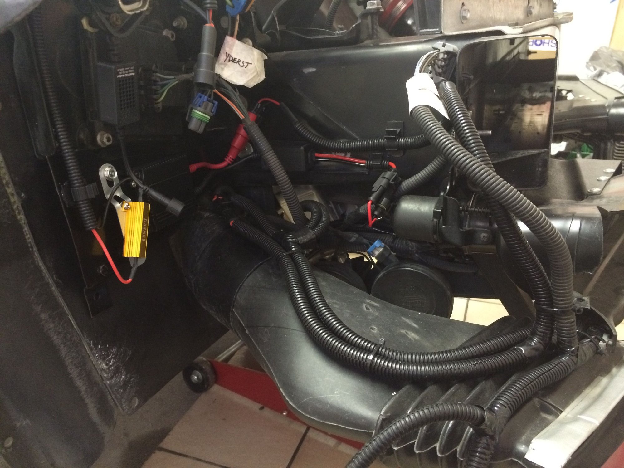

Back to business and topic - now as everybody have had their nightmare about Danish taxes...

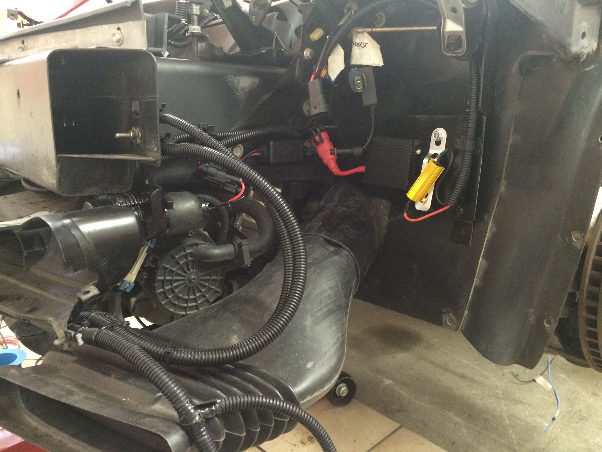

I´ve spend some hours on the wires. The rear end is finished (everething soldered up and packed in wire looms - ready to test the new LED rear ligths from radioflyer with euro signal ligth built in.

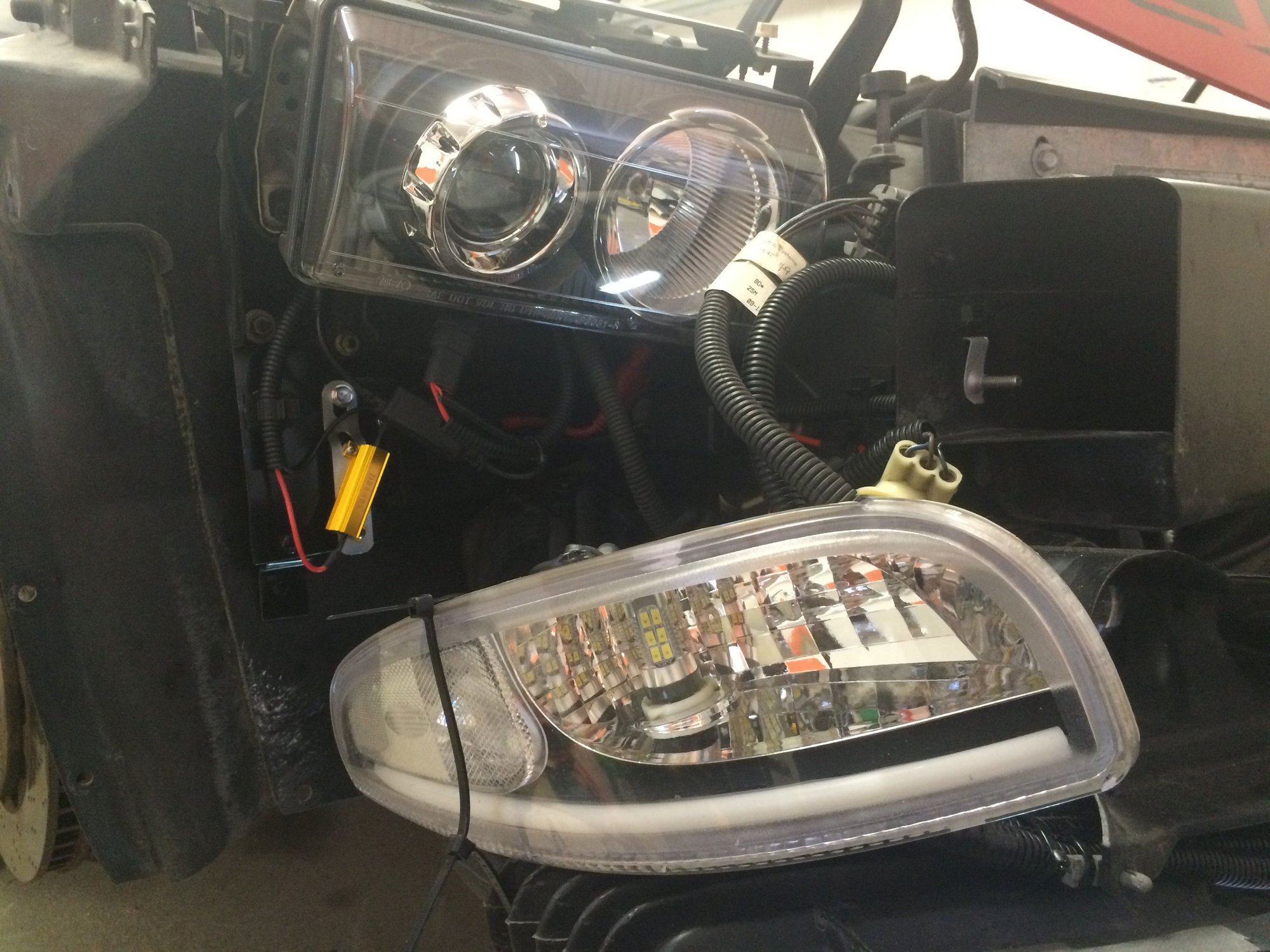

In front I´ve made the new wirering for the HID fog ligths (complete new wirering in 2,5 mm2), made brackets for the driver and the resistance for the LED headlights, and started to route everything nicely.
It takes a lot of time to clean everything up, solder and make a nice routing - but soon i´m done and can start doing some of the "bigger" things, where there will be a more visible progress
Right side before - with all the extra wires
In progress
Left side all packed and routed

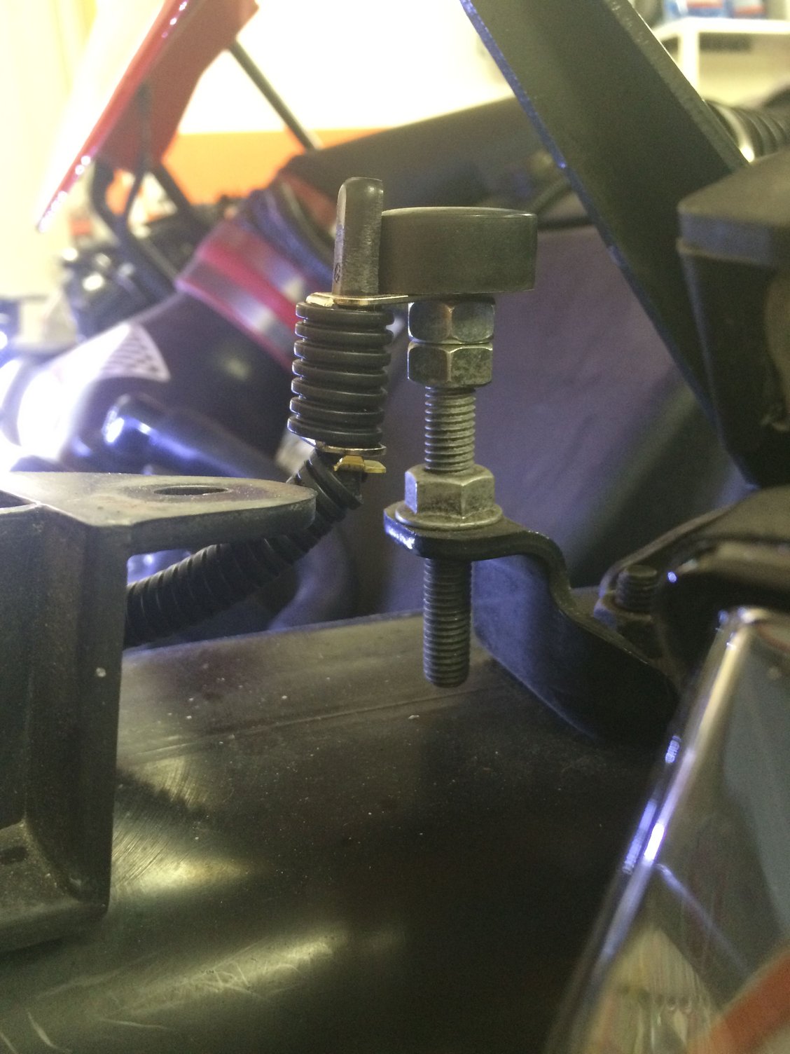

Haven´t had that much time lately - but it´s still in progress yet slowly.

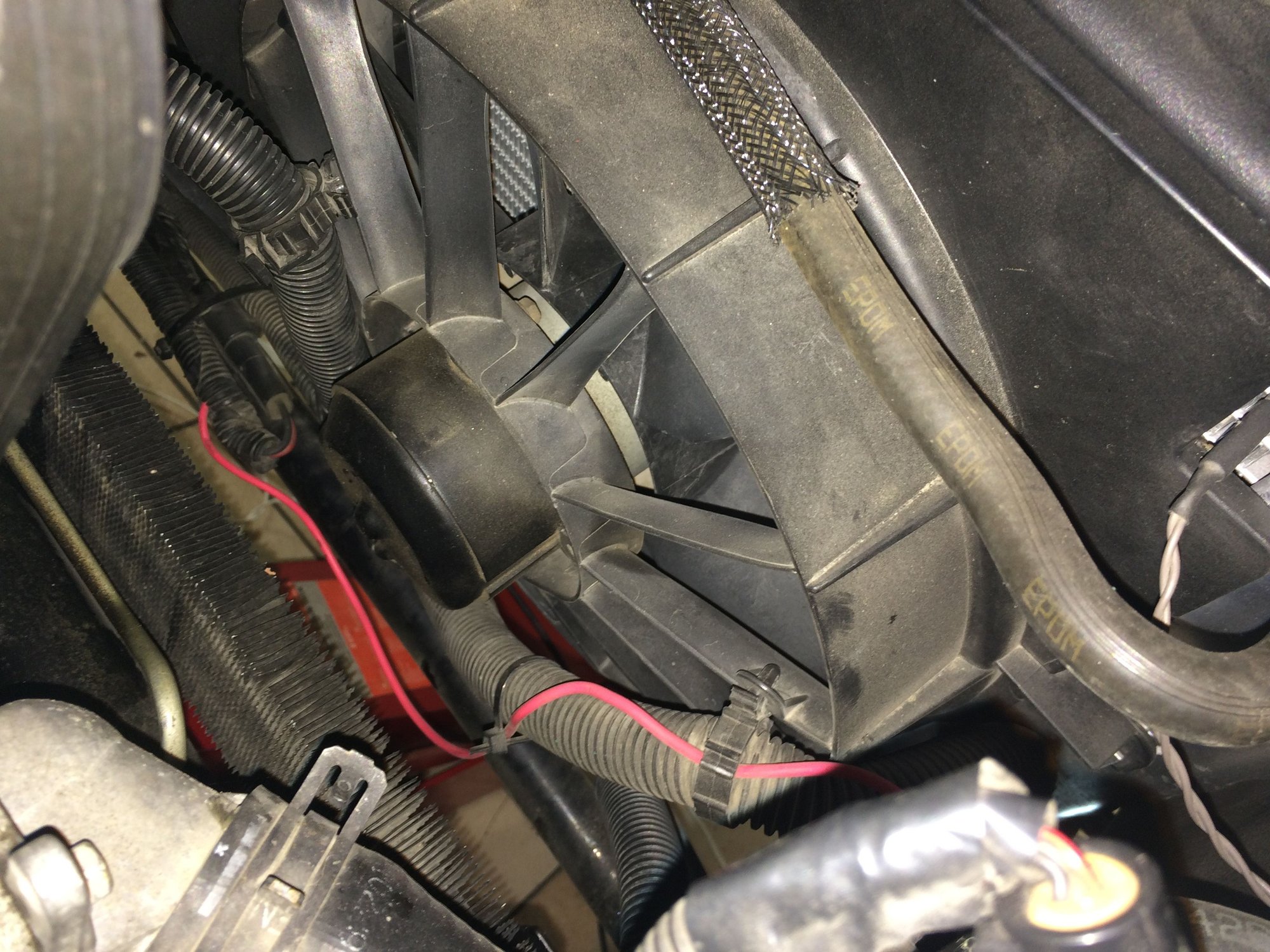

Cleaning up wires in the engine bay I found an unknown fan controller unit from Vinci Power Products. It was hidden under the coolant tank - but its unknown how it controls/affects the fans. It is not routed nicely and I dont like wires routed out everywhere from the fuse box. Im installing the CoolIT hardwire kit from SacCity Corvette, so this unit going out.

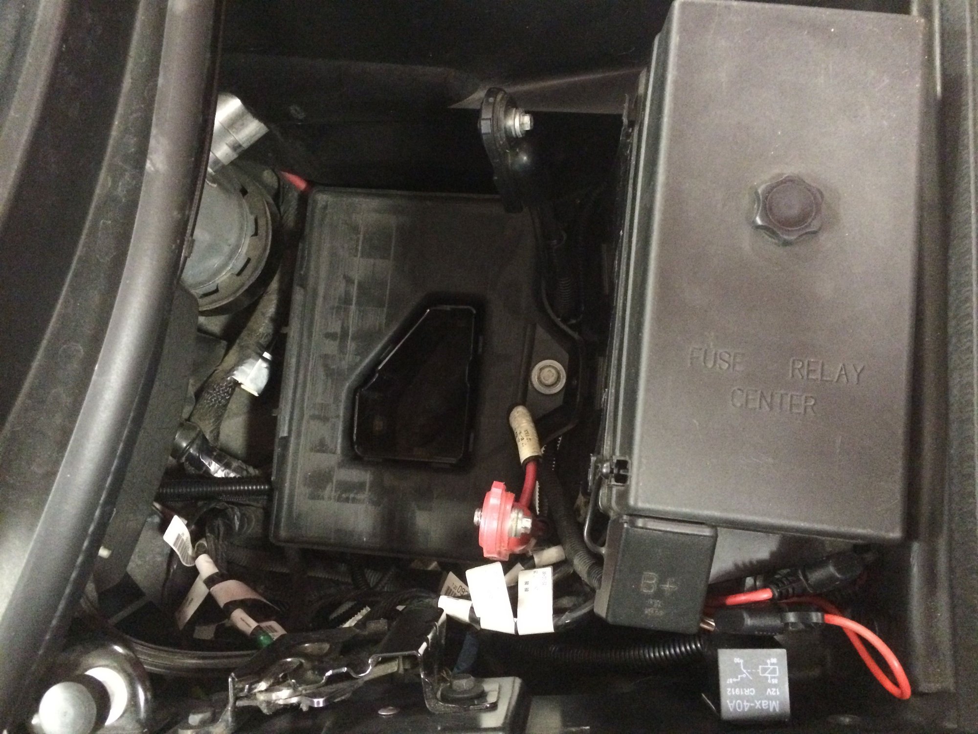

Battery tray before and after. Nice to see that there is no sign of any former acid leak. I´ve routed all the new wires from the right head light cove, under the coolant tank an in the battery tray. Its a harness for the HID fog lights and a harness for my custom hood light (will have a pressure switch, and lights will mounted in the engine bay as the Hood will be painted both sides, and I want it to look clean). The relay to the Hi-4 harness from Radioflyer is mounted to a little custom bracket that is riveted to the inner fender.

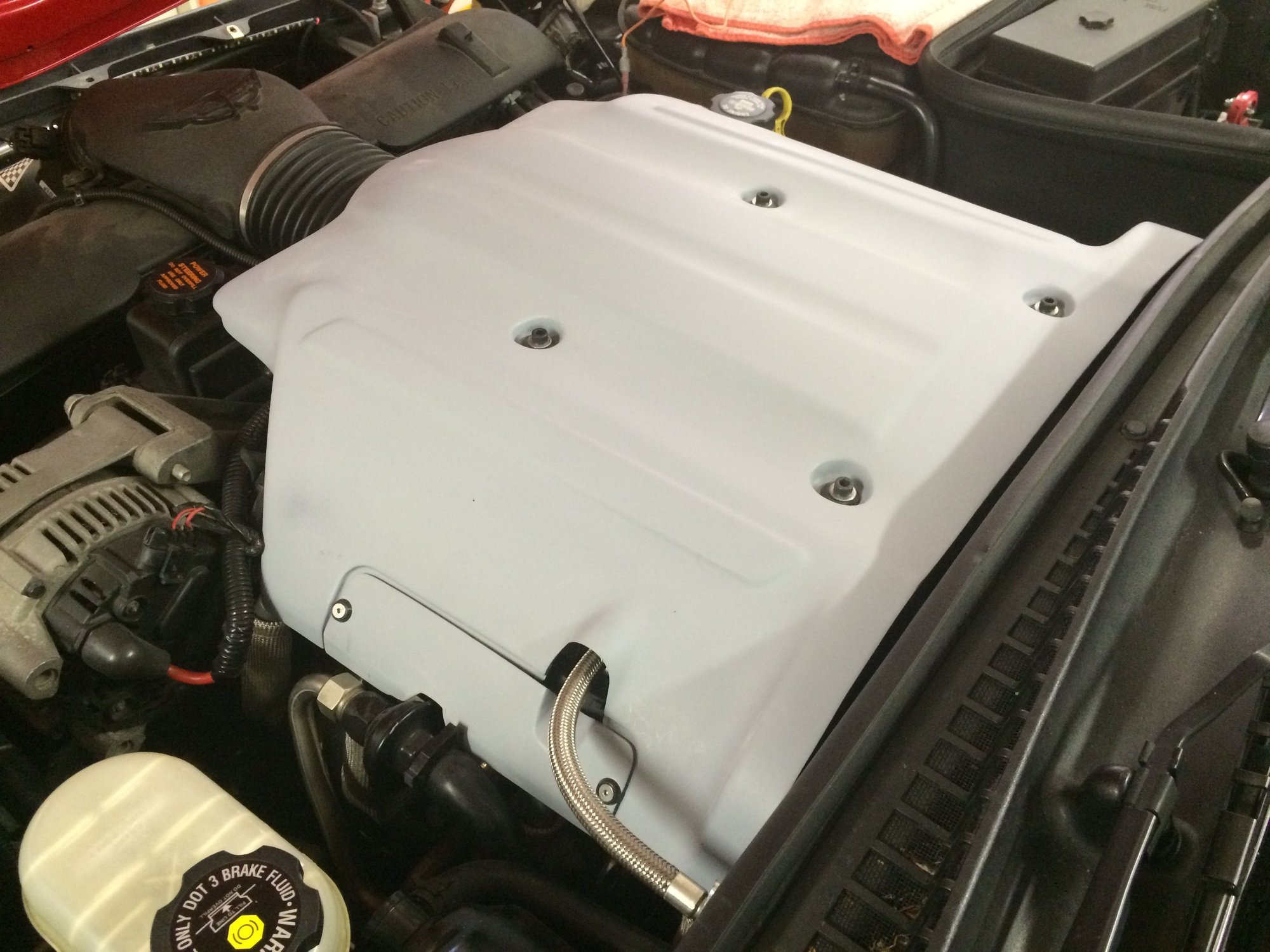

Have received a lot of glass fiber parts for engine dress up - here is a test fit of the 1-piece cover from DD Mods

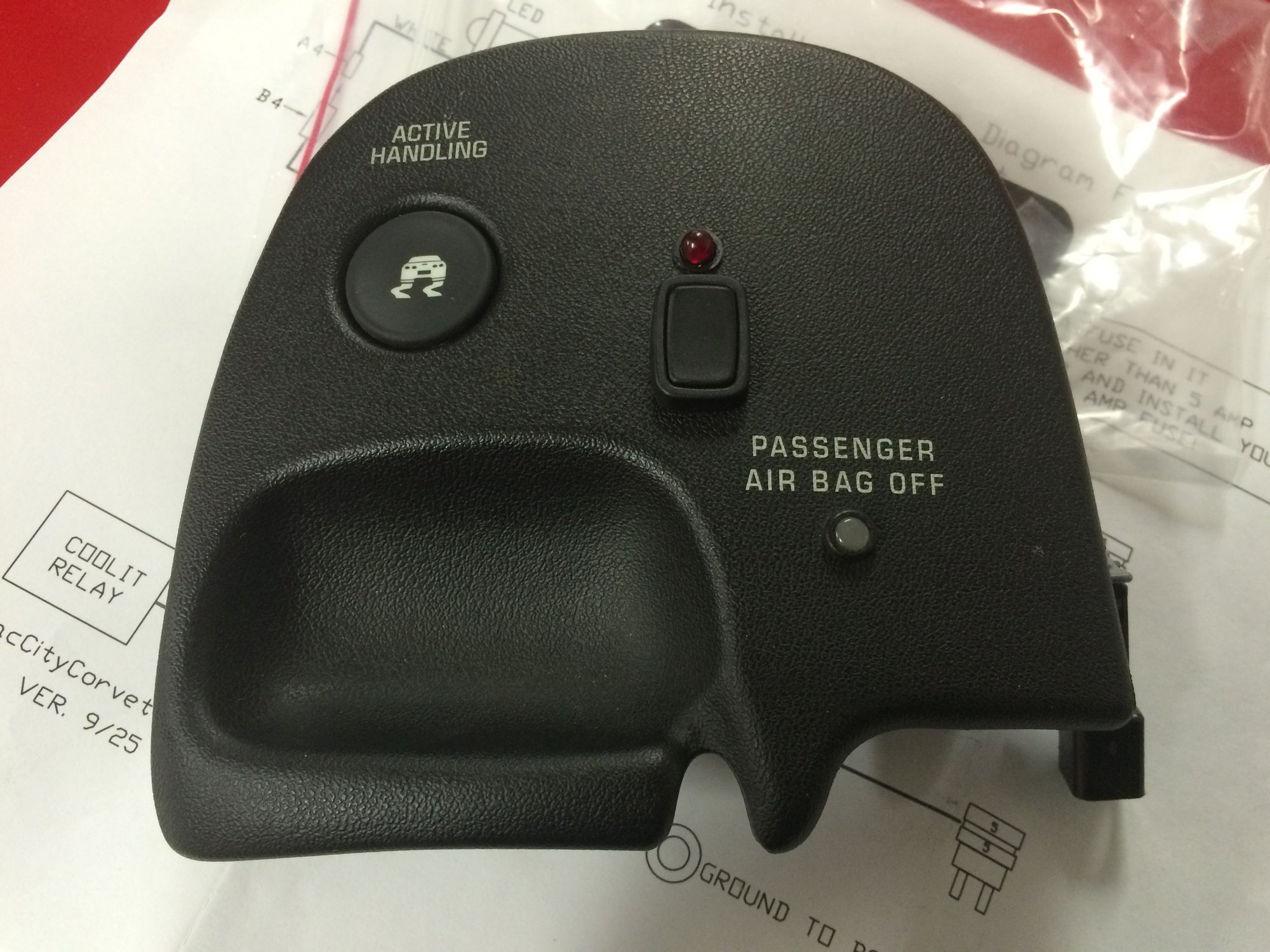

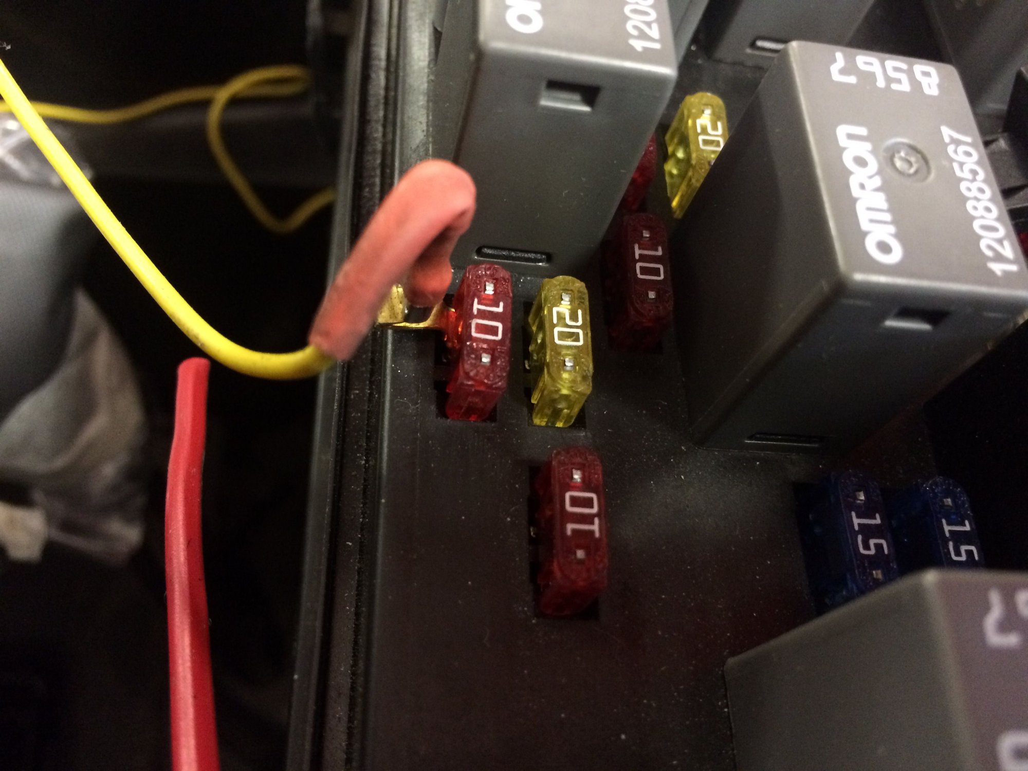

The switch for the CoolIt hardwire is mounted - looks almost as it is OEM. The other part of the kit is routed into the cabin and ready to install, when rest of the interior electricity is done.
I´ve used the top post battery terminals to make an easy connection for the battery charger.

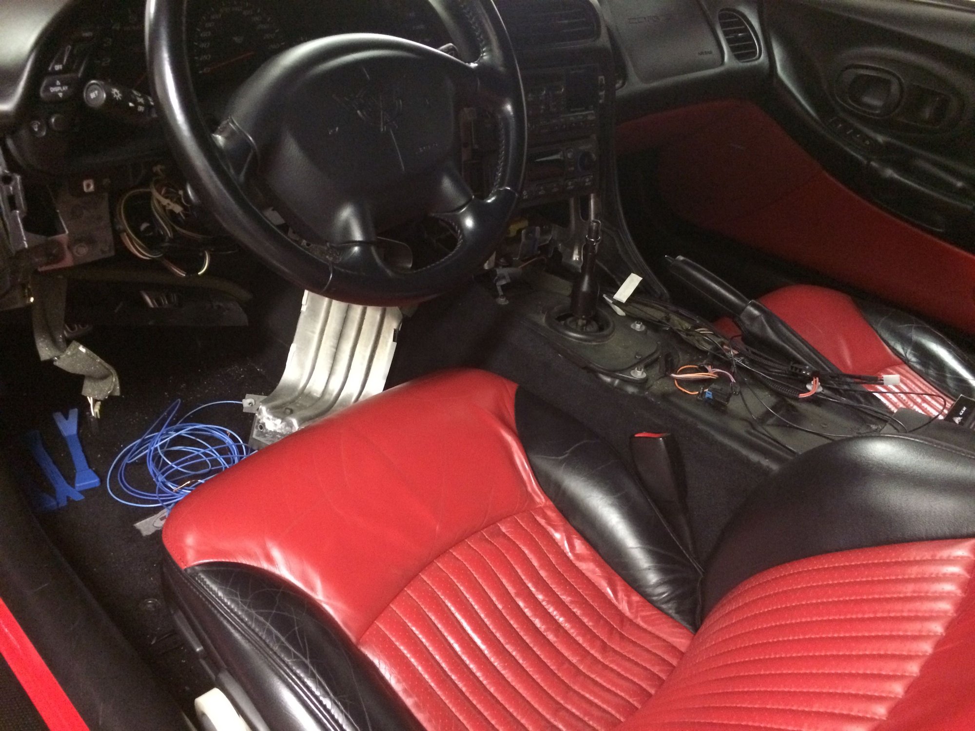

I plan a later project for the interior - but for now I just leave it as it is. I´ve made a temporary plate that mounts instead of the ash tray (can be deleted easy as it only pushes in as the ash tray). The plate will have a master switch for the new hood light, so it can be disconnected manual at car shows, daylight and working on the engine.
Hope to be done with all the wirering within af few weeks, so everything can be tested - but I´m still waiting for some parts to the extra turn signals on the front fenders (by Danish law).

The CoolIt is now installed and works perfect. Really easy to install and a nice quality product
I removed the Vinci fan controller, but found a mess in the fan harness were the vinci controller was spliced into the high fan hot wire. I´m glad I did this now as it would have melted the wire within few years...
The light package from Radioflyer was installed and tested today. And I can only say WAUW...! It makes a great diffence when replacing all the OEM lights. Didn´t shoot any picture with lights on but I will be fantastic when the paint job is finished and I can start the final assembly. It´s not permitted by Danish inspection to run HID headlights if the car hasn´t Automatic level adjustment on the headlight, so George made me a special kit with 6K LED´s in both high and low beam and installed a resistor in order to have the correct draw to raise the headlights. And it Works perfect. I´m amazed by the quality and finish in his products - it really supports the fact that you get what you pay for. Because of the distance (and the fact this is my first rebuilt/modification at this size) I´ve emailed him several questions, and he always gives an answer within very few hours. Bump for a very helpful vendor - and I can pass the best recommendations to everybody who is in the marked for his products
The Hood will be painted both sides and the OEM Hood light will be removed to make it look "clean". I´ve installed some White LED strips in front of the radiator and fitted a pressure switch to connect/reconnect ground when the Hood is closed or open. It is wired to a master switch in the center console where I can control it (e.g. at shows with all day open hood). I did not use the OEM hot wire, as I dont like to splice aftermarket accessories into the OEM harness. So its feeded by its own harness from the power outlet at the engine fuse center.
I can not describe how happy I was when everything just worked as supposed when it was powered up today. It is truly a satisfaction when all the wirering has been taken apart during the last couple of month
