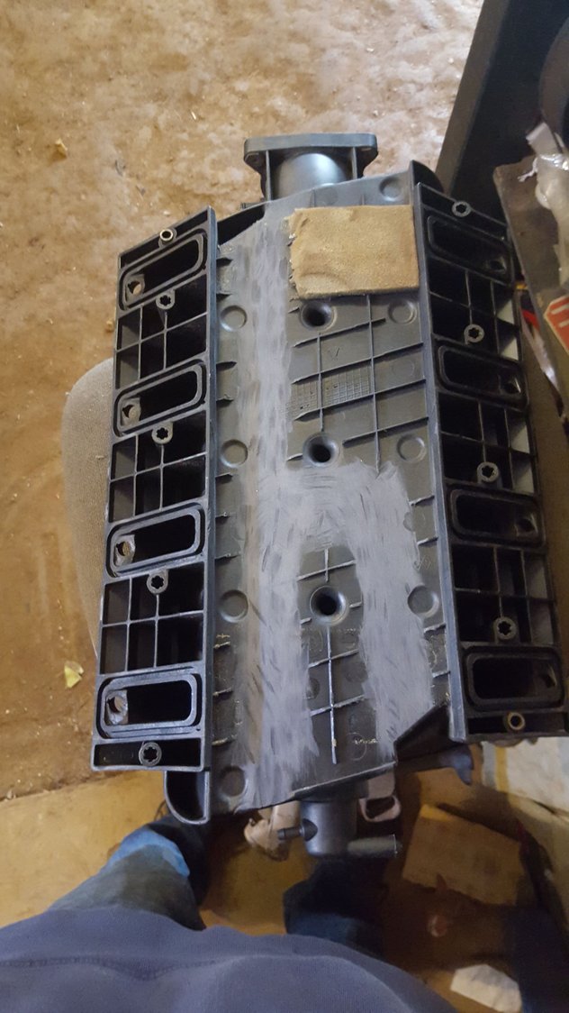

This is what I shaved off when I did mine.

Thanks for the picture. This should help me tons

Not to hijack the discussion, but in the pictures posted, I see that there's a piece of that "foam stuff" still attached to the bottom of the manifold. What is the purpose of the stuff?
The reason I ask, is because a couple of years ago, when I removed my intake, to access the oil pressure sender, I also put a sheet of the heat insulation barrier, on the bottom of the intake. In order to do this, I had to remove the OE foam pieces, and ever since then, I've been wondering if I made a mistake by doing so.
LOL! Sound deadening! What ever good it did. There are a LOT better products on the market for that. In fact, there's a dedicated heat shield just for the LS series of engines.
So,, NO,, you didn't hurt or miss anything.

I thought the foam was to keep dirt/debris/water from getting to the knock sensor holes in the valley cover, I could be wrong though
