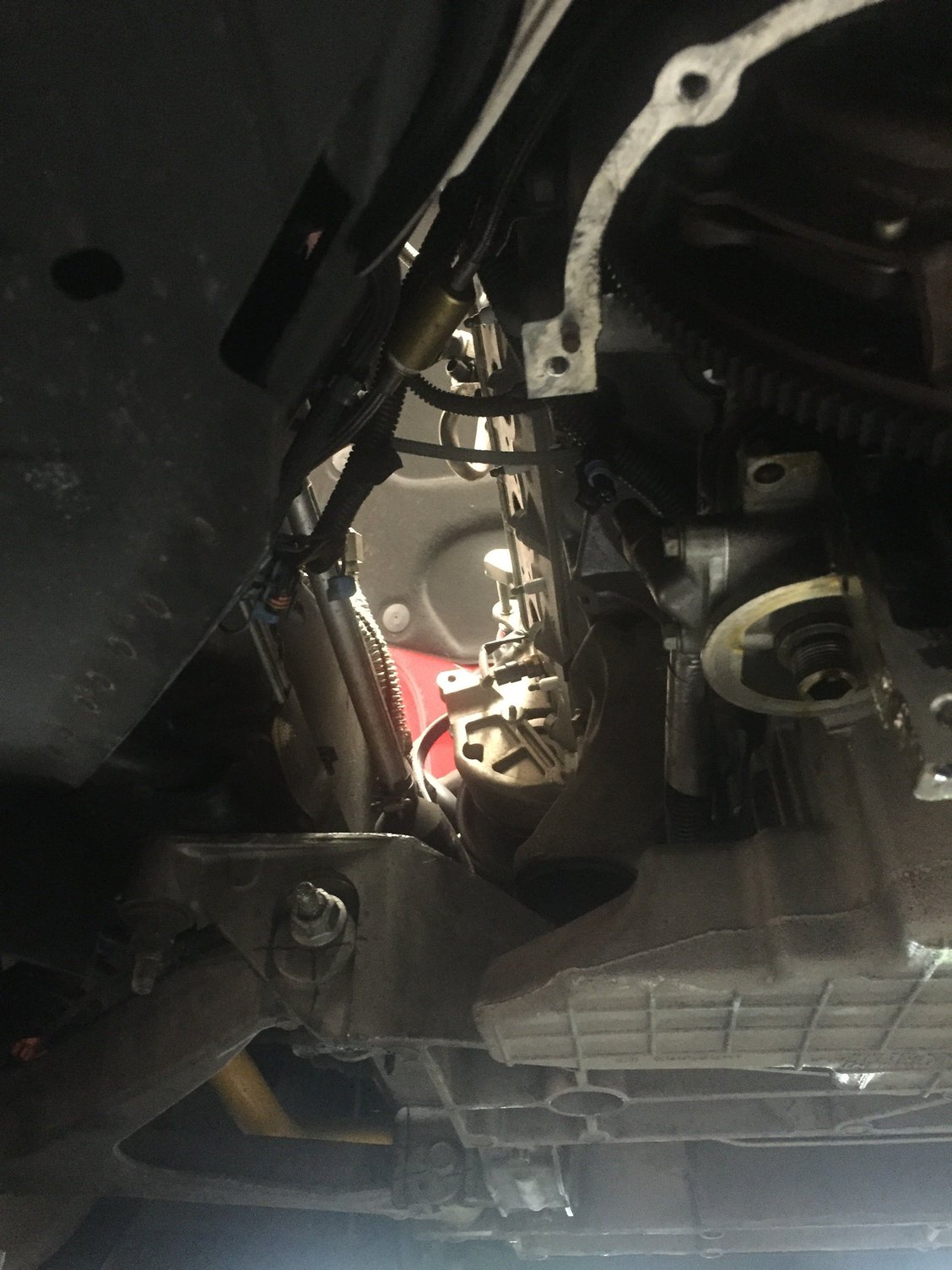

Success!
The problem was when going straight up the header flange would not clear the bell housing corner so I was trying to go up at an angle, front flange up which was not working at all.
I removed the bell housing cover and it gave just a little more clearance and slide right in when positioning the header flange straight.
Bell housing removed
20fa8078591b1c5fe2bd2057253.jpg[/IMG]
I just noticed that the passenger side header doesn't have the little metal block to secure the dip stick, I emailed Jon for suggestions
