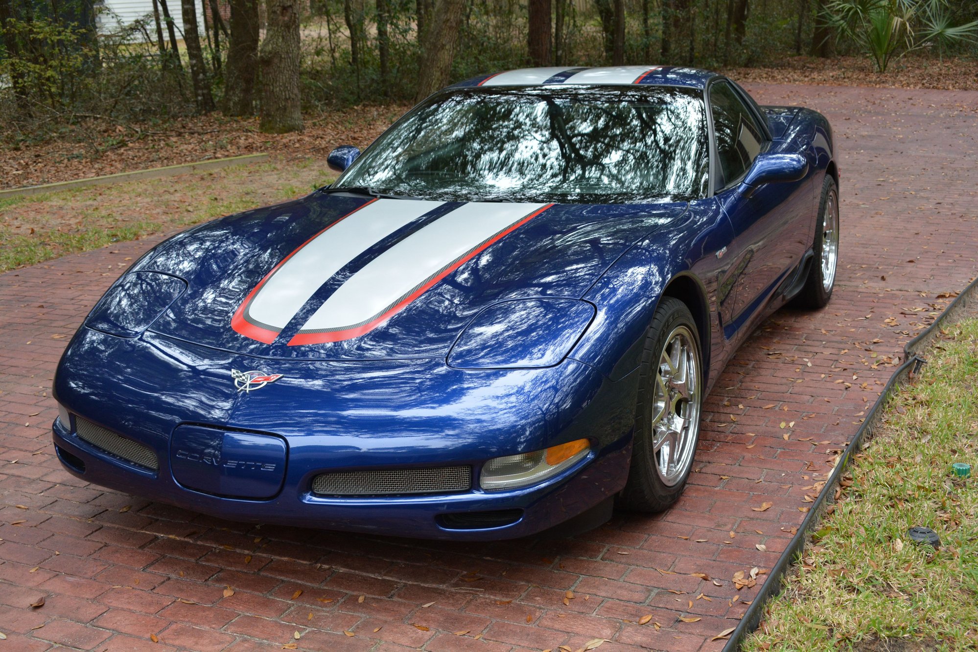

I priced out the cost of painting my Z06 and was told $6000 plus the cost of the Commemorative strips decal. Also priced out a total wrap and it was $2400.

Z06Berlin, not sure where you got the quote on the CE stripes, but you can get them from vettestripes.com. Mine are the same style, different colors.

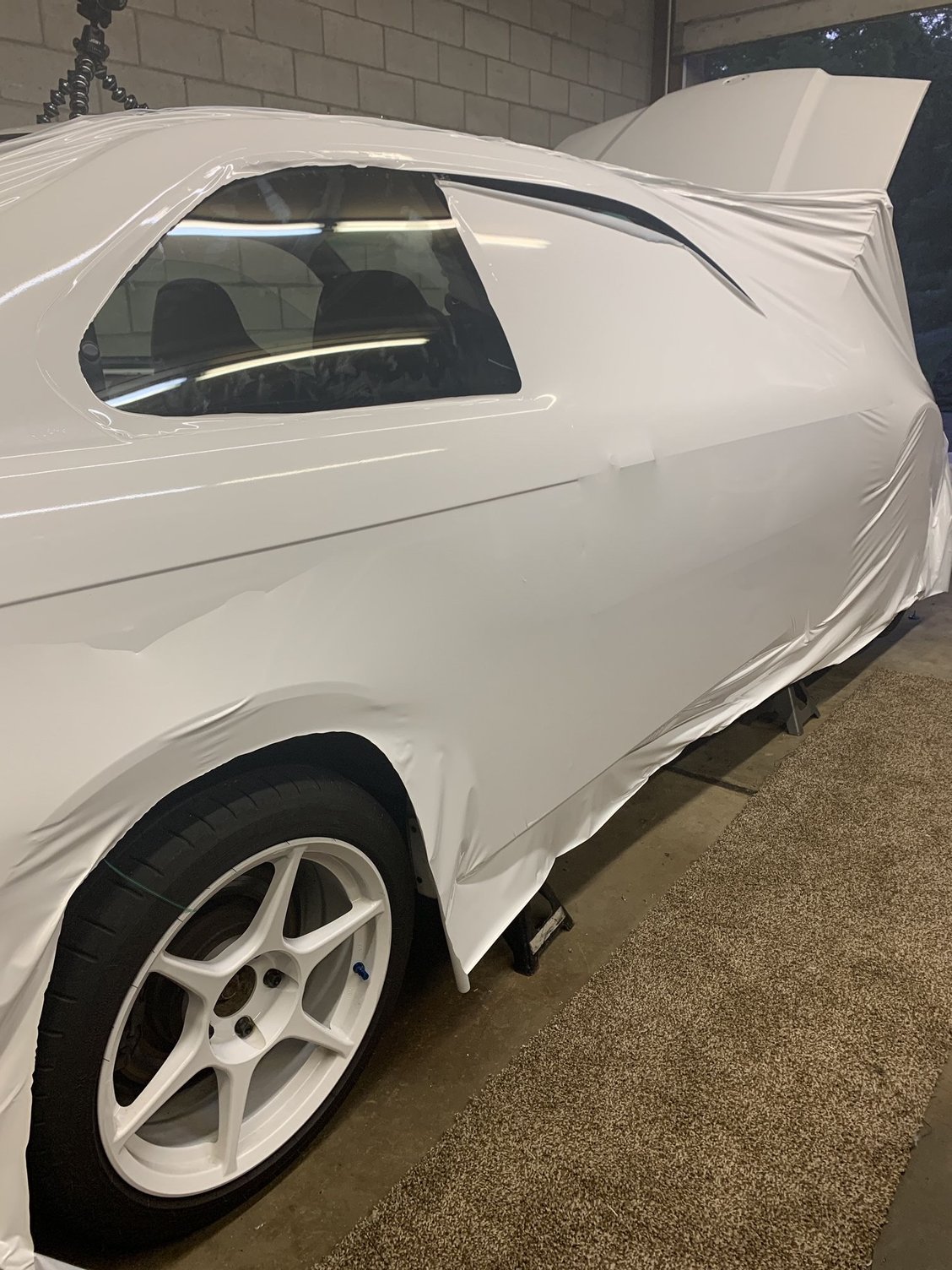

I didn't have any seams on my car at all actually. I wrapped into the cove area, but material was not going to make it to the opening. My car was black, so I did a visual trickery by cutting it in the shape of an opening to make it more aggressive/profound. Kind of like how the C7Z side vents are more aggressive in size vs the Stingray base. Even the FRC top was seamless, aside from a 1" seam in the center behind the window. No seams though anywhere on that car. Like I said though, I didn't wrap the rear and left it gloss black like the C5R was.
The actual opening is much smaller than mine appears
I then did the same thing in the front brake duct openings. Instead of wrapping into the opening, I cut it and made them appear more pronounced and opened.

KITT, I’ve seen that done once before and it was of course a black car to start out with. Mine is pewter, lets say I want to change to a bronze, battleship grey, grabber blue, or orange. I would not be able to get away with that.
You say the seam on the FRC was 1” behind the window. Are you referring to the panel on the rear deck where the trunk is?

Even with pewter you can do it. Just wrap the openings gloss black first.
Yes, the small strip that is the top, behind the window on the FRC is like 1" wide, I had a seam there. I basically wrapped the top, then down the sides and go bunching in the rear, but I cut it away, leaving only one seam in the back. Today that wouldn't happen to me and I'd probably get the top seamless. That being said, one could also just wrap the top until it meets down at the quarters, and just seam it there and you'd never see it.
