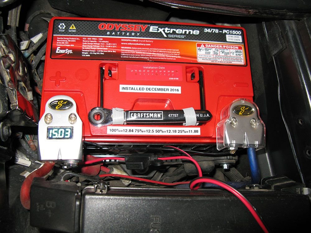

I went to Odessey this last time (so far, so good). I had a couple AC Delcos and a couple red-tops previously. This battery has a noticeable difference in cranking power...
