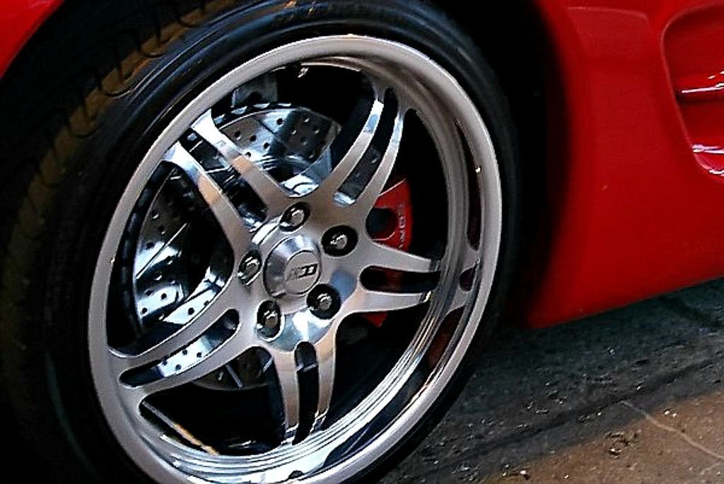

17 years old, 80,000 miles Baer Eradispeed +2 Two piece rotors with aluminum hats and aircraft fasteners and AC Delco semi metallic carbon ferrous compound.
