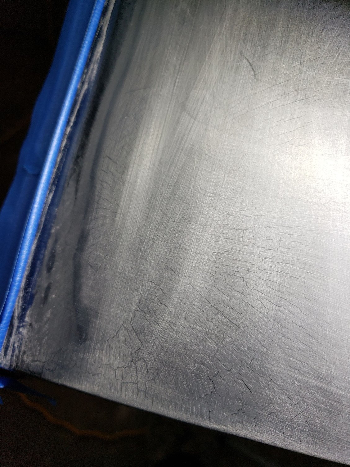

Here is a look at my cracks. This is after about 3 hours with the 400. I got them all out last night, but it was a exercise for sure.

Yikes!! I didn't have the cracks that you're showing. No wonder you had to use a heavier grit.

I can't be sure. But I do know that a lot of people that had rattles in their roof had a tendency to adjust and tighten them. What could have lead to stress cracks. I never touched the adjustment in my roof. There are small rollers in the roof mount on top of the windshield that freeze up and don't move that i make sure are lubed. Again this is just my opinion on what I have heard and seen over the last 21 years of ownership.

Defimitely. I have checked the adjustment on mine in the past. It doesn't help that my seal are shot as well. I was looking again at the OP pictures he posted. Looks like that is just a clear coat issue. He should have no problems getting that back to clear.

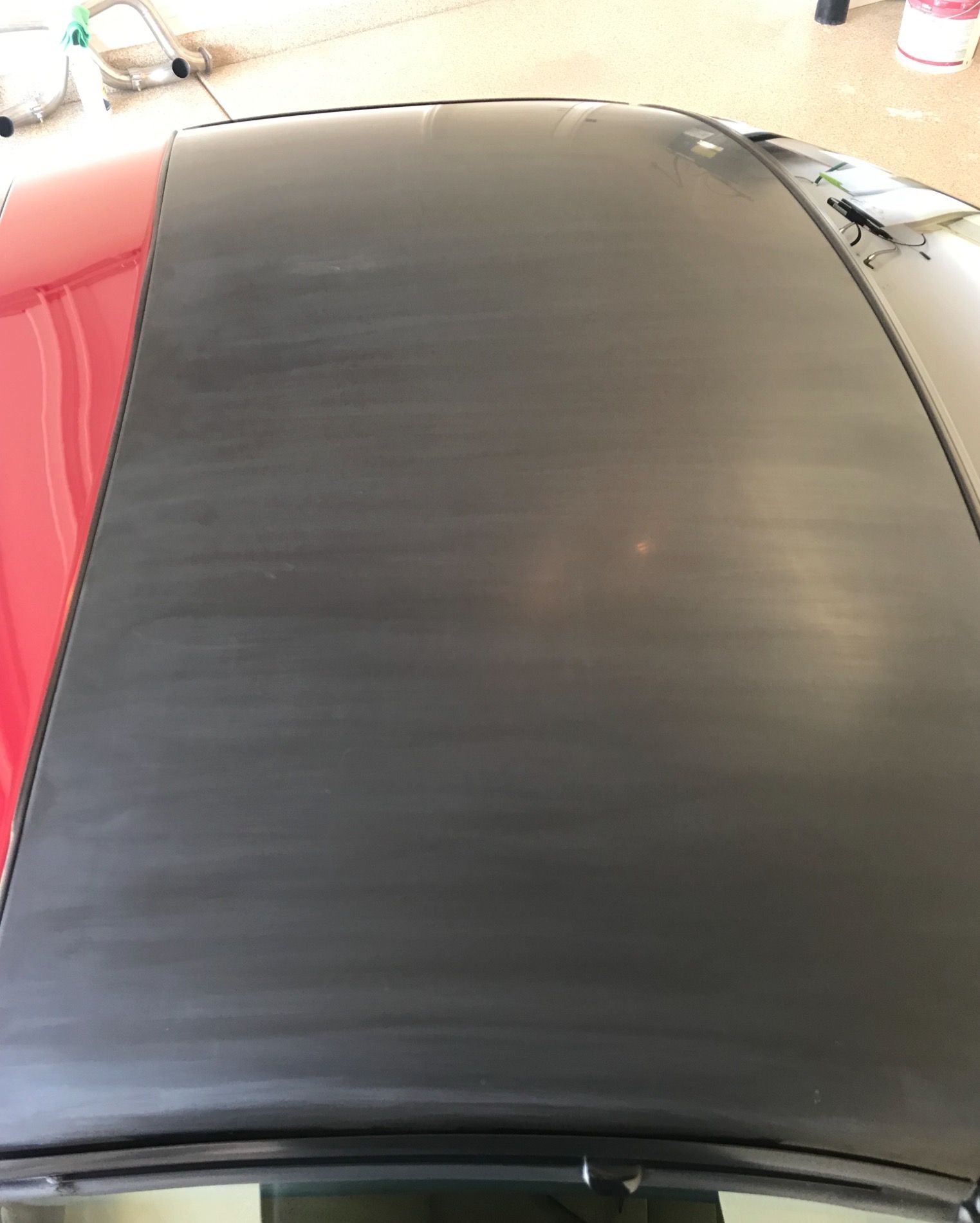

And we're off!

Spent about 3-4 hours yesterday with 800 grit to get off the acrylic finish which is a real pita. Still have a way to go. I would recommend an electric sander to anyone wanting to tackle this job. I didn't think the finish would be this stubborn.

Looks like you're making good progress. I used an electric on mine in combination with blocking it. It made a big difference. Bite the bullet and put 600 on that portion remaining. It wont hurt anything.
