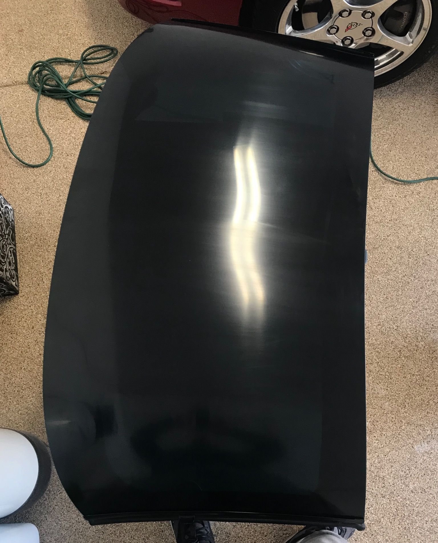

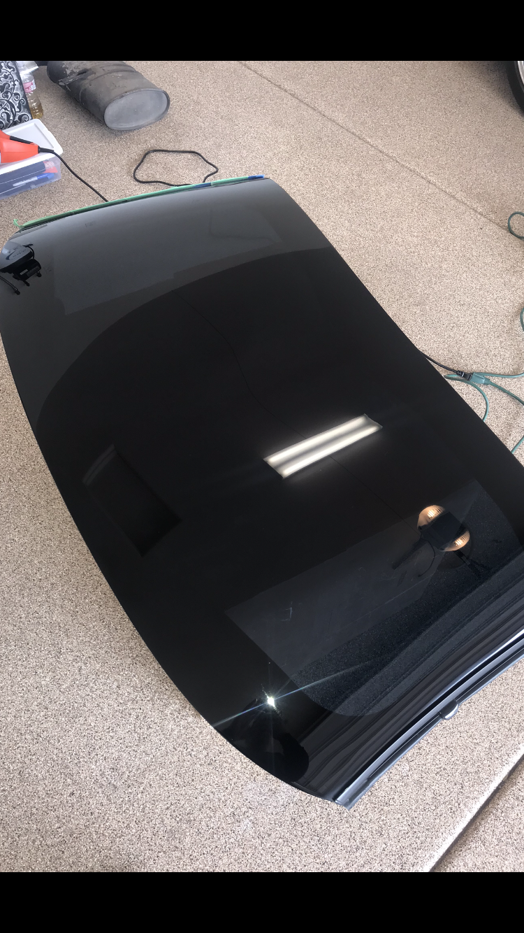

Im waiting to borrower a polisher from a friend. In the meantime I used some medium cut on an orbital just to see where I'm at. I'm happy with where it's at so far. There's a body shop about a block from me that'll talk to about clear coating it and see what they say.

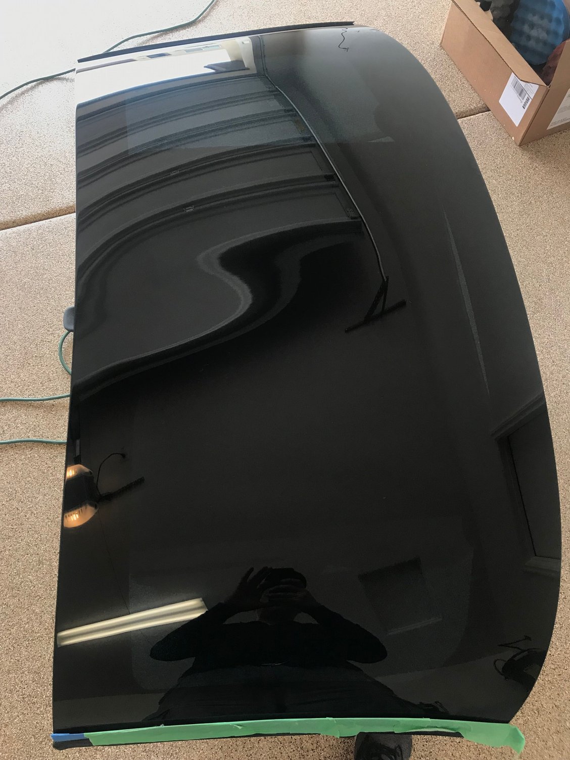

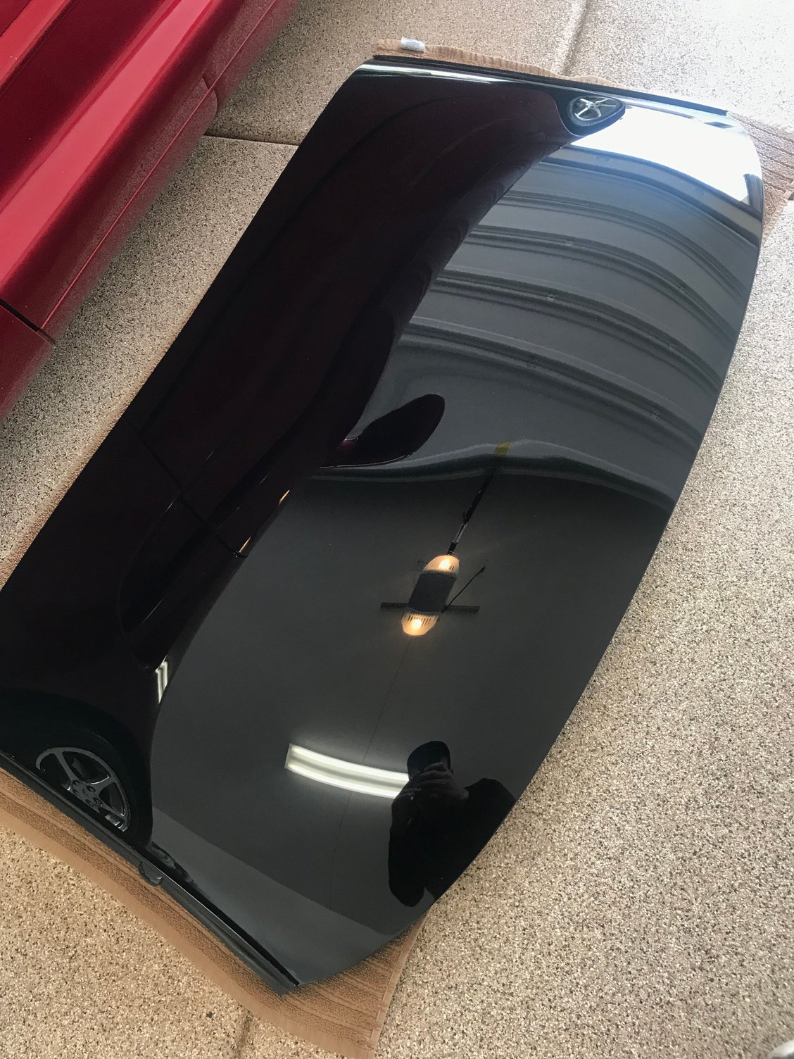

Thought I would share these final photos for anyone that is interested and give some final impressions. I had to take a step back and restart with 400 grit on one small section because of a very strange small spider web crack on the surface that appeared. Not sure if it was there before I started or if I accidentally burnt it while polishing. Nevertheless, I was able to get it completely out. I followed the instructions posted by others re sand paper grit and medium, fine, and 2.0 cut polishing. The only difference I made was using meguirers NXT wax on an orbital as a final step. There are still some very fine scratches from simply wiping the top with a microfiber towel but they are hardly noticeable. I am going to take it to a body shop next week to see about getting it clear coated. Overall, it def was more work than I anticipated, but I very happy with the result (as long as the clear coat lasts without cracking). Its obviously not perfect, but it sure is much better than that first photo I posted on this thread.

Looks fantastic. Made all the difference in the world when it's on the car. I'm going without clear and see what happens. Keep us posted.
