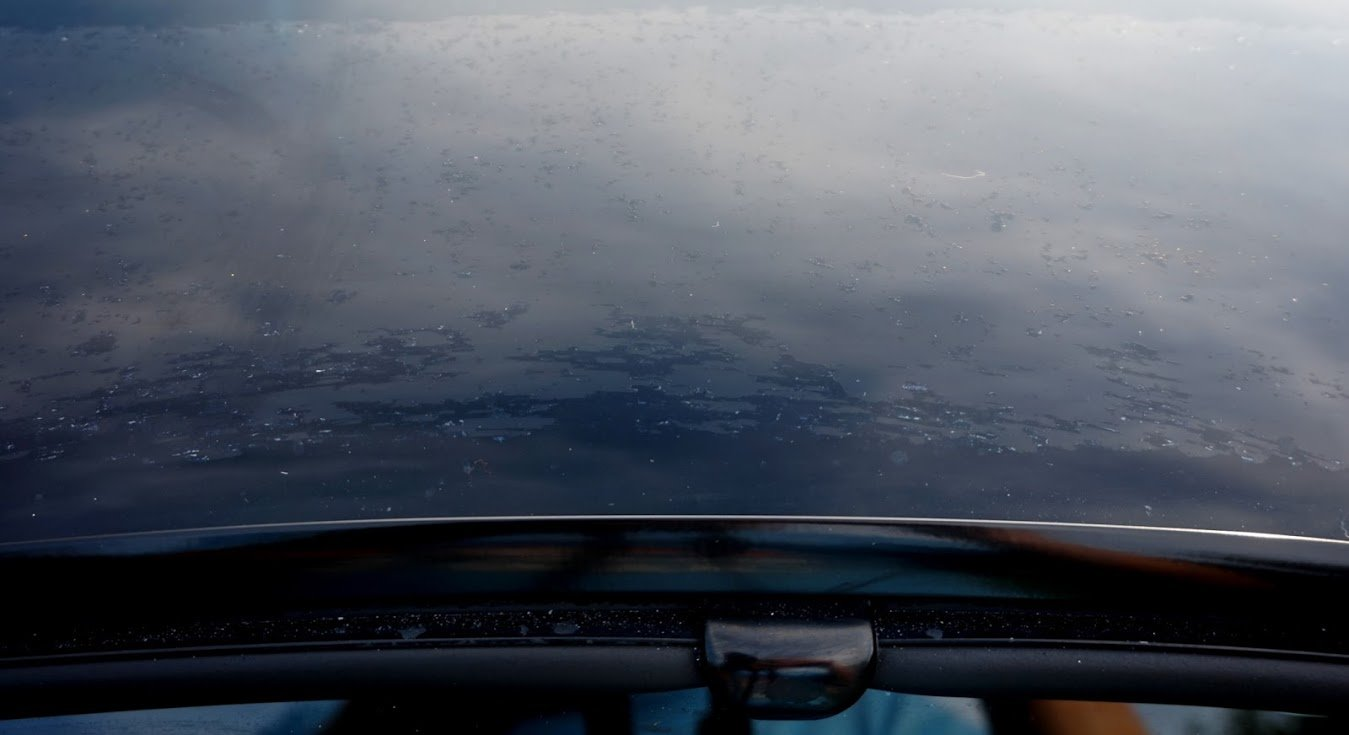

40k miles garage kept and still looks like this

Because AZ? and Because old Chevy?

I would say, probably never had anything on it to protect it from the sun. UV protection.

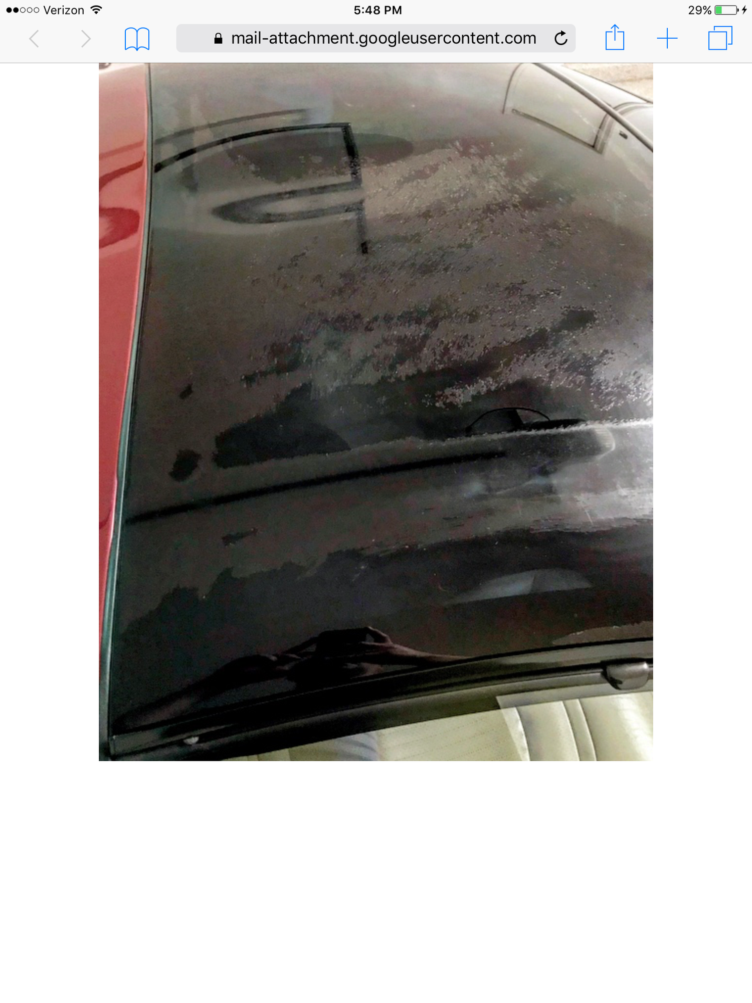

I bought my C5 used around 2010 and my roof looked worse. I found one on CL for $300 that was pristine. The guy used the painted one and kept the clear one in a spare bedroom. Within a couple years it started crazing too. I was pissed. I had planned on having it painted, but ended up selling the car to buy a C7.

Unfortunately, this is "normal". It was a common problem not long after these cars were new. Mine looked the same when I bought it and was also a 40k mi garaged car. Looked like someone messed up when detailing and took a rotary buffer with sandpaper right down the side of it. I researched it last year and found out it was a common issue, especially on the passenger side, which is where mine was. Not only was there heavy delamination on that side, but I had spider cracking (not actual cracks) throughout. I spent a weekend refinishing it and it's 90% again. If I would have hand sanded with 400 grit first rather trying to take the easier route with a machine sander, it would be close to 100%. It looks fantastic from outside the car, but inside looking up, you can see small imperfections. I rarely use it but figured it would be a fun project. I may have been wrong on the fun part, but it got done. The lexan is TOUGH by itself, but getting the factory tint/UV protectant off was the most difficult part by far. You may have better luck, it seems to be hit or miss on that part. There are multiple threads detailing refinishing them. Cost me about $100 in supplies and two days worth of vigorously working at it....or you can buy one that's in better condition for $400-800 most of the time. To put UV protection back on it, I just used a couple coats of JetSeal from CG.

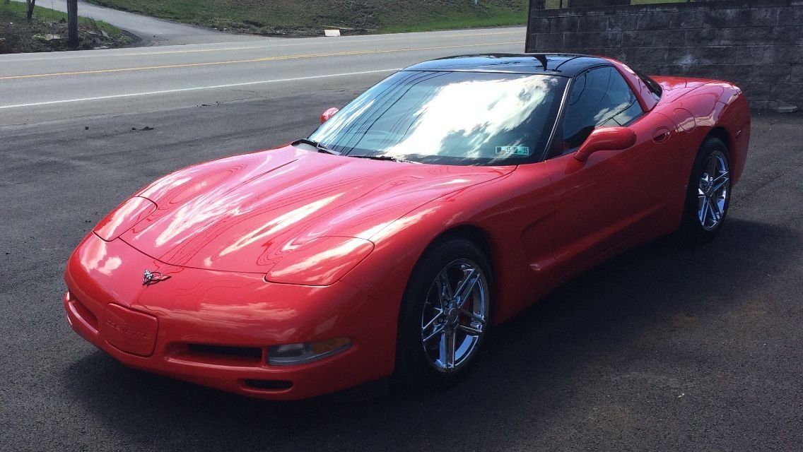

I can't speak to this as a common problem. All i know as the original owner of this 98 is I have protected this roof from day one with the same product that i put on the Painted surfaces. I have some rock chips on the leading edge, but other than that this roof is perfect. So in my opinion it has been UV protection that is the key. And i do know that in the past in threads about these tops. People were using things for Lexan to clean, That was harmful to the clear.
