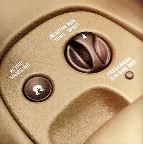

I'm looking at buying a 2004 Commemorative Edition convertible. There are a couple of really nice, low mile candidates within a 10 hour drive. Only one has selective ride control. How big of a deal is that? Is there a really noticeable difference?
The car that has it is the furthest away (of course). I'm wondering if it's worth going the extra mile(s).

I have it and wish I didn’t. Not that functional after 14 years and the shocks cost 2-3 grand to replace. You will end up just putting in regular shocks and rendering the whole system useless. Oh and not to mention you will have to either buy simulators or spend money tuning the feature out of your car since if you install normal shocks without simulators it will send the car into limp mode. My advise is buy one without it.

my CE 04 has it or had it. Never could tell the difference between settings and this past year it was time for new shocks. 4K to replace all around so went with C6 Z06 shocks for less than $400 installed including reprogram to fool the computer into think the sensors are still operating etc..
So no you really don't need them, its a :: if the car already has it type option

I haven't noticed a difference between tour and Sport. Nice to push the button and turn off traction control just feels more real without traction control but other times I want it on. I say go for it and get the one with Selective ride

On my F45 system, I felt that having larger sway bars (C6 Z51 front and rear) made the different settings more pronounced. I plan to upgrade them to F55, which should be better.
F55 shocks new are about 1600 for the set. Many F55 Corvettes have shock stuffers that the dealer never removed, which make the ride harsh.
I like it because mine is (was) a daily driver and comfort with the ability to tighten up on the fly is worth it to me.

Not worth it because repair cost is high,there is a noticeable difference between the 2 settings.Just add C6 sway bars to a C5 to help in handling.

I have it on my 04 convertible and can easily notice the difference between the sport and touring mode. Touring mode reminds me of a car with worn shocks. It really softens up the rear. Front not so much. I only use touring mode when the roads are in bad shape, which is often in NJ. Sport mode is stiff enough and car handle's fine in that mode on the street. Plan on installing Z06 sway bars, will see how it helps the handling

While you're in there, check to make sure your front shock stuffers have been pulled out. It wouldn't surprise me if the dealer pulled out the two rear ones and not the two front ones.
