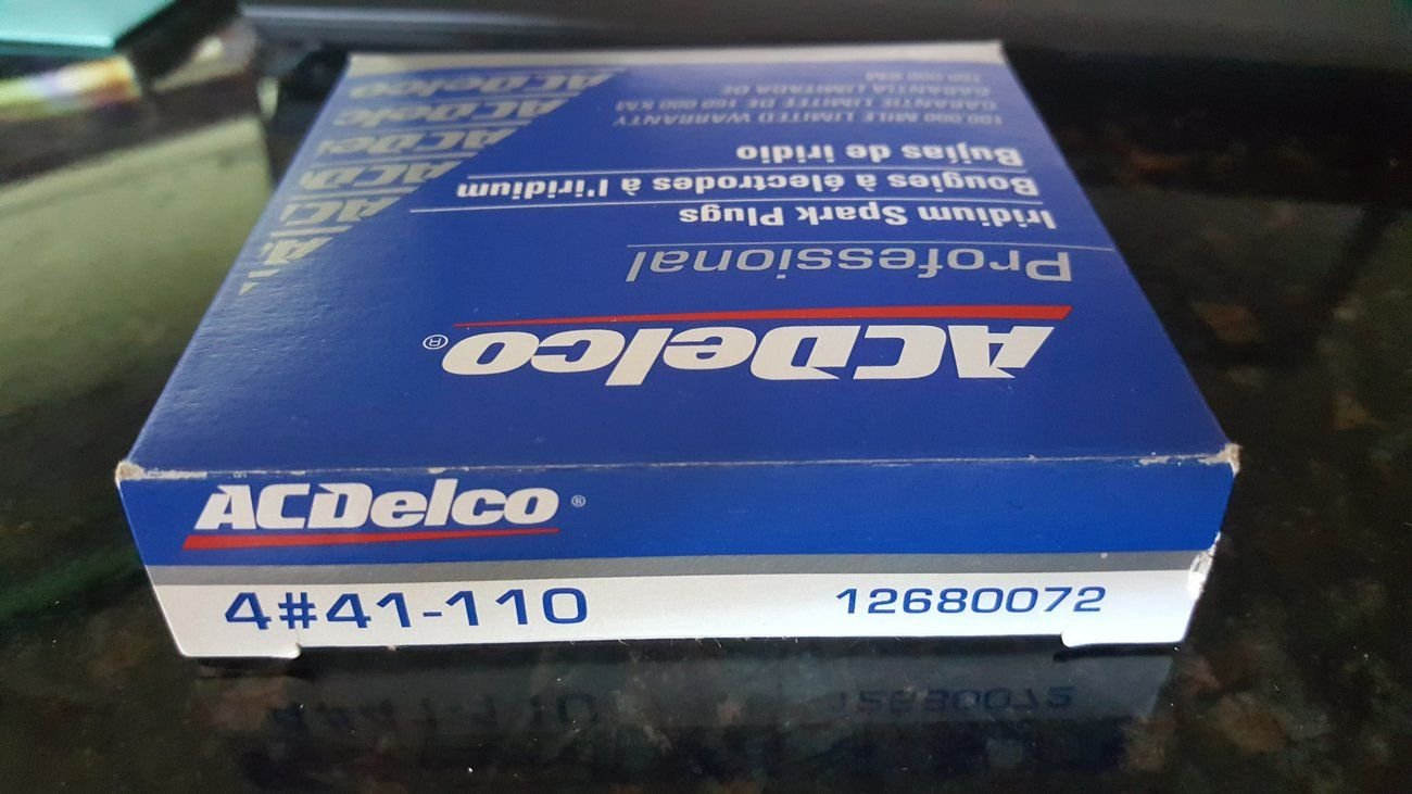

I am trying to replace my spark plugs on my o4z..what is the oem plug and part number please? I looked up 100 different part numbers and it keeps changing..wtf.

AC 41-110 comes to mind.

i just ordered the 41-110 ..the dealer only has this number is 41-162 and they are$11 each..

amazon is saying the 41-110 doesn't fit my car 2003 z06

AC Delco 41-110, just changed mine and new AC Delco red wires.
Sometimes Amazon is wrong. Not sure this is one of them. GM and ACDelco list the 41-162 as the replacement for 41-110 in pre-2014 vehicles. No idea why, since the 41-110 and the 41-162 are iridium. In that case the iridium wins, with lower voltage and longer life. I just went with NGK to make it easier...

I believe the 41-162 replaced the 41-110. I just installed the 41-162 today, which I purchased through Amazon for $7.49 each. I also completed the $3 per plug rebate on ACDelco's website.

i checked 41-110 and 162 for the gap and its the same..not sure what the difference is?
I posed this same question to C4/C5/C6/C7 Specialist Paul Koerner and his reply to me was this:
"The story is ACDelco is wrong from a technical aspect.
They are doing it for pricing so that they will sell more plugs at a cheaper cost.
41.110 is the ONLY plug I put in any LS1 LS6 LS2 LS3, applications for LS7 and LS9 are different.
All the best, Paul "
Paul seems to know his stuff so I'll take his word for it !

Hmmm, the 41-110 are cheaper than the 41-162... Great, I installed the 41-162 because all the sites, including AcDelco, showed that to be the correct plug but now I'm wondering... I know the plug Gap changed and I originally thought that was the difference, but someone here said it's the same on both plugs.

Amazon is wrong this time. I had my mechanic put in Delco 41-110 plugs (0.40" gap) #12621258 and the red spark plug wires.
