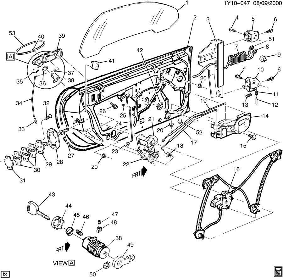

I have no idea how this could happen except something striking it. We are talking about #38?

yes, #38 and i was thinking the same thing but was hoping for a known gremlin...

As the lock lock cylinder goes into the handle ( from the backside ) it’s supposed to snap into it . There is a tube built into the handle that the lock fits into perfectly. They made a steel spring in a OVAL shape that fits over that sleeve on your handle. So when you push the lock cylinder into that sleeve it spreads out enough to let it in and then snaps tightly around the backside of it. Perhaps someone did push too hard on the key and it slipped past the spring. Can’t imagine it just fell off. Or it was done deliberately, again I’ve worked on cars since 1971. It just might be possible to remove the trim panel on the door and push it back in to the sleeve on the exterior handle. MAKE SURE YOU LINE IT UP CAREFULLY ! It has a notch on it the matches the groove in the handle so pay attention. I normally insert the key into the lock as soon as it’s partway in the handle to keep the cylinder lined up. The key should be straight up and down. Let me know how it works out or if I can be of any help. Good luck

Thanks for this info. I am going to open the door panel this weekend and see what's going one.
