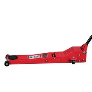

Check this out for a good post on this matter. It's for a C6, but it applies the same to a C5.
A good floor jack is essential.
The ATD-7325 (same one as the Omega 29023, just under a different badge) is very well regarded here. You can see it
here here
It's been discussed in depth here.
What really separate this one from the pack, besides its extremely low profile, is its length. It allows you to reach the front and rear crossmembers from the front and rear end of the car respectively, in order to raise the whole axle. It can also accommodate a cross beam adapter like the one Summit offers, allowing you to touch only the preferred jacking points.

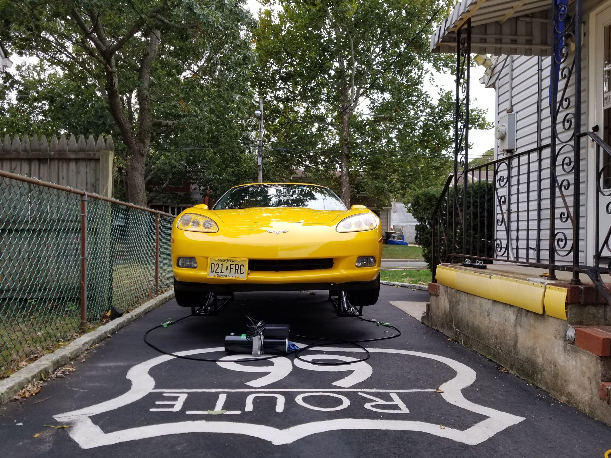

I just purchased the 5000 lb quick jack and don't have a garage , but had a good size shed built for my tools so everything goes there. they weigh 75 lbs each. It does work great
and is worth it.

Originally Posted by GCG
A good floor jack is essential. The ATD-7325 (same one as the Omega 29023, just under a different badge) is very well regarded here. What really separate this one from the pack, besides its extremely low profile, is its length. It allows you to reach the front and rear crossmembers from the front and rear end of the car respectively, in order to raise the whole axle. It can also accommodate a cross beam adapter like the one Summit offers, allowing you to touch only the preferred jacking points.
That's a very nice low-profile floor jack. Kinda pricey, though.
