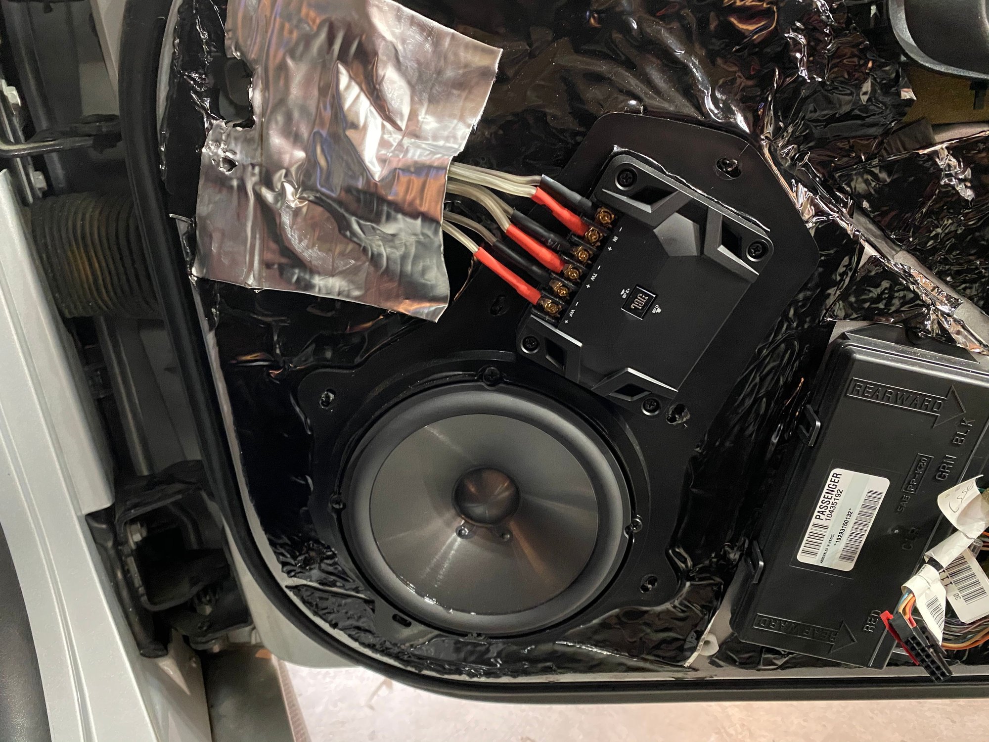

I did the small Sound Ordinance 4 channel amp (75w per channel) and the Sound Ordinance under seat 8” powered sub with remote and by passed all the aftermarket harness part for sounds. Used JBL speakers and aftermarket plates. Tweeters are mounted in the dash pad and the crossover mounted where the upper speaker would go on the aftermarket door plate with the component woofer in the lower part. Replaced the rears with same line from JBL as fronts. Wave breakers behind the door and rear mount with sound deadening through the car. Very nice little system for very little money. If I had to do again I would change the speakers to the Focal line.

I opted to take all of the factory crap out. Bose is history. Good Riddance. I picked up an aftermarket 4-channel amp and new front and rear coaxials. I massaged 6 1/2" speakers into the front and back and now everything sounds waaaay better than stock did. I also have a sub amp and sub to mount on the truck eventually, but I'm undecided on how I want to design my box.

Old Apr 12, 2020 | 06:12 PM
dskinsler83's Avatar
dskinsler83
Joined: Apr 2019
Posts: 1,562
Likes: 324
From: Morristown, TN
