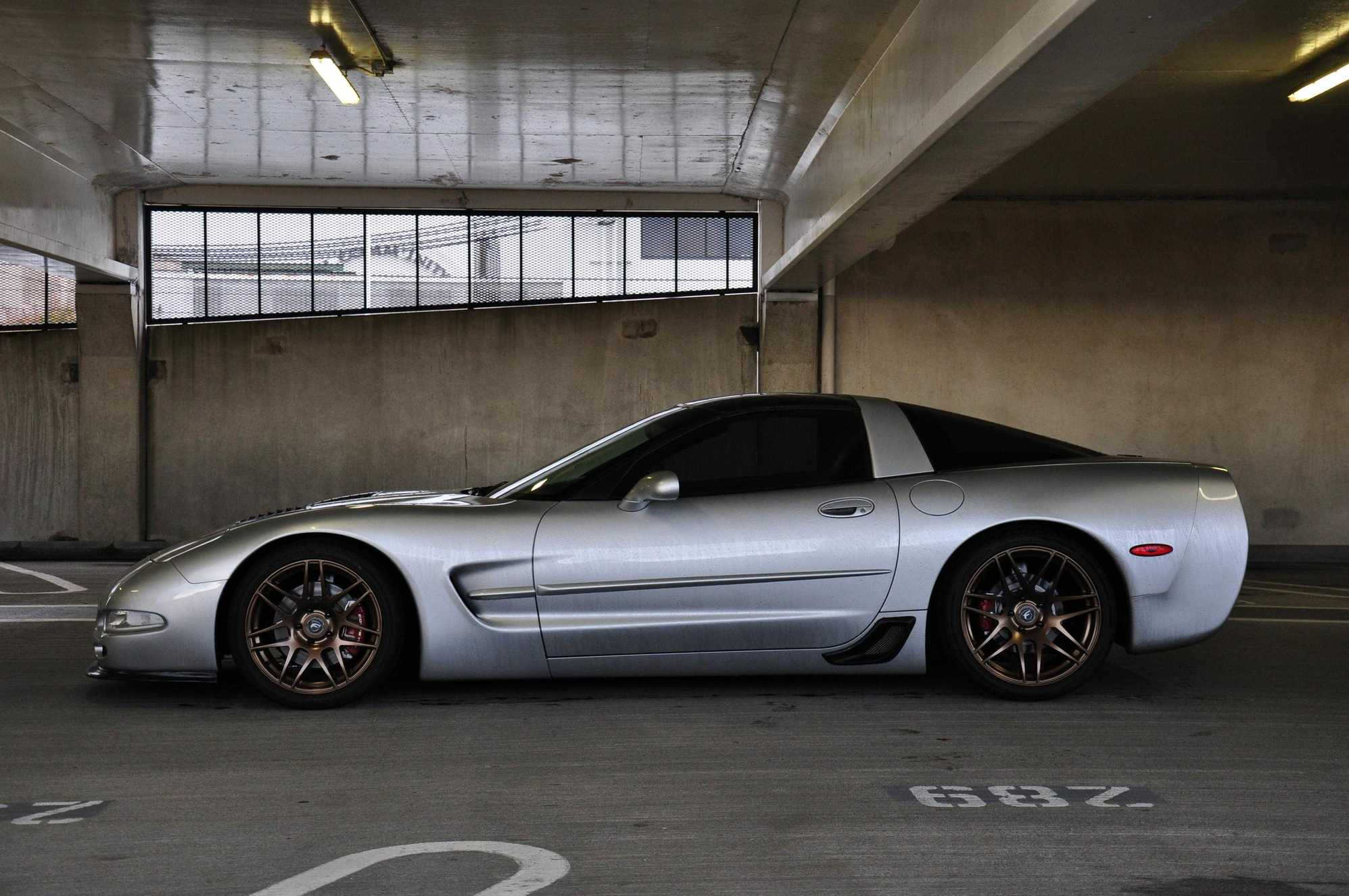

Nope. It has stock front bolts, ran down all the way, with all the rubber pads chopped off. And in the rear I run 7" ZIP Corvette bolts, and they have 3/16" of thread sticking out the top of the nuts left, and that is it.

Hmmm. I ordered mine in a custom offset...at the time, no one else was running +53, so they made me a bespoke set. Turned out fine, but that was some years ago now, things these days have most certainly changed :/

For as long as Forgestar has been in business, their standard offset for a 19x11 rear, in C5 fitment, has been a +53. CCW's standard offset for a 19x11 has always been a +54.
Just my opinion but I don't think either offset is enough, if you want to run a 305 tire wider than a Hankook.
