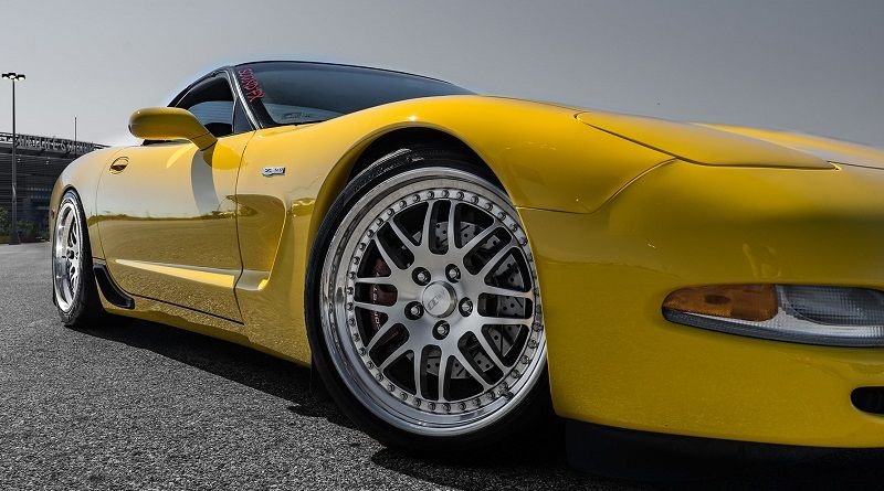

Great thread thanks. Had not seen that one. Here is a picture I took from that thread. 19x11 with +55
305 30 19 is the rear tire I will run. Same in this picture. A tick of poke.

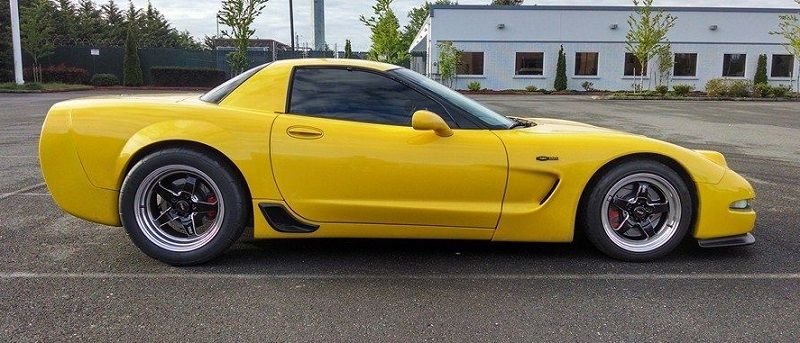

That must be one of the widest 305's. Here's a photo of my car, when it had the oem fenders. Wheels were 19x11's with +54 offset and Hankook 305/30/19's.At most, poke was no more than 1/8".
its funny I have seen some like yours that seem to tuck nice and others that don't. Your car is what I want it to look like .
