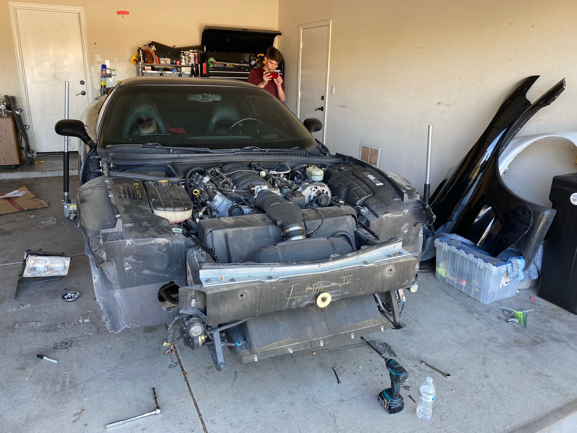

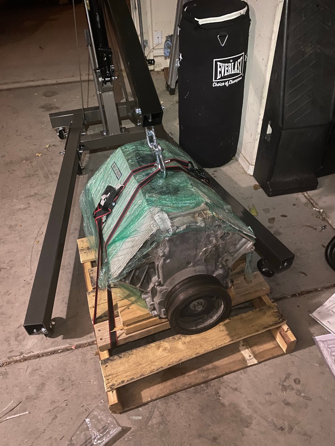

Started the tear down today. Picked up the new engine last weekend.
