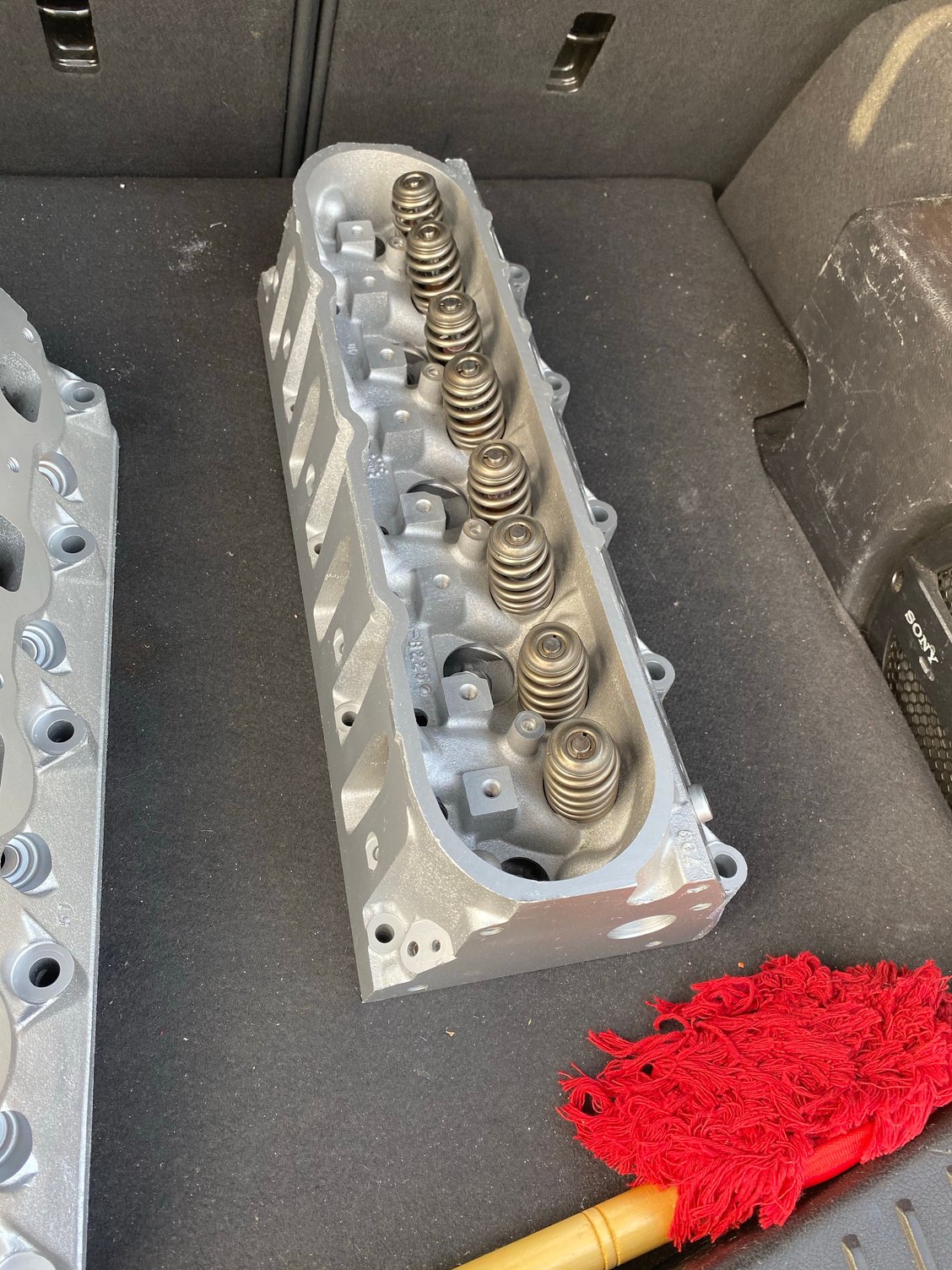

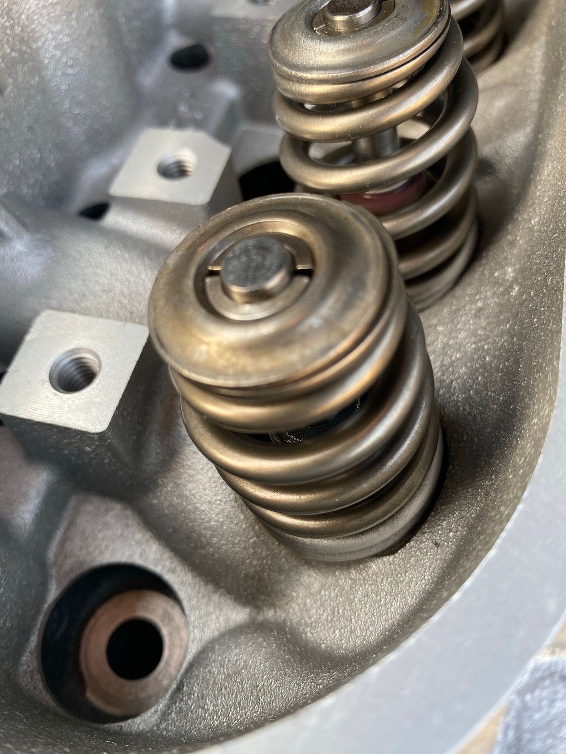

Just got these bad boys home.

You sent the heads for a valve job at a local machine shop?
Just curious what they charged.

Rebuilt with spring upgrade $300
cost of heads $300
$600 total.
great guys. Local shop in mesa.
