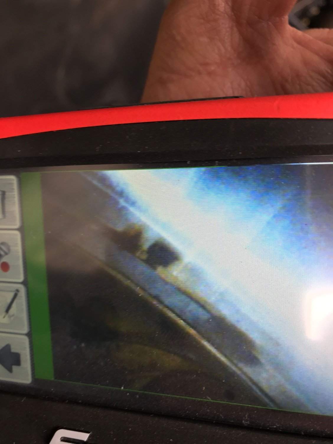

Unfortunately I have lost compression in the #1 cylinder. I believe I have located a suitable replacement one state away and plan to pick it up next weekend. The replacement is a bone stock LS1 out of another Corvette. Should be plug and play. Whilst I have it out on a stand I figure it will never be easier to work on. I will definitely do a water pump, swap for an LS2 timing set and definitely do a harmonic balancer.
I am toying with swapping for 243 heads and also thinking about doing cam, springs, lifters and trunion upgrade since the head swap will require pulling most of that stuff anyway. Is it worth the hassle or should I just leave well enough alone with the 241s?
Is there anything else I should consider while I am in there? Cost is a consideration but I have a little money to play with. I mostly just cruise with an occasional track day. I am also up for any suggestions for the cam.

I don't get it? You lost #1 cylinder in your present engine.
You buy a used engine and change everything but the cylinders?
What makes you think ,you won't lose #1 again.
You could of saved money and either looked around for a deal on
a crate engine( they are out there). Or just rebuilt what you have.
Anyway , check those cylinders.
Good luck
I have been warned that the sleeves are so thin that it may not be repairable. I am also thinking the bottom end is not typically problematic on these. I just got lucky. The main reason is the replacement is a fairly low mileage, my build will be pretty mild, and it raises price significantly to do the bottom. Honestly I would love to, but don’t want to put this on a credit card and I have about a 5K cap on what I can spend at the moment. I am spending about 2K on the new engine, about $300 for the 243 heads plus about another 3 to have them checked and prepped and reassembled for install, plus a gasket and seals set for a couple hundred, harmonic balancer is another $400 or so, a clutch set will be close to a grand, cam kit around $1000 all in, you get the idea. I would just wait and save a little longer but I daily drive this car and count on it for transportation. Honestly I may just drop the new engine in as is only swapping the heads and let it go at that. When things pick up for me in a year or so hopefully, a great crate motor or full on rebuild will be much easier to come by. I am just not willing to go into debt to do this. Doing a bottom end build will be a minimum of $3000 from everywhere I have seen...
All that being said, I am very open minded here. If someone has a viable option for me coming in at around $5K I would be grateful for the information...
