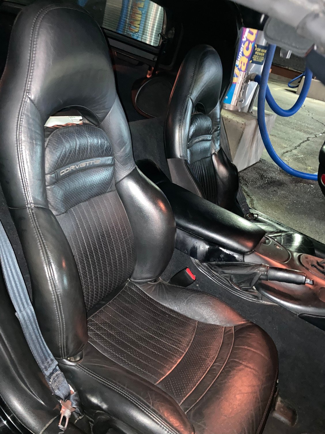

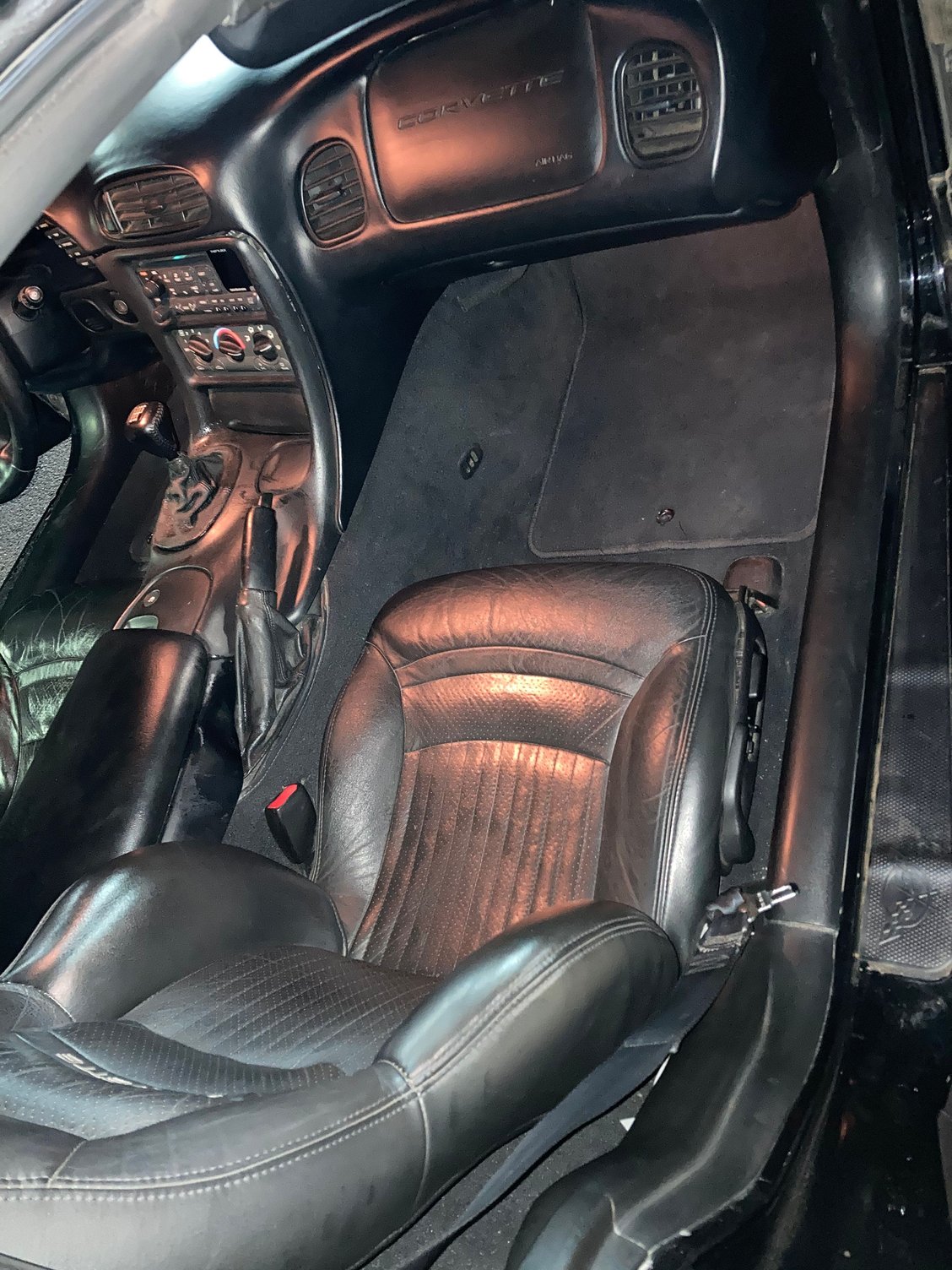

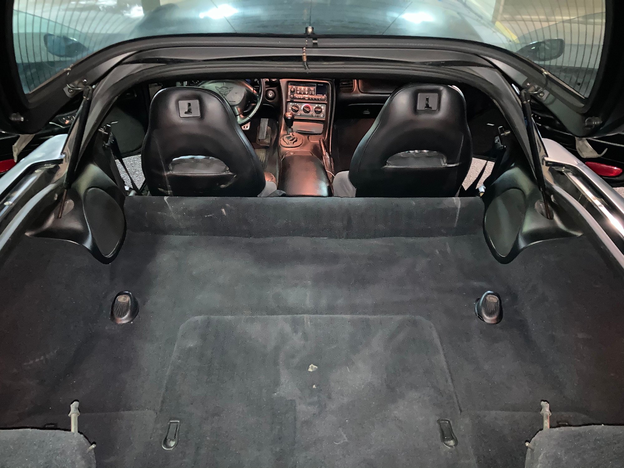

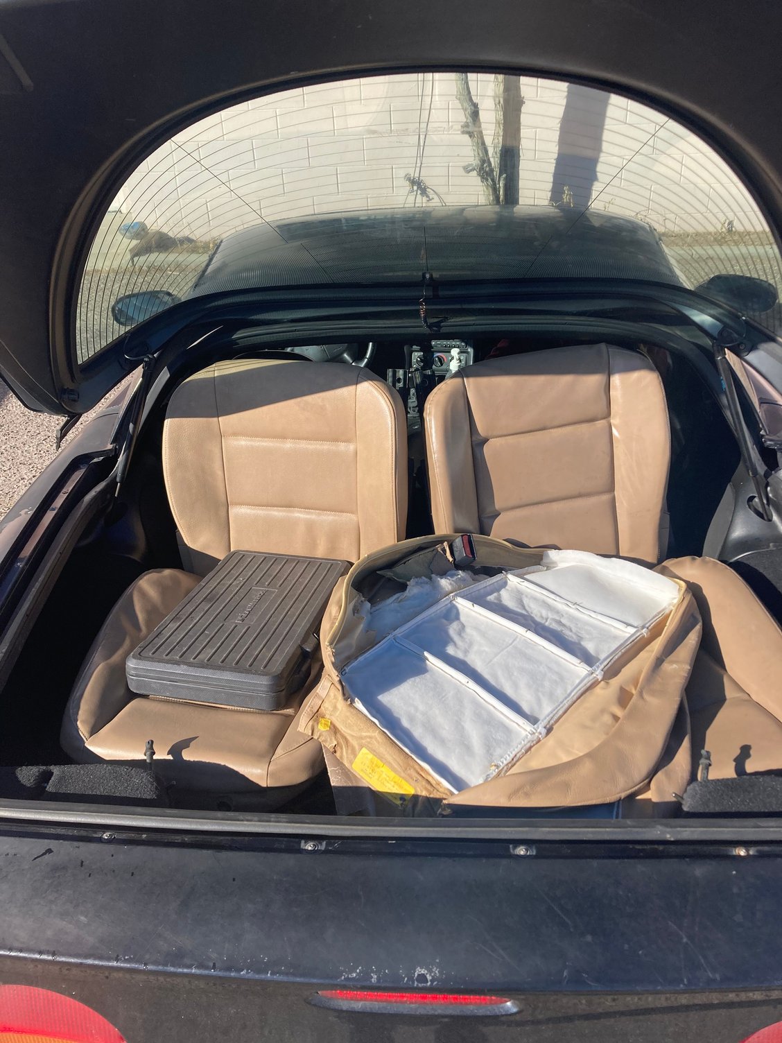

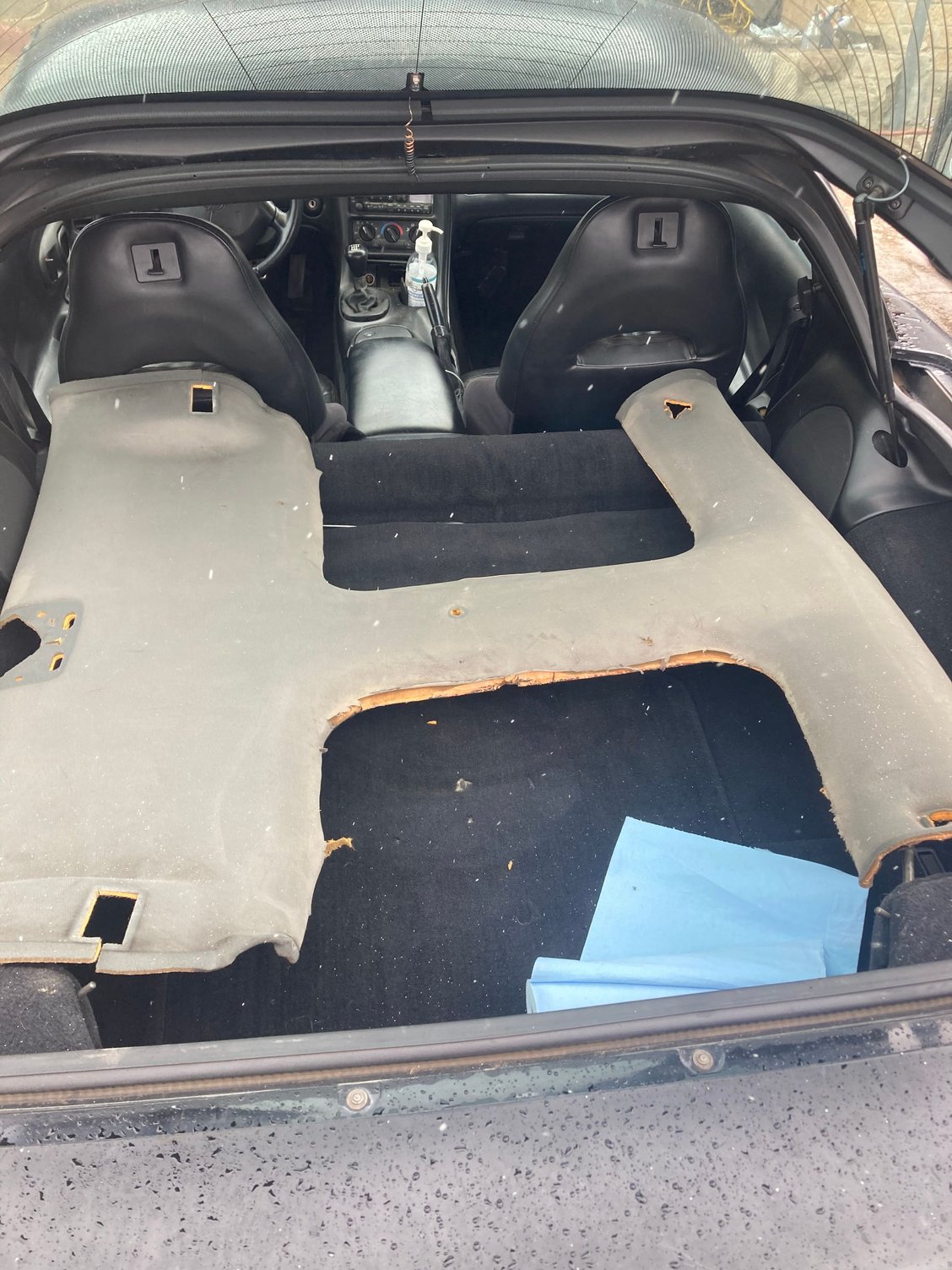

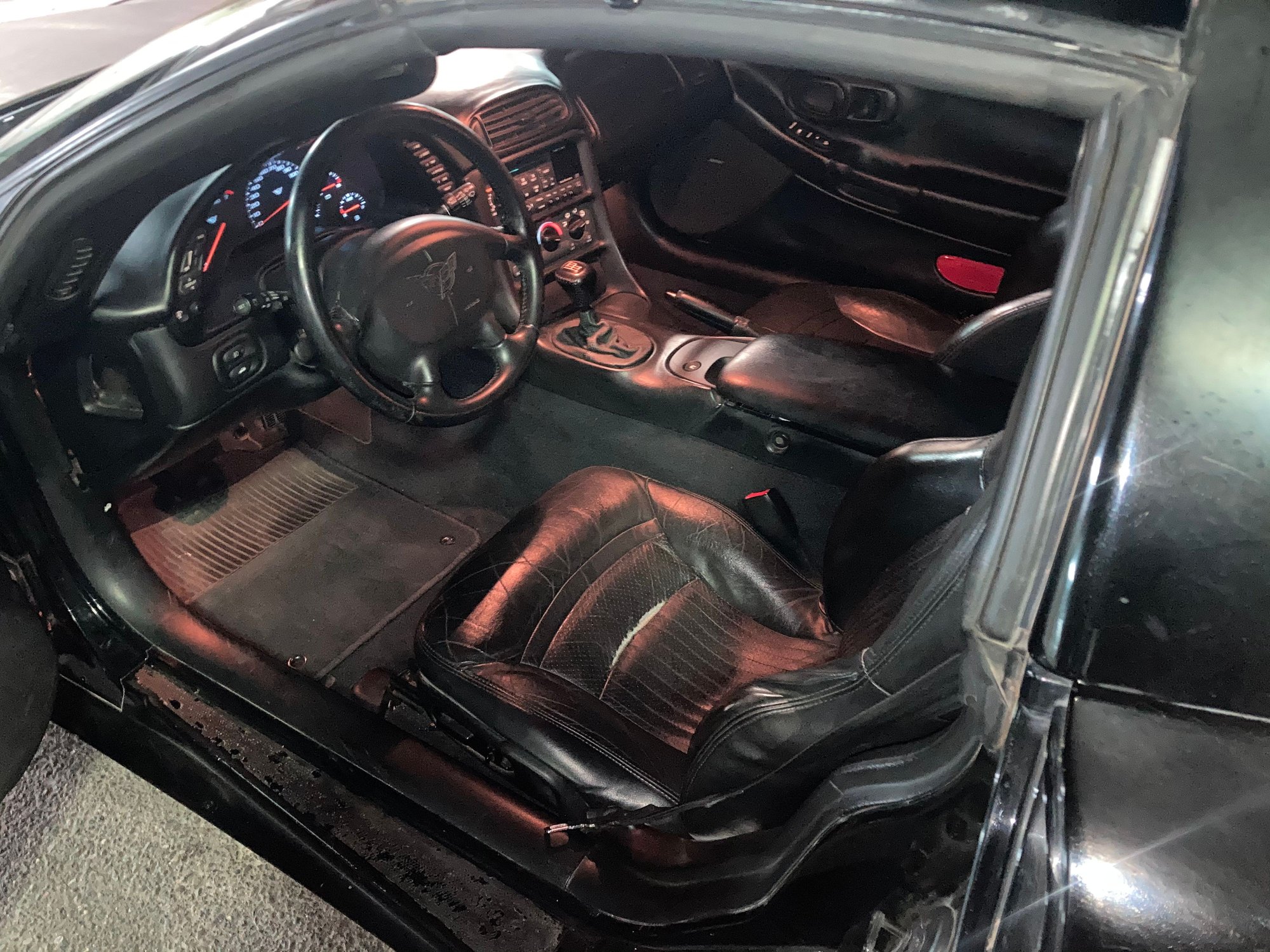

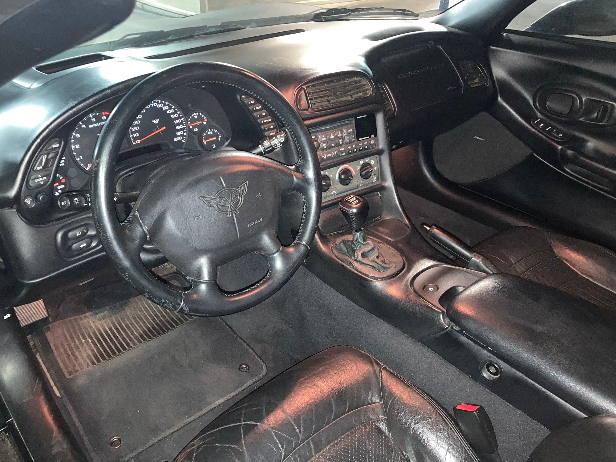

I vacuumed, wiped and treated all surfaces to assess the condition, interior is in better condition than I thought. I still need to shampoo the carpet, steam the crevices and vents, pull the seats, etc.
Other than the cut in the driver seat and a chunk of carpet missing in the trunk, I see no other issues. I did order a shift boot and ring.
over all I think it’s coming along well, also hold struts and driver regulator was replaced today.

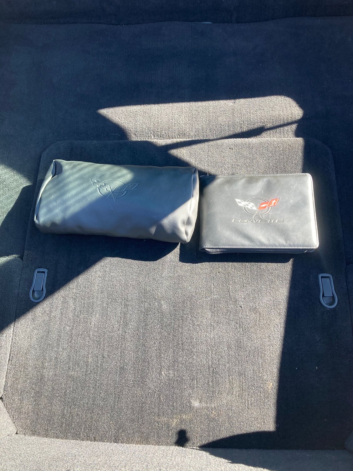

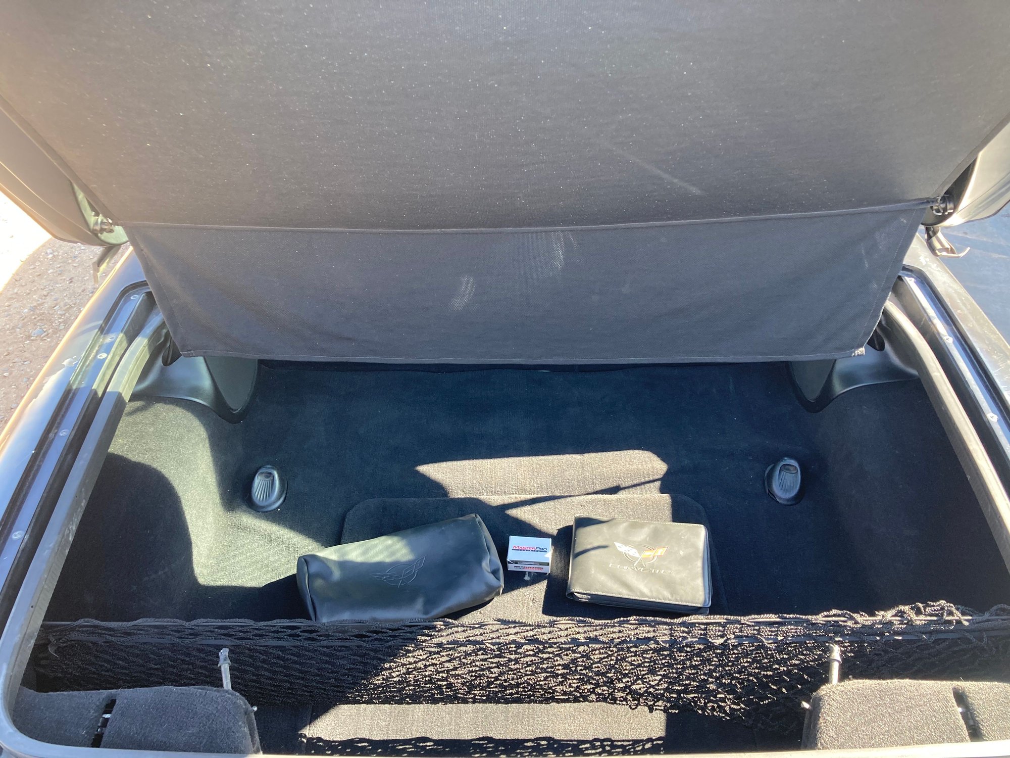

I bought a original rear sun shade, cargo net and carry bag on CL today, $60.
Baby steps but steps in the right direction 😀

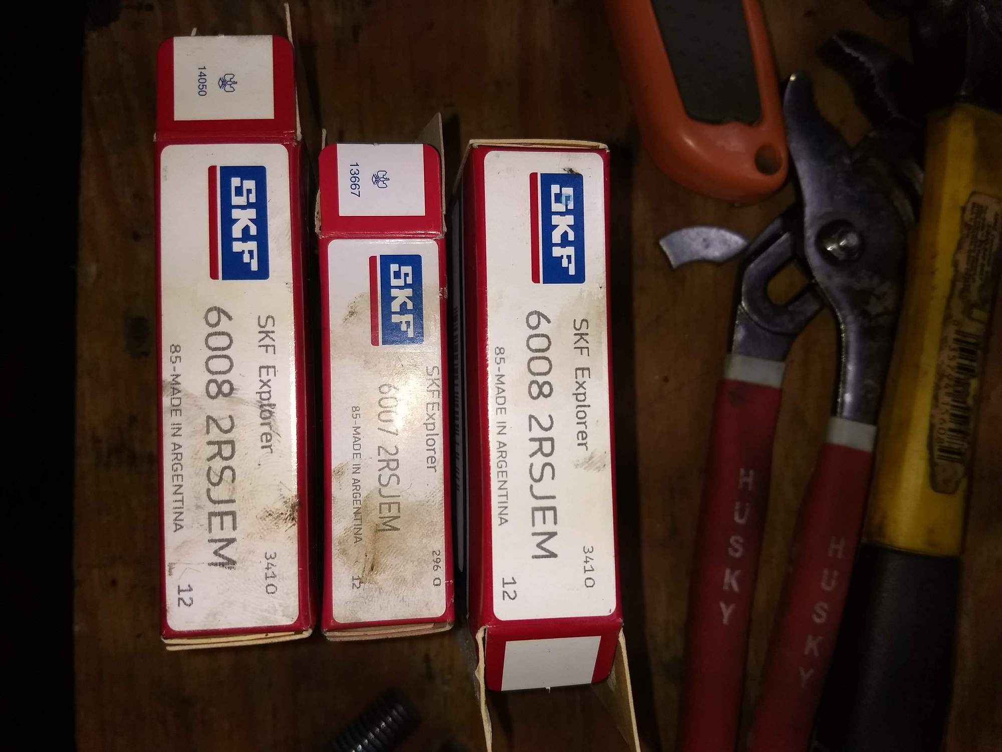

rebuild the torque tube... Its less than $200 in parts. 2 couplers and 3 bearings.

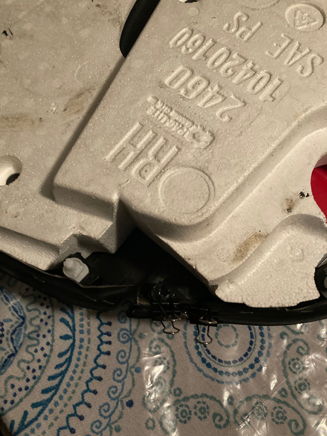

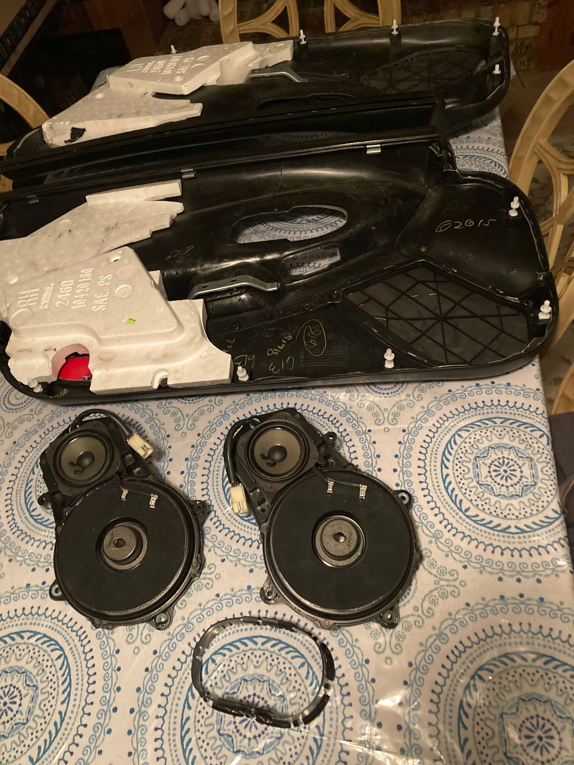

Well when replacing the window regulator I broke the last functional clip on the door panel. So I had some time to pull the speakers and panels and repair the broken tabs.
I used nylon washers and epoxy to repair the speaker tabs and let them dry over night. I repaired the broken slots on the door panels and inserted new clips.
I also repaired the shift boot ring while I was at it.
Hopefully this takes care of the squeaks/rattles in the door. I’m also using butyl tape and 3.5mil plastic sheet to make new vapor barriers since the old ones all but dust. I also dropped off the sun visors to have the floppy ears fixed.

Can you please provide part numbers or links?
These are the ones I installed.

Those are the bearings for 2000 and later snap ring torque tubes. For a 1999 non-snap ring torque tube you need one (1) 6007, one (1) 6008, and one (1) 6010 bearing, along with two (2) GM 12456212 couplers, and one (1) GM 12456208 oil slinger -- kind of flimsy and easy to deform. The couplers can be had a couple of places, run about $135 each at RockAuto, bearings from all sorts of sources, even the for sale section, which is self promotion on my part...
Looks like I’ll be returning a 6008 bearing. No biggie, better to have and not need. I just ordered a 6010. Thank you for letting me know.

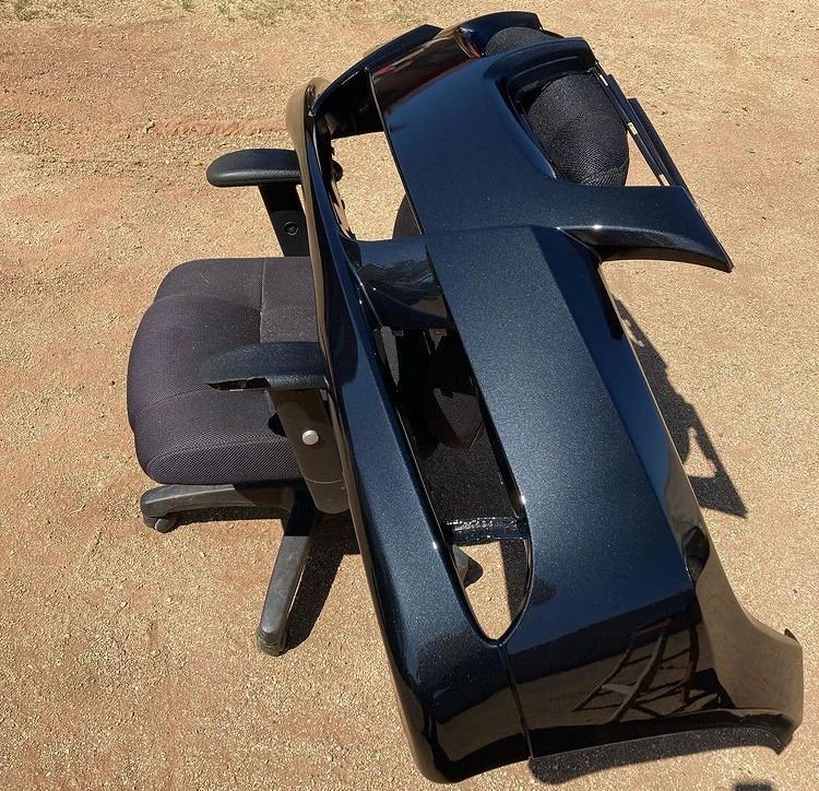

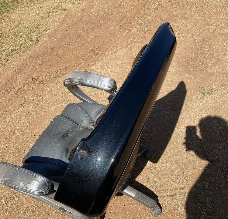

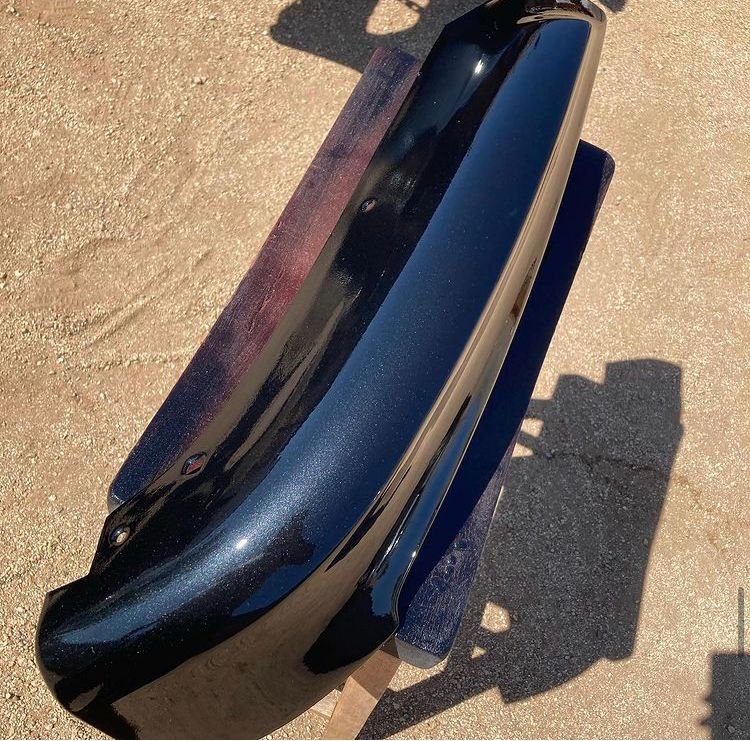

I can’t wait to paint it but it’s so cold it’ll be a little while. Meanwhile while I’ll be working as often as I can to keep moving forward. I know a lot of people will disagree but I’ll be painting this out side. I’ve done several vehicles like this, the most recent being my BMW. I’ve done complete cars and parts like this for a long time.
I will be disassembling the bumpers, fenders, etc. for paint. I’ll end up doing 3 coats of BC/CC.
