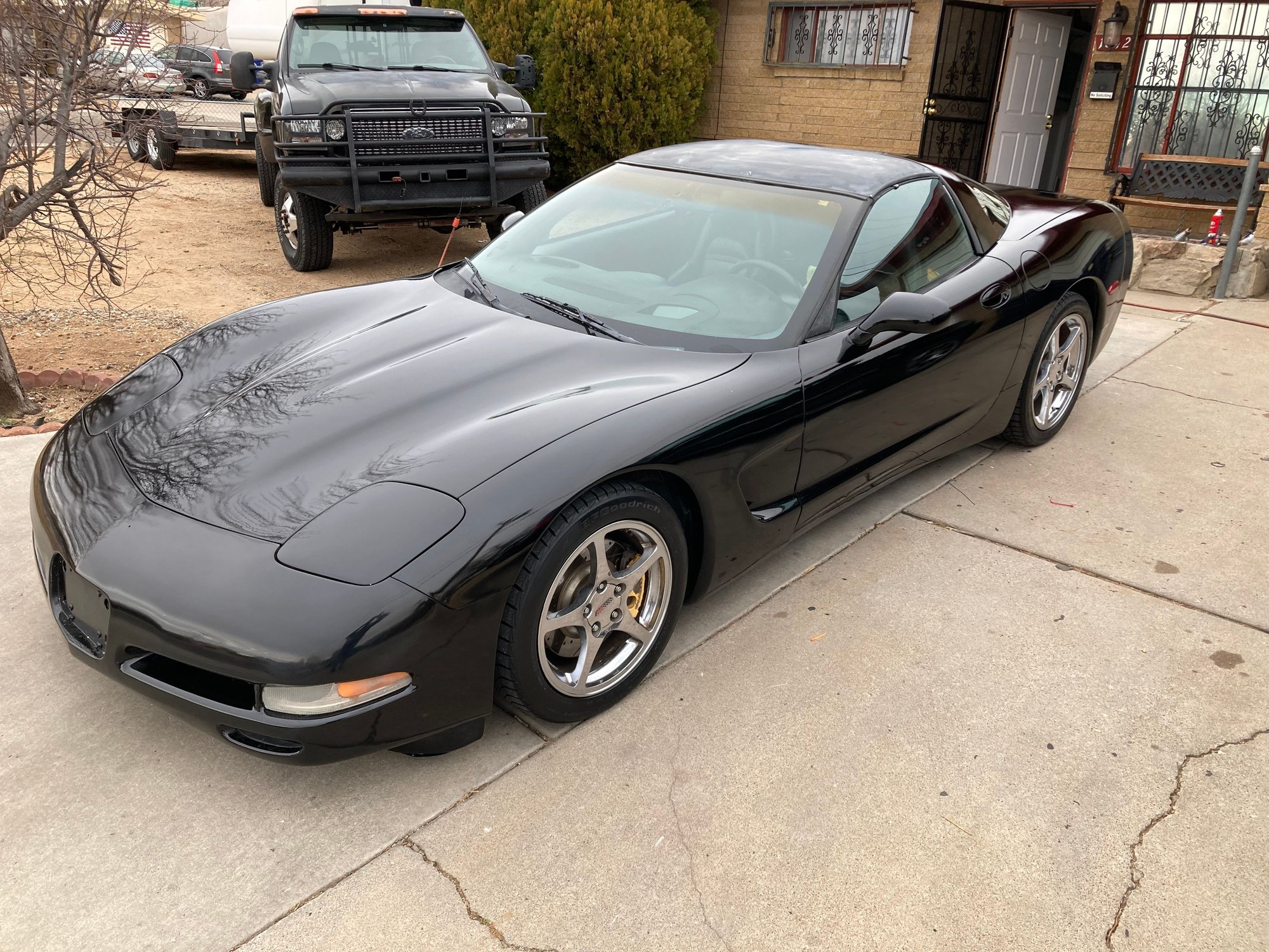

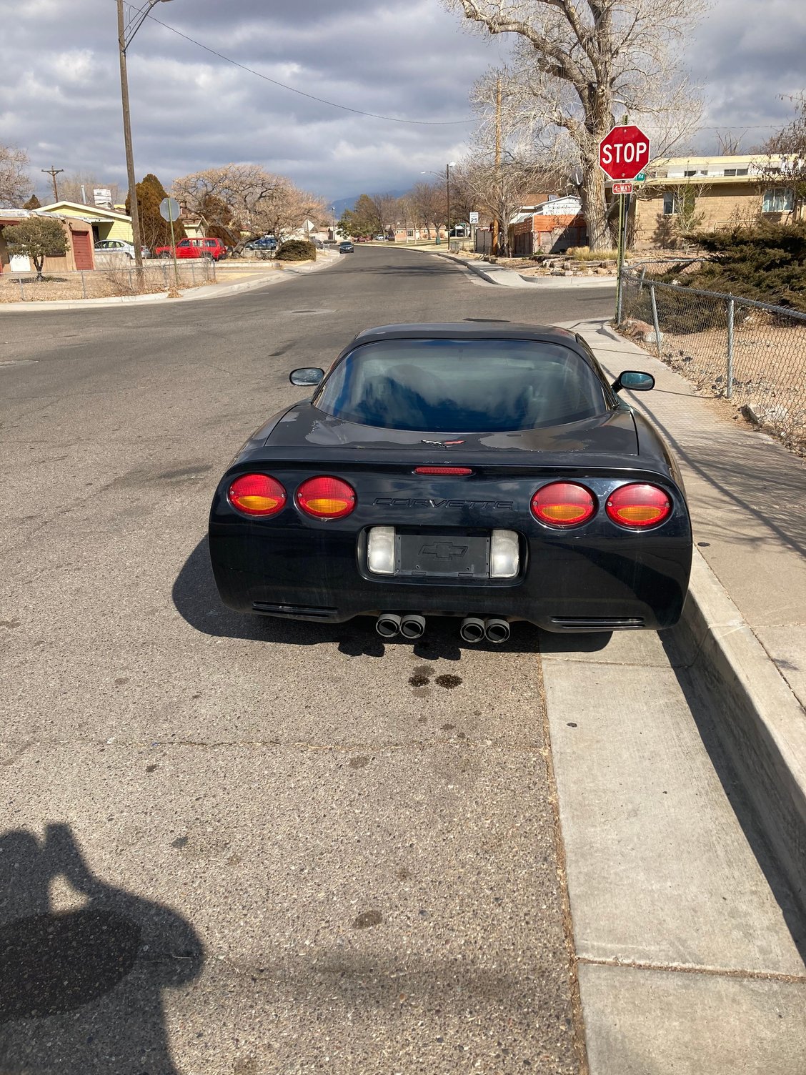

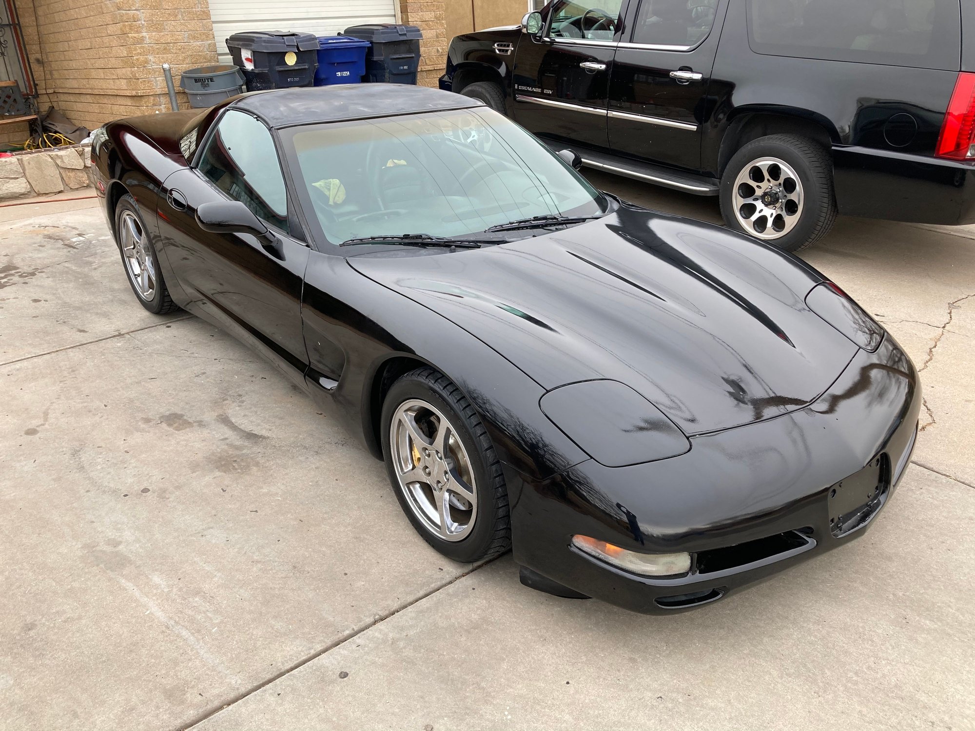

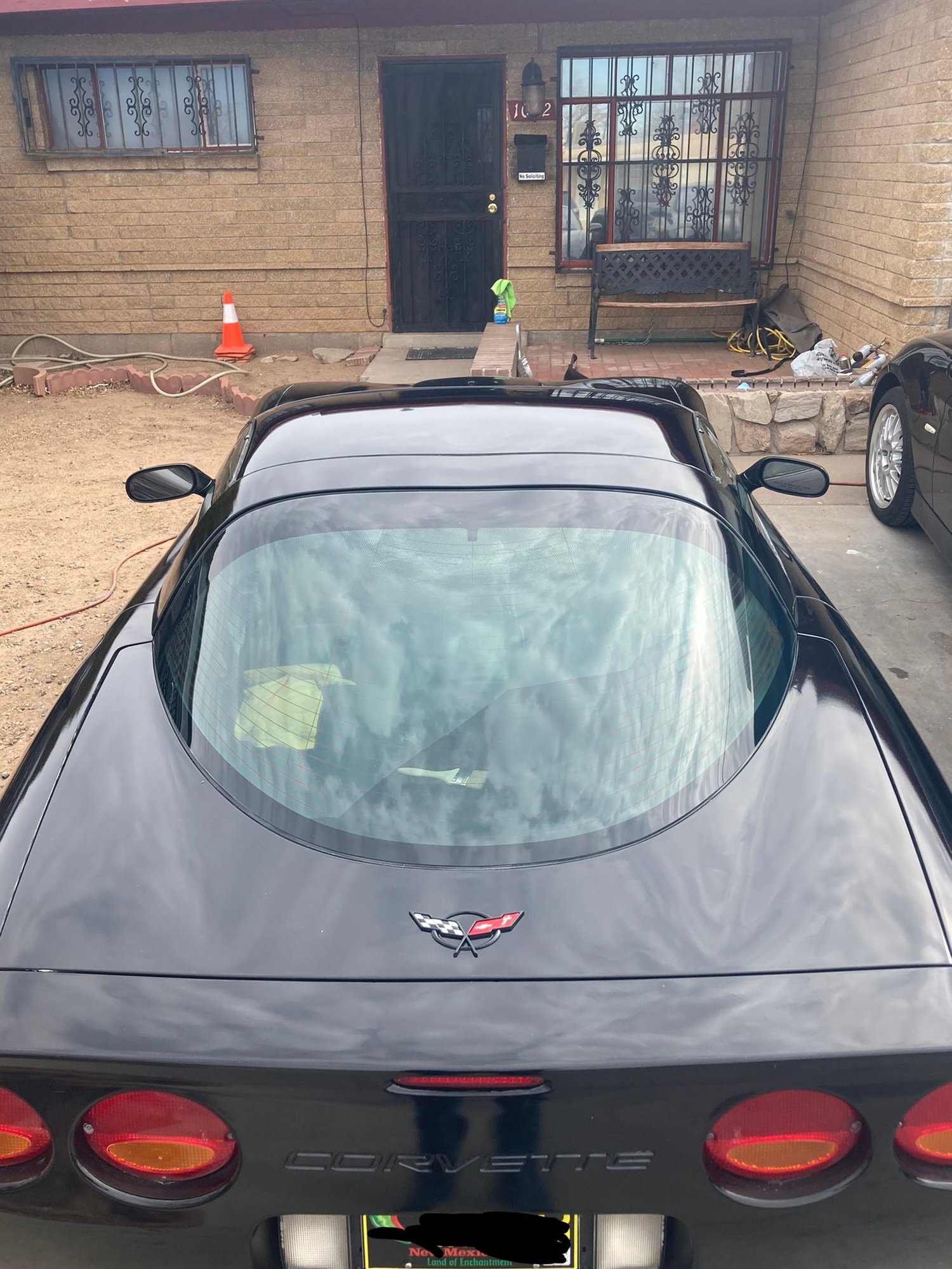

So my cousin came across this corvette for $4k after some negotiating I paid $3,400 for the car. It is a 1999 Corvette Z51 6 speed manual with 127k miles. It ran well but was definitely neglected. I drove it home and the next morning I started basic maintenance. Did transmission with 4qt DexIII, rear diff was 2qts 75w90 synthetic (with modified), 7qts Mobil 1 and filter. Next it was off to a friends shop for a clutch bleed on a lift. Once I got it back I did the AC Delco Iridium plug and Edlebrock wires.
Cheap C5 Build: Dyno and Weigh In - CorvetteForum - Chevrolet Corvette Forum Discussion

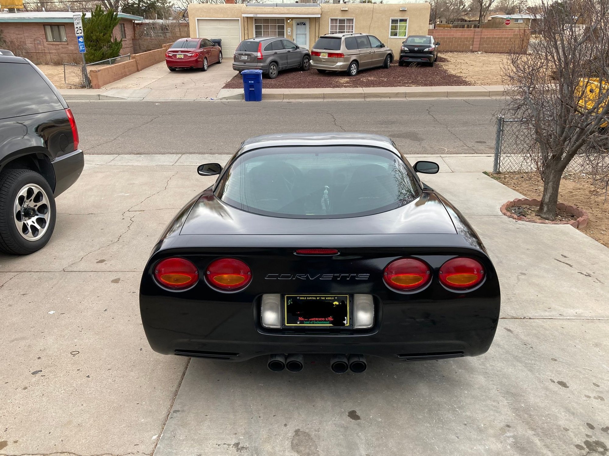

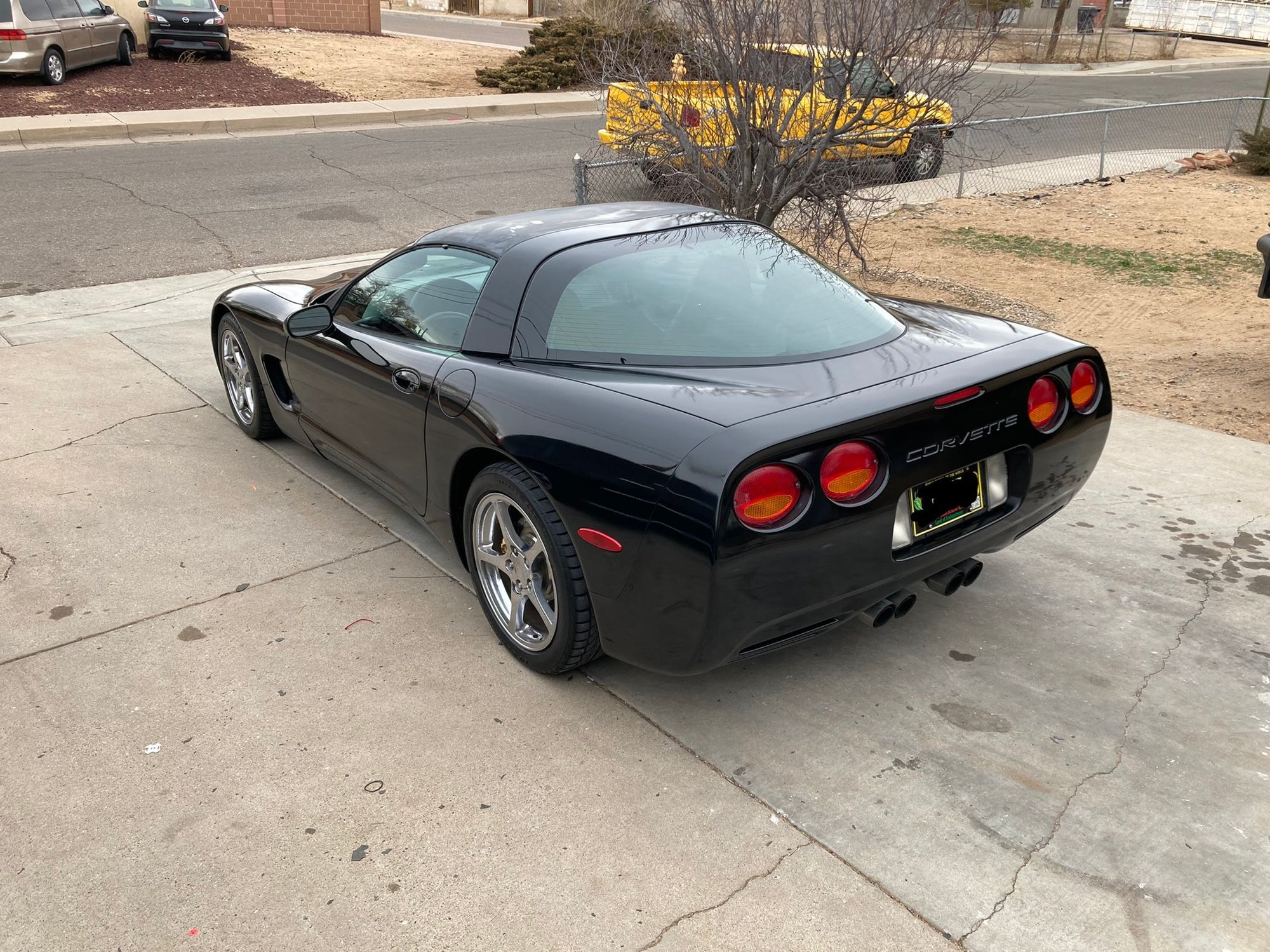

Edit: I added some after pictures here so you don’t have to read through the whole thing if you you don’t want to.
Badges on, top polished.
Last edited by knockingdiesel; Jul 17, 2021 at 12:02 PM. Reason: Added images and information

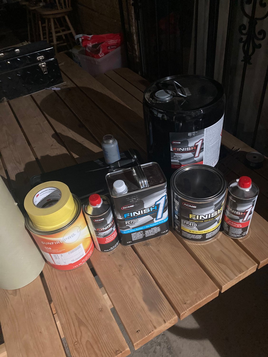

Although she won’t be a garage queen she’ll be restored to her former glory. I grew up in a body shop so scratches and panel touch up aren’t a problem. A paint job will cost me around $200 doing it myself.

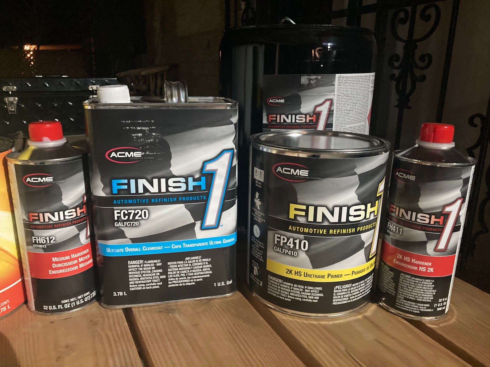

Sherwin Williams finish1 clear was $80 and 2qts paint (reduced to 3 qts) is $70. 3 rolls tape is $8 and 1 roll paper $18. 2k primer is $90 but it won’t be necessary on this car.
