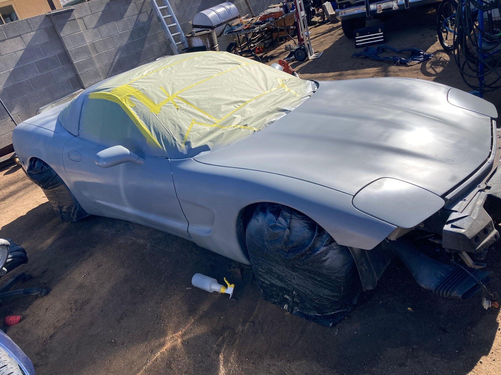

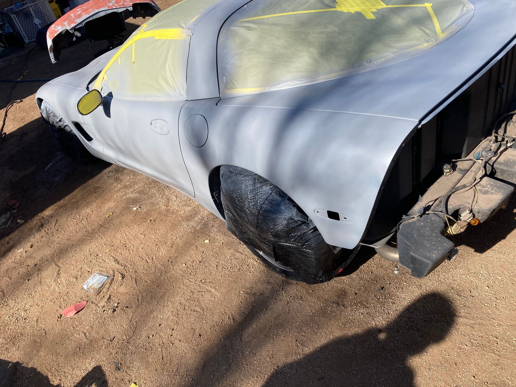

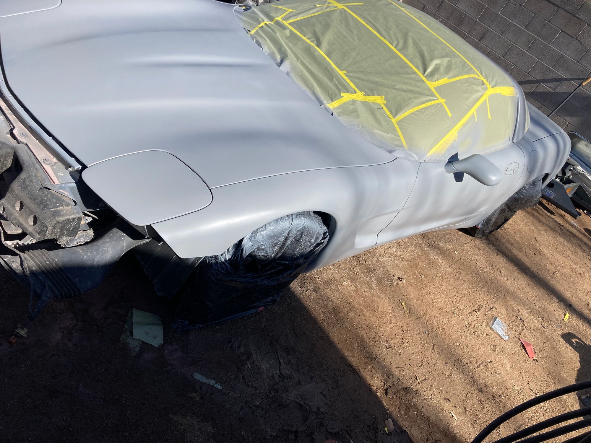

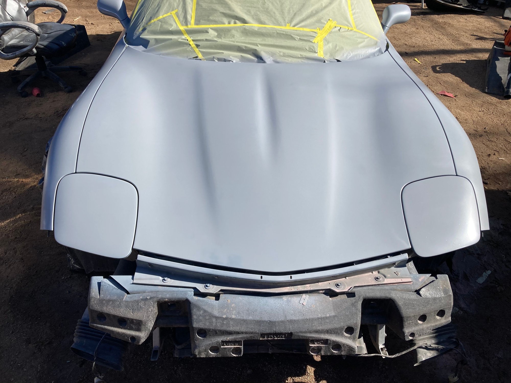

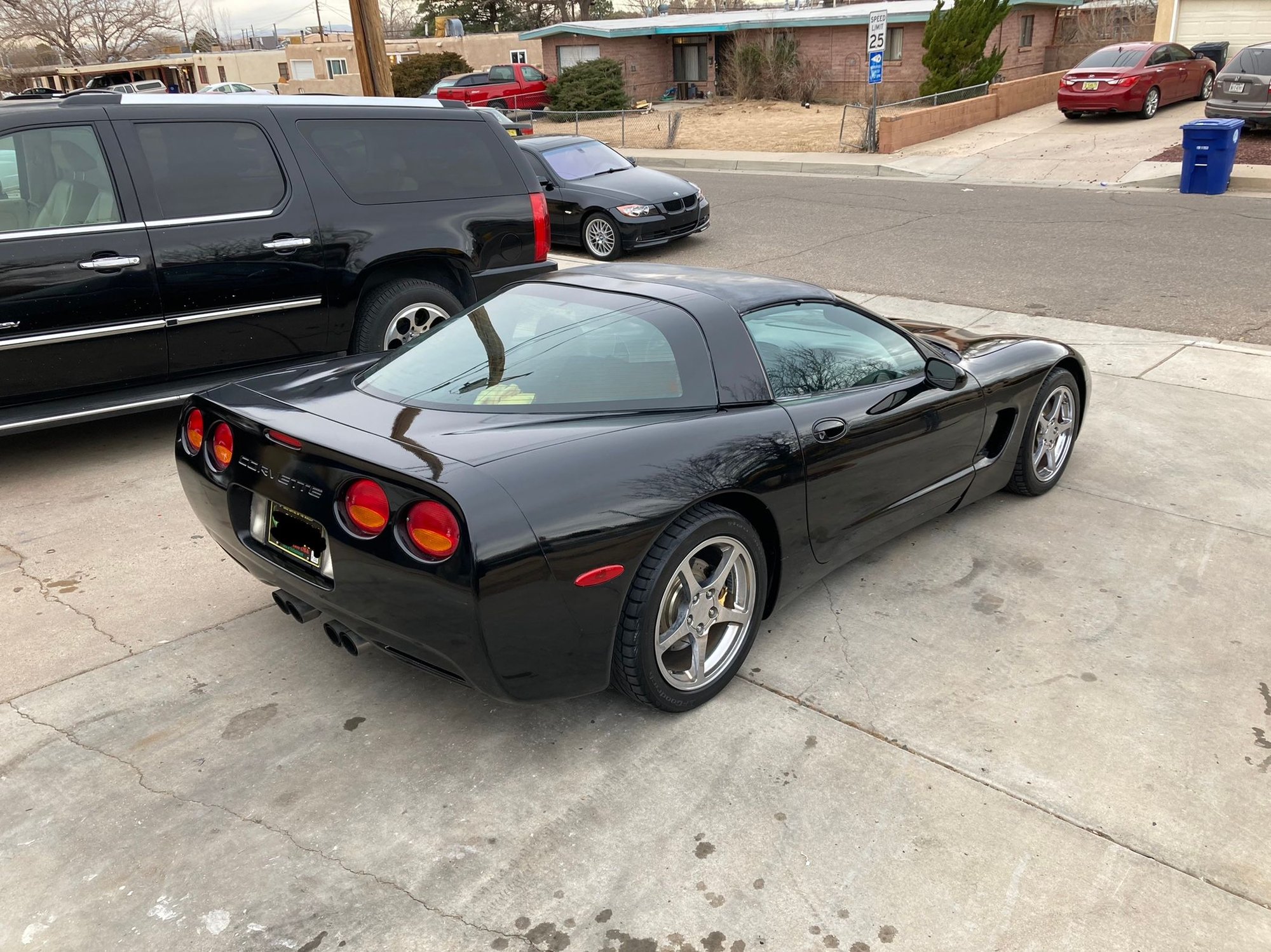

Primer is done (2k poly primer since I had some left) 2 coats. Tomorrow dry sand with 600 grit and paint.

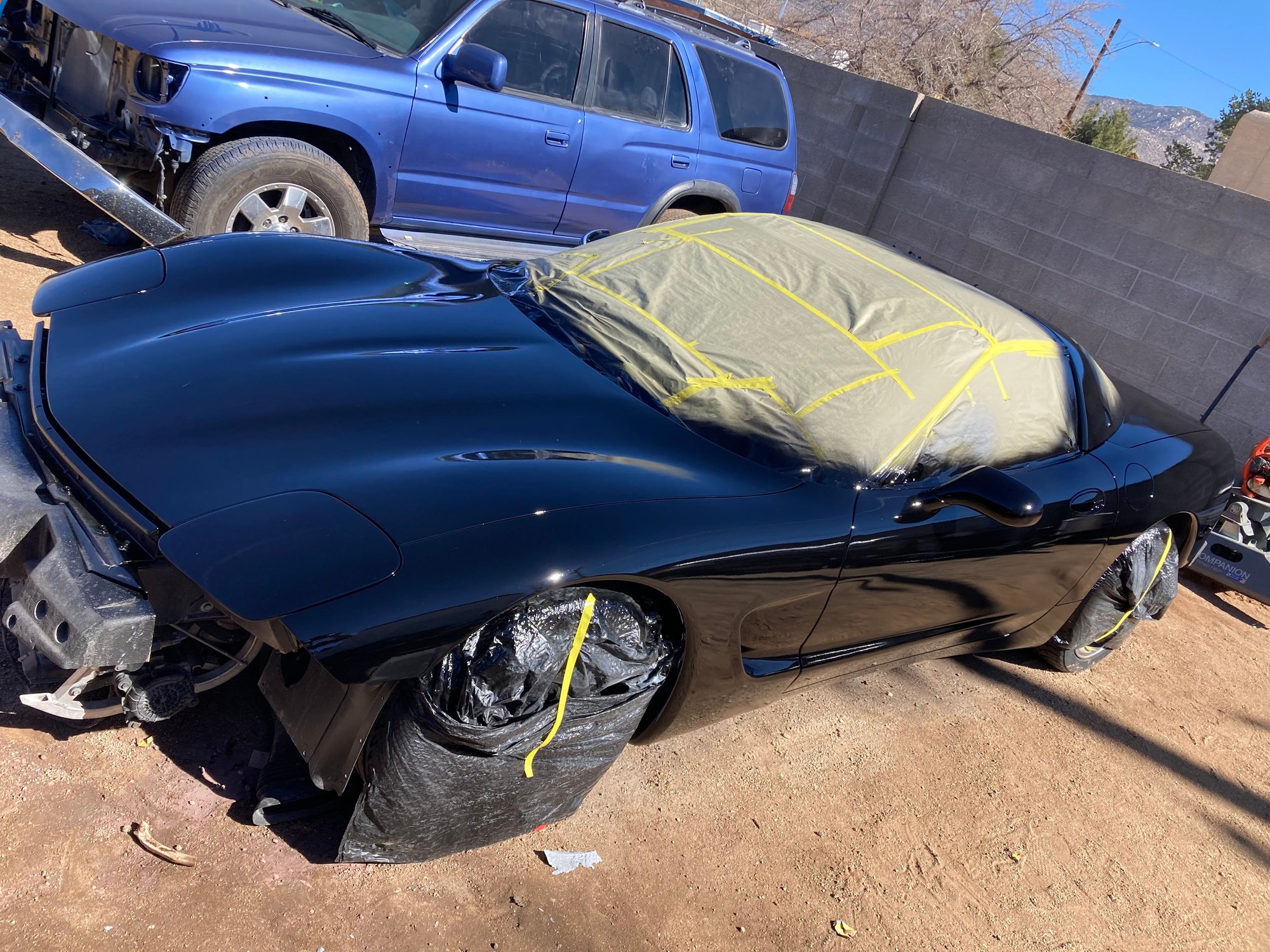

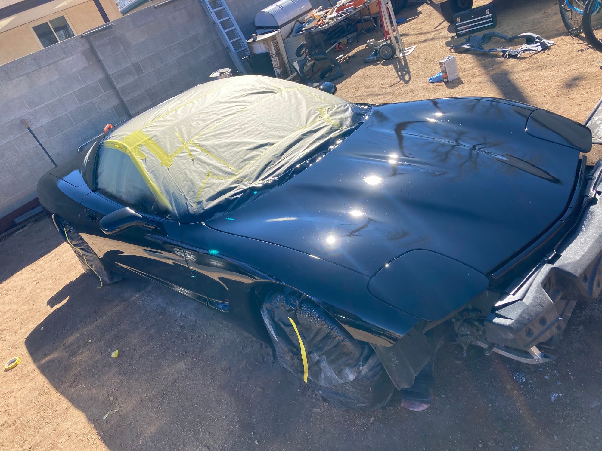

I had 3 good days to do the body work, prep and paint. 3 coats of base and 3 coats clear. All in I’m out $190 for paint job and $150 in body work. My hours aren’t included, about 25hrs for body and paint work.
ended up consuming 3 quarts of paint and a gallon of clear. I did two coats of primer blocked it with 400 then 600.
Im happy with the results given my time frame and weather, it’s a really nice daily driver. I did many to forget to do the front license plate cover. I’ll be doing it in a day or so.
Edit: not included in this prices are odds and ends that I already such as mixing cups, paper roll, tac cloths, etc. and I already had the equipment to this also.

Oh my goodness what a difference! That's going to look great when done. Nice score on the car for sure.

Pretty inspiring, I must say. Makes me think I could paint a car in my shop if you can do it outside!

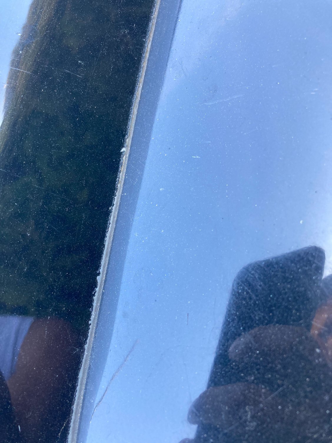

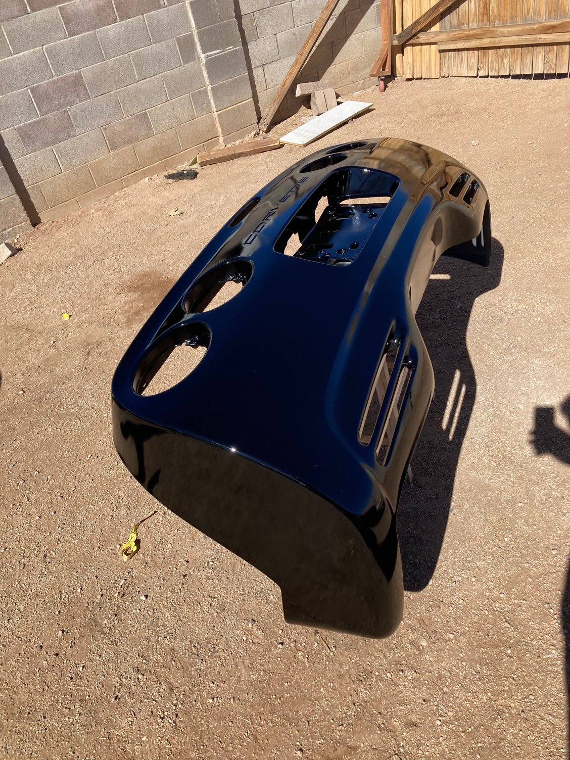

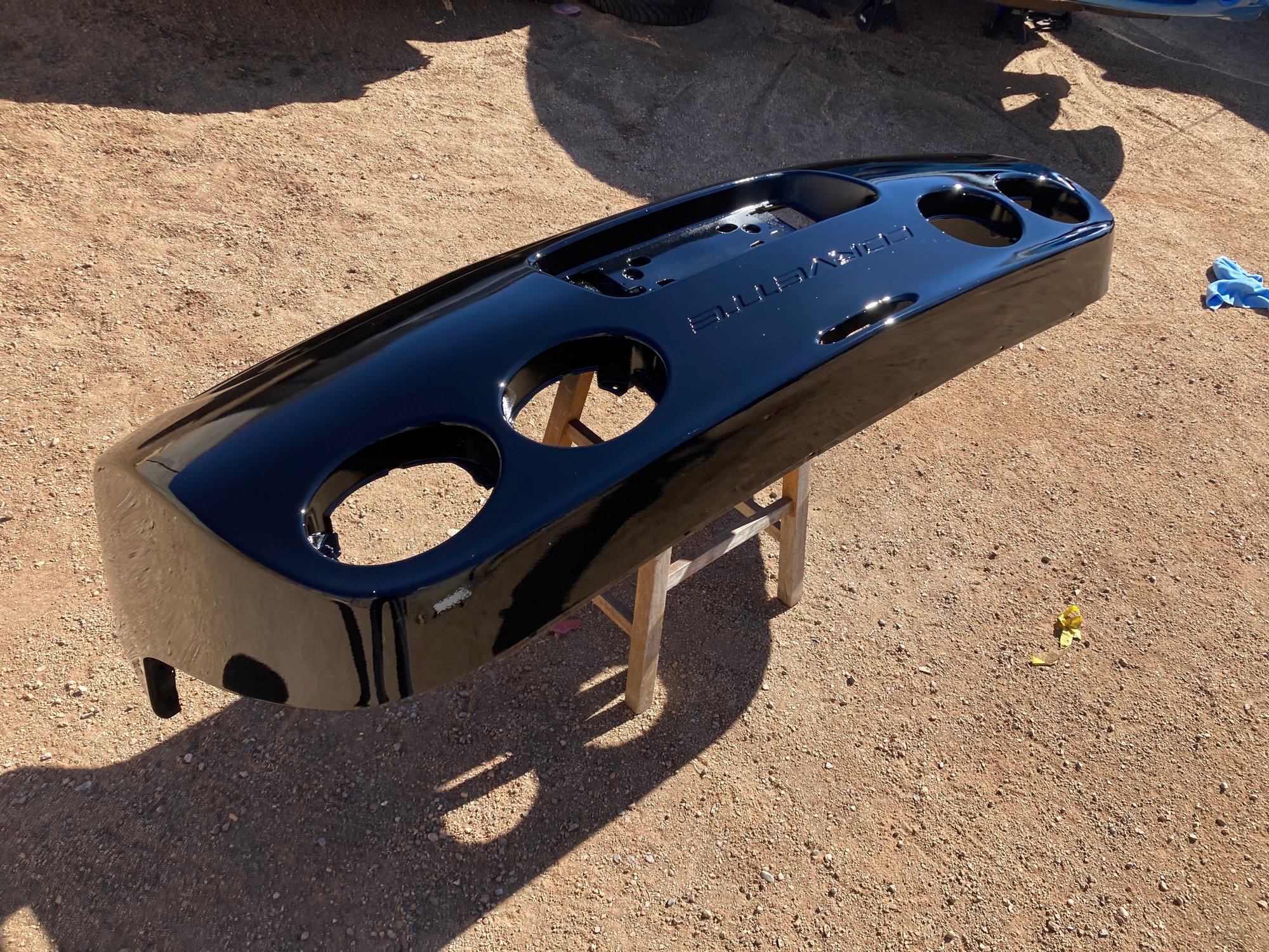

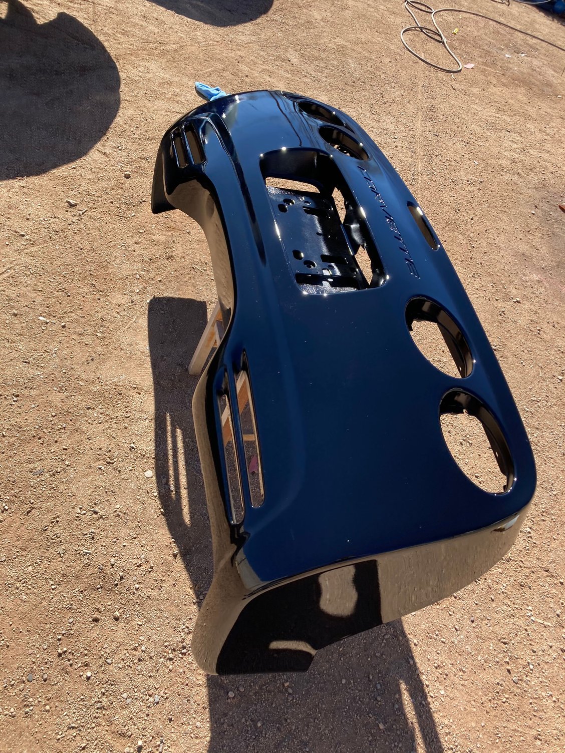

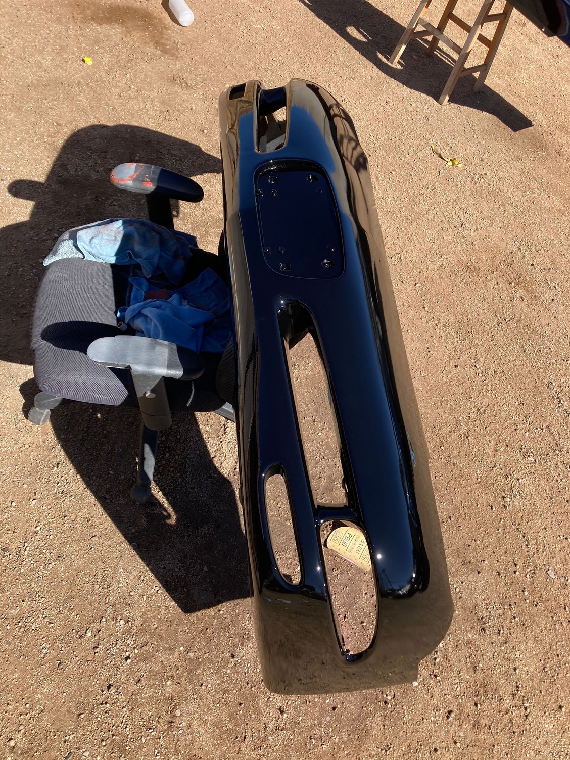

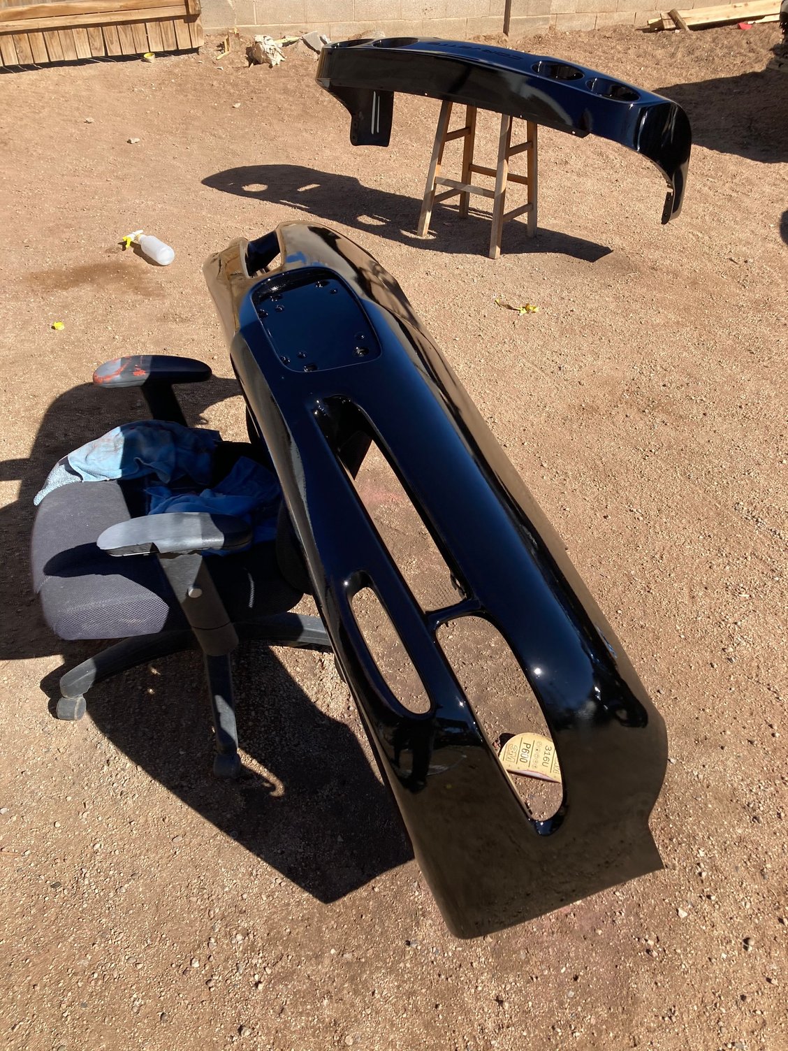

Technical question: Why did you remove and paint the bumper covers separately when you didn't remove anything else?
Old Feb 9, 2021 | 11:54 AM
  #48
knockingdiesel's Avatar
knockingdiesel
Joined: Jan 2021
Posts: 89
Likes: 68
From: Albuquerque, NM
I normally do that to keep the paint from cracking in the likely event the bumpers need to come off (look at pics below). Since all other panels have bigger gaps it’s a non issue. I didn’t bother with the mirrors or door handles as they’ll likely never be removed.
In this case the front bumper had lots of pitting and 2 cracks. So taking it off was the only way to repair it.
That being said, if I were repainting for the best possible outcome, I’d remove pretty much everything.

I’ve color sanded and compounded the passenger side.
I still have a ways to go.

The before and after picture is going to be powerful.

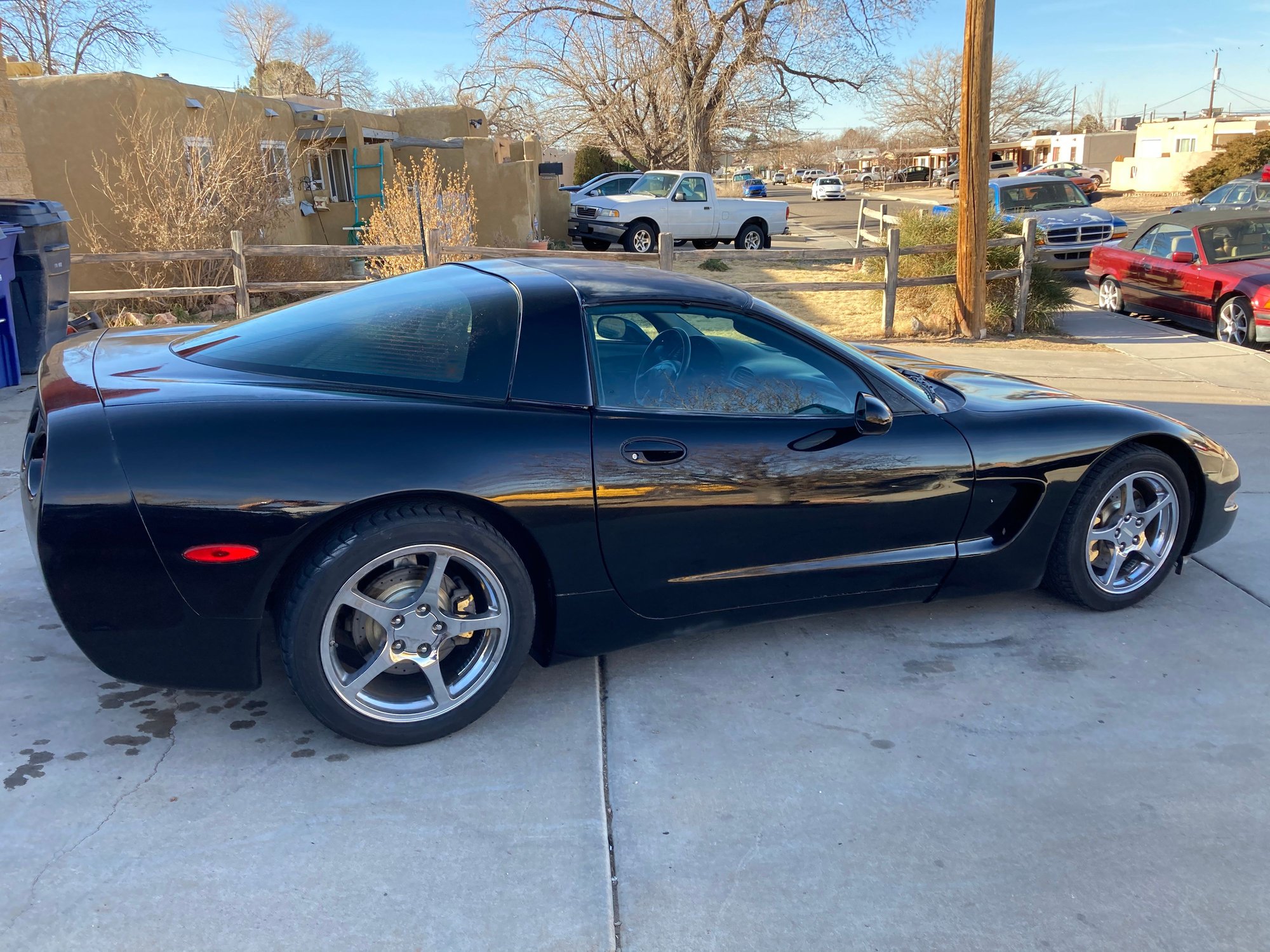

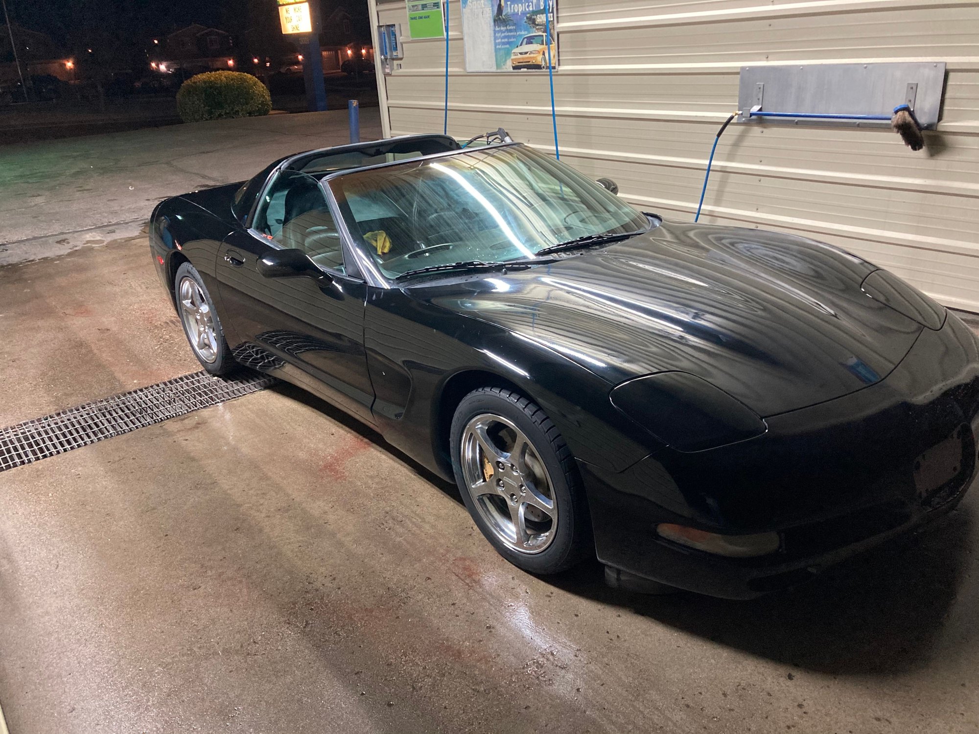

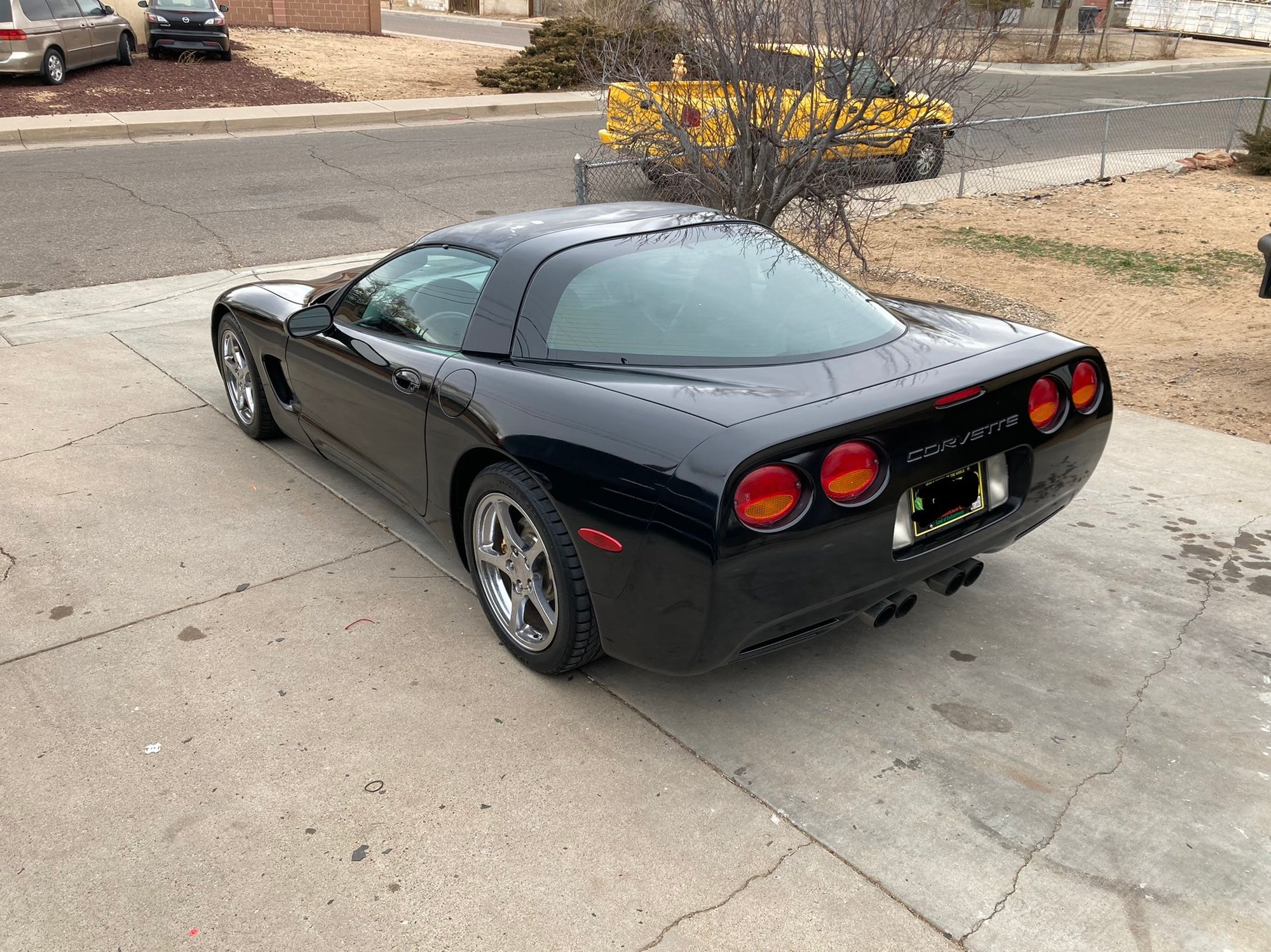

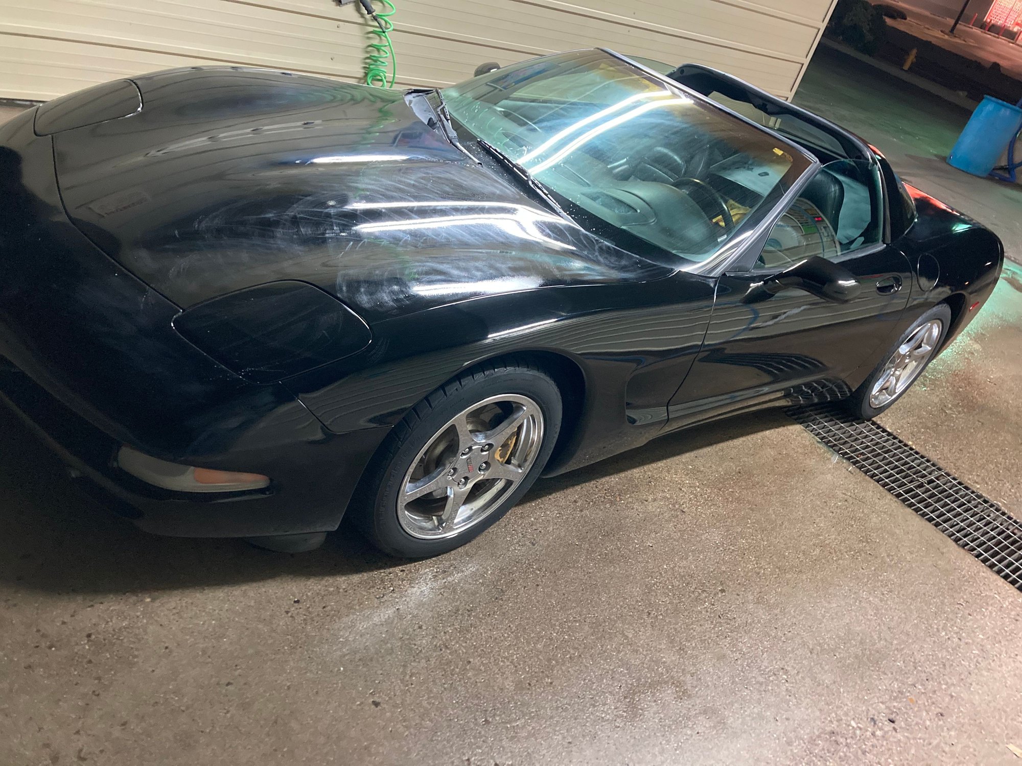

I’m about out of energy and upper body strength. I have sanded the sides (2000 then 3000 grit) 3m compound, polish and wax.
Both sides are done, hood and trunk still need to be done. I should have the rest of the paint done in the next few days.
lots of residual wax/polish/compound built up in the crevices so took it for a wash.

3k wet sand and then a good polishing must have it looking like glass. I do my billet wheels the same way.

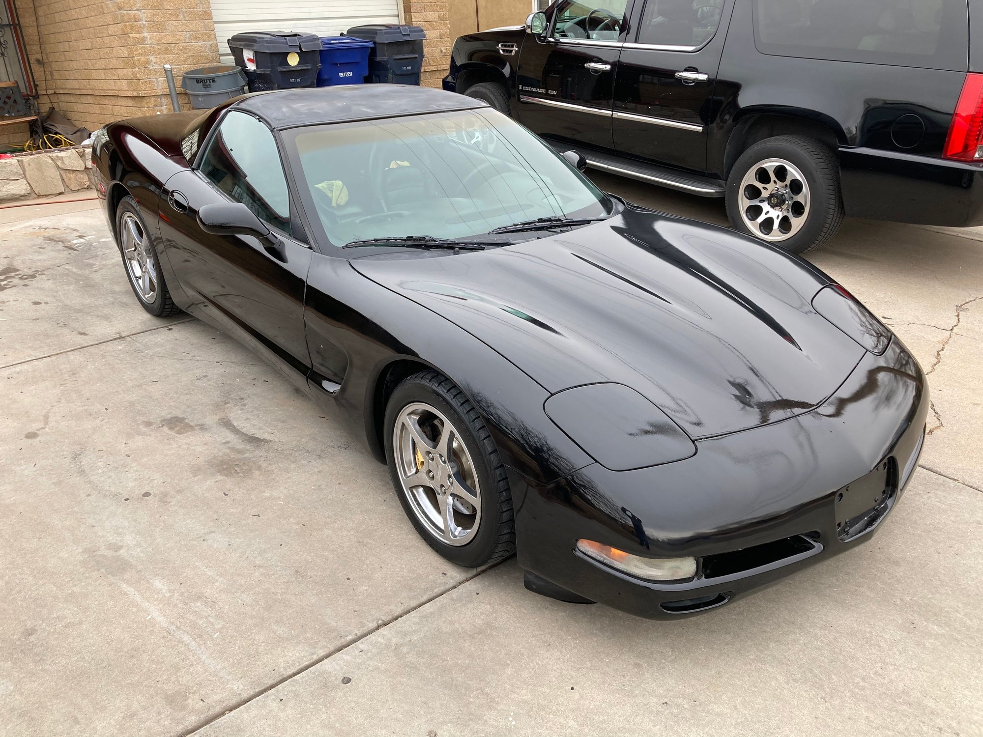

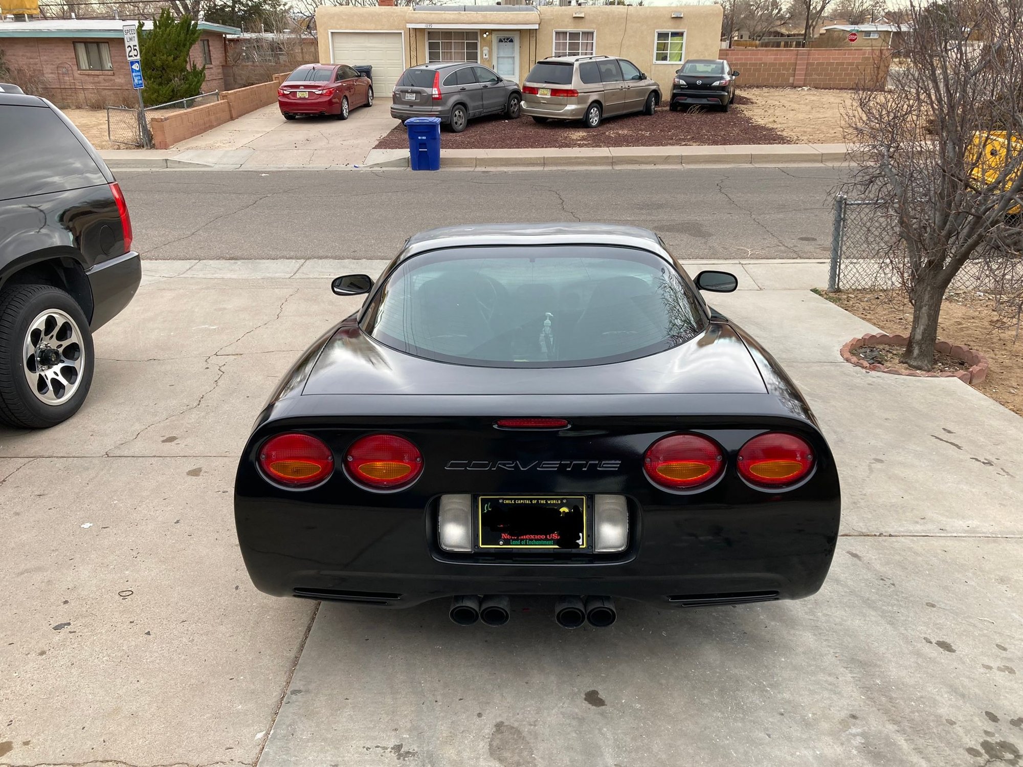

Well I’m 5 days in, from start to finish. She’s not perfect but it’s exactly what I wanted. She’s a 5 foot daily driver that I’ll enjoy for as long as I can. It’ll be getting the clutch and complete hydraulic system, along with the torque tube rebuild next week. The week after I’ll have the driver seat repaired.

You have brought that C5 back to life in such a short amount of time and it really looks amazing.

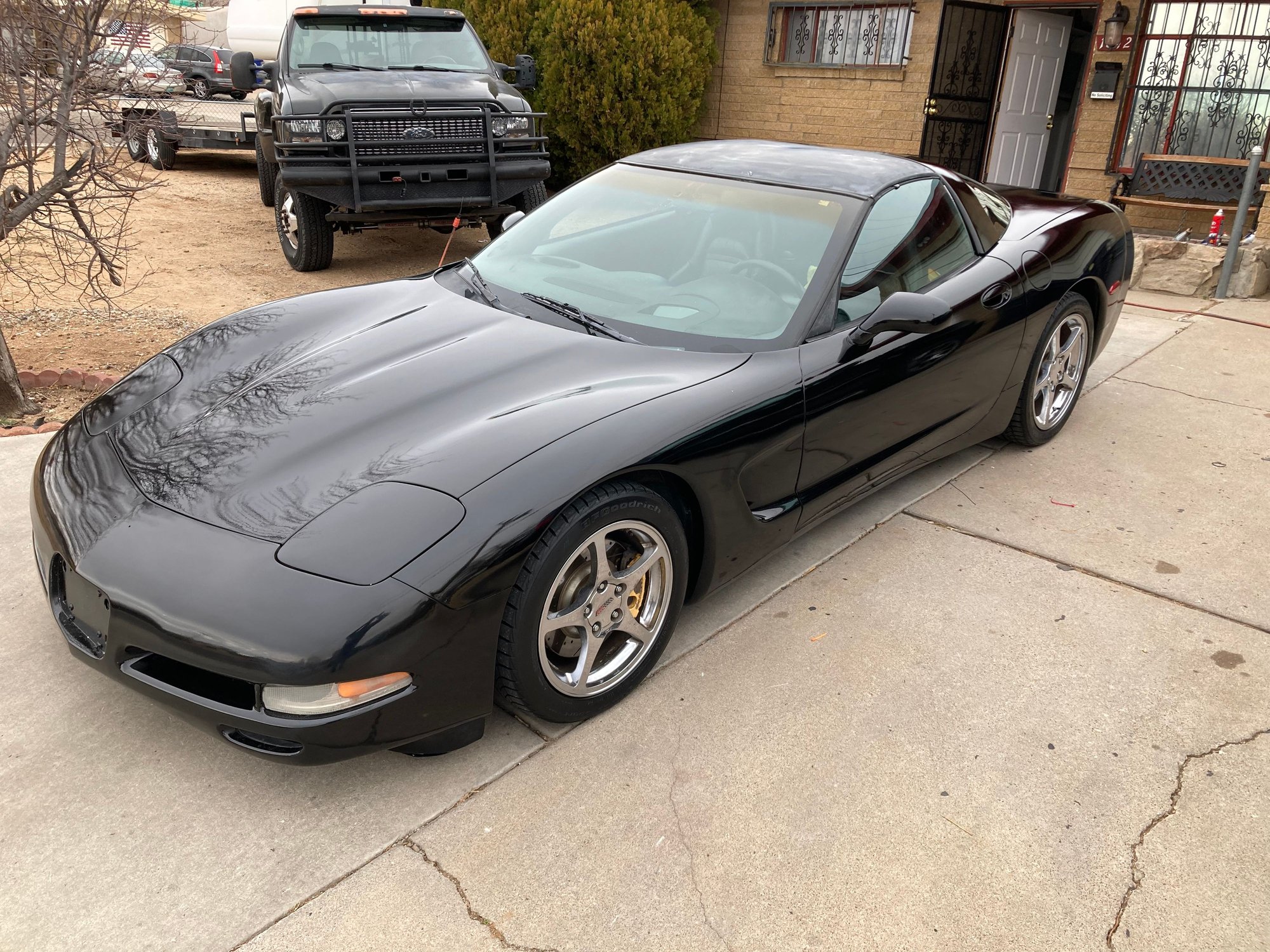

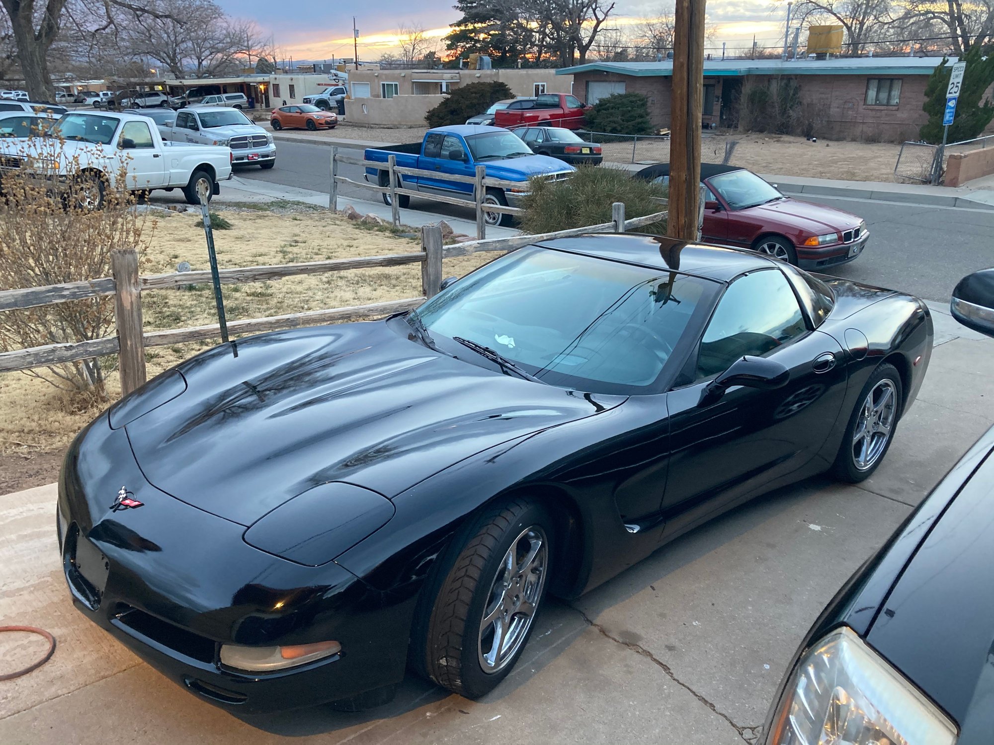

She’s all waxed and ready for the weekend!
